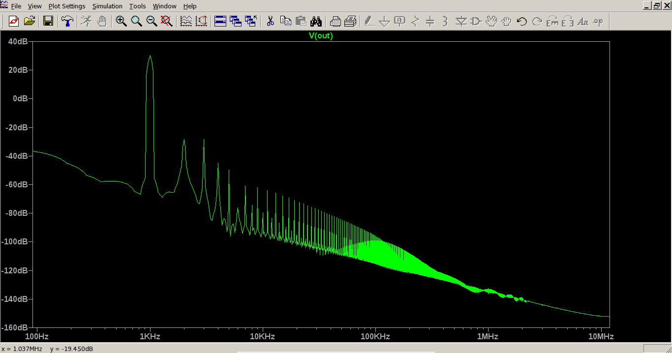

The attachment is an LTSpice screenshot showing the short current spikes with a 1000Hz input signal. The amplifier schematic has been enlarged to clearly show the output short ciruit current limiter, so that, users can make their evaluations, and if they want, comment.

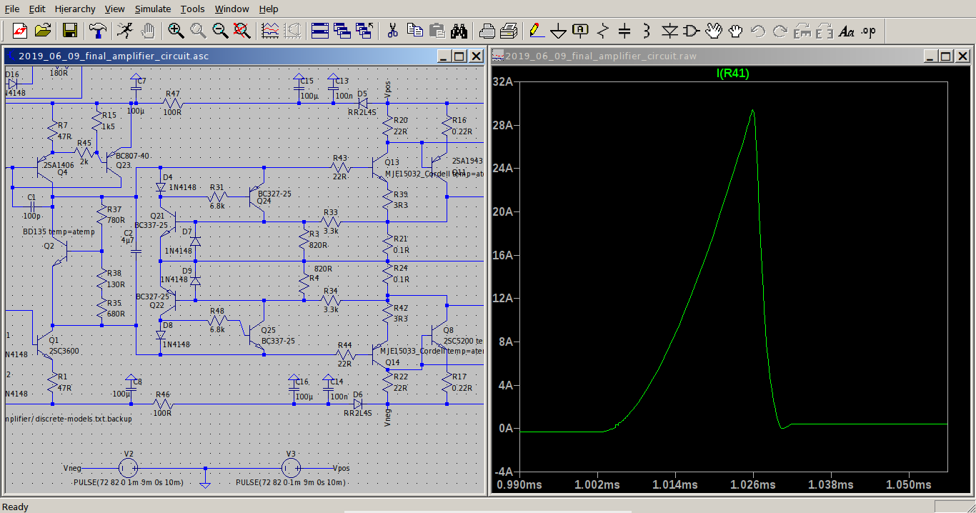

The almost perfect +/-35A peaked short circuit current squarewave has been greatly weakened, and transformed into triangular spikes with a base of 28 microseconds. Their peak is the protection circuit's activation current, which is 29.5A.
The reason for such a high activation current, is to allow for high power bass at full power with a 2 Ohm load.
The protection circuit works on the principle of forcefully latching itself on when the activation threshold voltage is sensed. The circuit remains on until it is de-energized at the succeeding crossover.

The distortion gets lower.
Adding two 68kOhm resistors to the output overcurrent protection circuit reduced the distortion figure. I am posting as it would be very interesting to understand why two humble 68kOhm resistors improved the distortion figure.
The added resistors were added in parallel with the signal diodes that are connected to the collectors of the protector circuit.
At 8 Ohms, 141W, the distortion is 0.005%.
At 4 Ohms, 283W, the distortion is 0.007%
At 2 Ohms, 572W, the distortion is 0.017%

Q24 and Q25 prevent the output transistors from damaging heat dissipation in the event of the output being short-circuited. Without them, the output current waveform is a square wave with a peak of 35A which is far too high. The output overcurrent protector circuit works closely like a Schmitt Trigger. Once the tripping threshold is reached, it is turned on and remains on until the voltage reaches crossover. While the output protector is latched on, the output cannot conduct much current.
I asked for comments as I did not expect the distortion figure to be improved with this addition.
Post 541 has a screenshot of the short circuit output current waveform. As you can see, the power dissipation is greatly reduced.
No, Q21 and Q22 switch off the drive on overload, Q24 and Q25 just short out the forward voltage of the diodes in order that Q21 and Q22 can function into a CFP output stage where the driver bases are only 0.7V above/below the output rail. Using schottky diodes means there is no need for Q24/Q25's auxiliary function.
With silicon diodes Q21/Q22 can only pull the driver bases to within 0.8V or so of the output, not enough without help. Schottky diodes are one solution, helper transistors Q24/Q25 are another.
With an EF output stage the driver bases are larger and this isn't an issue.

Before implementing the circuit additions physically, I would like to ask readers of this thread whether a simulated -22.6mV DC offset is acceptable.
With the new additions the short circuit average current has been greatly reduced. Plotting I(out)*V(rail), and using the generated graph to estimate the short circuit power dissipation, the result came to be about 60W to 70W.

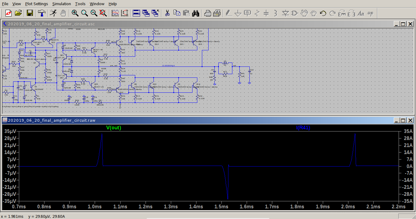

The output short circuit current is triangular with bases of around 26us and amplitude of 33A. The frequency is the simulated frequency of 1000Hz.
I am posting the circuit. I made a conscious effort not to change the original circuitry to enable myself to implement the new additions without having to rebuild the PCB from the very beginning.
I am attaching the circuit, a Fourier distortion chart with a 2 Ohm load, and the output on short circuit (1 micro ohm).
Looking at the Fourier chart, one cannot fail to notice the third harmonic is quite strong although narrower than the second harmonic. Acoustically, the second harmonic may be acceptable as a distortion, but the third, many deem may sound unpleasant to the ear.
