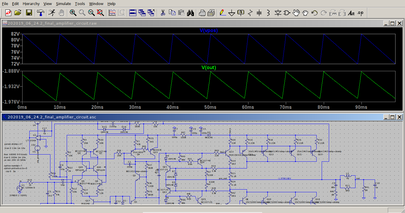

To investigate common mode amplication, I made sure the input difference at the inputs is zero. I achieved this by shorting the inputs together in LTSpice. In agreement with my expectations, the output is not zero, but a replica of the power supply ripple but with a much attenuated amplitude. This means, the differential input is not rejecting common mode signals sufficiently.
I am attaching a screenshot of the output and positive rail voltage.
The cascode at the input stage is subjected to power supply ripple and mains impurities. The cascode's changing Vbc causes its output currents to be modulated in accordance with the cascode's transistors output characteristic. So, the current mirror is receiving all these blemishes, and due to itself not being a totally balanced mirror, some of these blemishes are passed on to the VAS.
The sources of this problem are the transistors' finite output impedance/resistance and not-perfectly matched current mirror transistors.
Further explanation:
Since the bases of the differential pair are shorted together, the output is generated as a result of the finite BJT output impedance. The cascode's collectors are effectively under the influence of the positive rail voltage which, like all power supplies, has a ripple and voltage artifacts arising from the mains. The current mirror is seeing current artifacts on both sides. Consequently, the output voltage of the current mirror is oscillating in synchrony with these artifacts, and a portion of current is fed to the VAS.
The solution is to increase the cascode's output impedance by a factor of several times that is sufficient to get a zero signal output. In theory, this is a flat output response that is not obtainable while keeping the circuit simple.

You appear to plot V(out) rather than the drive to the VAS. The supply ripple may be coming from the VAS rather than input stage - unless you've ruled that out somehow?
Plotting Ic for both cascode transistors, it was very evident the ripple and power supply artifacts, are influencing the input stage's output. The telltale undulations can be clearly distinguished.
Have you plotted the common mode current output of the cascode on the input stage directly?
Yes, I started my investigation by looking at what is happening in the cascode, and immediately confirmed the telltale signs are present.
