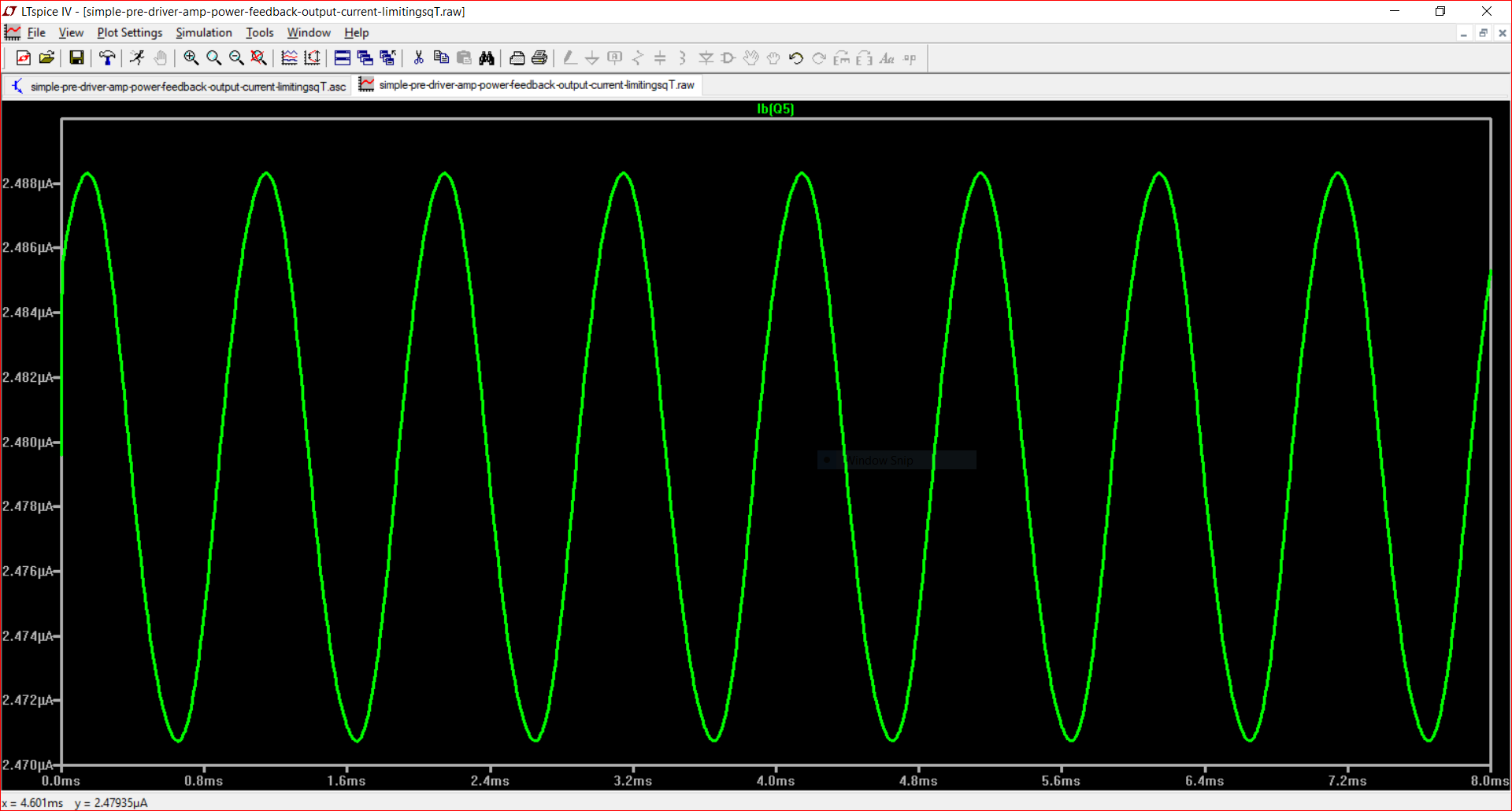

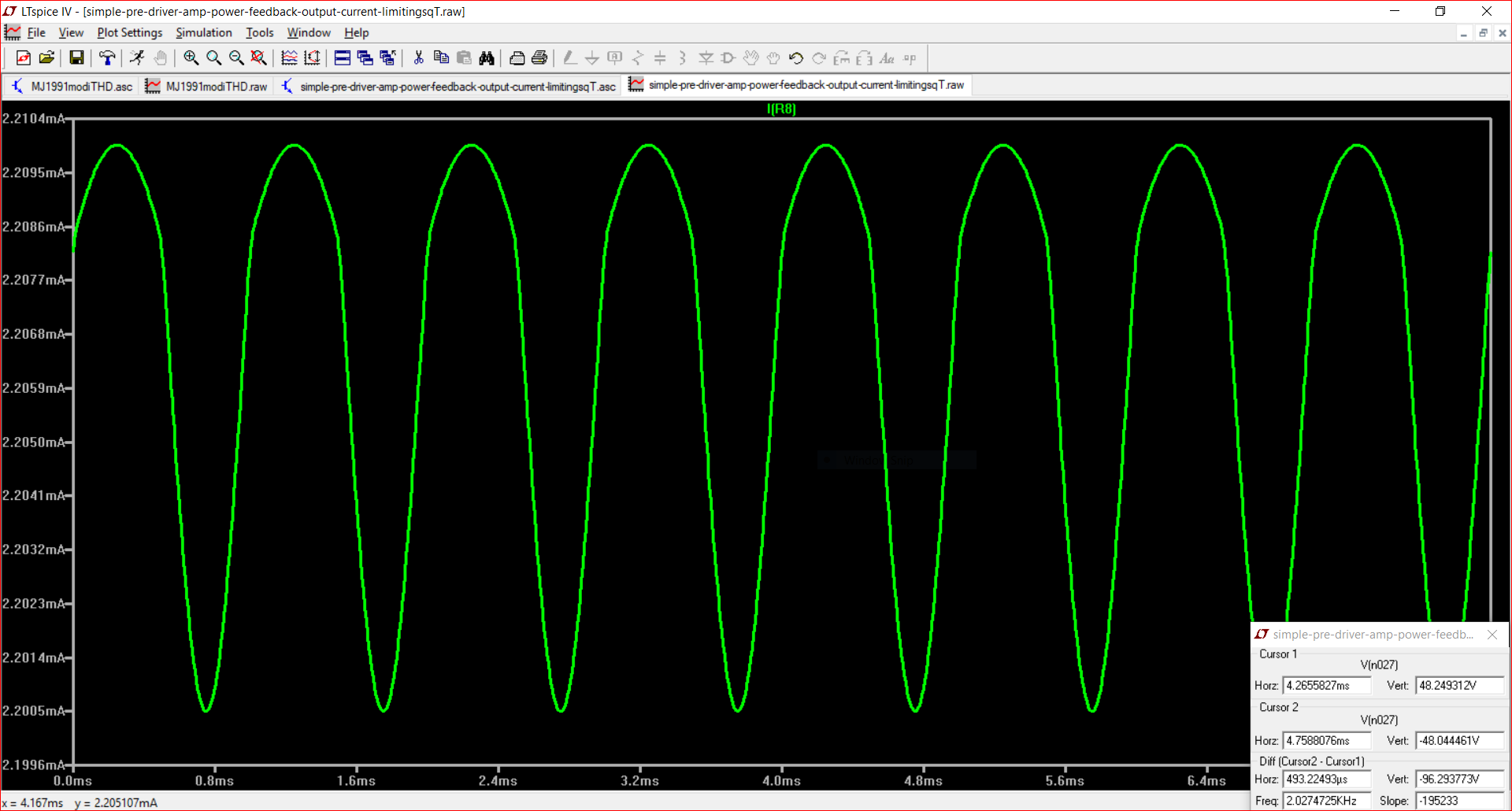

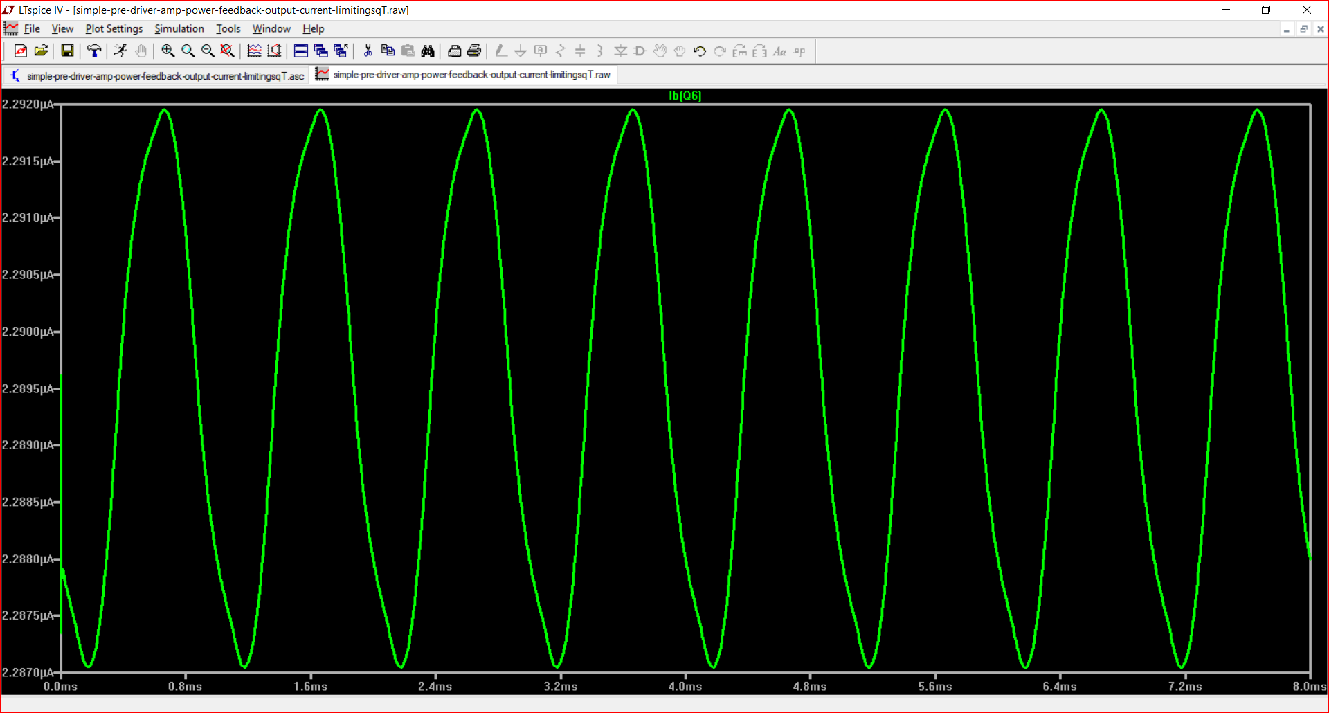

I looked at these in a 1kHz sine wave simulation to study the impact of R31 on the operation since this configuration departs from normal practice where the results for both transistors should look alike. The tail current plot also does not resemble a sine wave as it should.
On the question of using the op.amp it appears this is further away from the transformer than the power amp boards and being small it should be relatively easy and make sense to shield this and use the gain of two to reduce the closed loop gain of the power amp boards which are more at risk due to proximity with the transformer.

The three graphs for the input tail current become accurate sine waves when the three diode chain of the VAS is disconnected. Since, these three diodes are forcing the differential pair to depart from conducting a sinusoidal current when a sinusoidal signal is applied, it seems the source of trouble may be linked to them.
Thank you so much for this valueable diagnoses.

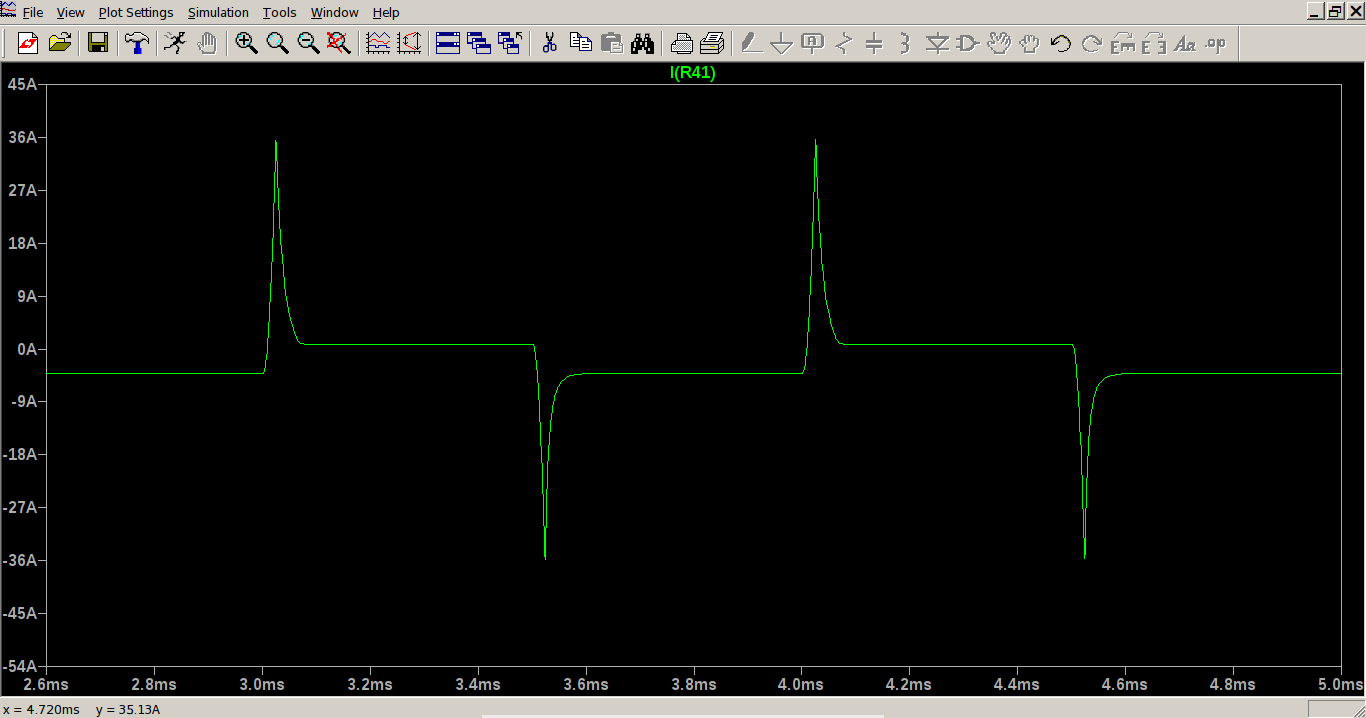

Calculation for power dissipation when the output is short-circuited.
Assuming a maximum power of 650W into 2 Ohms:
P = I^2*R/2 (calculating for a pure sine signal)
==> 650 = I^2*2/2
==> I = sqrt(650)
==> I = 25.5A peak
Let us assume short circuit protection limits the short circuit output current to 27A.
Simulations show this current is a square wave implying the equivalence of DC:
Therefore, the power dissipation on short circuit of the output would be:
P = IV (DC power output)
==> P = 27*80
==> P = 2160W
This power is shared between 16 power transistors, therefore the dissipation per transistor would be:
power/transistor = 2160/16 = 135W
The thermal power rating of 2SA1943 and 2SC5200 is 150W. The result is within limits.

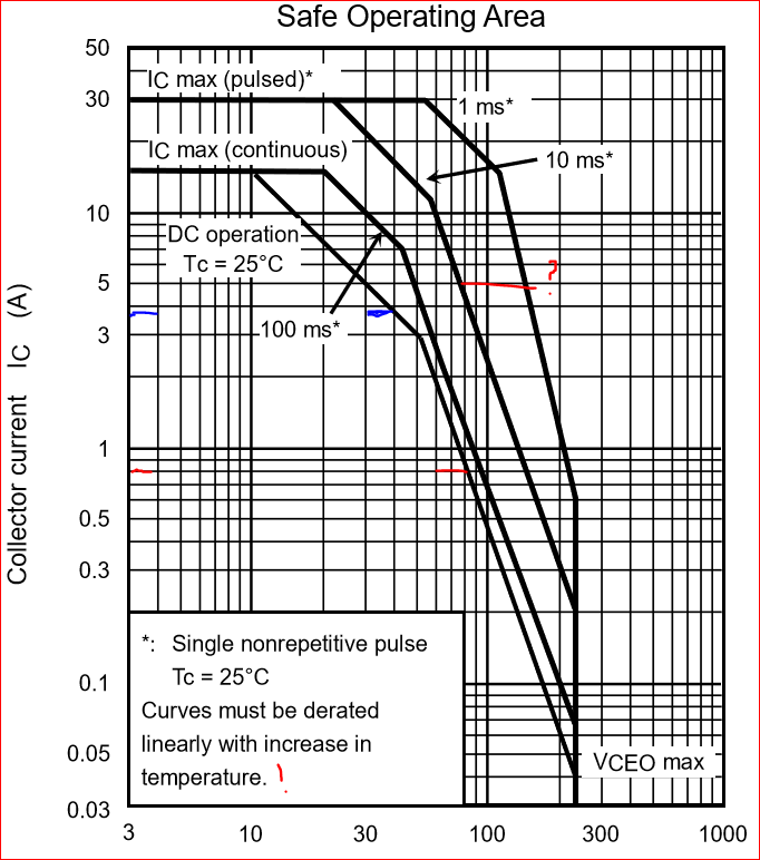

Don't rely on that. The graph for the safe operating area of a 2SC5200 attached shows that with 42 volt rails your IC can be close to 4A per each. With 80 volt rails you are down to 800 m.A. which implies to deliver peak currents exceeding this amount one is relying on a delayed action protection sufficient to allow these to pass before the limiter prevents the output stage from getting outside the safe operating area.
You should run a DC op pnt simulation to ensure the safe limits are not exceeded with various test loads including a short. Check the currents across the 0.1R resistors are not passing damaging levels of current - possible if the output halves have differing bias currents in their respective chains.
I made a mistake. Calculations require a crisp mind fully aware of all details, and due to my not so youthful age, I forgot.
Each amplifier channel has 8 power transistors, not 16. So, the estimated thermal power dissipated per device is twice what I calculated. This is far outside the safe operating area.
Recalculating for a 25A peak current when the short circuit protection is active, the thermal dissipation per output device is, V*I = 25*77 = 1925W. For eight output devices, this is: 1925/8 = 240.6W.
At this point, the crucial question is, whether the actual short circuit current limiter provides protection for the output devices, and for how long? If we are beyond the manufacturer's thermal dissipation maxima, it means, the output devices' thermal channels cannot efficiently transfer that thermal energy quickly enough to deter temperature from rising catastrophically. This is my reasoning, but sometimes, even apparently very logical reasoning may not mirror what reality may have in store.

I was taking the safe operating power of power transistors too simply. Since thermal runaway is very real, Vce is a dominant limiter, as more voltage mean, a stronger electric field across the junctions, which pulls off more electrons across them. There is also the limitation of impurity non-uniformity of the transistor silicon die itself. The latter imperfection, gives rise to localised high current paths that generate too much heat per unit volume with the consequence of localised silicon die damage.
The secondary breakdown is due to the positive tempco of current flow at a given Vbe - the hotter areas have more current flow and thus get even hotter, no non-uniformity is needed initially, just random fluctuations which are always present, but of course real devices will have some non-uniformity.
Secondary breakdown is more of a problem with large power devices where the die is larger, allowing temperature differences to build up. Its the main reason output devices are paralleled, rather than using really big transistors. Emitter resistors allow fair current sharing between devices and prevents secondary breakdown between devices (where the hotest device hogs most of the current).
