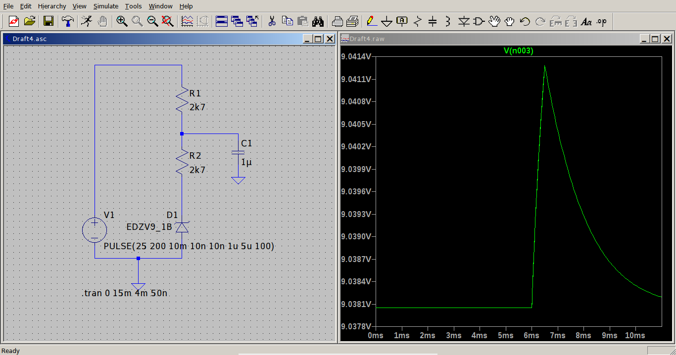

Looking at one of your simulations, the bias network for the cascode has a 10k resistor feeding about 7 mA from the positive rail into a 12V zener diode D3.
If you add a 100 uF capacitor in parallel you create a low pass filter effect on the positive rail and by-pass the noise generated by the zener.
The simulation does not include any allowance for ripple on the supply rails and you don't want any of this in the collector current of Q5 at the start of the amplification chain.
Simulating for the input and VAS bias chain, the attached results were obtained. Clearly, the bias chain adopted by Dougles Self for his Blameless Amplifier has a far superior performance to mine. I am attaching both simulations for comparison.
In the extreme, I can still adopt Douglas Self's two transistor bias together with the centre tapped risistor chain plus 1uF capacitor to ground.

I suggested the 100uF addition as an addition you could test on the actual hardware to see if there is a subjective reduction in the hum. You have not given an answer on this.
Earlier I had suggested the inclusion of an RC filter in the positive rail which according to simulations would have positive impacts on ripple and distortion by cleaning up the supply to the small signal stages. Again there is has been no answer on whether you have tried this out in your hardware or not.
A reported reduction in ripple on the positive rail to about 500 uV seems to have been forgotten in your latest simulations where this has jumped to 25V - a figure which seems to have been plucked out of the air.
The low pass filtering factor of D3 12V zener with 100 uF in parallel can be increased by making R2 =33k which would reduce the current and noise in the zener.

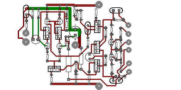

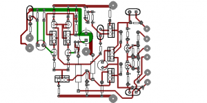

I am attaching the PCB layout for the input stage and VAS. The ground loop I mentioned earlier in this thread is shown in green. This has a radius of around 3cm and the PCB is less than 4cm away from the transformer. The non-inverting input is on the left hand side. I am thinking about breaking the base track of the non-inverting input to use a thin wire, and route this wire along the right hand side and top of the green track until it reaches the input filter. The other end would be soldered to top end of the broken track. This way, I am hoping to get two conductor segments with equal and opposite voltages induced by the leaking magnetic flux. If I also break the green ground track at the top left hand side just before the input filter, I can use a thin twisted pair of wires and take ground contact from the ground connection of the large feedback electrolytic capacitor. The other end would be soldered to the grounded beginning of the input filter. Instead of a thin twisted pair I can also use a thin coaxial cable like those used for VCRs.
Together with the above, I will separate the signal ground and power ground with a 10 Ohm resistor as recommended.
If these mitigations prove insufficient, I will re-examine the points from where I can take power from the power supply section.

You could try rearranging your nfb divider arrangement to fit with your simulation file.
I should have said arrange your nfb divider along conventional lines. Forget about that for the time being.
Anyway looking at the image you posted I did not see where is the RC decoupling of the supply rails shown in the simulation attached to post 482.
Without these you will have some ripple passing through the bias resistors for your input stage which is not helped by using values suitable for amplifiers running off low voltages supply rails and with 80V rails passing several m.A. where the need is measurable in u.A.
A couple of resistors in your image are physically large to bridge wider spans on your pcb. It seems these could be wire-wound types - if so change them.
The RC rail decouplers are on another small PCB that is bolted to the PCB I attached.
The physically large capacitors are 3W metal film types.

The ground current path from your cascode zener diode ZD1 reference connects through the 0 V for the inverting and non-inverting input. This should be vice-versa.
I note this network ground is close to the nfb decoupling capacitor so connected the resistance between these two points in comparison to that from the network to signal ground has to be considered 'susceptible' in terms of micro voltage drop seen as a voltage signal.
I have commented previously about the use of zener diode biasing. It should have a capacitor in parallel to pass the noise this generates to ground.
Better still would be to bias the cascode via a resistor divider with a parallel capacitor to augment the filtering of the RC in the supply rail.
