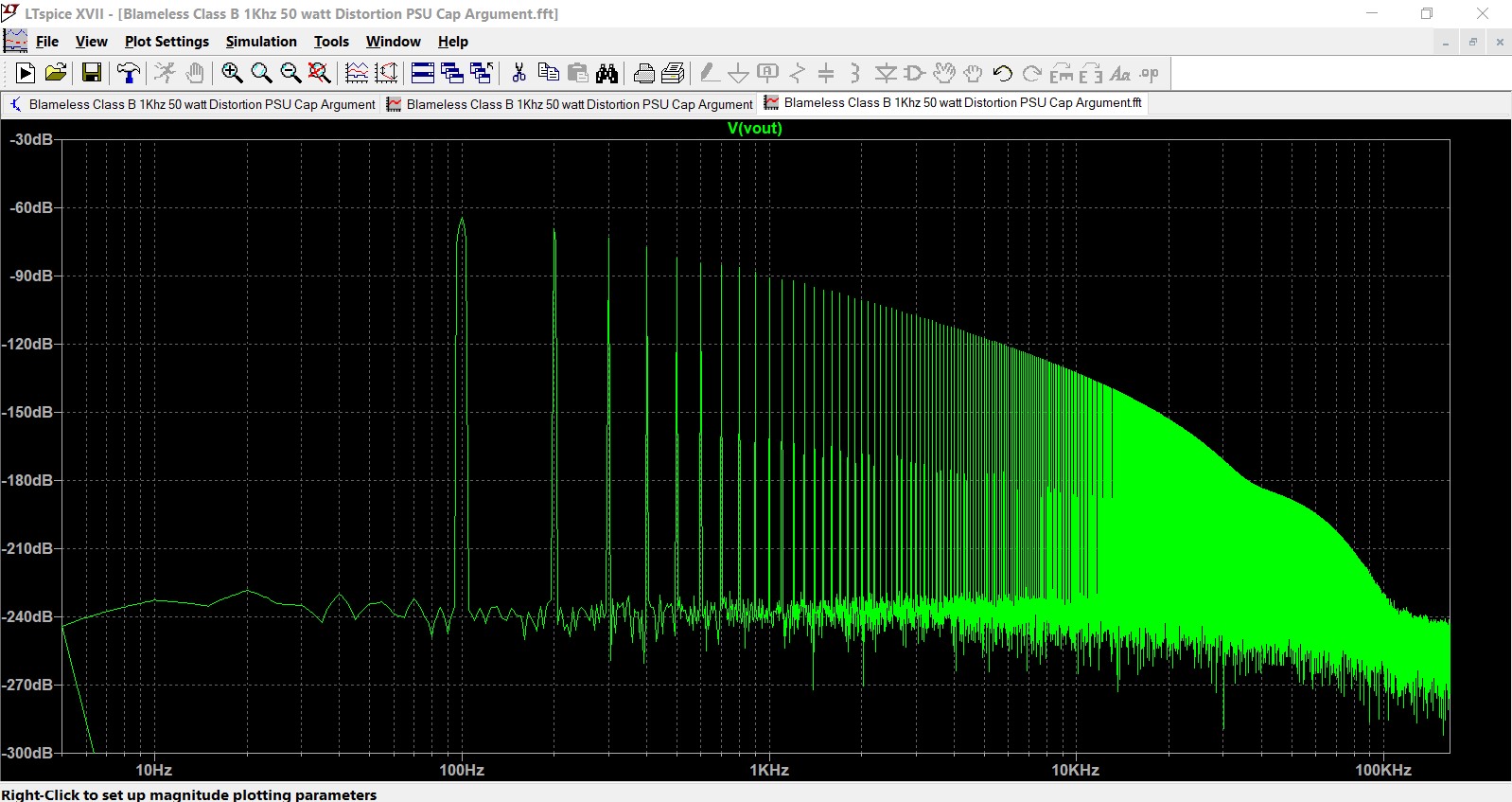

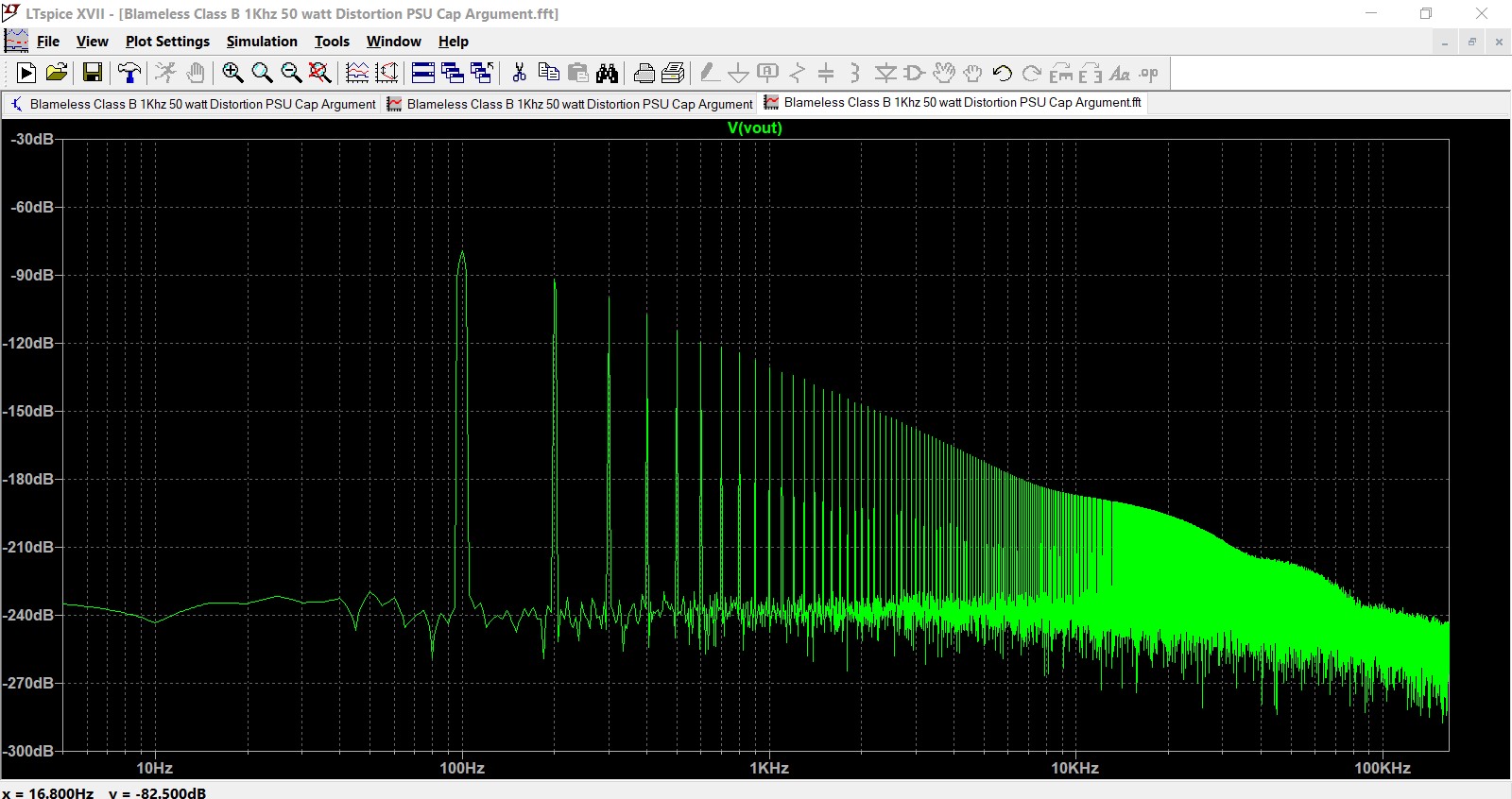

I am trying to avoid having to use additional 100V, 1000uF capacitors to keep down the costs and to avoid mounting problems. The space inside the amplifier box is getting limited, therefore, I am seeking other ways of decoupling the power supply. Using a diode-resistor-capacitor arrangement seems to work with a much smaller capacitor. However, the ripple at the output has increased by 250%. Using a slow speed mains frequency rectifier diode, has the additional side effect of being unable to pass high frequency interference signals. This side effect complements the filtering ability of this simple filter.
With four axial 100V, 100uF electrolytic capacitors, four ordinary rectifier diodes and four 100 Ohm resistors, these filters should be possible to implement without additional mounting and space problems.
I have omitted the 100nF capacitors. If their function is necessary, please post. I am attaching the resultant circuit.
The purpose of those 100nF capacitors must be to shunt any RF signal incoming from the mains and rectifier brige. Having a rectifier bridge presents a stream of wave trains at 100Hz which explains why my ear picked that frequency. Since the amplifier was never tested on load, the power supply ripple itself should not be the cause, as without an amplifier load, it should be negligible.
This reasoning is telling me, I can filter this interference with yet smaller electrolytics, but with the latest arrangement, and the 100nF capacitors.
Decoupling can also be to prevent turning the amplifier into a high frequency oscillator. The power rails can act as feedback paths if not adequately decoupled. For peace of mind don't remove rail decoupling in a power amplifier without thorough stability testing, oscillation at full power will do a lot of damage.

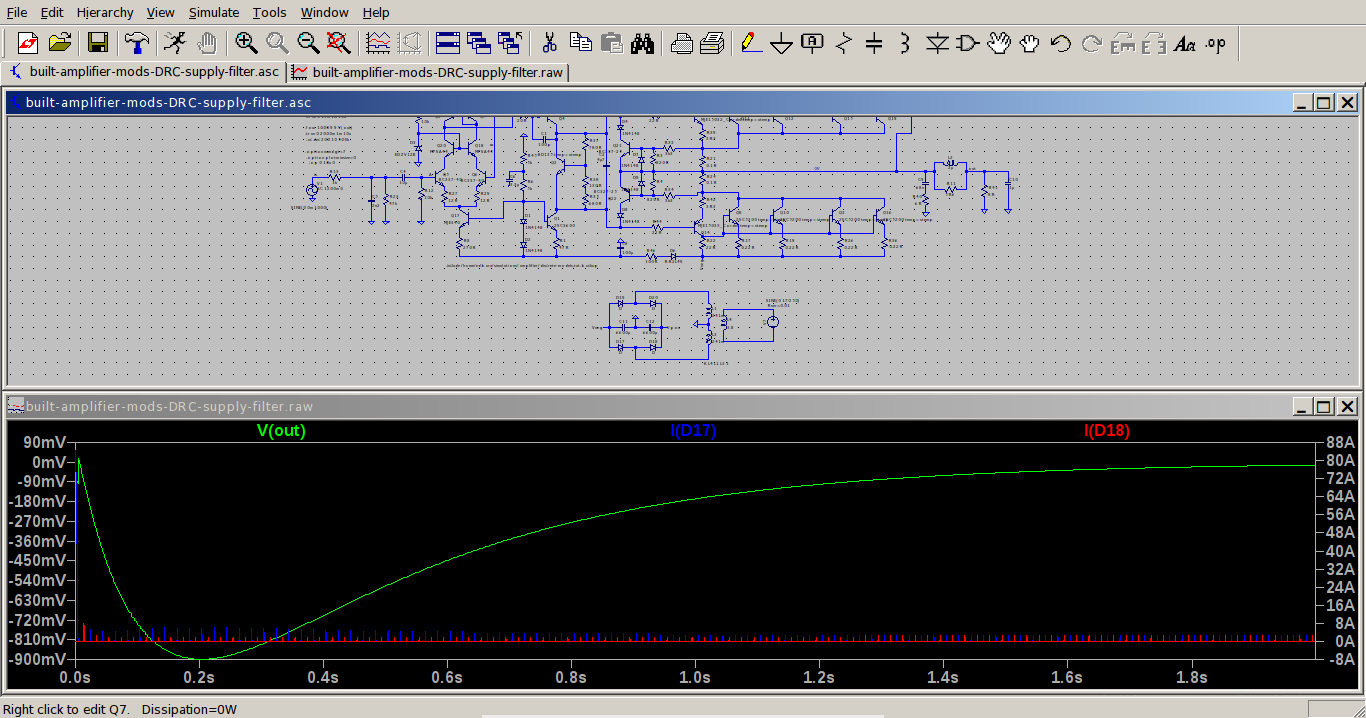

I removed the DC voltage sources and replaced them with a rectifier bridge, and two AC voltage sources to mimic the action of the toroid's secondary. LTSpice is NOT capturing any RF interference signals at the rectifier diodes, and the current curves are very smooth, implying good simulation resolution. The output is also very clear of interference. This is making me conclude it is the mains supply that is the real source of this interference. Where I live, many people do not careless about not polluting the mains supply: that is totally alien to them. As long as their appliances do not break down, and as long as their electric motors work, it is all right for them. This means, I need to create an interference source with frequent, but random bursts of frequencies as seen on the oscilloscope.
As you can see, I am very reluctant to start modifying the amplifier before studying in depth the cause of this issue. Simulations show that the actual ripple with no load is 200mv peak to peak, which should not cause series issues like this. Also, the fact that at some times, there was no hum, corroborates my conclusion that it is the mains supply that is causing all this. At present, around my home there is a building frenzy with electric crains that use relays that can be heard clicking from over 100m.
Modifying further the DRC filter to use two 100uF capacitors one directly after the diode and another one after the resistor, resulted in a ripple reduction of 17/0.2 = 85 times. The amplifier's power supply was simulated with a 2 Ohm resistor connected from rail to ground on both rails to simulate extreme loading. I am posting a screenshot of LTSpice with the output and Fourier Transform.
Post Scriptum:
Adding a 100p capacitor immediately before the rectifier and two 1uH inductors at the secondary windings' output resulted in heavy 2000Hz charging current oscillations with an amplitude of 60A. The output still seems immune to this according to LTSpice.
I will further increase the frequency to see what happens to the output.

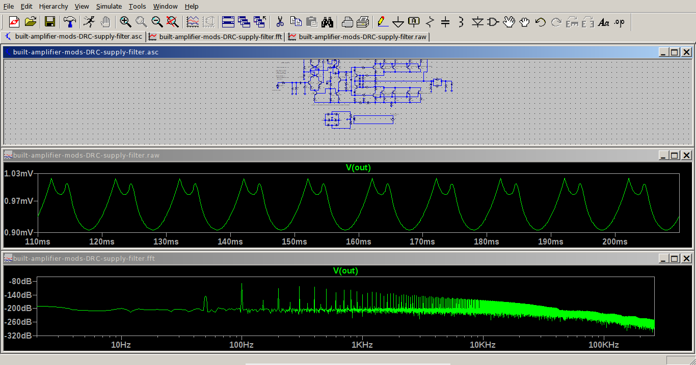

With the filters in the circuit attached to this post, I am getting these results:
One such filter is shown. It is made up of C7, C15, C13, R47 and D5
Rail ripple (intentionally made huge): 41.8V - 25.2V = 16.6V
RF voltage superposed on -ve rail: 50mV @ 200kHz
Results (after filters):
Minor rail voltage ripple (for sensitive parts): 1.02mV - 0.91mV = 0.21mV
RF voltage: 1.09mV - 0.81mV = 0.28mV
RF attenuation factor: 50mV/0.28mV = 178.6
Ripple attenuation factor: 16.6V/0.21mV = 79.0
RF attenuation in dB: 20*log(178.6) = 45dB
Ripple attenuation in dB: 20*log(79.0) = 38dB
