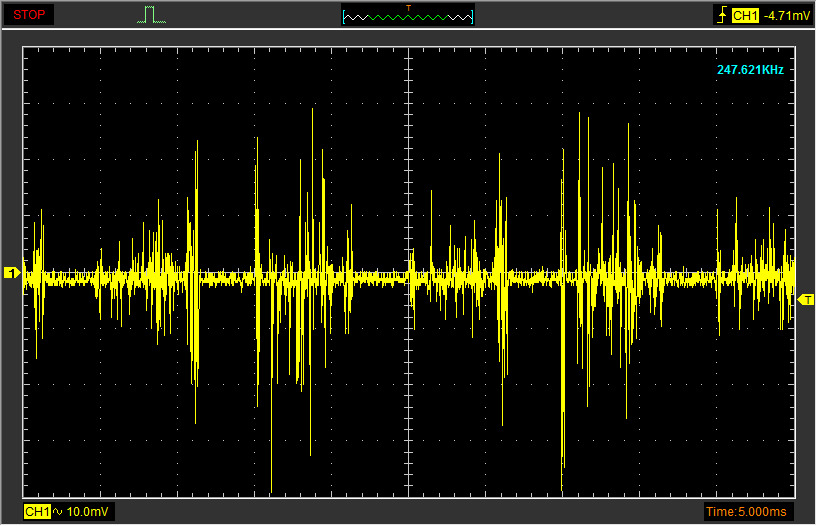

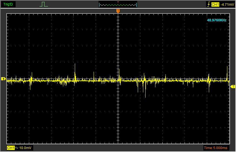

The oscilloscope is USB type model Hantek 6074BC.

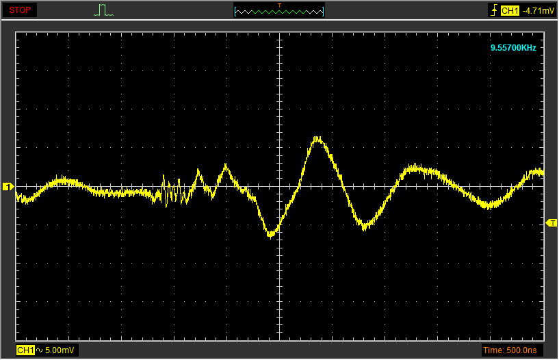

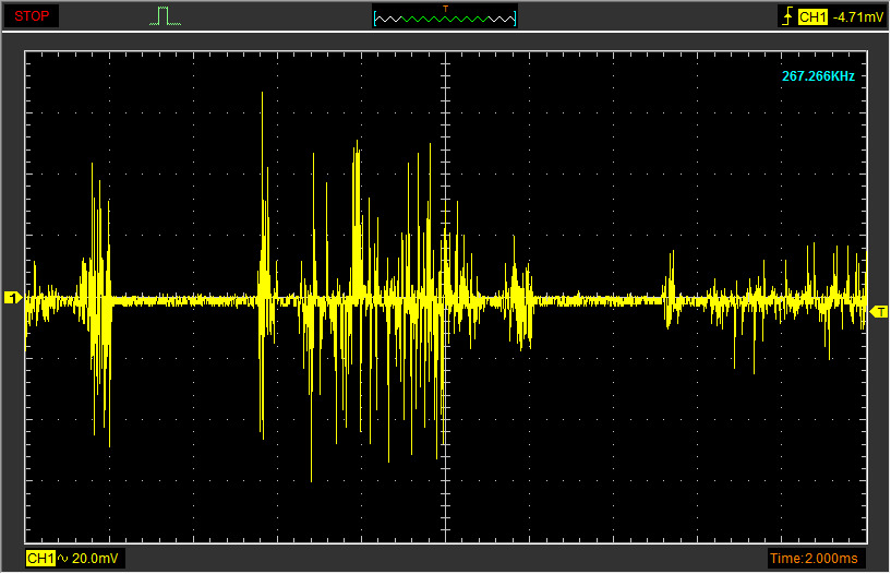

Testing is pointing in the direction of amplifier self oscillation. The supply ripple seems to be triggering this behaviour as the audible sound is like a 50Hz mains hum.

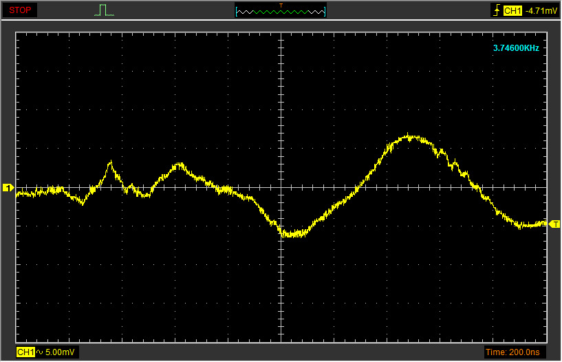

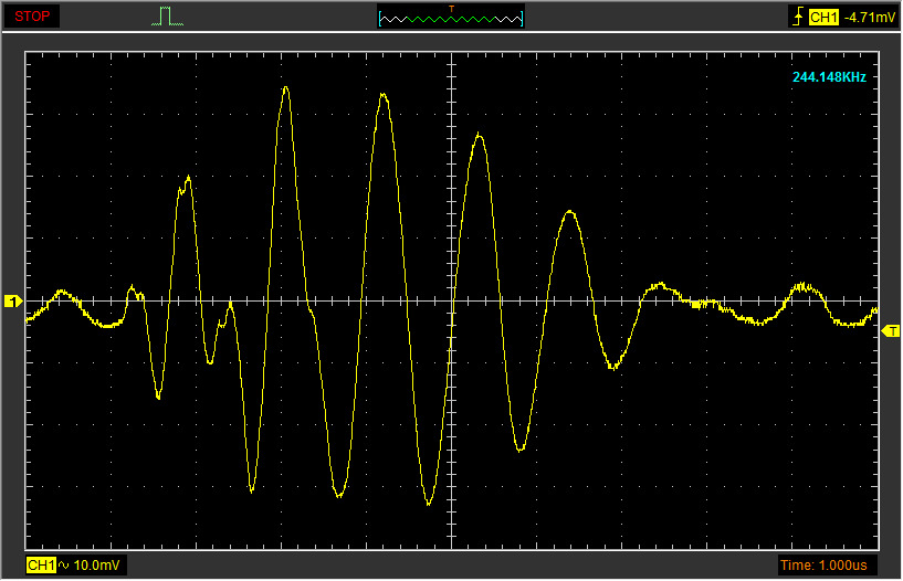

I am attaching various images of the scope's window at different time bases. The patterns continously change although the jpg images are static. I am also attaching the scope's image with the amplifier turned off. The output isolating and coupling component is a 3cm ferrite ring with 8 or 9 turns as primary and secondary. The high noise level with the amplifier turned off may be explained by the ferrite toroid picking stray radio signals.

Toroids are very immune to pick up, you may be seeing the wiring pickup between amp and toroid when the amp is off. Yes there's a strong resonance there around 1MHz.
But this might be the toroid inductance resonating with the scope input capacitance - its normal to just use x10 probe direct to the output
The amp may be oscillating with the ferrite, 8 turns on a suppression toroid is a near short at audio frequencies. Just use a x10 probe at the speaker output.

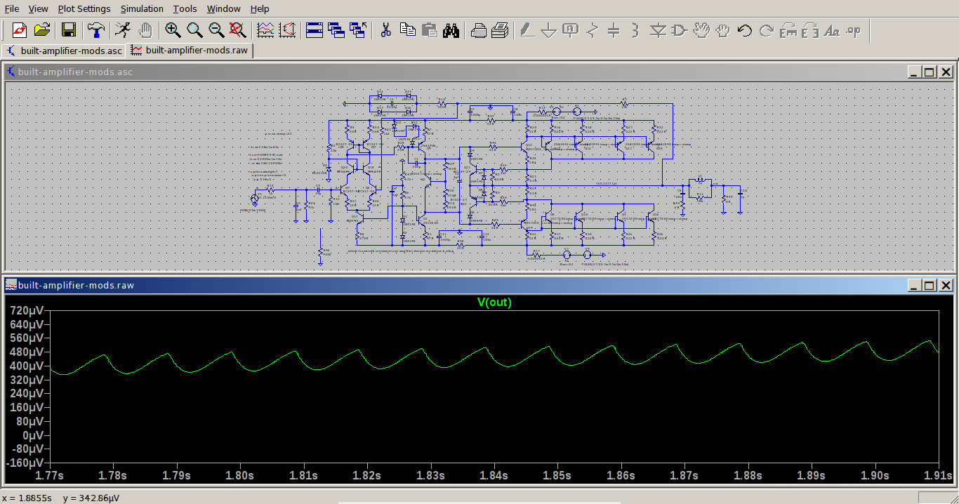

Thank you so much. This is much much better than before. Using 20*log(psu_ripple/output_ripple) I got 100dB! If this formula is the right one, the amplifier is exhibiting a power supply rejection of 100dB.
I am attaching a screenshot of ltspice while simulating this.
That looks better. The spray of harmonics I mentioned occurs when switching on half cycles radiates in the ether. Another example of this is a car ignition coil without any suppression. A neighbour somewhere close by has a lawn mower that interferes with TV reception. You should consider the other two suggestions I made in relation to the toroidal transformer.

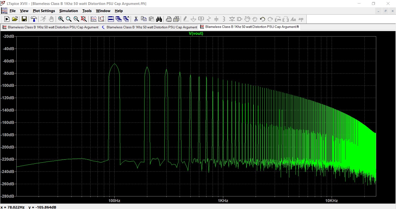

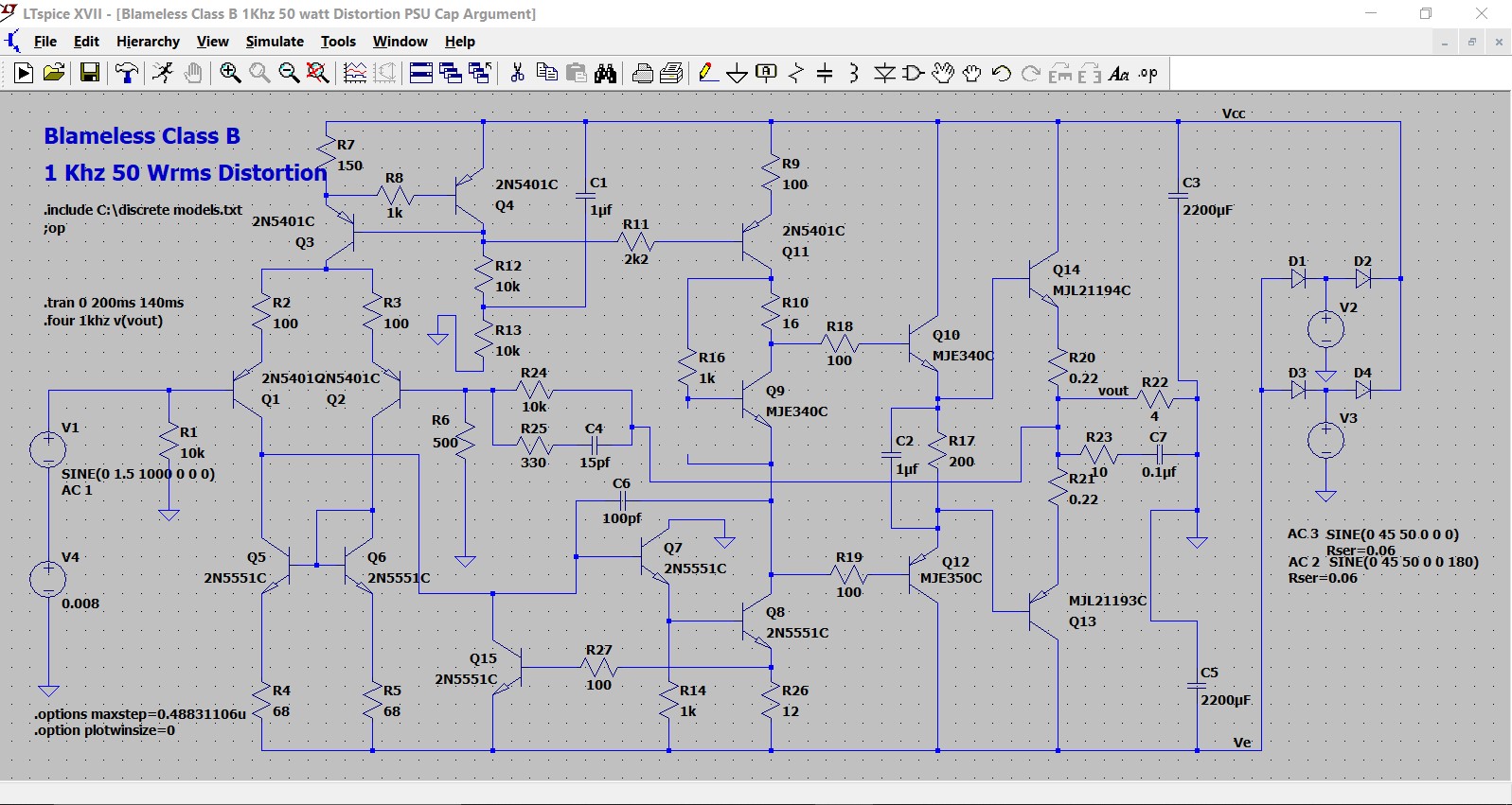

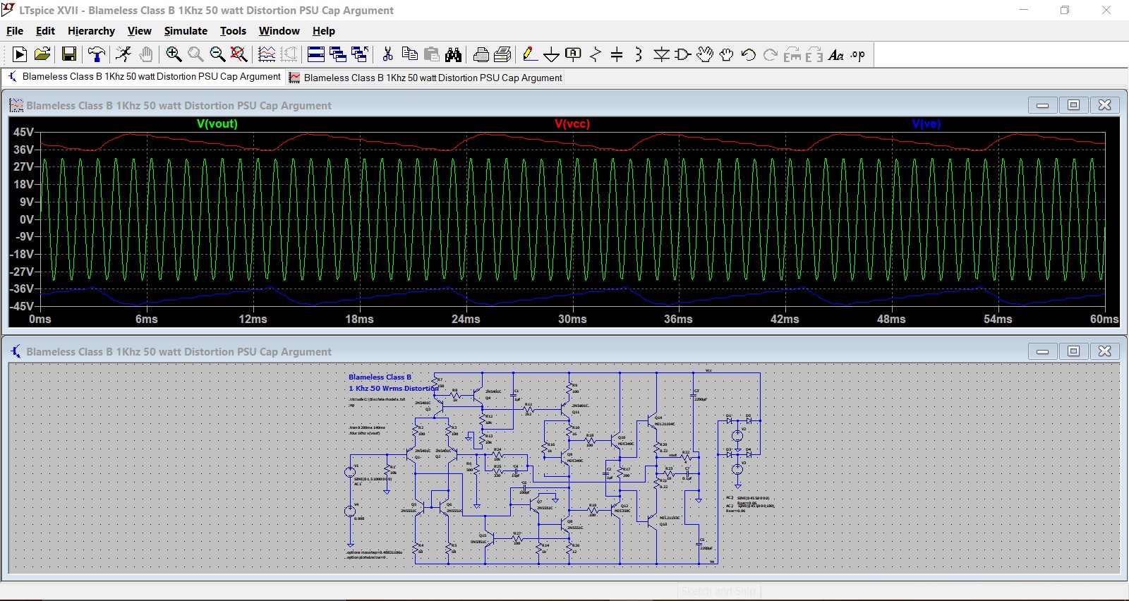

Have a look at this with the power supply set up as a 'real' AC supply.
The amp is running at close to maximum output and the reservoir caps are just 2200uF in order to generate lots of ripple.

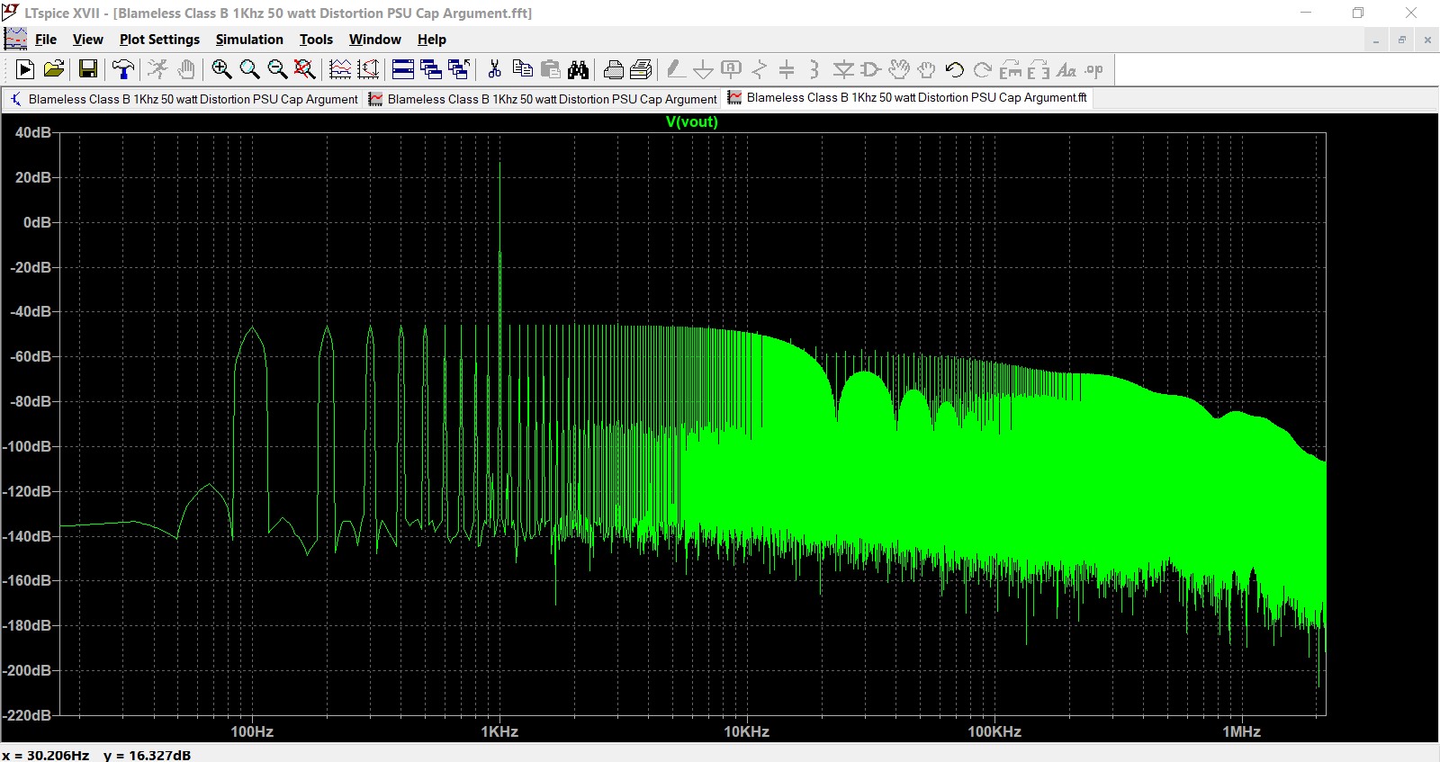

If we look at the FFT of the output we can see the ripple component superimposed on the amplifier output.
You could also load the rails with a resistor to introduce ripple and then look at the amplifier output with no signal applied. That is the last image and the rail ripple is almost 10 volts pk/pk per rail (20 ohm loading on each).
Simulating like this assumes perfect grounding which of course the real amp will not (can not) ever match.
