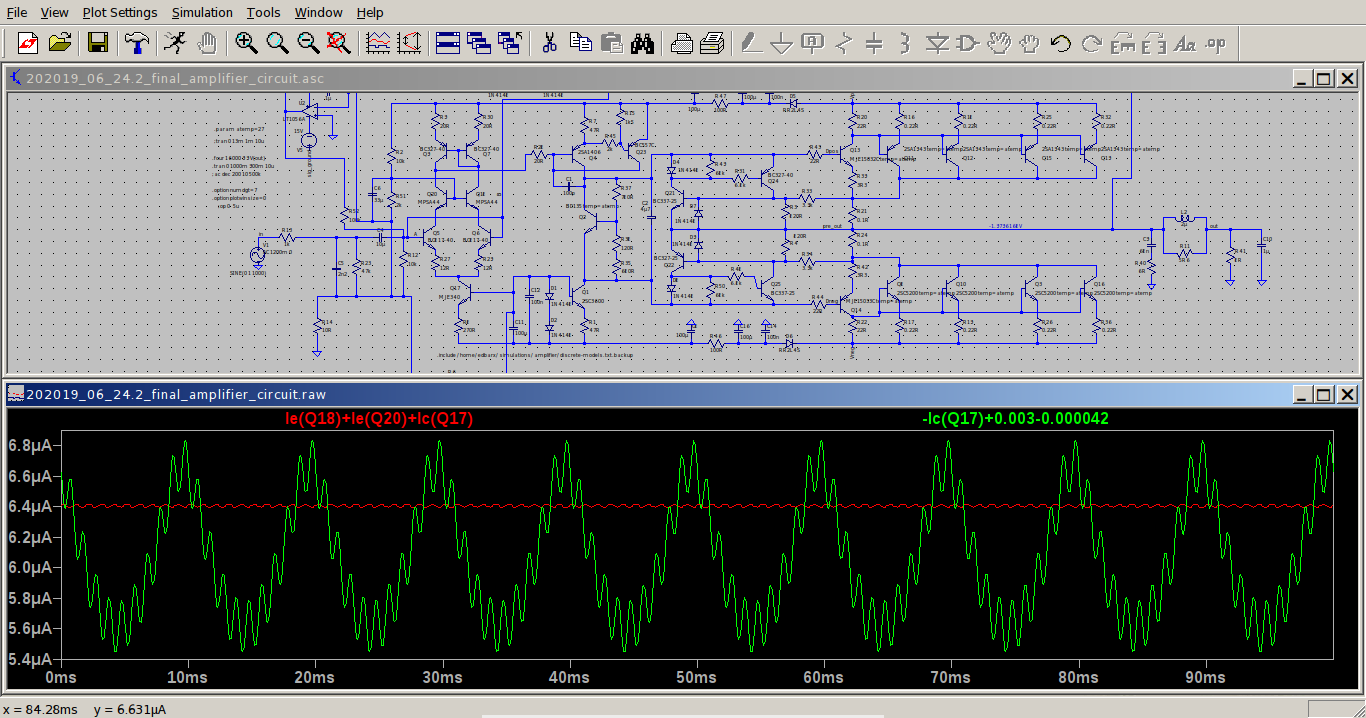

What happens if you make C6 1000µF - removing ripple from the bases of the cascode. Normally a cascode would be regulated anyway with a zener or LED to help reduce rail artifacts getting to it.
According to LTSpice the input stage's current source is very stable. With these simulations I am getting only a 1uA variation in its output current which translates to 1/3000.
The only current path besides the input stage's current mirror is through the differential pair's bases. However, current has to pass in the opposite direction to what it should under ordinary conditions. If this is true, the only reasonable conclusion is the differential pair's base-collector capacitance. This capacitance is being partially charged and discharged as a result of the rails artifacts and hum.

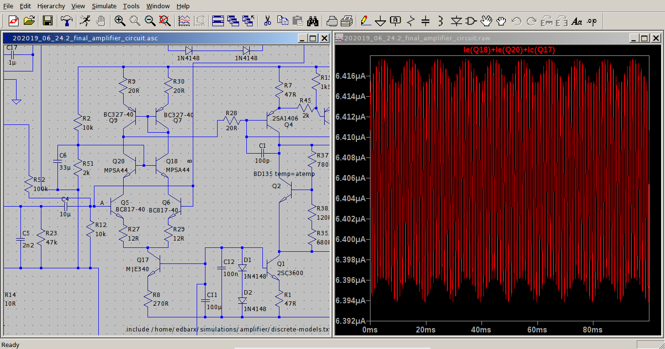

The mains hum, or better 100Hz buzz, can easily be seen in the attached screenshot. This was obtained by adding the cascode's emitter currents and subtracting the input stage's current source's Ic. Due to the negative sign of Ic, I had to use an addition. Nevertheless, this should be easily to grasp.
The amplitude of oscillations illustrated in the screenshot is the sum of base currents feeding into the differential pair's bases.
The golden question here is: Why am I getting a 100Hz signal superposed on the legitimate signal?

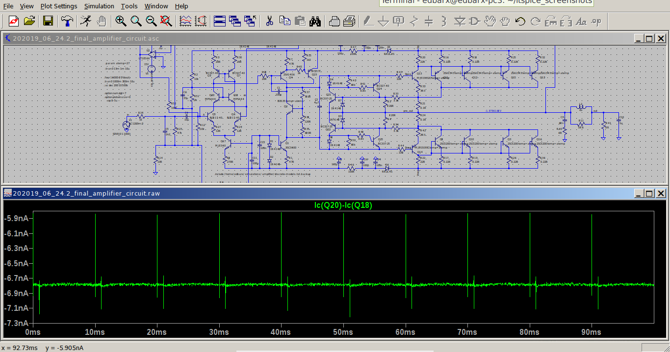

The 30 minutes edit time expired. So, I will have to post here:
The second screenshot shows the difference between the cascodes' emitter currents and the current mirror's Ic. These almost cancel out. The green trace is the current mirror's Ic. The modulating mains buzz is clearly illustrated.
The third screenshot shows the difference between the cascode's Ics. There are spikes in synchrony with the start and end of smoothing capacitor charging.

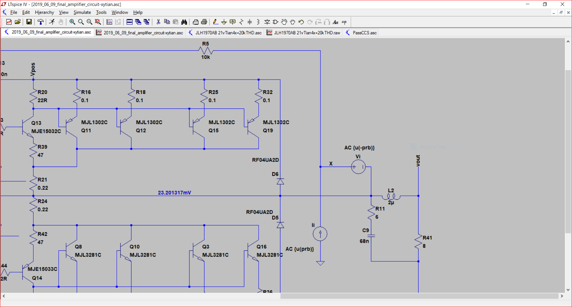

Given the persistence of your problem it would be worth paying the money to get the full articles. I have run a Tian simulation test which shows you have ample phase and gain margins even if your Miller capacitor is reduced from 100 pF to 39-47 pF.
Such reduction is made possible because the closed loop gain is 56.55 which places the unity gain point at 244 kHz which is very low by most standards.
There is about 3dB of mound of base boost below 100Hz which is rather strange.
I have attached the symbols and connections for a Tian plot so you can do your own investigations on your latest update of the simulation.
To use this you have to replace the expression for Vout with -1/(1-1/(2*(I(Vi)@1*V(x)@2-V(x)@1*I(Vi)@2)+V(x)@1+I(Vi)@2)) by clicking on that header in the plot. I usually copy this and put it at a convenient space on the .asc file and change the status from SPICE directive to Comment.
Select the two cursor option and drag one to 0 dB using the side arrow keys for fine adjustment Do do likewise for the second cursor placing this as close as possible to -180 degrees. Read off the stability margins in the box at the bottom.

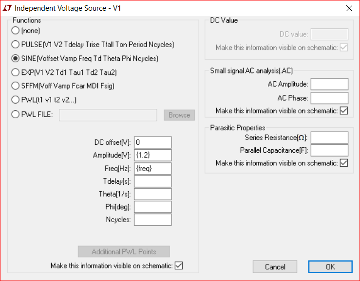

Pasting the given expression and pressing OK, displayed a dialog complaining: "Invalid @step resquest" and "This data does not contain steps".
Sorry but had a commitment to attend to this morning and in a hurry to finish that last post. You need these commands copied in two blocks - I have attached a text file to make it easier to copy these into your simulation.

Added the two lists of commands and parameters. Processing took around 20 minutes to complete. Pasting "-1/(1-1/(2*(I(Vi)@1*V(x)@2-V(x)@1*I(Vi)@2)+V(x)@1+I(Vi)@2))" in the plot window selector, I got a Power (KW) vs time graph. The LTSpice error log contained the error "Unknown parameter 'u'".
