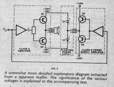

My idea?
You obviously have not actually read the AES paper I linked to describing the Technics patent. This is not my idea, it is a proven design topology developed Technics in the late 70’s.
I really can't make sense of what you are trying to say. If the slew rate of the class B amplifier is reduced relative to the class A amplifier then the class B driven floating rails (which are only for the class A output devices) will not track the output voltage on fast transients. And I really can't see how the "miller capacitances" (please don't be too specific here) can cause the symptoms you describe.
Pictured below is a simplified block diagram of the high power amplifier Technics manufactured using this technique – the global negative feedback for each separate amplifier was not curtailed in the least.
A much better diagram showing the GNFB connections of each seperate amplifier exists in the AES paper, along with a thorough explanation and performance measurements of a prototype amplifier.
Here is the title and a link to the AES paper again:
"High Efficiency Class A Audio Power Amplifier"
(CLASS A+ AMPLIFIER)
AES Preprint no. 1382 (N-5)
Presented at the 61st Convention
November 3-6, 1978
http://www.aes.org/e-lib/browse.cfm?elib=2972

These "switch mode assisted linear amplifiers" are quite a different topology to the Technics A+ tracking rails concept.
The amplifier I am building is in a somewhat different league than those amplifiers, both in terms of power output and THD.
Glen
Yes I know.
I suppose that this http://www.pat2pdf.org/patents/pat4115739.pdf is the original patent.
I just pointed some published switched-mode ways to help in the efficiency problem.
Surely the concept is not the same, but is easily modifiable.
The point is that you are avoiding any switching phenomena in the analog domain, like the ones in class-G solutions.
This could be another solution: http://www.diyaudio.com/forums/showthread.php?threadid=82550
Anyway it seems a very complicated replacement for a single power cascode circuit like this one:
http://www.audio-circuit.dk/Schematics/Treshold_800A.pdf
