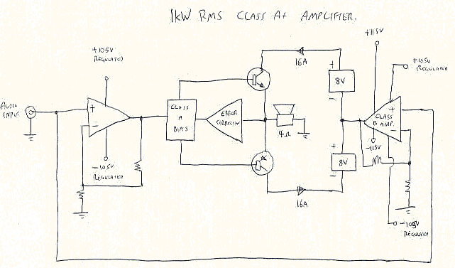

Major design update:
After banging my head against the wall the last few nights, trying to work out the best way to layout all the power circuitry on my big heatsinks, I’ve decided to abandon the excessively complicated bridged topology and to take a route I’ve been contemplating for quite a while already.
On these long heatsinks, a single-ended topology will be much easier to implement.
Another benefit of going single-ended is that only one class-A power output module with floating supply rails will be required for each channel (instead of two).
This means that, for a given output power, the class-A dissipation is half that of the bridged design.
In other words, by going single-ended, I’m able to have twice the power output with the same idle dissipation of the bridged design.
My amplifier is now rated at 1kW rms (continuous sinewave power) into 4 ohms per channel.
So it’s now: “MY 2000W CLASS A+ AMPLIFIER”.
This will probably make the design a little more crazy in the eyes of some. I have upgraded the supply voltages to suit, and the required transformers are on order………
For now, a simplified block of a single channel appears below. Schematics will follow this weekend if I have time…………
Hartono said:
how about the power transformer ? must be 15 Kg ++ ???
All up it will be a lot more than that. I've ordered four 200VA EI (split bobbin - better primary-secondary isolation than a toroid) transformers to provide the floating supplies for the class-A stages. These weigh 2.8kg each.
A pair of 2kV toroidal transformers supply the class B stages. I don’t know what these will weigh.
There are also various little transformers for ancillary stuff.
Incidentally, whilst finalising the transformer order and looking into available electrolytic capacitors, I have revised the amplifiers rated power/load impedance again 🙄
The amplifier is now going to be built to deliver 1000W rms per channel (continuous sinewave) into 2 ohms, not 4 ohms. This is much more sensible, as a pair of 4 ohms speakers (or even a quad of 8 ohm speakers) can be paralleled to make a 2 ohm load. Ever seen a 4 ohm 1kW speaker in a HiFi shop 🙂 ) ??
The 2 ohm rating also means that the class-B supply voltages can be kept well below +/-100V (1kW rms into 2ohms = 63.2V peak). Electrolytic filter capacitors for supply voltages below 100V are much cheaper and easier to obtain.
Phew. I’ll get back to the (final?😕 ) version schematics and PCB layouts now.

Hartono said:
If you build it, probably you will be on world's class A hall of fame. 1000 watt class A :hot:
If????
Dude, I'm not going to make a BBQ out of those ridicuously expensive heatsinks! 🙂. The transormers are on the way, I've already got the one hundered 10,000uF 16V ELNA electrolytics for the filtering of the floating class-A power supplies..........
Stay tuned to this thread.......
Glen
