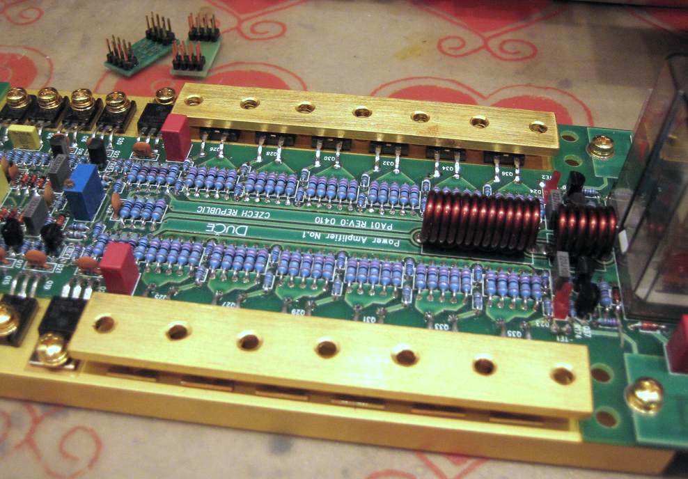

A completely solid attachment of the two metals might result in bending with temperature change - similar to a bi-metal bar in a thermistat.
Something to consider.
I'm interested in your design, but would like to try it on a smaller scale. 1Kw/channel is a tad high for my purposes.🙂
Keep up the good work.
Yes I know, this is a pain. Aluminium has an expansion coefficient that’s about 30% greater than that of copper.
I’m fooling around with the idea of using at thick sheet of copper, and building all the power output stages onto it as a sub assembly, which will be clamped to the aluminium heatsinks in favour of solid attachment.
Problem is that copper is very soft and malleable, so I’ll need a pretty thick sheet (say 8mm or so). I’m getting the prices for the copper next week. I’m a bit fearful of what I’m going to hear though, so the copper idea is still pending.

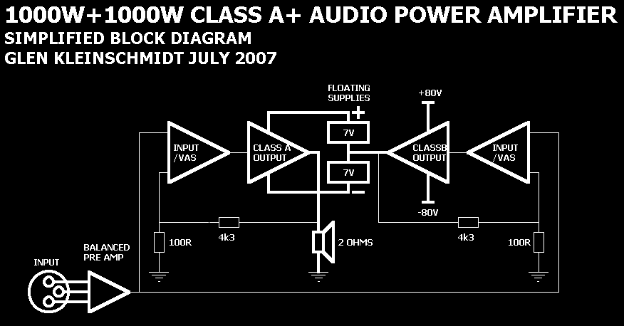

It excuses my ignorance but it would be pleasant to also see a block diagram of the whole amplifier.
Thanks. 😀
Here you go:
http://users.picknowl.com.au/~glenk/2000W.HTM

Upupa Epops said:Glen, look at " two pins " transistors, maybe something burn in your head... 😎
Yes, I know. The brass is at rail potential, connected to the drain/collector tabs......

Upupa Epops said:It is not brass, Glen, but vermeil of copper...
Sound like something from a recipe book. Like cream of mushroom................
