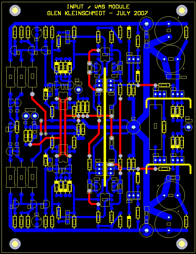

I’m not sure to what extent I am doing anything productive here, as the technical details of my project I’ve posted so far have been, more than anything else, responsible for inciting patronising dismissals based on dodgy presumptions by some who obviously have never seriously designed and built anything similar, but here it goes anyway.
I’ve finished the Input and voltage amplifier stage PCB:

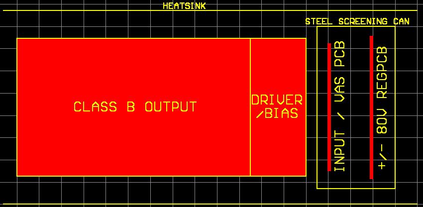

They say a picture says a thousand words, so here is one showing the physical layout, on a section of one of my big heatsinks as shown in this threads opening post, of a class B stage, using 3 of the modules described here already:
This is the section of the project I'm now proceeding to build and test first.
Cheerio,
Glen
Of course it's productive 🙂
You're just working in a noisy environment.
…They say a picture says a thousand words…
Sceptic?...
If you go behind 1Kw you REALY need a good layout!..
At least on class-G, the switching peaks could only be controlled with the layout techniques that Eva talked about, and some more…
In the pictures you have one of my “Many-Kw-and-Kg-Interleaved-Transistor-Madness” :clown:
But I think that all this talk is a little threadjack.
Maybe the layout you use is good enough for your project.
I have only one layout question:
From where do you sense the feedback signal on your big output cooper area?
