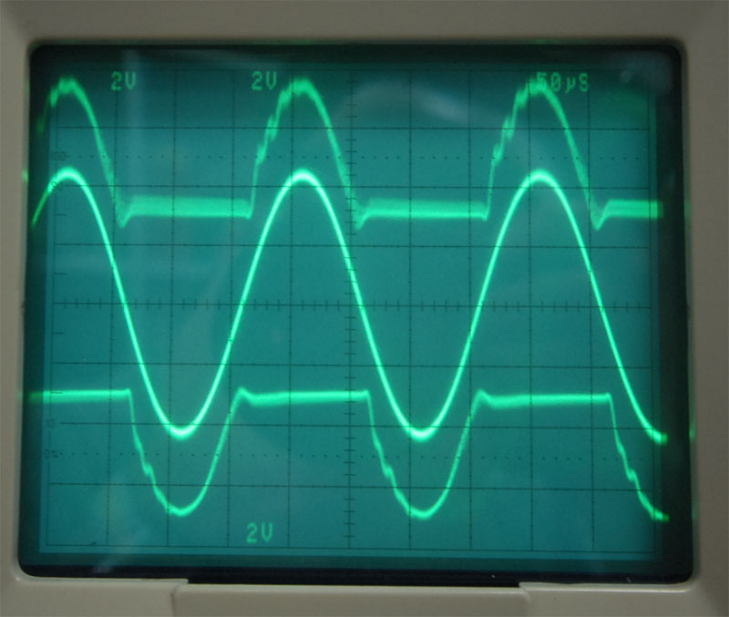

Alrighty, the Class B power output module schematic is now done (do not connect headphones here!).
http://users.picknowl.com.au/~glenk/MAIN.HTM (Input/VAS module)
http://users.picknowl.com.au/~glenk/CLASSA.HTM (Class A EC power output module)
http://users.picknowl.com.au/~glenk/80VREG.HTM (+/-80V Regulator)
http://users.picknowl.com.au/~glenk/CLASSB.HTM (1kW class B power output module)
Now onto the overload crowbar and protection circuits.......
Glen

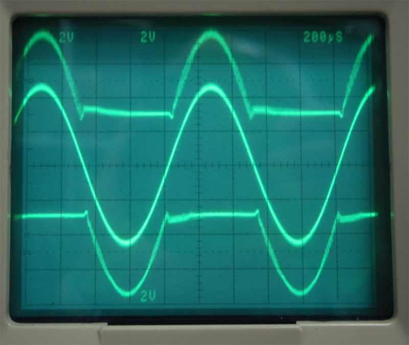

That's a class G amplifier. I've designed one of those as a series modulator for a class E AM RF power amplifier, which I have yet to build. I can post the schematic if you want.
Glen

Hi Glen
It seems a class-G, but it is not... or maybe it is.
I mean: it is a class-G but Switched instead of linear.
Now I realize that it is a completely new kind of amplifier! 😱
If you look closer, you could see the Hf residual on the 5KHz picture😉
TOINO said:It seems a class-G, but it is not... or maybe it is.
For what it's worth, I built a Class G with a Class A main output
stage amplifier in the mid-70's. It worked as you would imagine,
but the glitch when the "G" kicked in was larger than the notch
you would get on a Class AB. It was not worth the effort.
