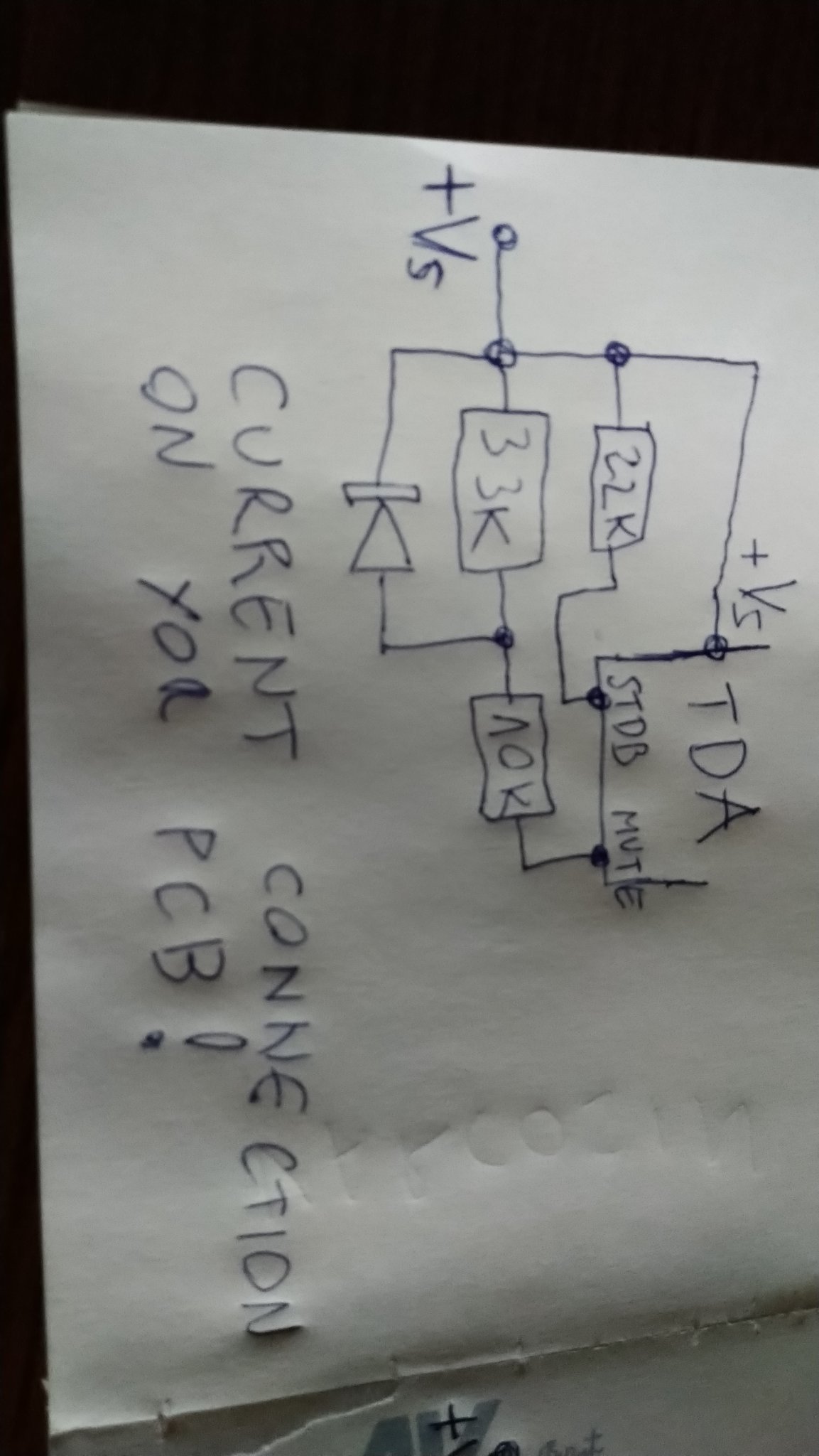

This folow my picture from previous post. I forgot to add 10uF capacitors but hope enought clear for understand

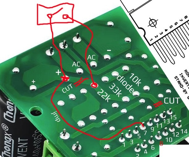

This is what you need to do (two cuts and one jumper wire from the positive pin of the capacitor to the pin7 of the TDA). So pin7 and pin13 of the TDA must remain connected to +Vs, (jumper wire), and mute & stdby circuity removed from +Vs (two cuts). Switch goes paralel at top cut. Thats all.
Right. So that's my next course of action, using one of the spare boards I have at hand.
I assume the switch can be a double pole one? One halve for the mute/unmute action and the other halve to switch the relay that powers up the amp.
I'm a bit busy the next few days, so it may be a while before I get to it.
I'll keep you posted.
Regards, Jan.

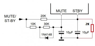

Since this chip has been out for more than two decades, some DIYers have encountered similar problems with the mute/standby function, and I think we should learn from them first and see how they solved this problem.
I found this thread, the solution is add a 2KΩ resistor across the capacitor in mute circuit.
I read the old thread and I'm not sure what adding a 2K resistor actually does?
Sure I can add the resistor, but what will happen upon powering up?
The 2KΩ resistor acts as a voltage divider along with the 20KΩ resistor, dropping V+ and charging the 10µF capacitor in parallel with it, this gives a delay time until the capacitor is fully charged and the supply voltage will trigger the standby pin to turn on the amplifier. The 2KΩ resistor also provides a faster discharge path for the capacitor during power down.
Savan also recommended this in post #15:
you need to research that and in case your VCC is high for those pins try add some resistor divider at the input of the mute and stdby!
I hope @Sangram sees this thread and gives us his insight.

Adding a 2K resistor is a 'non invasive procedure', so when I have the time, I'll try that first and report back.
I also read the datasheet; and at the start of this adventure, using a single powersupply filterboard (12V DC), I had a massive amount of squeeling noise when I switched off the power.
No speaker protection board yet and the noise appeared to come from the capacitors on the filter board draining. Adding the speaker protection board helped a bit, but as the board reacted too slow, only the last section of noise was cut off.
Changing the filterboard for one with a double power supply (12-0-12V AC) reduced the switching off noises to the 'thump' I still have today, but it also created a loud bump powering up (without the spaeker protection board).
The speaker protection board was re-installed and the power up bump was inaudible.

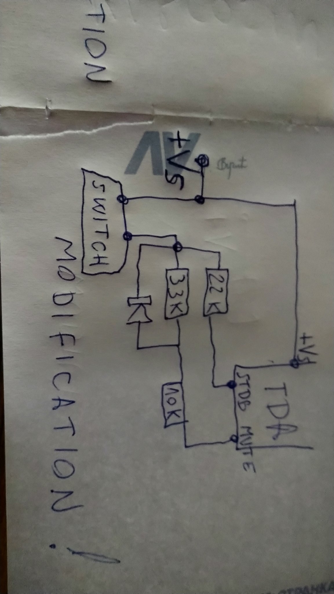

I told him that, it might be higher than +-40V trought rectification. In relation to mute&stdby he should replace 10uF capacitors with for example something like 100nF, but first must try maybe it will no need at all. RC 22k + 10uF is about 0.2 secconds delay which is soo long for getting fast response while turning OFF amplifier trought switch, I would replace capacitors with 100nF. Also I would replace toroid with 24V one, +-40V trought rectification is not a safe for TDA. I would not add 2k I would add 4.7k parallel to booth two 10uF capacitors, one for stdby and one for mute. 2k divider with 22k gives 3.33V which is in the verge of not working properly, see threshold values from datasheet! Mute and stdby is CMOS input, ideal is suplying them with 5V, just calculate divider resistors for 5V and add restistor paralel to capacitor of the booth mute and stdby. If need I can draw all needed modifications on new picture!
2023-07-24_164132-jpg.1196117

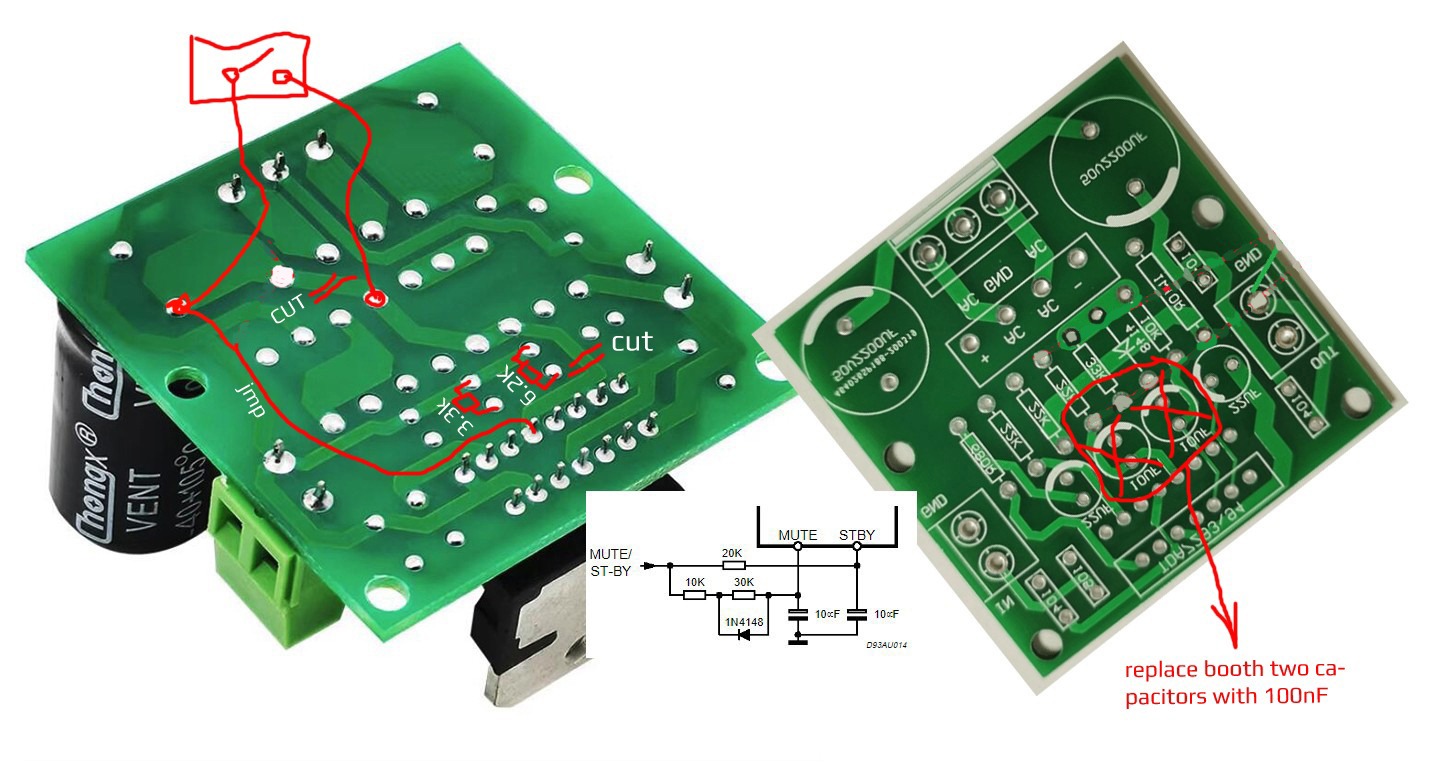

This is all modifications I would do:
1. replace torus transformer with one of 24V, trought rectification you are at around 30-35V which is a safe for TDA
2. replace two 10uF capacitors with 100nF (might be bipolar)
3. two cuts
4. one jumper wire
5. add paralel 3.3k resistor to first capacitor
6. add paralel resistor 6.2k to seccond capacitor
With this modifications mute & stdby will be suplied trought resistor divider with around +5V and booth pins with their capacitors (100 nano rarad) will be fast discharged when you turn OFF switch, so you should not hear "thump".
Yes, you can use two pole switch.

Regarding Savan's mods:
1) I have several toroids on the shelve, so giving 24V a try is no problem. These are older toroids (from the 220V era) and deliver more with the European Voltage being slowly raised (and fluctuating, as the load changes), so in stead of 32V, it'll be more like 34,7- 0 - 34,7V DC after rectification, but that's not an issue.
2) Replacing the two capacitors to reduce the response time of the mute/standby function; I should have 100nF lying around.
3) Cutting two traces, no problem.
4) Add a jumper wire from the positive power supply to pin 7 of the chip.
5&6) Add 3,3K and 6,2K resistors in parallel to the replaced capacitors.
7) Use a double pole switch to power the amp and the mute/standby circuit.
I'm having some busy days ahead, so It may be a while before I can work on the mods.
At the moment, the one in the pictures powers the subwoofer in my workshed, so I may assemble the modified set-up on a new piece of plywood.
@Klaus: if the above doesn't produces the desired result (no switching off noise), I may ask you for a schematic and/or pictures of your solution...
Regards, Jan.
