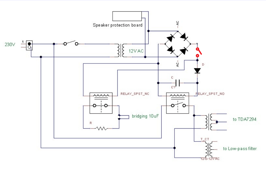

I think that will disconnect the speaker instantly.What if I use the second relay, which now connects the 2K over the 10uF, to cut the speaker lead to the connectors?
However, I suspect that the turn off "thud" is caused by the power switch arcing or the magnetic field of the 12V transformer collapsing.
Put a switch on the DC side to control the relays will confirm it.

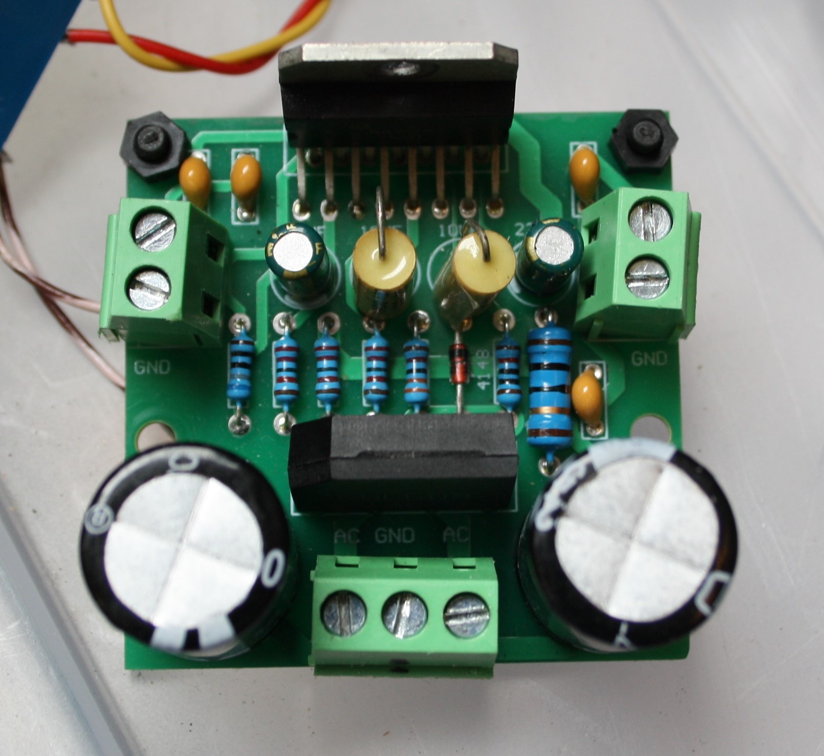

Hi Savan,This is all modifications I would do:
1. replace torus transformer with one of 24V, trought rectification you are at around 30-35V which is a safe for TDA
2. replace two 10uF capacitors with 100nF (might be bipolar)
3. two cuts
4. one jumper wire
5. add paralel 3.3k resistor to first capacitor
6. add paralel resistor 6.2k to seccond capacitor
With this modifications mute & stdby will be suplied trought resistor divider with around +5V and booth pins with their capacitors (100 nano rarad) will be fast discharged when you turn OFF switch, so you should not hear "thump".

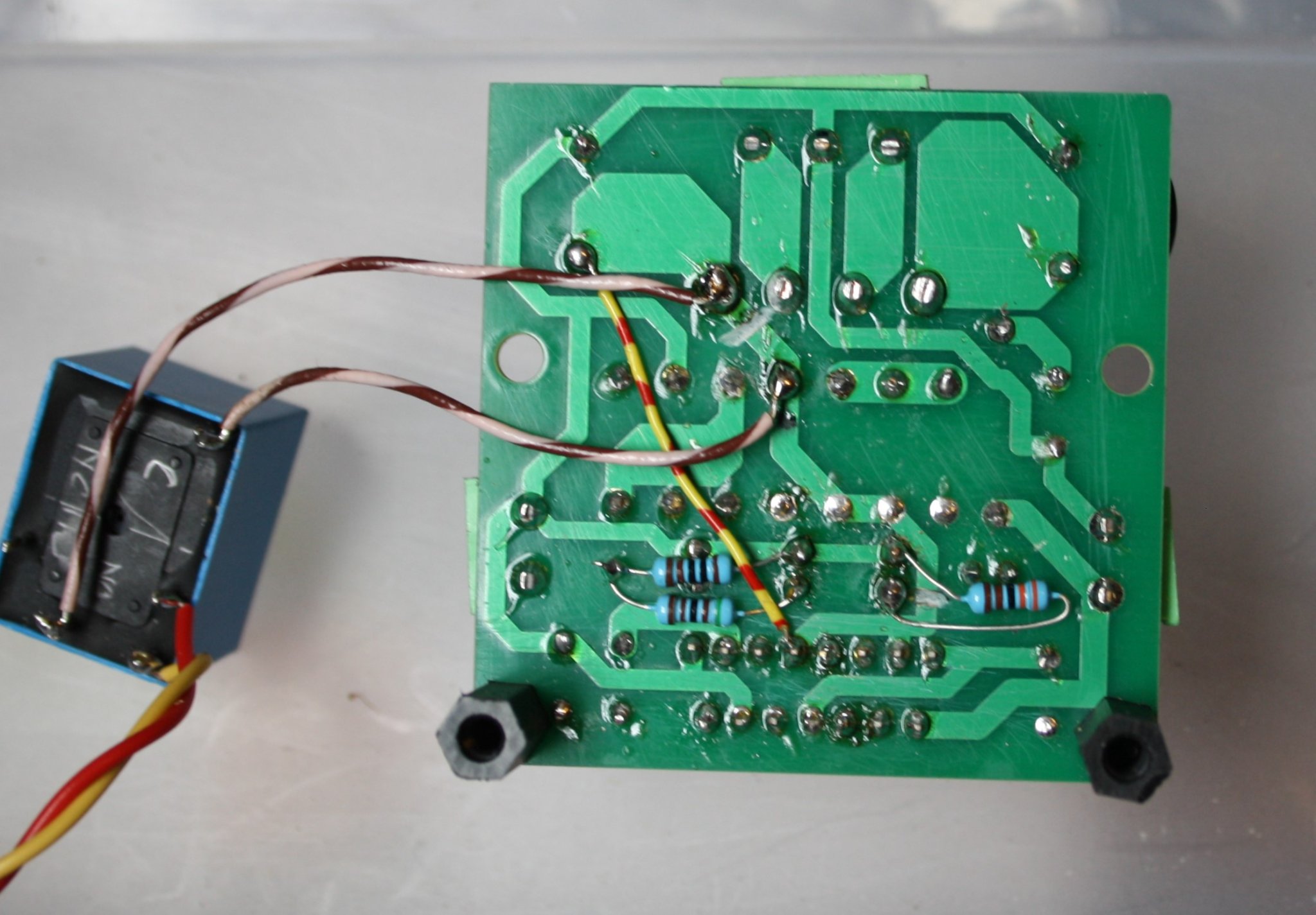

Savan, please take a look and let me know if I can power this up.
I made the cuts with a Ø1 mm milling cutter in my Dremel and checked if the traces were cut properly with the multi meter.
Soldered on the jumper wire and removed the 10uF from the top; this was not the nicest job, as I have big hands and there isn't a lot of room, I modified a wooden washpeg to get a grip on the capacitors...
The 100nF came out of my spare box and are decades old, but still measure properly (99,8 nF).
I didn't have a 6.2K at hand so I used a 5.1K with a 1K, which wasn't a bad solution given the space underneath the board.
The relay bridges the cut in the powersupply when the amp is powered up and should cut it when the 12V transformer powers down.
Regards, Jan.

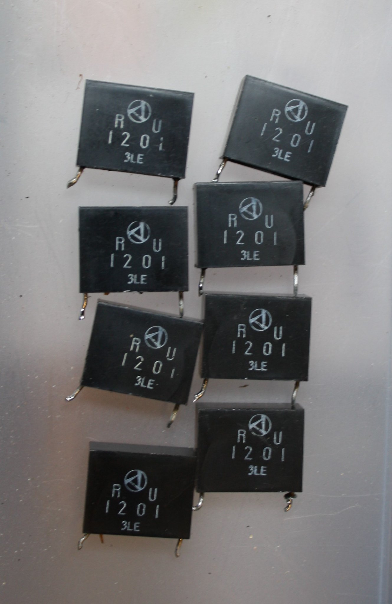

I also have a number of these 100nF capacitors:
I can't find for which Voltage they are suitable though, size is 20 x 16 x 8,2 mm legs are 0,8 mm thick.
Usable/suitable?

I just mounted the modified board back onto the heatsink, reconnected the wiring.
Did a last visual check between my pictures and those Savan posted and saw that I have switched the positions of the 3.3K and and the 6.8K resistors...
Fortunately I had not powered up anything.
I'll remove the board and switch the resitors to the correct places.
Stupid me...
Regards, Jan.
Stupid me...
Regards, Jan.

Jan, resisitor values is diferent for 12V power supply! The mod I have done is for power supply of 40V since in that time when I wrote that you had 40V power supply! For 12V power supply as you using now, you need to replace 3.3k with resistor values between 15k-22k and 6.2k replace with resistor values between 30k-40k ! Capacitor voltage after divider is no more than 6V even its less, so you can use for example capacitors with declared votage of 12V with no problem. Use this to calculate resistor divider for Vout 5V https://www.digikey.fr/en/resources/conversion-calculators/conversion-calculator-voltage-divider , Vout must be between 4V to 6V with no problem so chose resistor value you have at home. If you using 40V power supply than my mod should be used wothout any changes.

Sorry Jan, I can't confirm the voltage rating, I wouldn't put it on 230V mains voltage if it were me!I also have a number of these 100nF capacitors:
Usable/suitable?
Please refer to #84 post, my suggestion is to add a switch on the DC side to experiment. If there is a "pop" when opening, add those film cap to the switch and see if that works (since it is at about 17VDC).
Its simple, you have 22k in series and you need to add paralel resistor value to make resitor divider for get 5V out for stdby. Also you have two resistors in series 33k+10k=43k and you need to calculare paralel resistor value to get 5V for mute pin. So that way on the link I have provided enter Vin value e.g. if you using 12V power supply enter 12 or if you using 40V pover supply enter 40. For R1 enter 22k or 43k and calculate to get aroung 5V for booth mute & stdby. No need to be excatly 5V out but between 4 to 6 volts is ok, even 7V is ok but don't do less than 4V since 3.5V is a treshold value for mute&stdby=OFF , better is having 4V and up, do it by looking into what you have from resistors in your home and use those values for R2 in calculatorMerci pour repondre Savan,

Hi Savan,
So if I understand it correctly, when using 12V, the 6,2K has to be 4,7K (6.26V) and the 3,3 has to be 22K (6V), in oder to get both values over 5V.
I'l start changing out the values, but I'll wait for you to confirm (or not) before I apply power.
Regards, Jan.
