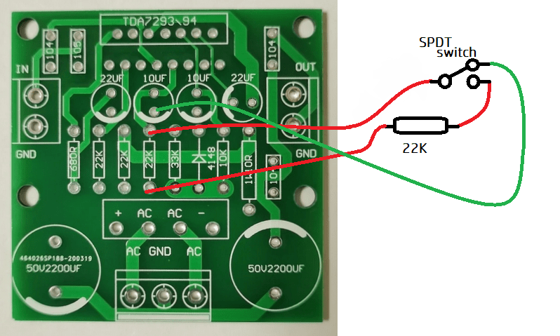

Jan, if you don't mind, you could try grounding the mute/standby circuit with a SPDT switch and see if that mutes the amp while playing. (Please note that the switch is moved in front of the 22K resistor).
It looks like the mute/standby is a latch circuit, once turned on, it stays on until the amp is powered down.

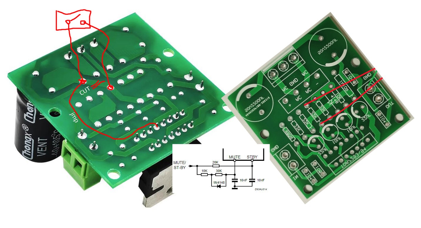

I think you have doing that wrong! Please see picture! Mute + stdby circuit on those small board is allready suplied by VCC, that mean mute+stdby is OFF all the time, reason why mute not work for Jan. You just need to cut wire and add switch between! Also one jumper wire.

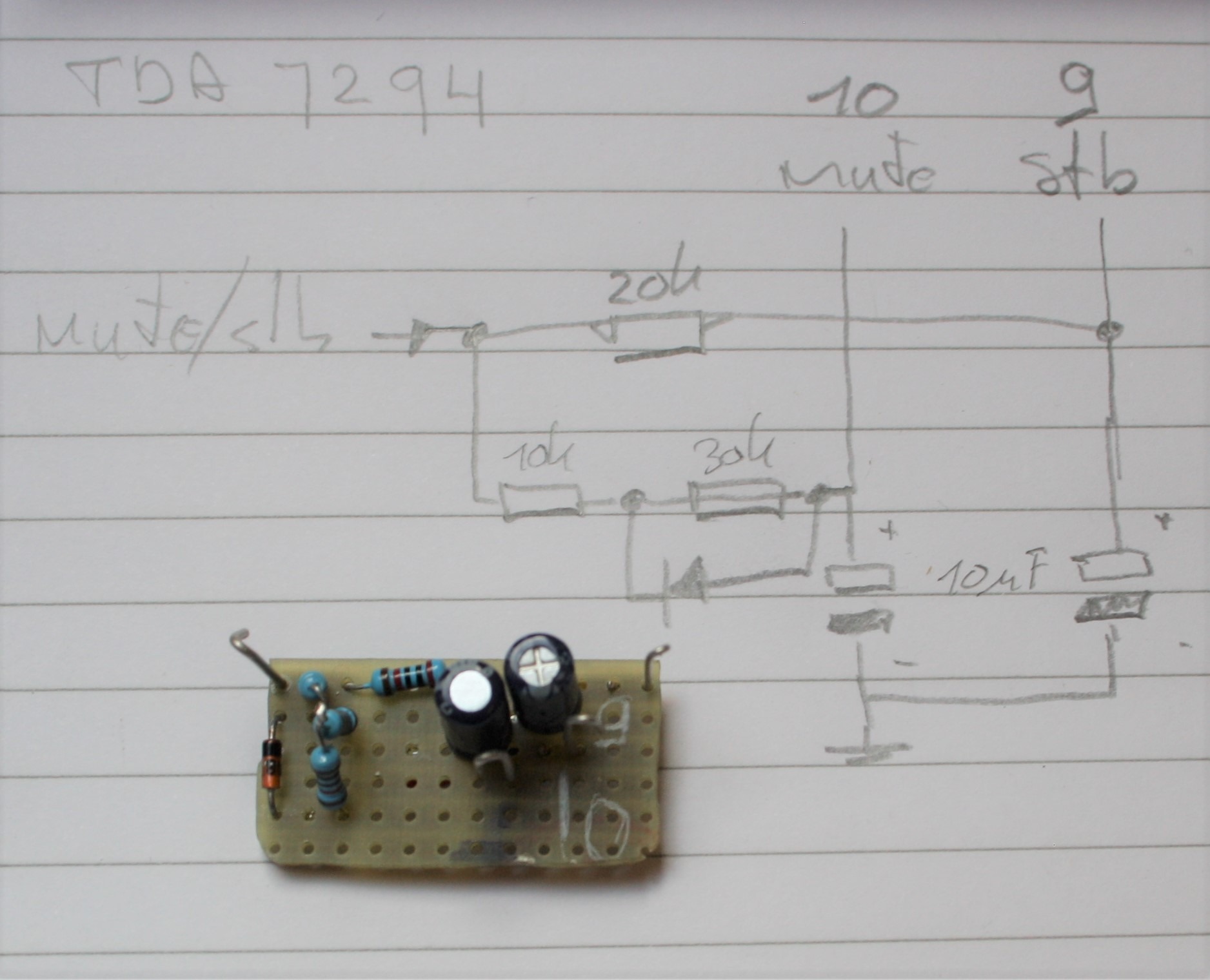

Right, putting everything back in place (it still works!), soldered some wires onto pins 9 and 10.

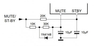

I took the components from this schematic:
And soldered them onto a piece of experimenting board.
I know where mute and standby should be connected to, but which Voltage do I use to power it and where does that come from?

Resistors values for mute+stdby is ok, its designed per datasheet and that ok. Its designed to be connected to +supply, so max +40V on mute+stdby trought those resistors and diode is ok. Mute+stdby is allready connected to +supply on main pcb, that mean you can't get mute+stdby ON because its connected to +supply! Option is to cut pcb trace and add one jumper vire as per my picture and all will work!

Now speaking about mute+stdby, you no need external mute and stdby resisors! Those components is allready soldered on your pcb! But its connected allready to +supply internaly on pcb! And that mean your mute_stdby is by default OFF! Thats reason why your mute+stdby is not working. What you need to do is just do it like on picture from post 25 and everything will work.

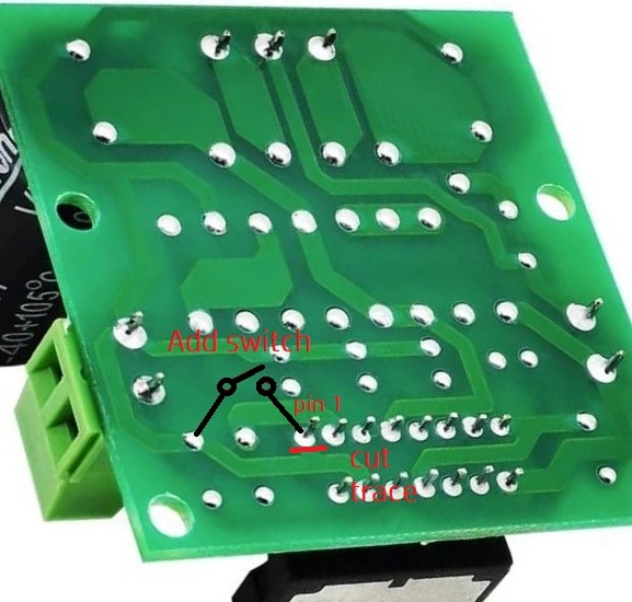

Hi savan,I think you have doing that wrong! Please see picture! Mute + stdby circuit on those small board is allready suplied by VCC, that mean mute+stdby is OFF all the time, reason why mute not work for Jan. You just need to cut wire and add switch between! Also one jumper wire.
Your method is the same as post #5, break the PCB trace instead of lifting the 22K resistor.
I think the mute/standby circuit utilized SCR for switching, it acts like a latching relay, once the gate triggered to switch on, it stays on until the amp is powered down.
In some circuits, grounding the gate can turn off the SCR, therefore I suggested post #24 @pompebled to try a SPDT switch and see if that can mutes the amp while playing.
If grounding the gate cannot mute the amplifier, another way to try is break pin #1 PCB trace from the ground, and add a switch to pin#1 and ground. The switch should be closed when the amp is powered on and the switch in open position, it will mutes the amp.
BTW, add a switch to pin #1 and ground, the other switch will no longer required, the 22K resistor should go back to its original position.

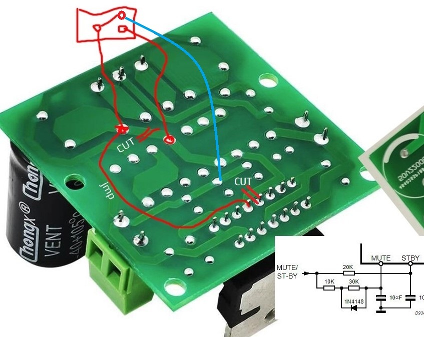

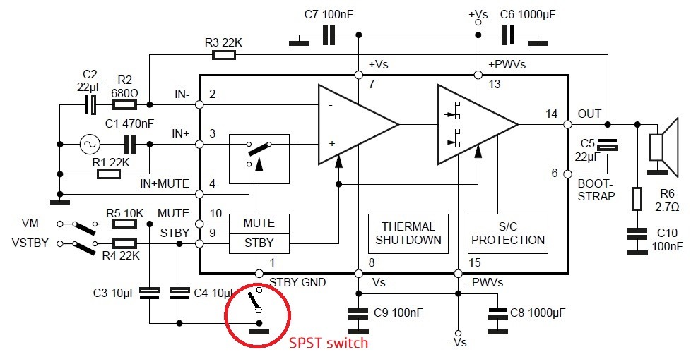

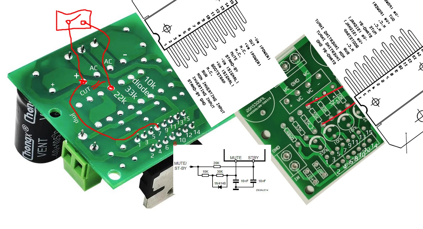

After I study the images again, lifting the 22K resistor and add a switch (post #5 & 24) only can control the standby function, mute circuit still connected to V+.
savan, I agree your method is correct! However, the trace on pin #7 also needs to be cut to disconnect the mute circuit from V+.
Jan, please try the above modification first. If you have a SPDT switch on hand, use it and connect the NC contact to ground (Blue wire).Hope this makes it work!

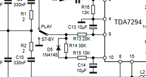

Above image is copy from TDA7294 datasheet Figure 20 - High efficiency application circuit.

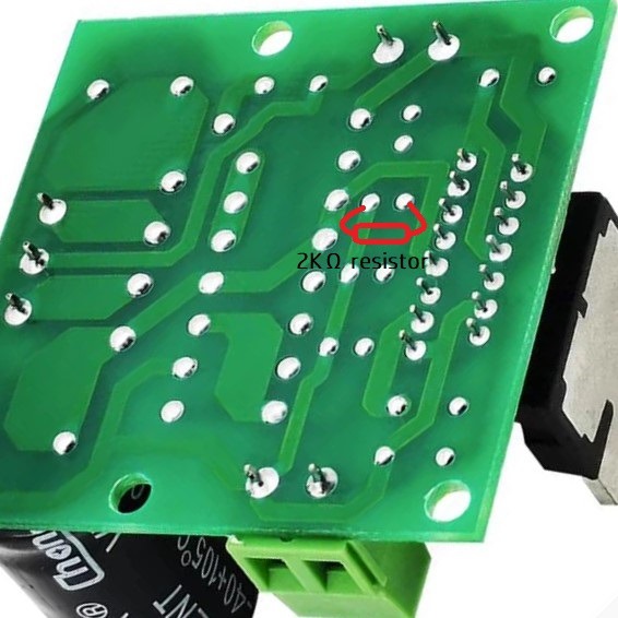

I found a ten year old thread about TDA7294 Mute/Stdby problem:
https://www.diyaudio.com/community/threads/tda7294-mute-stdby.234126/
The solution is add a 2KΩ resistor across the capacitor in mute circuit.
Hi Chris,
I read the old thread and I'm not sure what adding a 2K resistor actually does?
Sure I can add the resistor, but what will happen upon powering up?
It's a long way from adding a switch and cutting traces...
Regards, Jan.

Thats wrong! That way you will get short circuit (VCC to gnd)!!! Seccond cut is wrong too, those trace must exist, its VCC trace to TDA! I added jumper wire for that after we cut VCC trace for mute & stdby![]()
Opps! I was lazy and use your existing drawing, my bad! The two red wire should switch place.
Sorry I'm at work without a computer. Please look carefully if you don't cut the second trace, the mute circuit will still connected to v+.
No, please take a look at pinout from picture! The corect way is from picture! The green pcb from the right is allready rotated, just folow pinout and traces. If you cut pin 7 than TDA will be without +Vs pin 7! But if you cut as like on picture mute and stdby will be disconnected from +Vs but TDA will be also disconnected, so must be added jumper wire from +Vs (capacitor +) to the pin 7 of the TDA otherwise TDA will not have +supply voltage!
There is one bug on pcb (10k resistor and 33k resistor), their places were swapped so that the diode is in parallel with 33k but connected to+Vs instead of 10k connection to +Vs, but ok it can be like that without any problem (RC network is the same = 10k+33k with capacitor 10uF to ground). Mute and stdby on pcb is identic to figure 17 from datasheet (schematic at the botton of picture)
