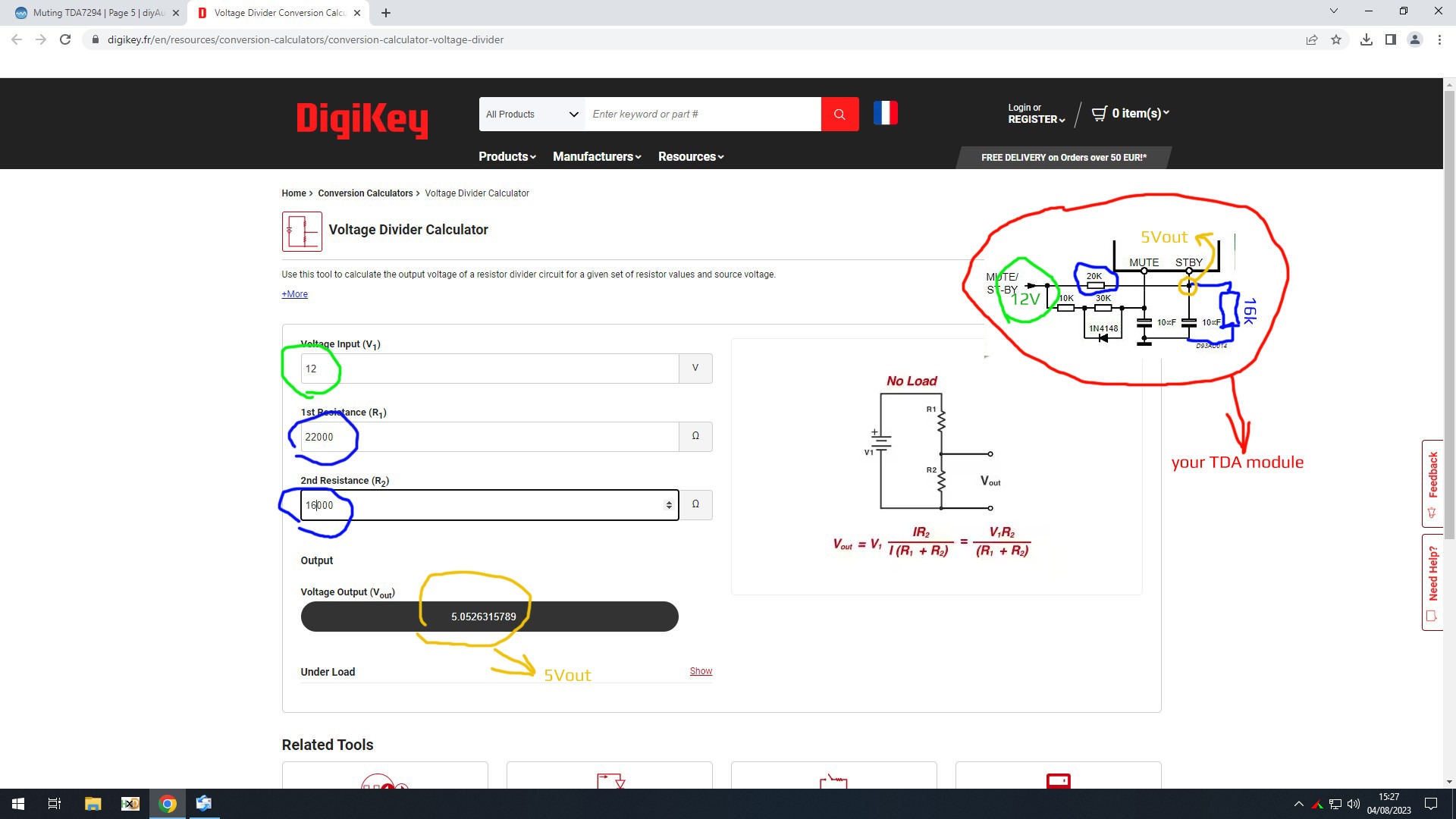

This picture help? This is calculated resistor divider for STBY. You can see that calculated R2 value is 16K, so replace 3.3k from my mod with 16k. Or if you do not have exact 16k calculate yourself for Vout between 4 to 6V is ok too. Now you can calculate yourself for mute, you have 10k+33k=43k in series on your pcb, so for R1 type 43000, for R2 type anything until you get 5Vout, thats all. When you get close to 5V, that resistor R2 value you caclulated is to replace 6.2k from my mod. Its not important to get excatly 5V but between 4V to 6V is ok too! Based on resistor values you have at your home. Important is having not less than 4V on booth mute or stby.
Update: I can at least replicate those values in the calculator, so there is progress...
The closest I can get by combining resistores is 30,8K and 15,8K. When I enter these values in the calculator, I get about 5V.

Hm seems mute & stby funcion is not what tell datasheet. There sould be thump free but seems not a true. or probably much biger power off delay is need after mute&stby is fully on, looks like delay is too short. I realy have no idea right now. Did you measured voltage between gnd and mute pin and also between gnd and stby pin while mute=off, you need to have there close to what you had in calculator so around +-1V close to 5V . Did you replaced two 10uF with two 100nF ?

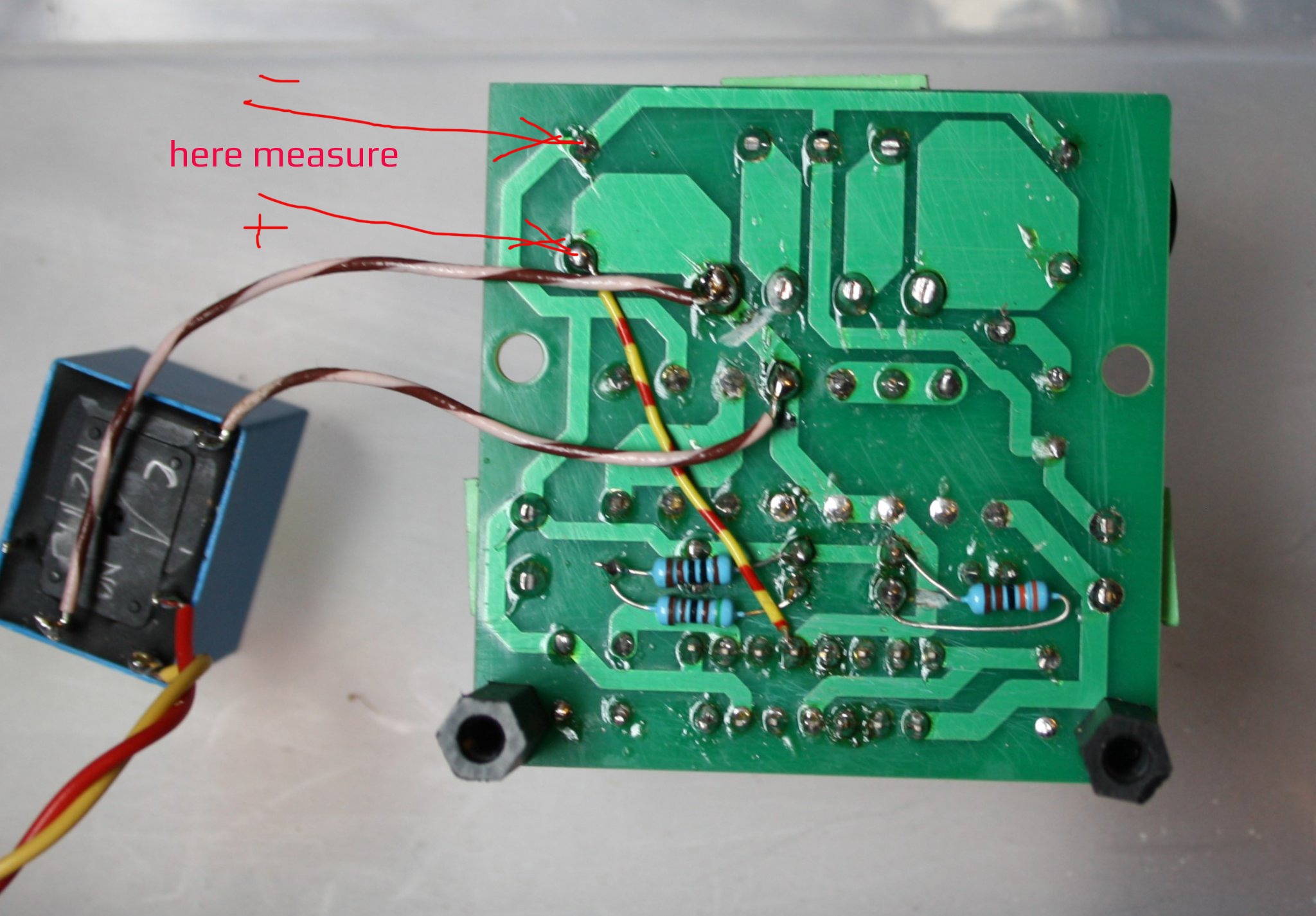

Even 9V is ok! But strange, seems you have more than 12V on input e.g. after rectification you have 21.7V? Just simply measure and replace 12V in calculator with real voltage, you will need to get close to 9V you measured.
Hi Savan,
When I measure on, or rather under the board, on the outside pins of the rectifier, I measure 33V DC.

Jan measure at one of the big capacitors, see picture. So those masured value you need to use with calculator. About dc protect I would use them! it help save speakers in case some day something get wrong with apliifier and you get DC voltage on speakers.

Hi Savan,
I can't reach the point you show, but I can reach the same poit on the other side of the board and the common ground : 16V DC.
Feeding that into the calculator gives 22K and the 16K you already predicted

As you say 9V is OK to operate the mute/standby function, is there any point in reducing the resistor value to get the actual measured Voltage closer to 5-6V?
Lowering the 16K to 6,8K in the calculator drops the Voltage by 3V, which should be on the mark...
If I have absolutely nothing to do, I may just give that a try, but, if you say it won't do any harm, I'll save that for the time being for when the TDA7293 arrive and I can replace the humming one and experiment with a higher Voltage on the power supply.

TDA can accept rail voltage on mute and stby so 9V or even 39V is ok there! Resistor divider is added because something is needed to discharge capacitors and we need that fast so we used here the minimal voltage and minimal voltage for mute and stby is 3.5V, I would make them 4V minimal in our case 5V is the best, the same time replaced 10uF capacitor with 100nF no need to be e.g. 50V capable but 10V for example becaue of voltage divider. For example if you have 39V on mute and stby your capacitors need to be minimum 50V capable. But if you make 5V using resistors divider you should use 10V capacitors there with no problem. Even you can omit resistor divider in case you have a way to discharge capacitors to gnd.

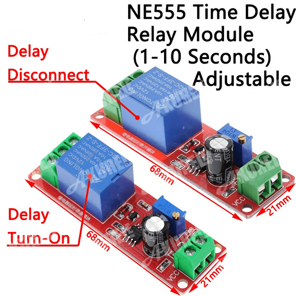

As I suspected, powering up the filterboard causes the thud on the speaker output, regardless where the power comes from; the buck-down module, or as it currently is wired, my regulated powersupply.
Adding a relay board that switches the speakers on with a delay seems to be the solution, exactly what I tried to avoid, given the small cabinet it all has to fit in...

Hi Chris,
I have a couple of these, but that would still require a seperate power supplywith a rectifier, for which I barely have room, if I want to respect the distance between signal and power wires.
I could use the buck converter (36 x 21 mm), but this one only puts out 1A, I'm not sure if it can handle the relay board and the low-pass filter.
I can always give it a try, tomorrow I'll let you know what happens.

Having the filterboard and the delay board share a power supply doesn't seem to work, I managed to render another filterboard inoperable, trying it...
I installed my last working filterboard and will order another buck-down board to power the delay board, or add an extra secundary winding plus rectifier, to power it.

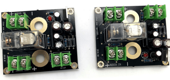

Hi Jan,
This mono uPC1273 board mounts directly to a binding post and has built-in rectifier and voltage regulator that accepts 12-18VAC power provides a 3 second delay and DC protection.

Hi Chris,
I have one of these board in my spare drawer, it is brandnew and when I apply power, the relay acts immediately, no delay, no matter which way I turn the adjustable potentiometer, nice a dud...
The mono speaker protection boards you show, are a bit to bulky in the small aluminum housing, I have to work with on this project. They are the fast reacting types though, aren't they?
