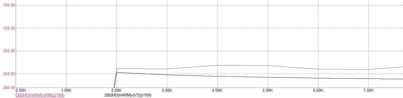

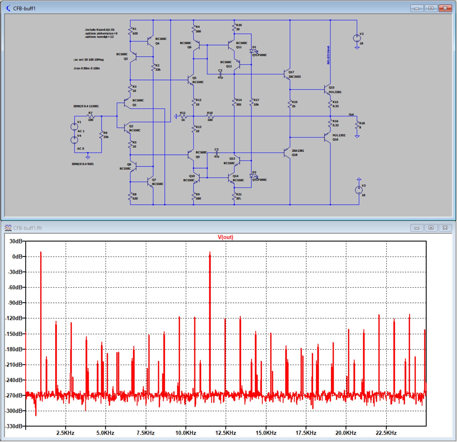

Small update:
I made a simplified line level buffer from my schematic, THD is -225 dB, for the full version I expect -250 dB or better.
Problem: MC12 transient analysis seems to be limited to -260 dB. Any chance to improve that with settings ?
Black is the sine source, red my amplifier.

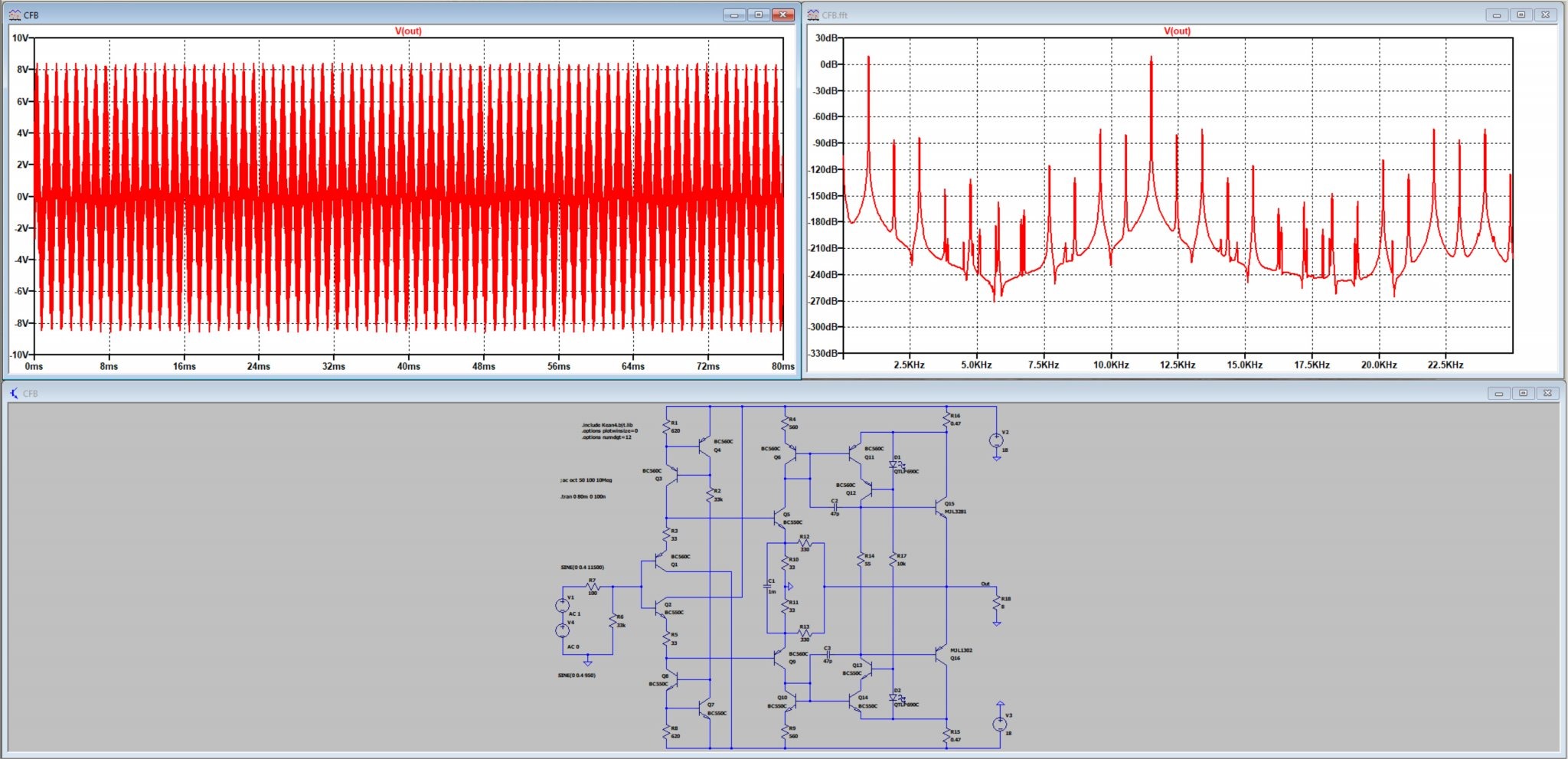

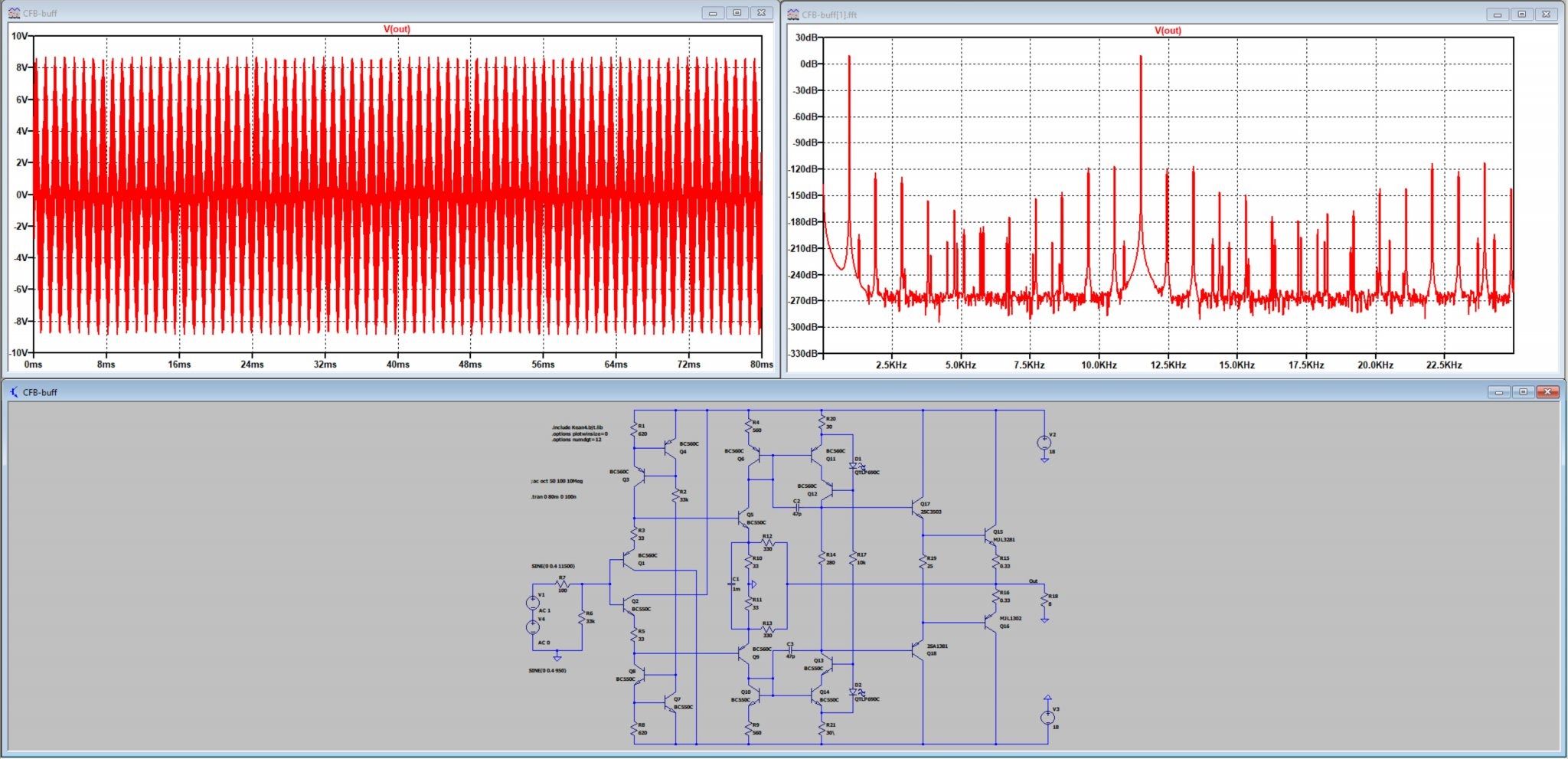

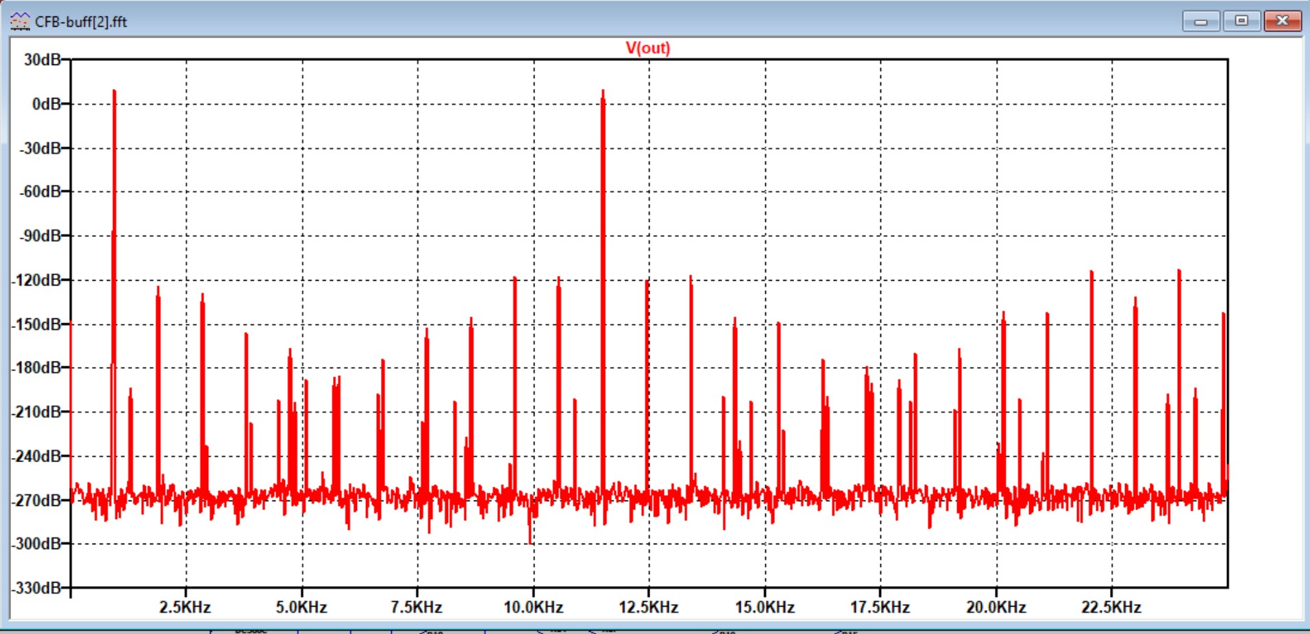

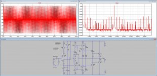

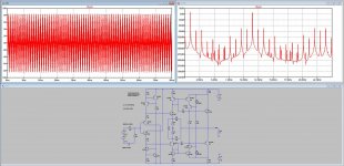

With just a bit fiddling and increasing the loop gain, I could lower IMD by 30dB still without any optimization.
Left the original and a the right the modified version, both having 850mA bias current.
Hans

And when removing the 1m cap over the two 33R resistors, IMD spectrum becomes even better.
Schematic from post 1112 and 1113

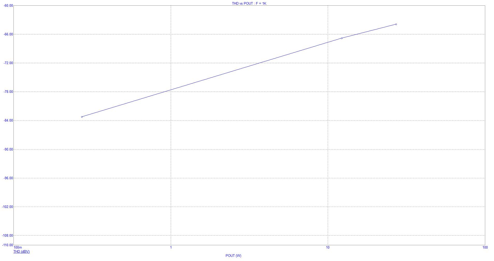

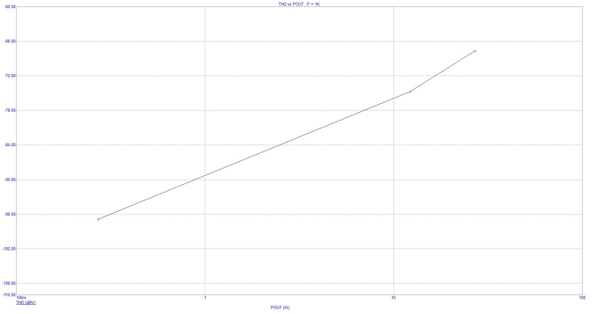

THD with cap is worse than without.
Same for THD 😊
Without the cap, try IMD with one of the 330 ohms feedback resistors changed to 333.3 ohms (+1%)

Well, that's the easiest problem to solve, just replace the four 330R and 33R resistors by one 160R and one 16R resistor.Same for THD 😊
The four 10R emitter resistors are just there to linearize non ideal diamond transistors, but don't affect gain.
With this mod, resistor matching is no longer an issue.
It simply shows that this Hiraga design is not well developed to its ultimate potential.
There is probably even more to improve, but a few steps already improved IMD by 44dB to below -125dB, not that bad at all.
