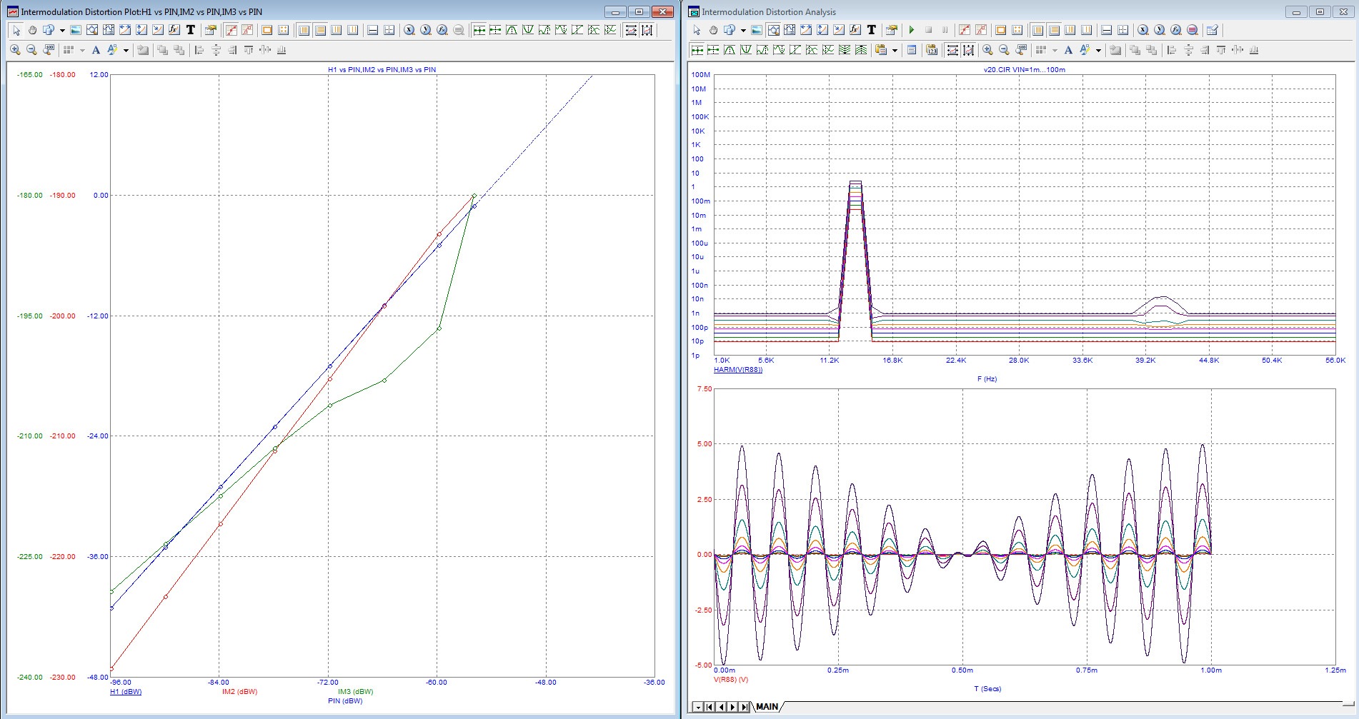

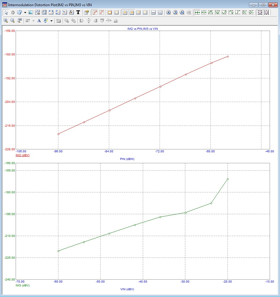

Not so simple due to the small numbers involved. But nevertheless, possible:
I have been working in enough different disciplines for familiarity with any kind of units so read "on the fly". For me, the numbers in Volt are quite handy as the ripple voltage of the required power supply is Volts too so I immediately know the requirements when knowing the amp's PSRR.
Expressing 1 ppb (V/V) in % requires (too) many zeros but is 10^-9, -180 dB.

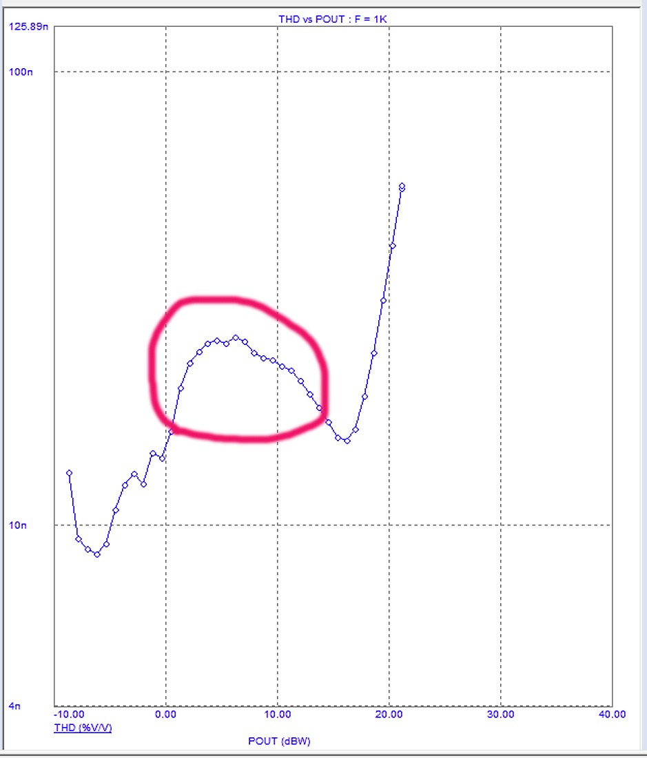

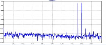

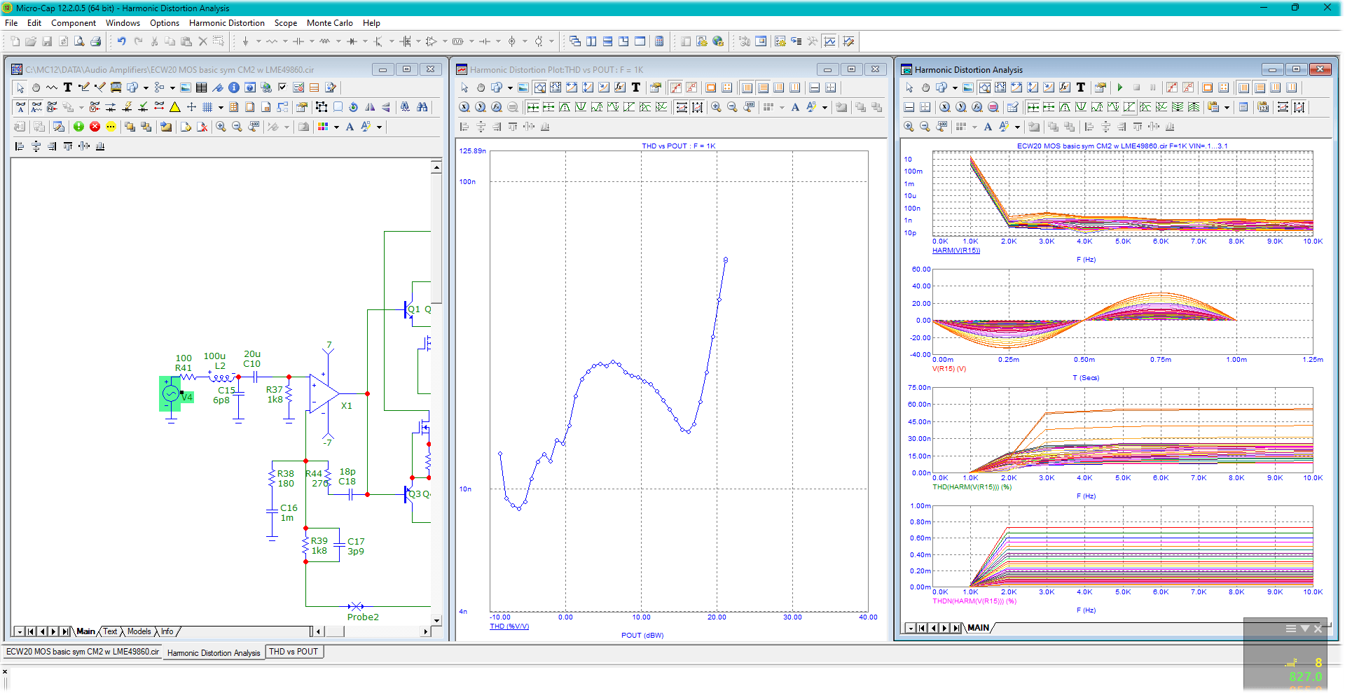

Indeed, it's the switching area but also the area where "internal" correction starts. That means, increasing the quiescent current increases distortion there and class A will not improve THD @ P(out)max. But it's only part of the story. Running IMD with the proper frequencies often gives a better idea of what the ears can expect. Hence my preference for 950 Hz and 11.5k (equal amplitude). For my purpose, anything below 100 dB at full power is defined as "good. enough". In the case of IMD, the improvement of class A is remarkable: as a figure of speech, "cutting the grass". So the question is "which one will sound better?

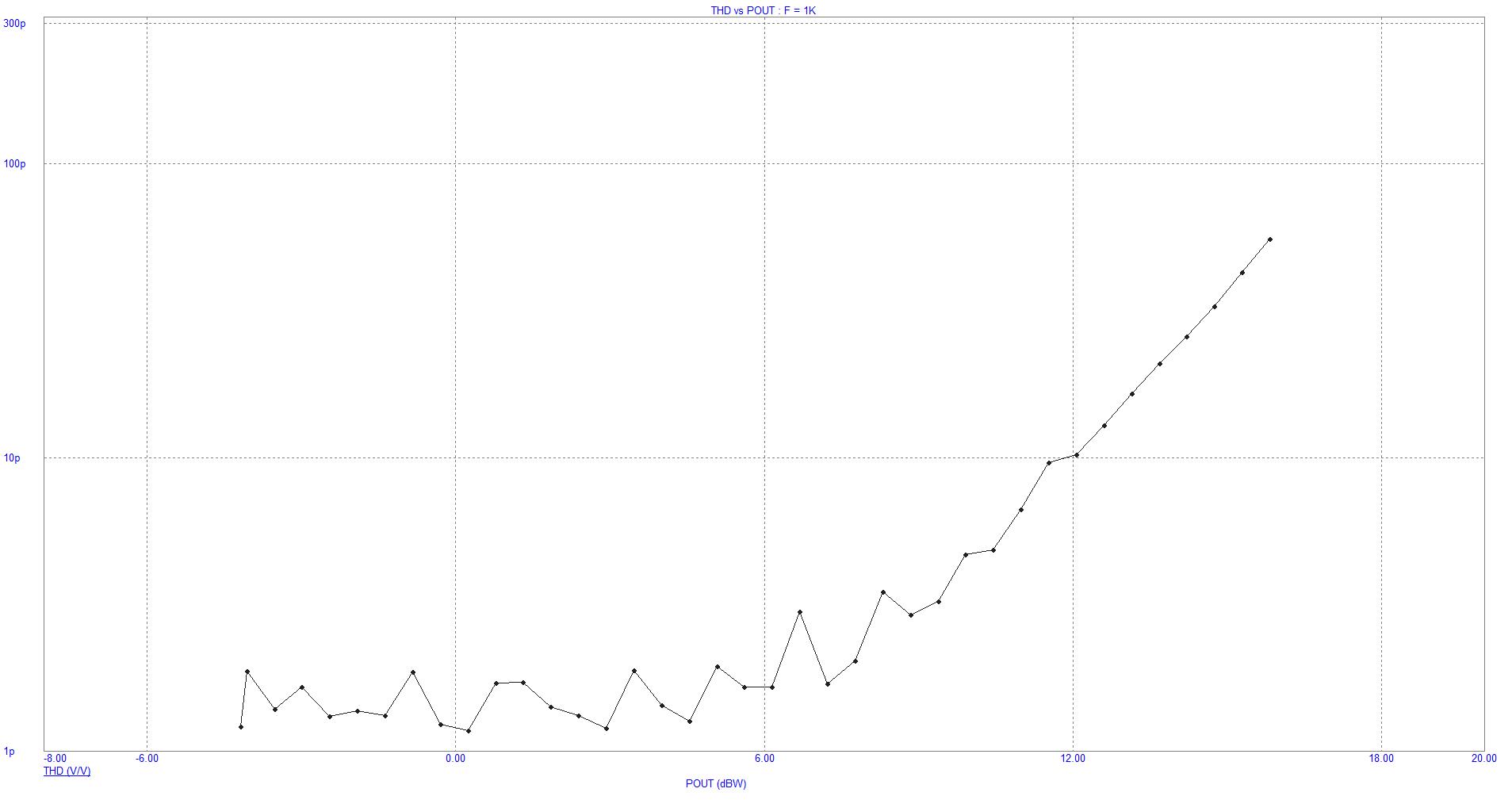

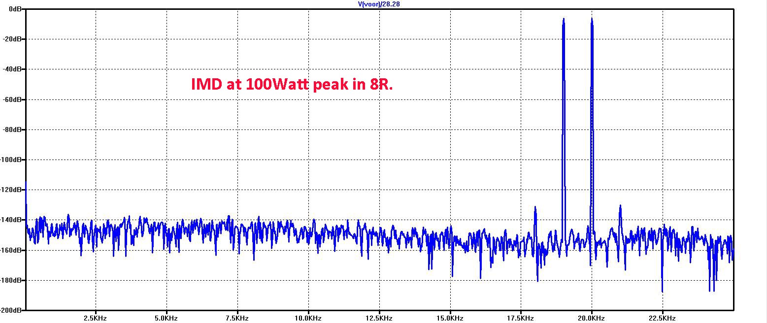

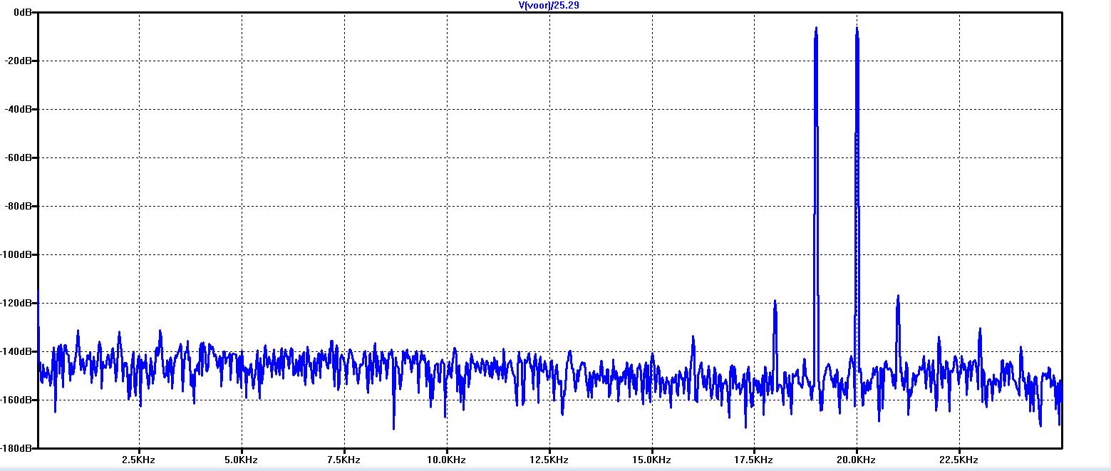

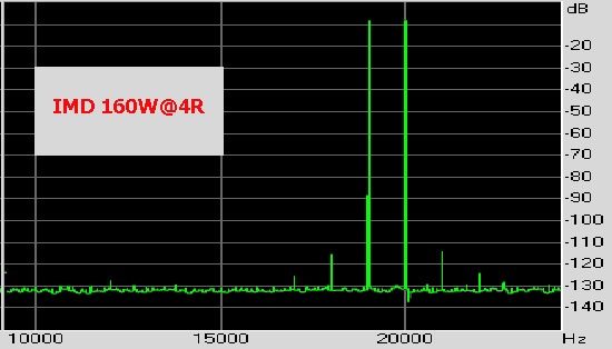

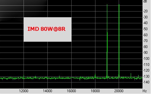

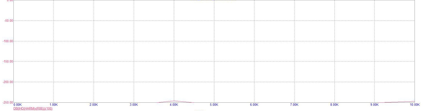

You may be using distortion-free components in MC12, since your plots are way beyond reality.
Everything beyond -130dB for a main amp is most doubtful.

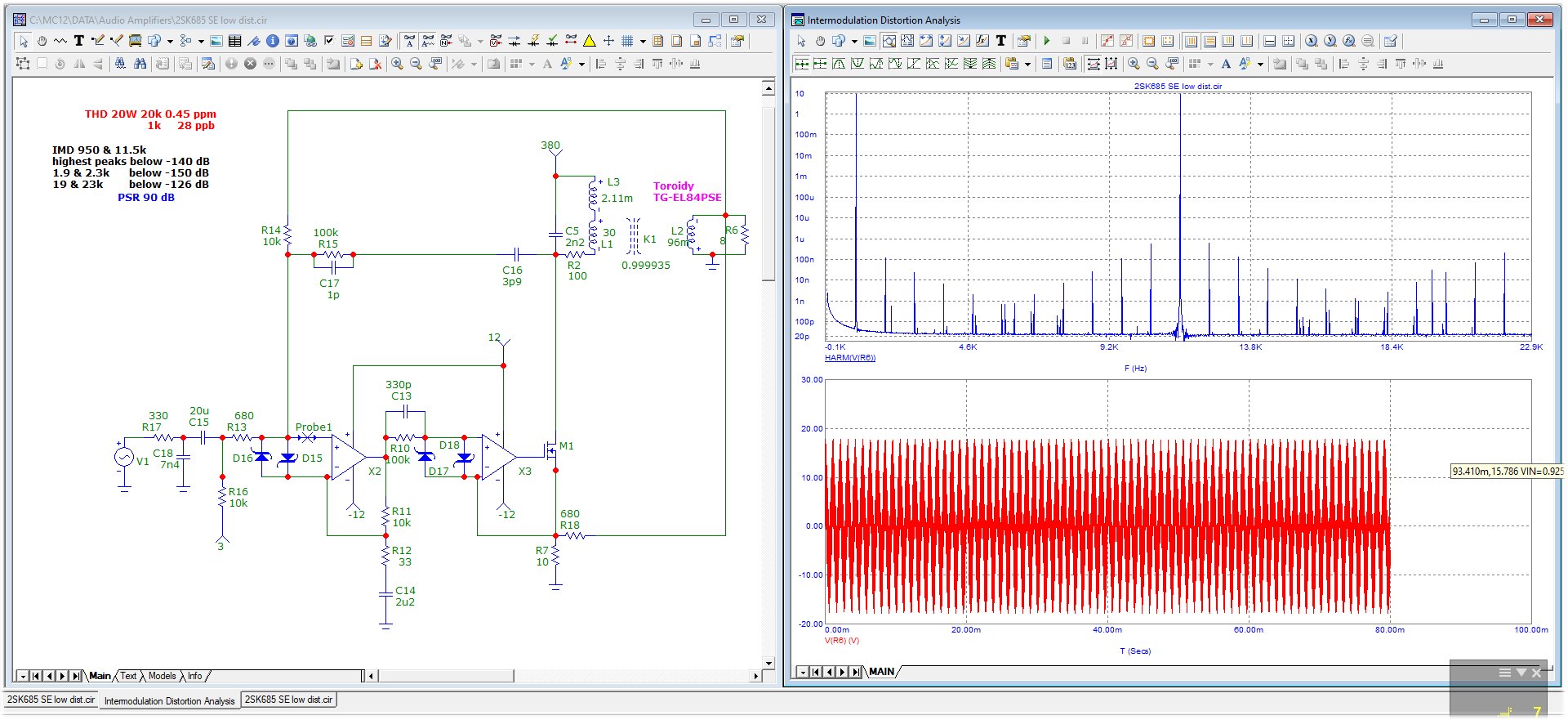

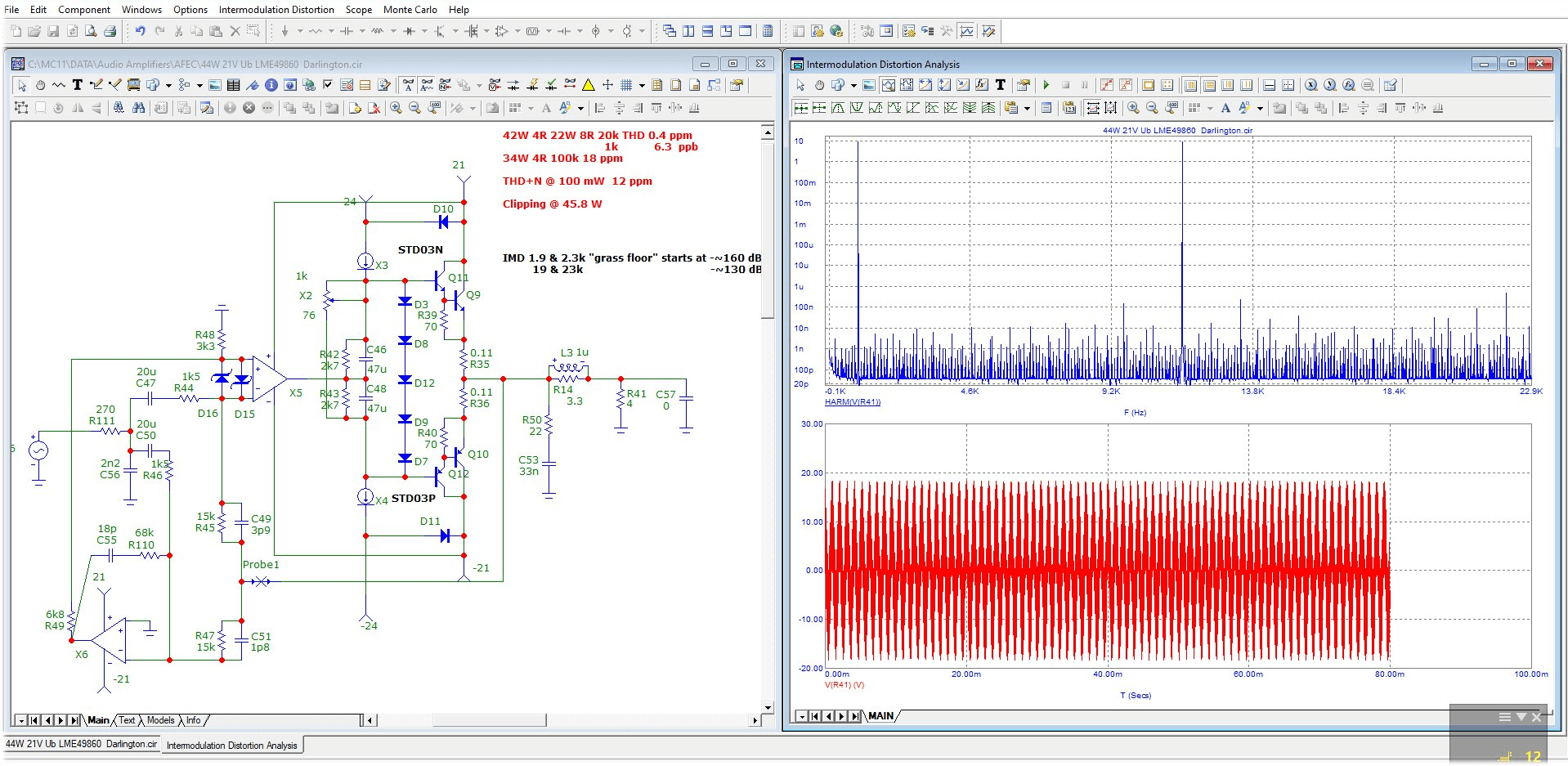

LTSpice did a much better job for my main amp.
See simulated versus measured IMD, for 8R and for 4R at resp 80Watt and 160Watt.
Hans
