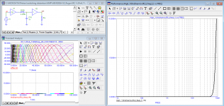

Since Petr evaded the confrontation, I made the sims with 3 distortion free first order R-C filters,

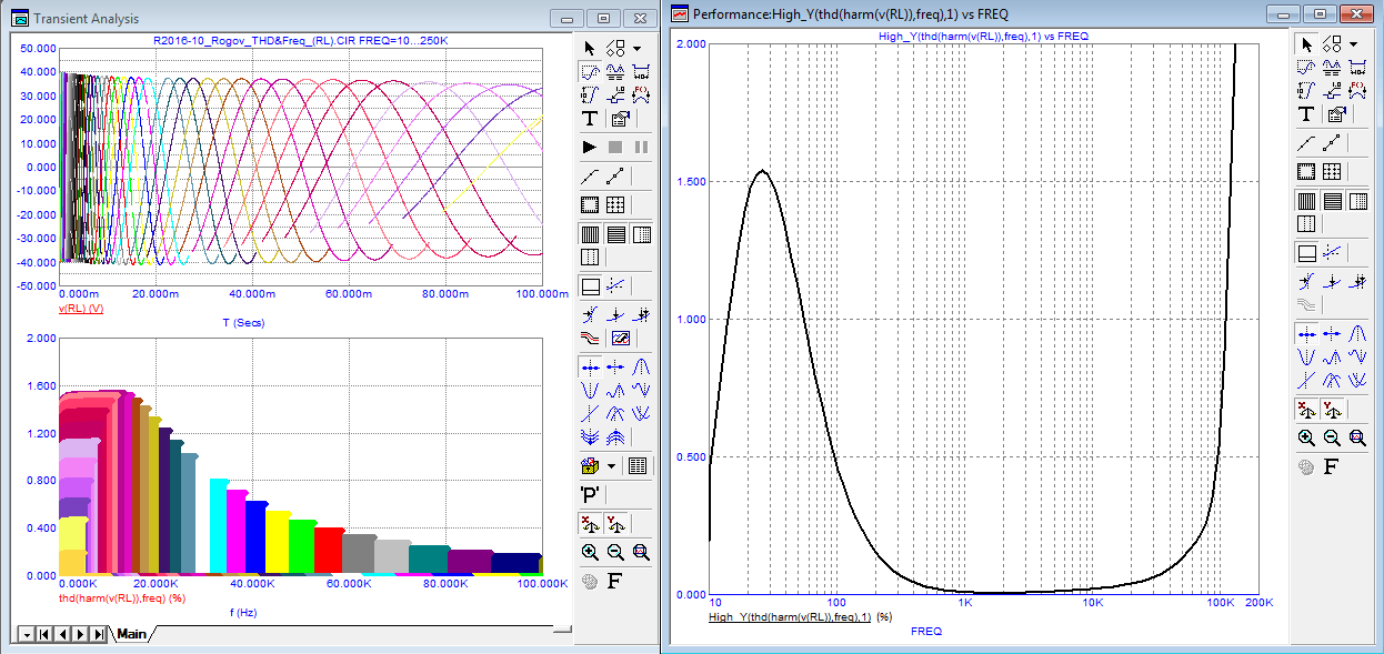

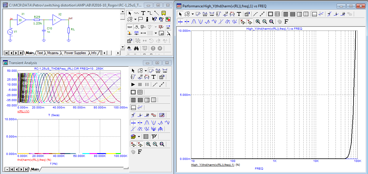

Here is the result of testing on the second period of an RC-chain with a time constant of 1.25 µs and a real amplifier having the same signal delay time.
Also feel the difference between the second period and the tenth period.
I hope it is clear that it makes no sense to test the RC-chain on the tenth period

Fantastic pictures, but without explanation what they mean they are just a bunch of lines in nice colors.
1) The first and second picture in #1003 have exactly the same subscripts, yet they differ quite a lot.
2) What is your meaning of "second period" and "tenth period".
3) What is R2016_10_Rogov_Thd&Freq_(RL).Circ Freq=10...250K
4) What is shown with Thd(harm(vRL)).freq) (%) are you multiplying Thd with freq and how is this Thd measured, details, details, details.
5) What is High_Y(thd(harm((v(RL)).freq).1) vs freq
Any experiment has no value when it can't be replicated by an independent source.
There is no circuit diagram provided of the amp you used, so even when understanding what you did, your plots can't be verified.
And using just some amp can never be used as a generalization to prove that it can't be compared to a RC network, apart from the fact that this is besides truth.
Last but not least, where are the "speed distortions" that you declared as being amplifier errors, that was the point I declared to be a non issue.
I don't see them in your current simulations so are changing the subject ?

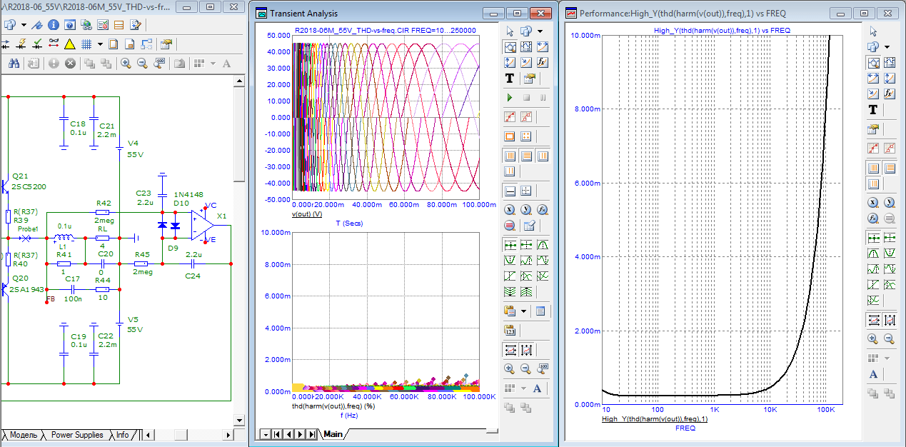

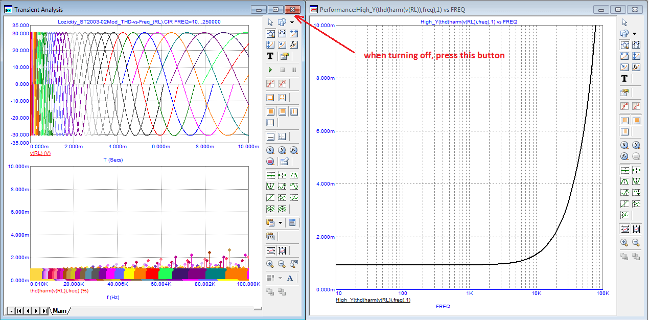

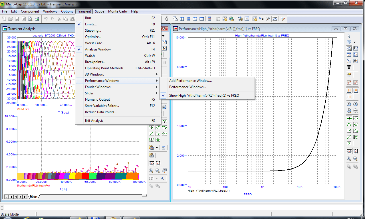

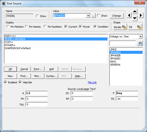

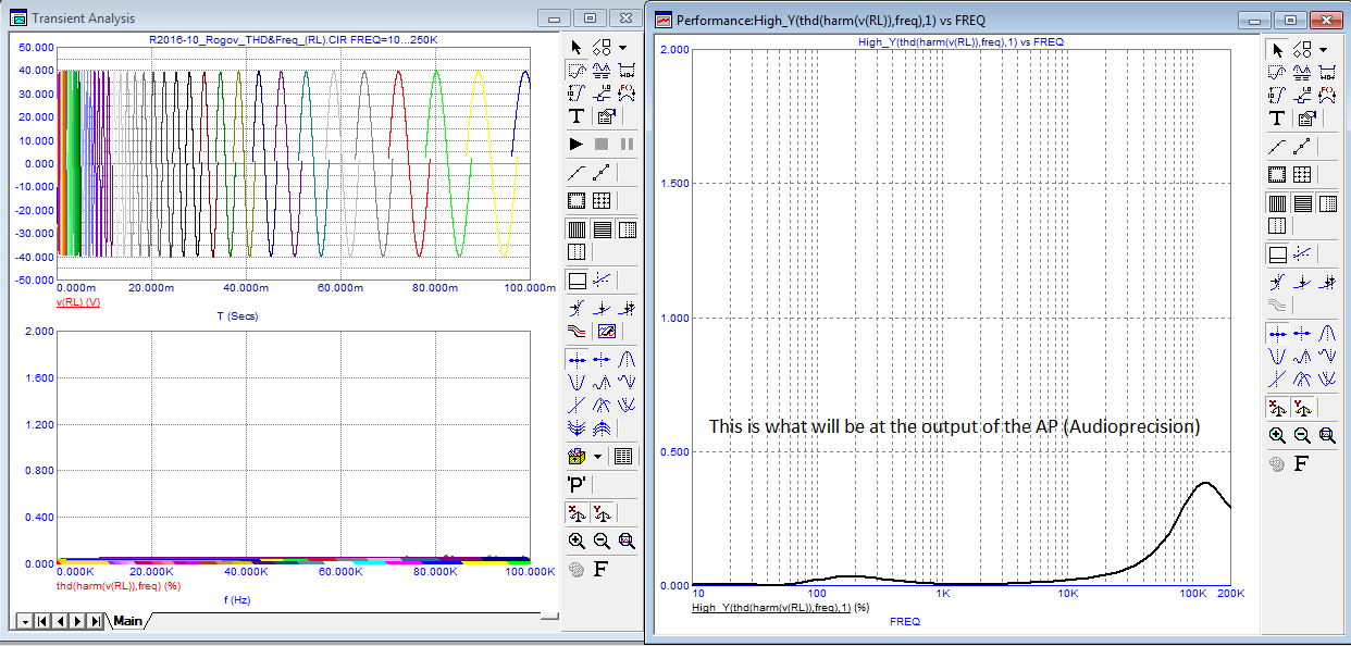

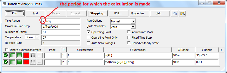

Hans, I have already explained that it is impossible to measure the loss of information on pure sinusoidal signals.
How to measure exactly the losses I showed on numerous examples by the compensation method. I don't know of any other method. Everything was detailed in the article on distortion measurements.

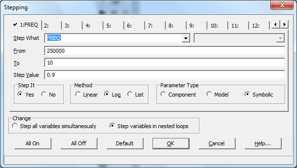

As for plotting the dependence of THD on frequency, this is done by the MicroCap program in a step-by-step mode. The algorithm of work was written by Russian professors of the Smolensk University (the married couple Amelins).
In this case, the generator sequentially operates at frequencies from 250 kHz to 10 Hz, in steps of 0.9. You can set the number of generated sinusoids. In this case, using the example of the Rogov amplifier (Radio 2016-10), I showed the results of the calculation using two and ten sinusoids.
If you are familiar with the algorithm of the simulator, you should know that distortion measurements are carried out on the last period (in one case, on the 2nd period, in the other, on the 10th period).

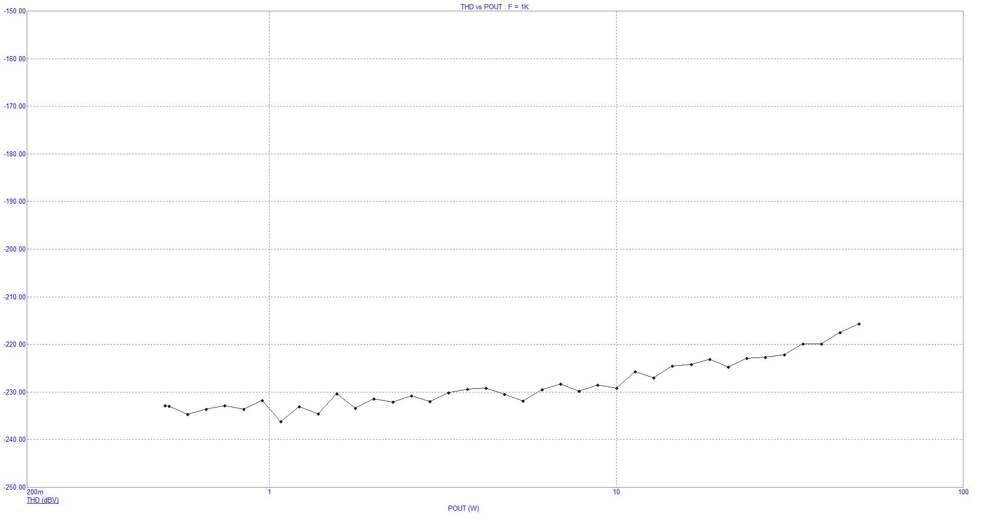

What is your problem ?
It is very normal that amplifier THD is rising above 1 kHz due to well known effects like phase shift.
Just simulate THD vs Power at 10 kHz. Or whatever frequency you want.
So you do not need all that sine burst nonsense, a technically correct sine burst can never reach the amplifier because it is low pass filtered by the preceding audio chain. That´s where your story ends.

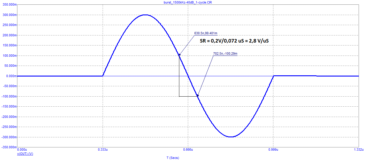

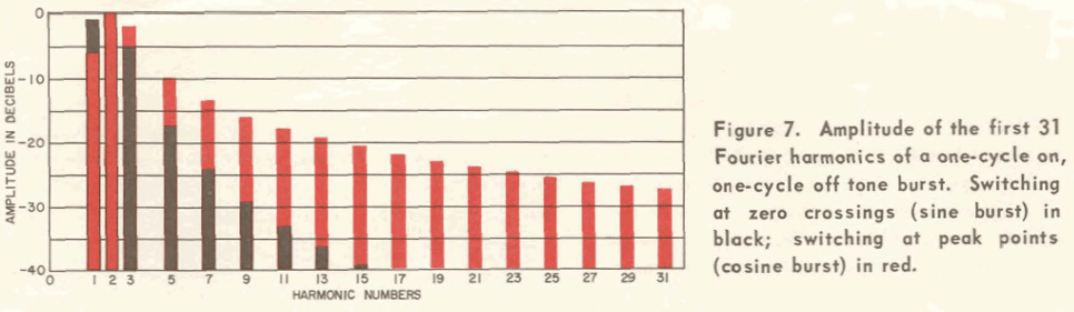

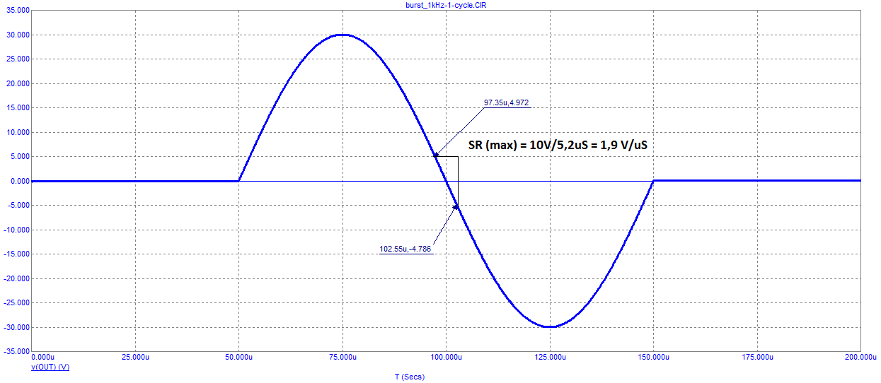

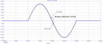

At every step, I am pointed out that a 10 kHz burst has cosmic slew rates, and they even introduced the IN-105, which shows the spectrum of a burst of one period (Fig. 01). True, I don’t quite understand how this period can be assembled from 15 harmonics, the levels of which are highlighted in black bars.
To begin with, let us measure the slew rate of such a signal at the output of a typical amplifier in Fig. 02. As you can see, the signal slew rate does not exceed 2 V/µs.

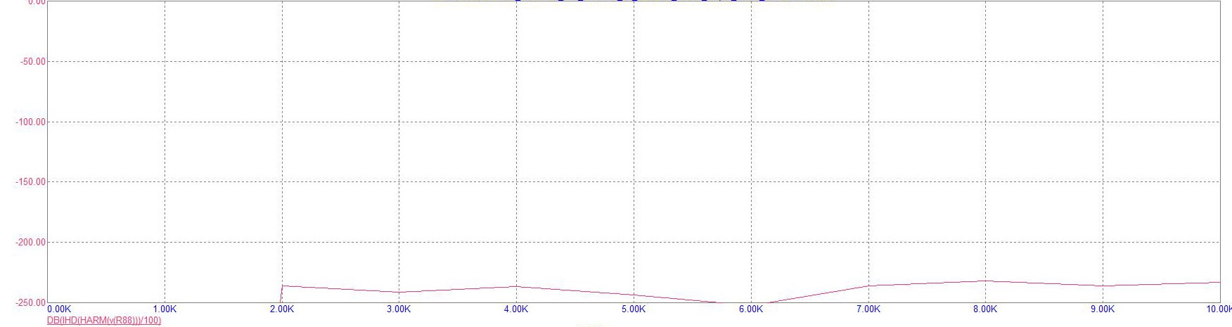

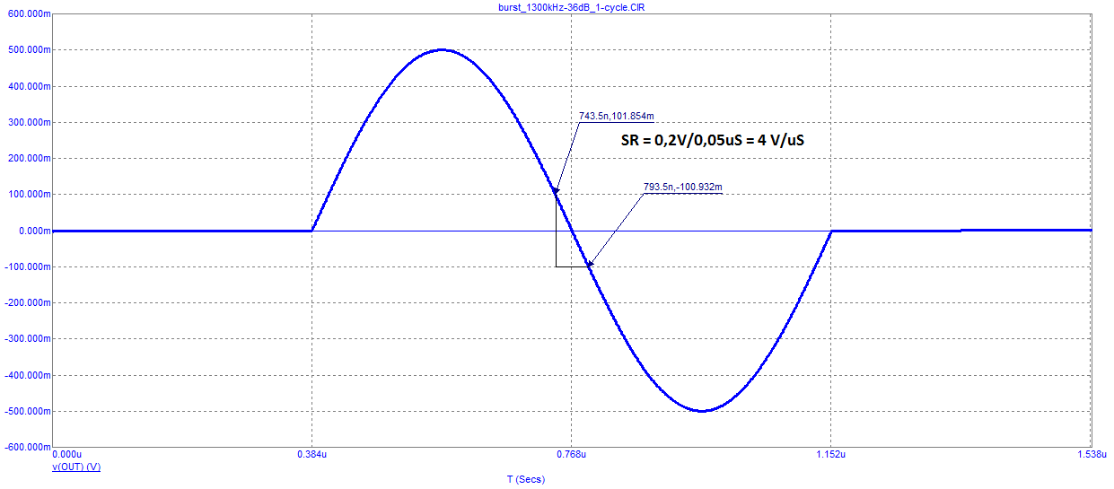

The highest harmonic has a frequency of 1.5 MHz with a level of -40 dB. Maybe this harmonic has a cosmic slew rate? Let's measure, fig. 03. But here, too, the slew rate does not exceed 3 V/µs.
The 13th harmonic has a higher level, fig. 04. But even this single harmonic has a slew rate of only 4 V/µs, which is more than an order of magnitude lower than the slew rate of most typical amplifiers.

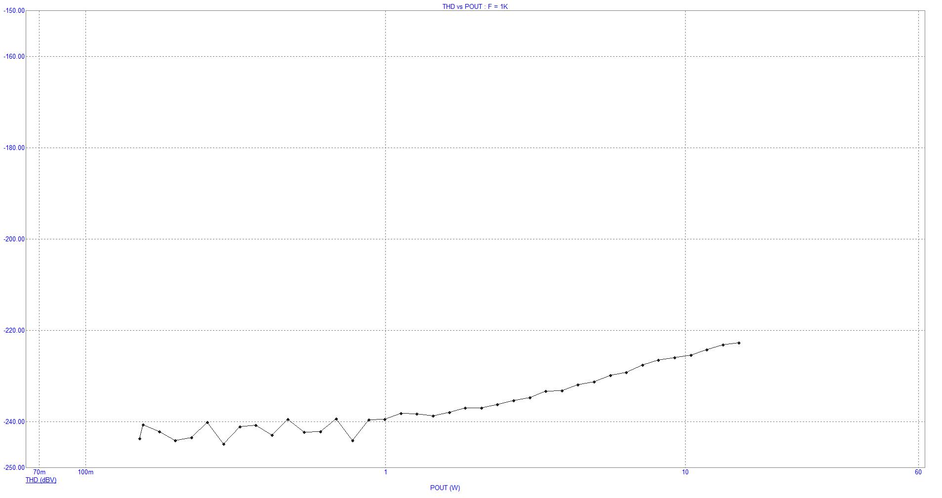

Do you think I throw around schematics like candy ?... That was over 10 years of hard work. I will publish it this year, or next, hopefully.

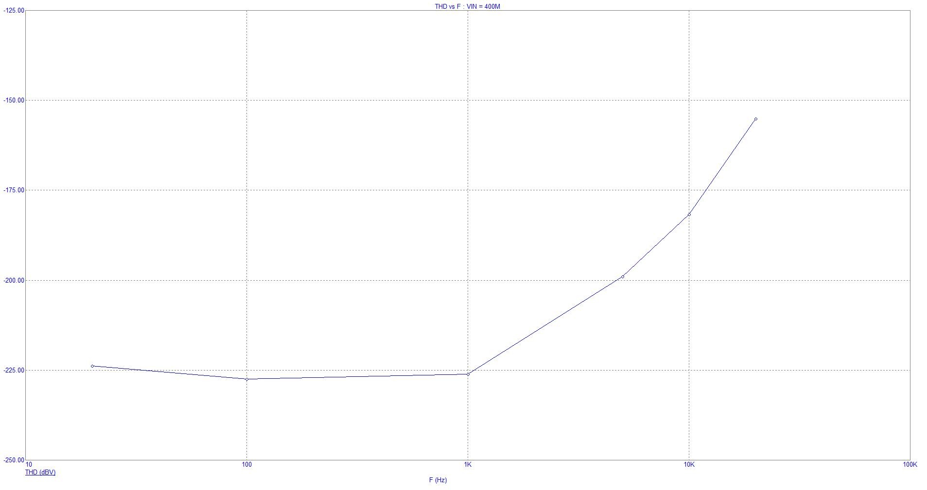

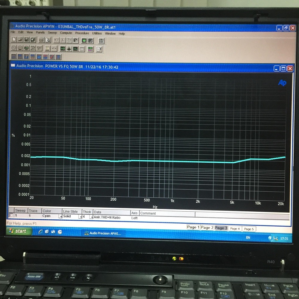

Why brag about something that no one can check? Give at least the result of test of a real amplifieras dadod did.
Okay, here are the main graphs:
Bode diagram with Group Delay;
Loop gain curve on reactive load 50, 100, 500 nF and 2 uF
since your scheme is so secret
