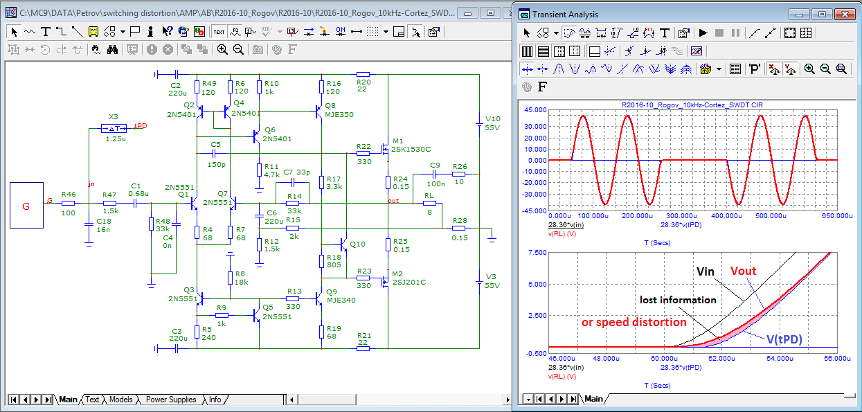

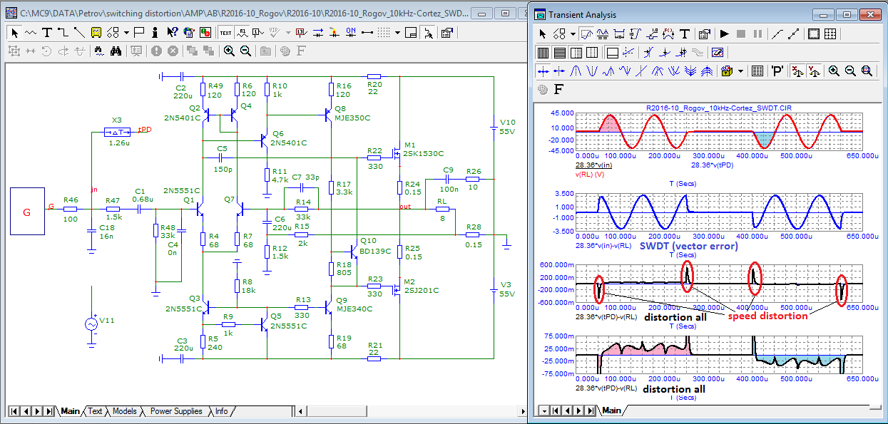

In continuation of the post:
https://www.diyaudio.com/community/...nterview-negative-feedback.94676/post-7252358
for those who do not understand:
high-speed distortion is nothing more than a loss of information. Moreover, the level of losses depends little on the amplitude of the signal.
With a large signal amplitude, the losses can reach 1% or more, and with small signal amplitudes (say, the higher harmonics of musical instruments), the losses can reach much greater values!
For those who want to understand the ongoing processes, here is the modified material
best regards
Petr

Answers that can be applied on lab level (for verification) will be much appreciated.
For your understanding, the so called speed distortion is a non existing distortion caused by a GD that is not flat for the whole spectrum of the testsignal to demonstrate this speed distortion.for those who do not understand:
I proposed you some time ago to get this proven with your testsinal on simple distortion free first order R-C filters with a -3dB point at resp 50Khz, 150Khz and 450Khz.
And yes, the higher the BW the less ultrasonic info from your testsignal will be lost, but this has nothing to do with distortion, it’s just attenuation with 6dB/oct.
Let’s wait and see if you accept the challenge for once.
Hans

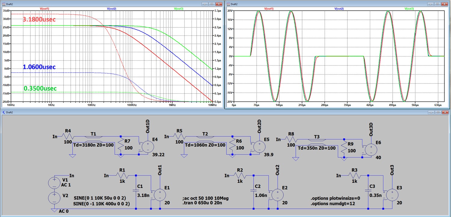

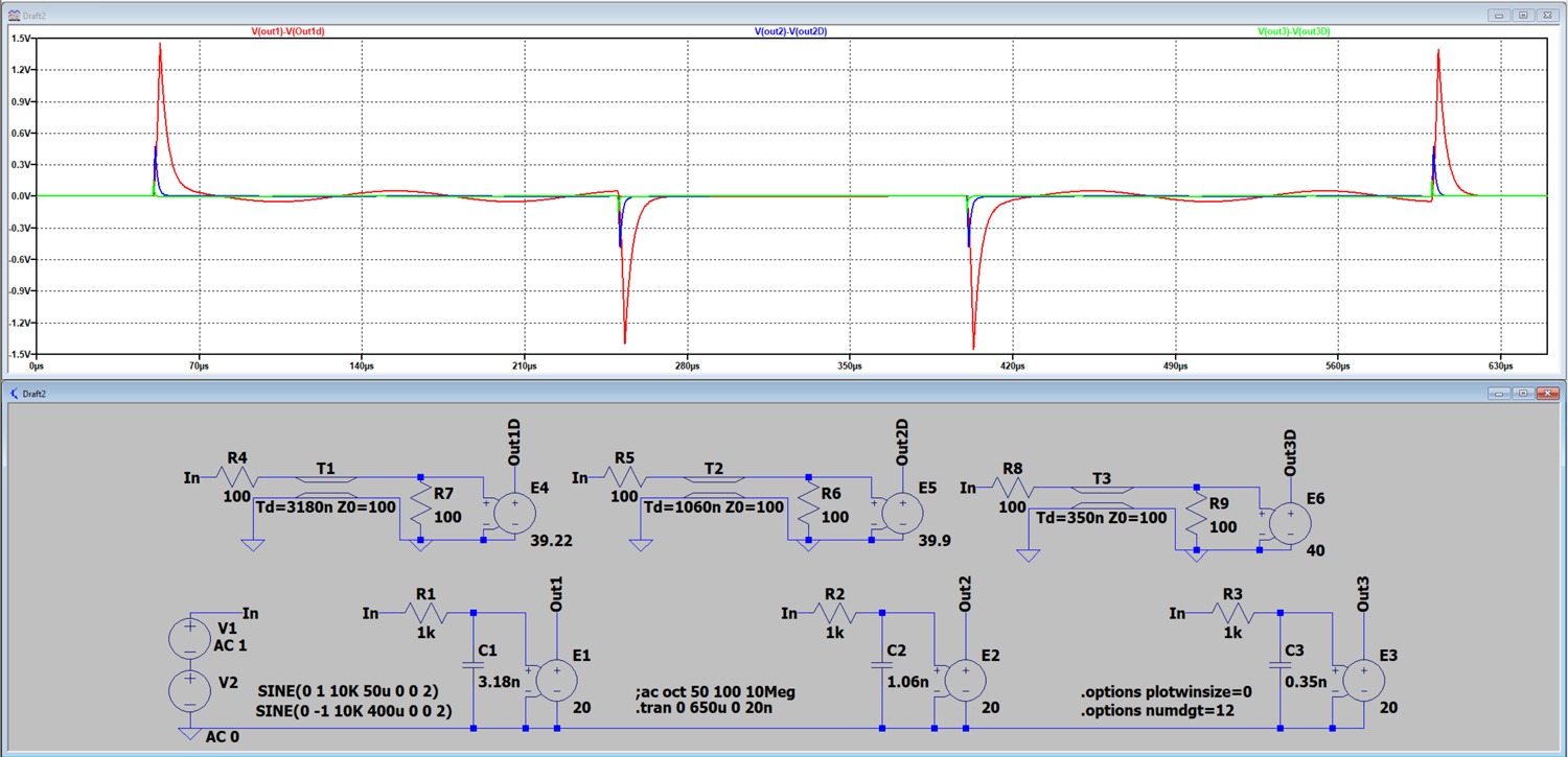

Since Petr evaded the confrontation, I made the sims with 3 distortion free first order R-C filters, their -3dB at resp 50Khz, 150Khz and 450Khz followed by a 26dB gain cell, in this way representing 3 main amps.
In the first image at the left you see Frequency responses and Group Delay, their values written in the plot.
At the right you see the output signals when driven with the same input signal as Petr is using.
In the second image you see the output signals minus the input signal matched in delay and amplitude.
Exactly what was to be expected, the higher the Amp's BW, the smaller the anomalies at start and stop, Petr's so called "speed errors" .
However be aware that all three Amps are free of THD and IMD distortion and that those glitches do not indicate any amplifier distortion.
It's just because their GD's are not flat over the whole input signal's BW , so it's a complete non issue.
Hans

Hans, how about this. Because of the limited amp bandwidth, the higher frequency components cause a higher error amplitude at the differential input pair.
I agree with you that this is not distortion. But can you say, that at these instants the loop gain is lower (as shown by the higher error amplitude) so the distortion reduction ratio of the amp is smaller (the A(ol) is smaller in the A(ol)/(1-beta*A(ol)) classic equation).
That would mean that the existing distortion of the amp is reduced a bit less at those transients than during the steady state periods.
This is of course nothing new - distortion reduction depends on the loop gain that is available.
But it does not generate any (new) distortion. An ideal, distortion free amp remains distortion free also at those transients.
Jan
