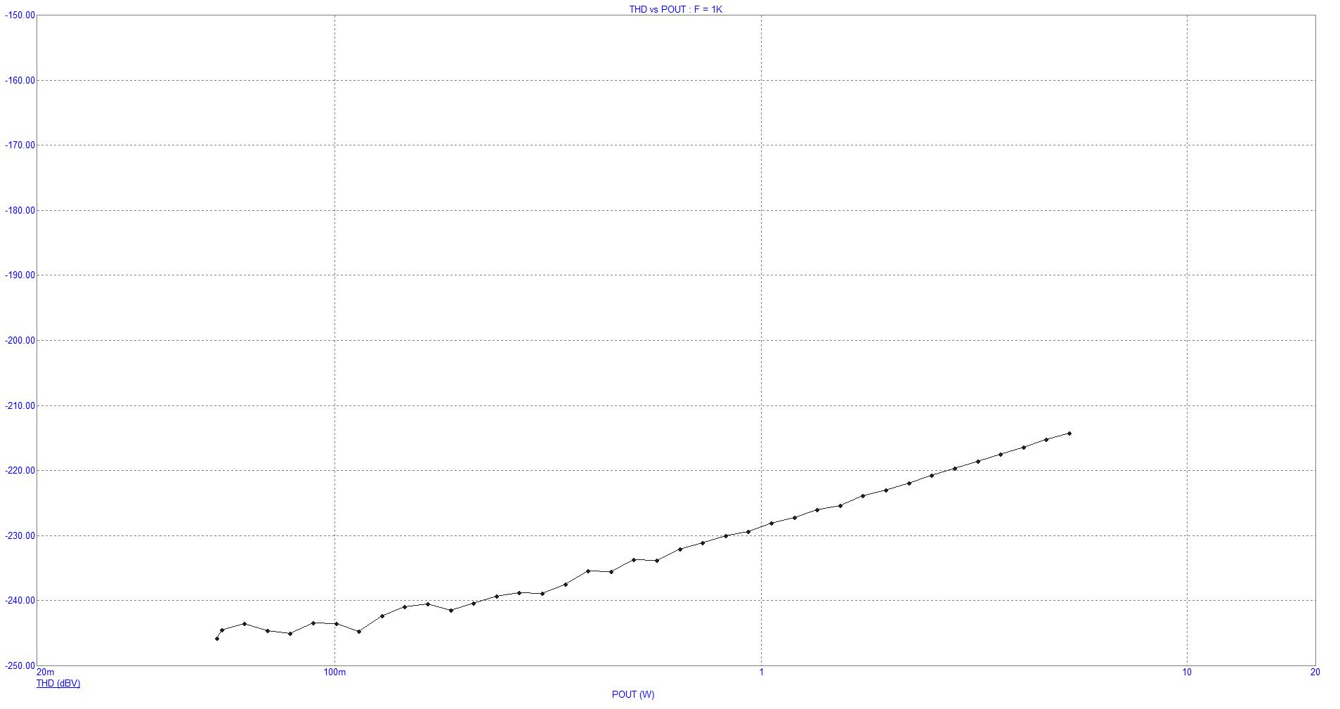

I use the models that come with it.You may be using distortion-free components in MC12, since your plots are way beyond reality.
Additionally to the above: The paper describes a -120dB noise limit for the used AP 2722, that's why 60dB noise gain was used (by adding a resistor between + and - input) to raise the limit from -120dB to -180dB.You are right, I didn't know this AES paper.
It differs from the LA article in that gain is here 0dB versus a gain of 60dB.
at 1.1nV-rtHz input noise and 7.746V out, noise level is down at 20log(7,764/1.1nV) = -196dB referred to 7.746 Volt input.
So either his measuring gear limited the noise to -180dB and/or he used a much wider filter bin width.
And THD was indeed below noise so in that case < -180dB for this unity gain amp.

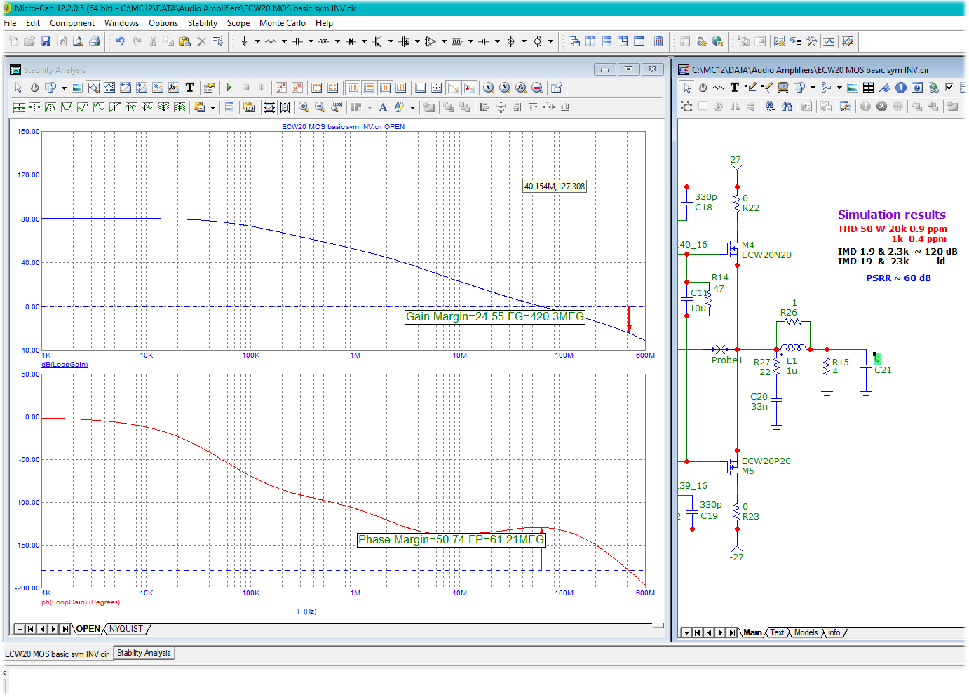

Okay, here are the main graphs:

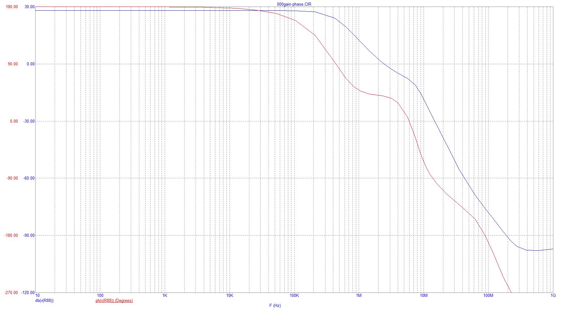

Bode diagram with Group Delay;

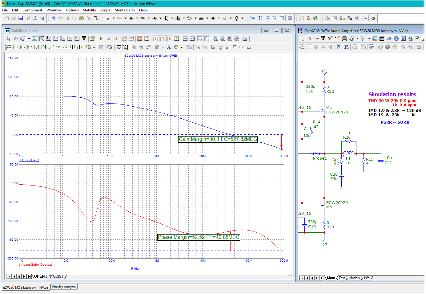

Loop gain curve on reactive load 50, 100, 500 nF and 2 uF
since your scheme is so secret
I‘m using a speaker cable that has some capacitance, no issues.
1 uF in sim pulls down the phase and gives a small peak in hf response.
Transient analysis still works, thd not much affected.
I could include the capacitance of my cable in the final hf compensation.

While loop gain might hide the issue of nested feedback loops, phase margin tells a more detailed story as when using opamp(s), already at fairly low frequencies, the value goes to 90 degrees and from then only gets less. Already ~50 years at Elektor, checking stability with a 1uF cap was standard procedure. So 1st thing with amplifier design is to look at stability, and correct it in a way that loads cannot cause instability.
Why do you want that ?The "good enough" amp I intend to construct is even stable with a 10u load.
Don´t worry, I built my monoblocks during covid and never had any problems.While loop gain might hide the issue of nested feedback loops, phase margin tells a more detailed story as when using opamp(s), already at fairly low frequencies, the value goes to 90 degrees and from then only gets less. Already ~50 years at Elektor, checking stability with a 1uF cap was standard procedure. So 1st thing with amplifier design is to look at stability, and correct it in a way that loads cannot cause instability.

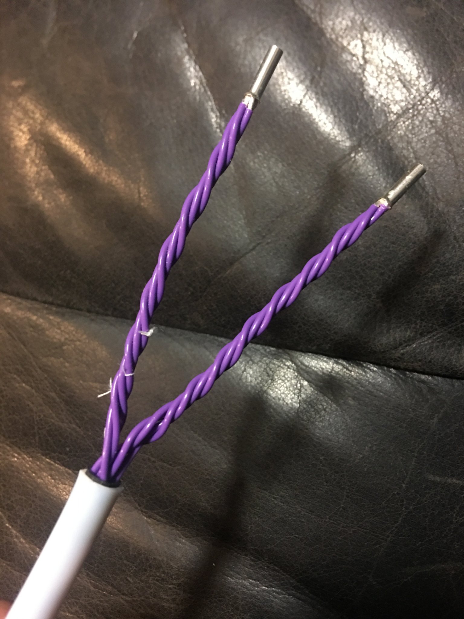

So speakers + network form a bit more complex load. Later I will make braided cable with 16 wires, capacitance will go up...
