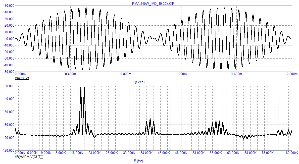

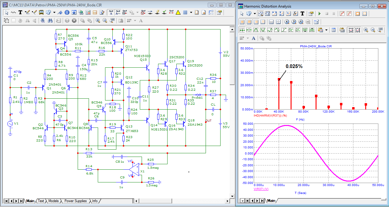

«The problem of these debates is that almost no one comes with real data, real measurements, facts. Instead, general statements and stories are provided, without any quantification, without any possibility of qualified discussion. Then it looks like a spectacle for admiring unqualified crowds.»
I took a look at your report on the amplifier performed almost 1: 1 from the book by Douglas Self. Nothing new. Here are the results of testing his model. Good for a subwoofer.

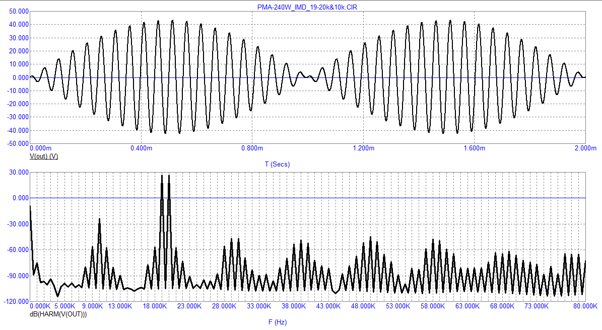

the second IMD test is performed according to Hiraga
John Curl's Blowtorch preamplifier part III

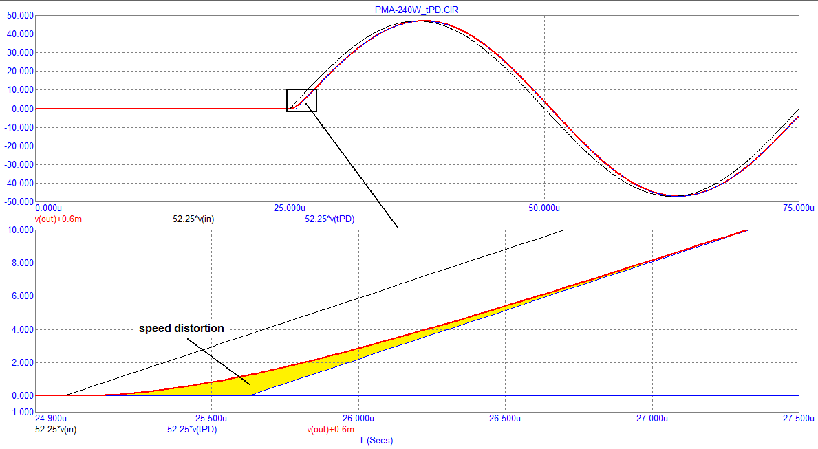

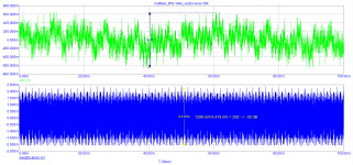

Here is an example of a short burst from just two periods (I don't even remember where I borrowed it from). The pronounced distortions of the first half-cycle are clearly visible (for you FCD). At the end of the burst, prominent oscillatory processes are caused by the behavior of the GD beyond the passband.

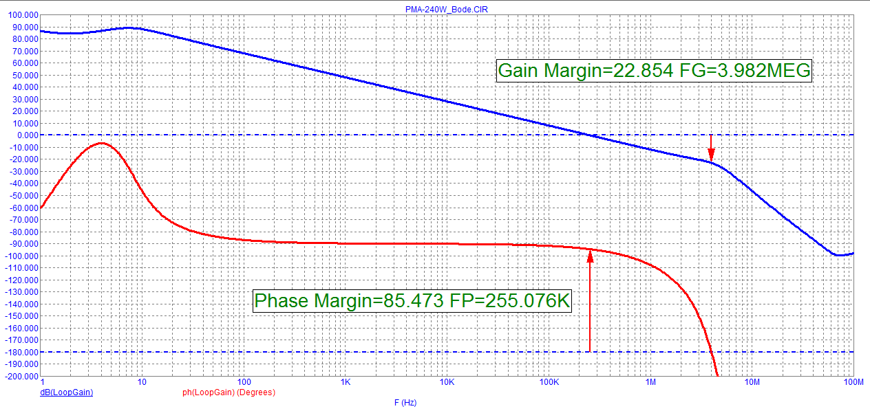

@Fagos: Yes. The quote from Petr_ from the BT thread is taken out of context and actually means the opposite of what he thinks it means.
But also, what has that to do with the discussion we are trying to conduct? I have no idea what amp that is, no idea what 'my report' is, and whether or not it has anything to do with the discussion.
@ Petr_: yes, in the beginning I have mocked you, that was not good and I apologize for that.
To the content: as long as you continue to bring up FCD nobody is going to believe anything you say. FCD is not an audio test signal, and nobody will be impressed with a measurement of an illegal signal.
We have a saying in my country: 'even a donkey will not bump into the same rock twice'. You keep on bumping into the same rock over and over again, maybe believing that some day the rock has magically disappeared. Not going to happen.
You do it again in the previous post: just out of the blue. The graph does not show distortion, it shows the usual ringing from a signal outside the normal operating bandwidth of the circuit. You can't just throw up stuff like that and expect people to decipher it.
I suggested a way forward: use a test signal that everybody can accept because they use it them selves: a low-passed square wave. It should be acceptable by you too as it causes exactly the same errors that you are trying to present.
You obviously are a smart engineering person, but maybe you are not experienced in approaching an investigation in a logical, step by step way, to get to a solution or at least a clear problem statement. That's OK, we all started from zero, but many here are willing to help, just accept it.
I asked a simple question: the error voltages shown on the amplifier from the square wave signal, are they a problem for the amp? Do they cause distortion? If they are a problem, why?
Then if we know what the problem is (if any) we can talk about how to design the amp so it is no longer a problem.

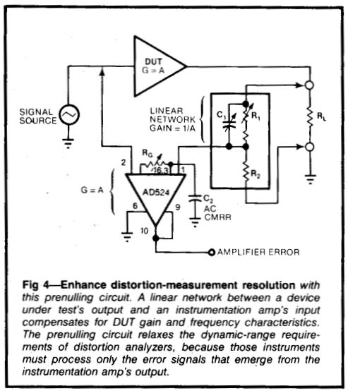

This circuit comes from an ADI App-Note 245 by Wurcer & Jung:
https://www.analog.com/media/en/technical-documentation/application-notes/5866763300941AN245.pdf
I experimented with it quite a bit, that's why I recognized it at first sight.

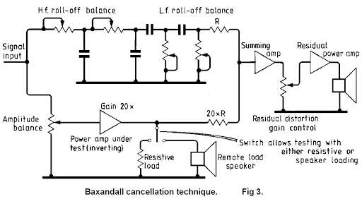

Do you actually think Baxandall and Jung were unaware of what you are trying to claim?
Here are their conclusions after significant study.'
Peter Baxandall
'Provided an amplifier is not overloaded, and provided it has sufficient feedback to make to make the distortion when not slew-rate limiting adequately low, there is certainly no absolute necessity for the slew-rate limit of the amplifier to be any larger than the maximum rate of change, or slew rate, of the waveforms handled by it.
Walt Jung
'Once sufficient linearity and slew rate have
been provided in a design, there may actually be little gained
by boosting SR further (to far beyond that necessary).
The optimum audio amplifier is best designed with all contributions given proper perspective'

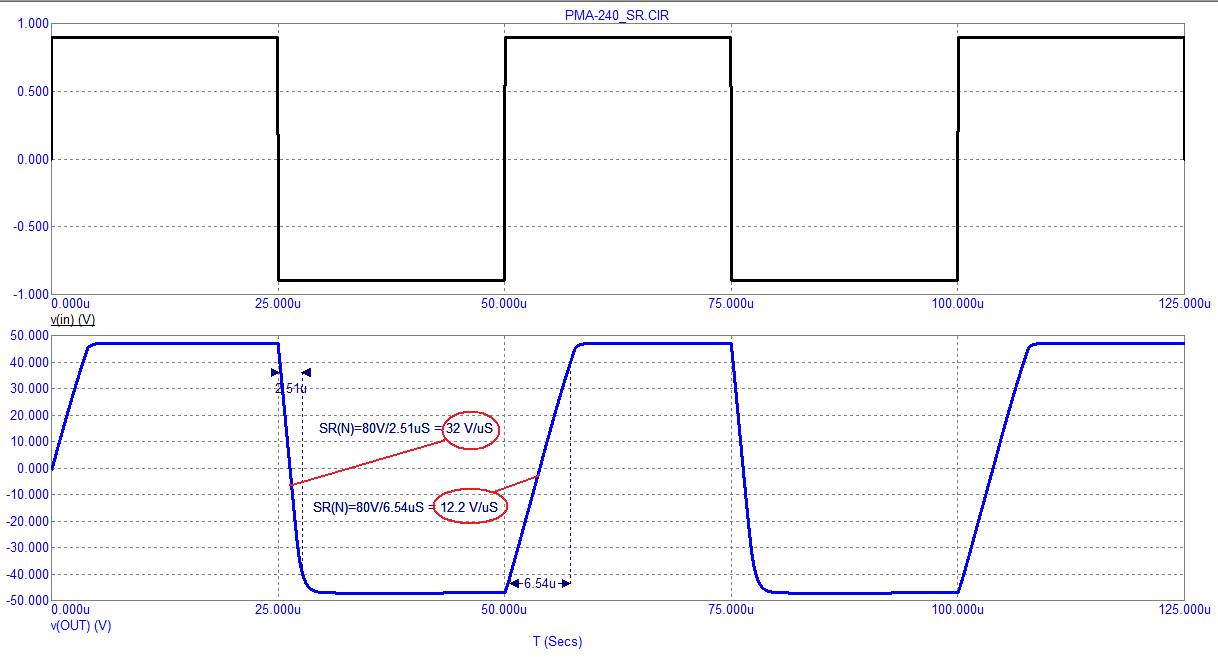

Jan has repeatedly tried to tell you that the square wave test achieves the same thing as your FCD test. I have demonstrated this. Yet you assiduously avoid addressing this engineering perspective. Instead, there is repeated obfuscation with tangent topics.
One of my amplifiers is in a commercial recording studio. What does this mean? It means nothing because it does not contribute anything, not one iota, to the engineering discussion at hand.

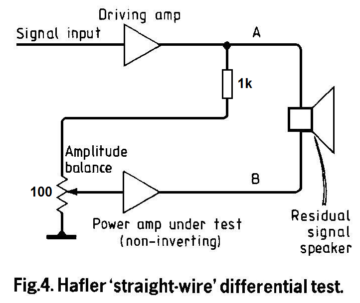

Presumably, Carver uses the Hafler test, which I have already quoted along with the Baxandall test.

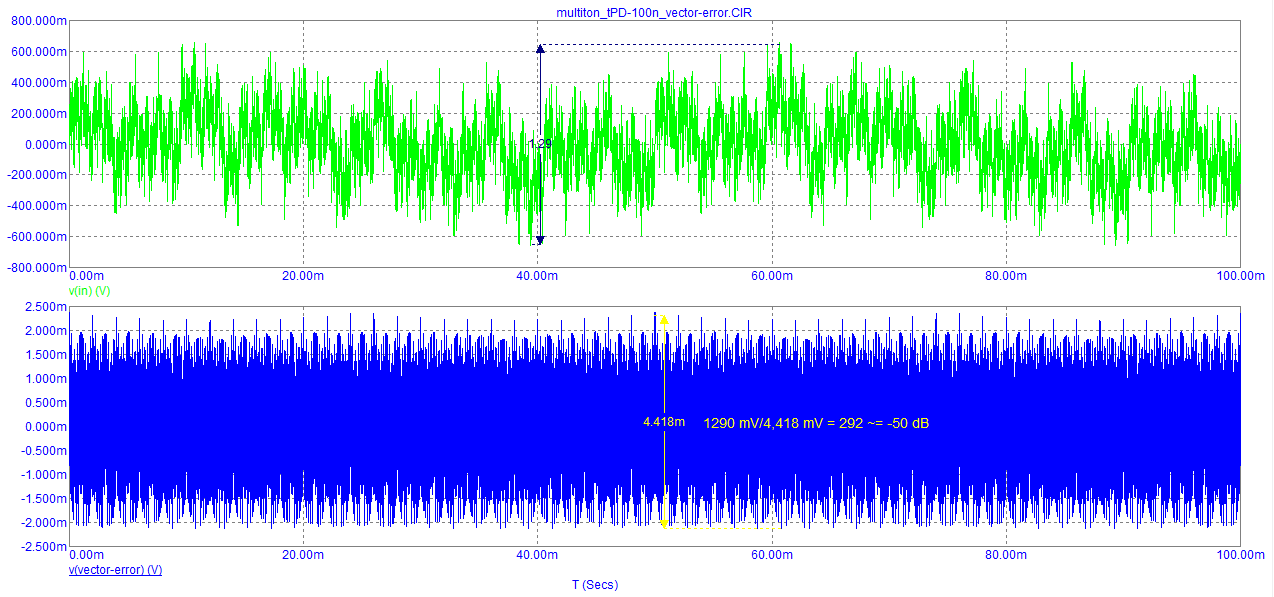

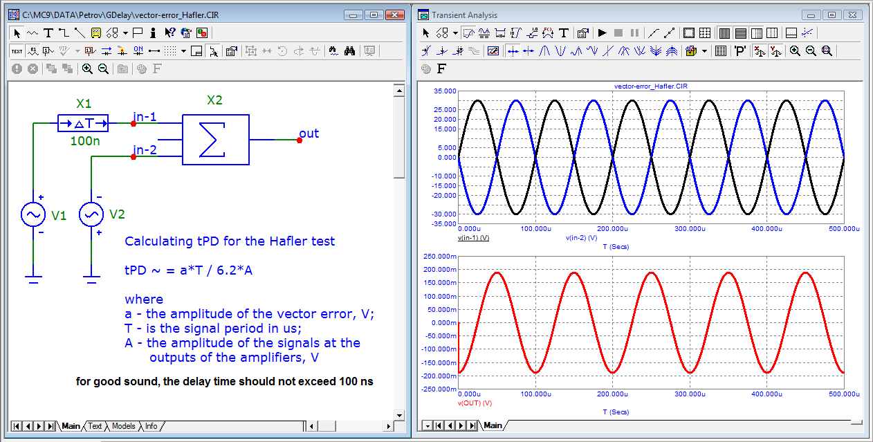

What is the attenuation of the vector error signal by 50 ... 70 dB. This means that the level of the vector error is 300 ... 3000 times less than the signals at the outputs of the amplifiers. Let's imagine that we use a triangular signal with a frequency of 10 kHz (100 μs period) as a test signal, while its amplitude at the outputs of the amplifiers is 60 V from peak to peak. If the signals at the outputs of the amplifiers are equal, the difference signal will be a rectangular signal with an amplitude of 0.2 to 0.02 V.
Time Propagation Delay is calculated by the formula:
tPD = aT / 4A
where
a - is the amplitude of the rectangular signal at the load;
T - is the period of the triangular signal;
A - amplitude of the triangular signal at the outputs of the amplifiers
In this case
tPD (max) = 0.2 * 100/4 * 60 = 20/240 = 0.083 μs = 83 ns
tPD (min) = 0.02 * 100/4 * 60 = 2/240 = 0.0083 μs = 8.3 ns
I have repeatedly mentioned that the signal propagation delay time should not exceed 100 ns. As you can see, Carver is doing just that.

Will you make a comparison of the signals before and after the filter? Maybe we'll laugh together, who knows...
Can you explain where this formula came from and how it was obtained?Presumably, Carver uses the Hafler test, which I have already quoted along with the Baxandall test.
tPD = aT / 4A

In addition, as far as I understand, Carver uses a real signal, which means that his band is limited from the source. A triangular signal will probably give us inflated values of distortion and the comparison will not be correct.
I will also add that according to my estimates, you have a group delay on a sinusoidal signal with a frequency of 20 kHz and 0.03% should be about 200ns, which is equivalent to the cutoff frequency of the first-order filter about 770kHz. This will give the desired value of the input-output vector error.

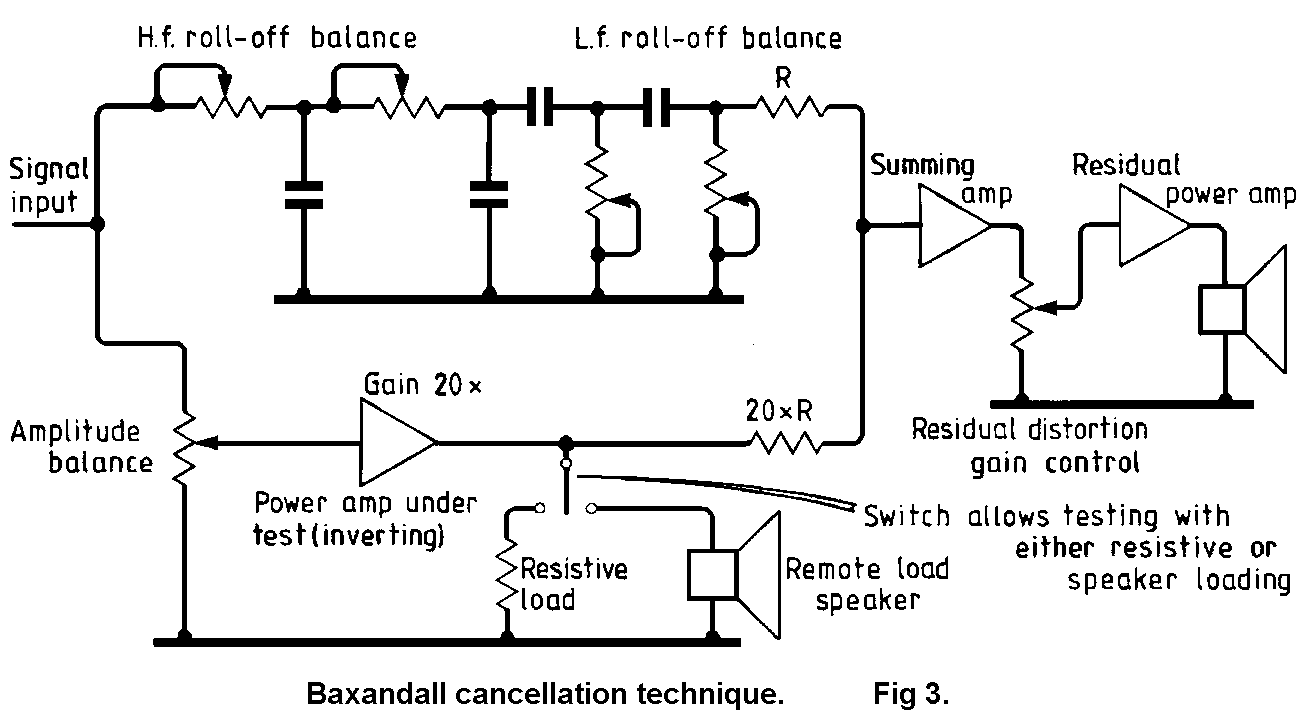

AKSA talked about testing using the Hafler method, in which there is no need for phase correction. Baxandall phase correction is difficult to perform with sufficient accuracy, moreover, it is undesirable since it excludes phase distortions introduced by the amplifier.
In my opinion it's wrong to talk about phase distortion in this context.
The correction network corrects for the low pass caused by the amp. This is linear and distortion is caused by non linearity.
/örjan
I agree. Phase distortion is a measure of varying phase shifts in a signal chain. It is a linear phenomenon that does not create new signal frequencies.
On the other hand, harmonic distortions are caused by non-linearities in a signal chain and do create new signal frequencies, harmonics of the fundamental tone(s) and intermodulation products.
Although phase distortion and harmonic distortion use similar words, it is important to understand that the causes and effects are completely different and should not be confused.
The Baxandall test is designed to measure non-linear harmonic distortion by suppressing the fundamental in the amplifier output. The amplifier will have phase shift so to cancel its output by subtracting the fundamental, you need to introduce the same phase shift in the subtraction chain. It generally involves tweaking R-C attenuators.
This phase distortion/phase shift and its correction do in no way limit the ability of the method to measure harmonic distortion.
