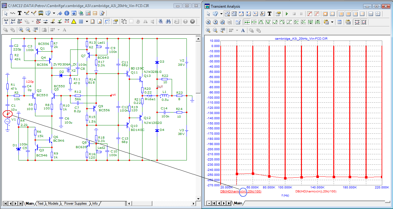

peufeu:
“This amp is trash, but it's not because open loop gain is too high, it's because it is way too low ”
and how many "happy owners" of this trash?

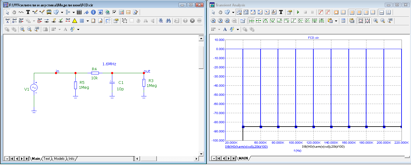

accidentally took the wrong model

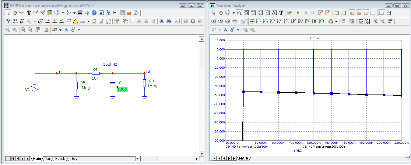

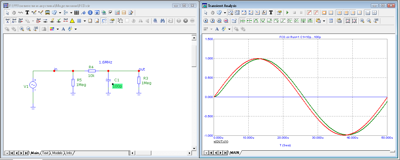

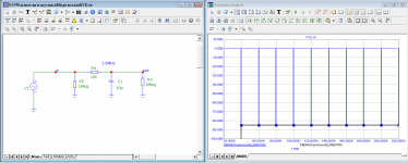

Let's simulate the spectrum of an ordinary first-order low-pass filter chain with a cutoff frequency of 160 kHz (for example) and a frequency of 1.6 MHz. See the difference on the charts through transient analysis, as you did above. It can be seen that this has nothing to do with the nonlinearity of the amplifier and characterizes it only as a low-pass filter. By disabling the input filter, you cannot exclude the bandwidth of the amplifier itself, which pushes you to try to make it more broadband.
So it looks like a sine
And this tail falls into the time window of the Fourier analysis.

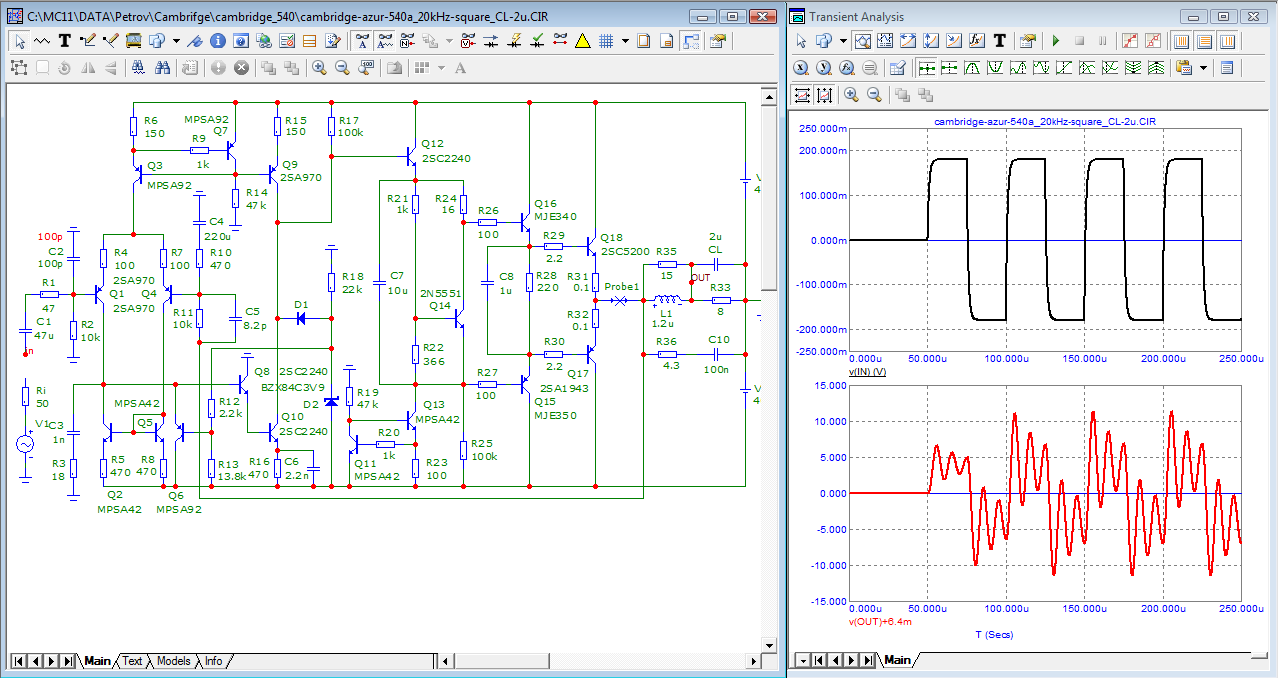

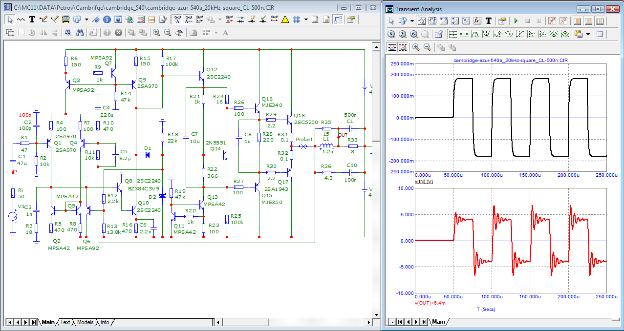

Graham Maynard (author of FCD) has repeatedly drawn attention to the negative impact of the choke at the amplifier output on sound quality.
John Curl also believes that amplifiers to amplify an audio signal should work stably without an additional choke, he argues that there is more harm than good from a choke and tries to develop amplifiers without a choke.
Here are the results of testing the amplifier with choke:
The output impedance stabilizes only in the 3rd period. This is how the amplifier will respond to the loudspeaker back EMF.
The amplifier is too tough for the effective load in the form of 0.5 and 2 μF.

You don't know, because you don't know what comes next. Does the signal continue in the same manner? Is it a burst? The essence of the FFT in the sim is that it assumes the signal is periodic, as if the signal continues in the same way as it is shown.
In your case, it appears that the beginning and the ending of the signal is at exactly the same phase point, so for the FFT this connects exactly and there are no discontinuities, and no harmonics created other than by the signal itself.
The graph shown by peufeu before illustrates it beautifully. It should be clear that by assuming the periodicity of the signal you use as input, you create discontinuities in the signal when the FFT assumes it is periodic, and this creates a whole slew of harmonics.
Jan
Yes, he is using FFT on a signal that looks periodic but is not, because the discontinuity is hidden by the way the signal wraps around the display. If you put it in the center it becomes visually obvious. This is an incorrect way to use FFT, it does not work.

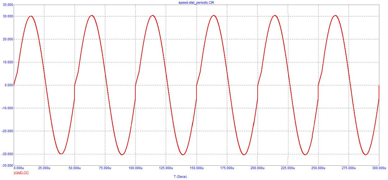

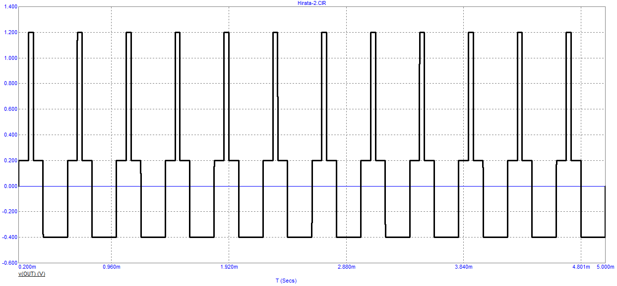

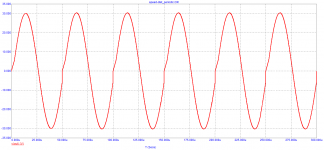

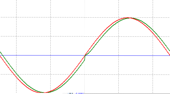

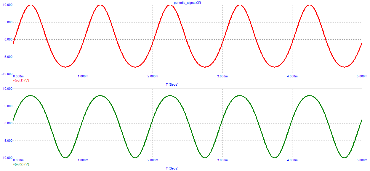

OK, but is this test signal periodic?
This is how the MicroCap simulator sees the signal of the first period at the output of the amplifier, adding to it the required number of periods in front and behind, so that the signal becomes periodic.
Jan, if I understand correctly, then the output voltage surges up and down when the signal crosses zero do not bother you and you normally treat it as periodic.

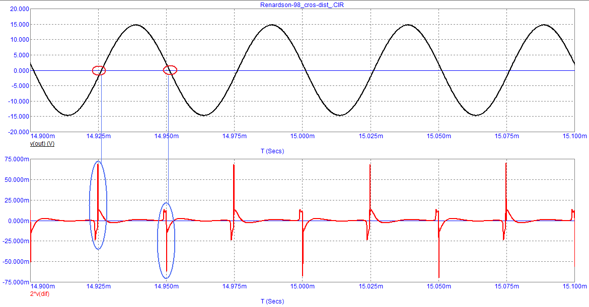

So that there are no surges in the signal of the first period (as MicroKap sees it), then make amplifiers according to the recommendations of Cyrill Hammer with a signal propagation delay time in the entire audio range and far beyond it, only a few ns
Consider that MicroCap sees the first period of the signal with crossover distortion at one zero crossing of the signal. That's all. The level of this crossover distortion depends only on the tPD.

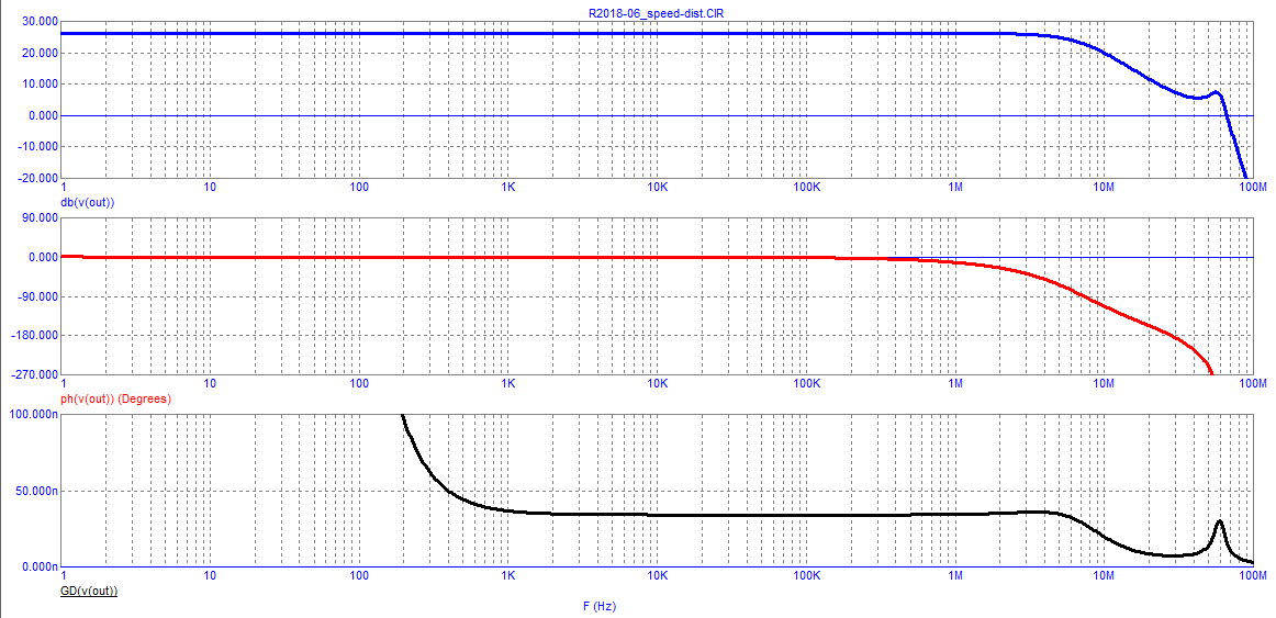

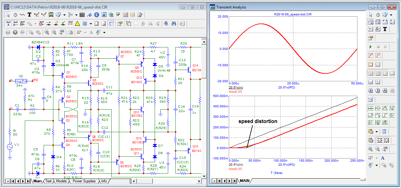

even a signal propagation delay of 34 ns will give an analogue of crossover distortions at one transition much less than in the previous example (with an amplitude of no more than 30 mV)
In an ideal rectangular signal, the rise time of the edges is zero, only there these edges are for the entire signal amplitude from peak to peak (tens of volts).
In this case, MicroCap splices in exactly the same way, only the amplitude of the front at the splice in one of the zero crossings is from ten mV, up to several Volts - it depends on the signal propagation delay time (tPD). That's all.
Is it hard to understand?
So now we are discussing cross-over distortion? It is not very honest to change the subject every time you are asked a serious question. It is very childish actually, and you never learn anything doing it. How old are you?
But yes, of course cross-over distortion does bother me. I want to minimize it in an amplifier.
How you can think it does not bother me I don't know, did you pull that out of your hat ;-) ?

Jan, I don’t understand who you mean. Or you just enjoy flooding.
Crossover distortion and velocity distortion are completely different types of distortion.
Crossover distortion occurs whenever the signal crosses zero.
Velocity distortions occur both when the frequency changes and when the signal amplitude changes.
I have pointed this out many times. As for the distortions of the first period (what Graham Maynard was looking at)? then they arise at the very beginning of the period and depend on both the magnitude of the group delay and its behavior both in the audio frequency band and behind the band.
I just gave an analogy between different types of distortions to make it clearer how MicroCap sees them.
