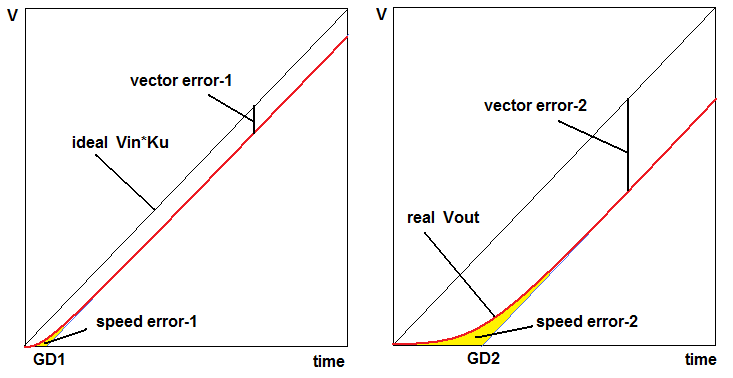

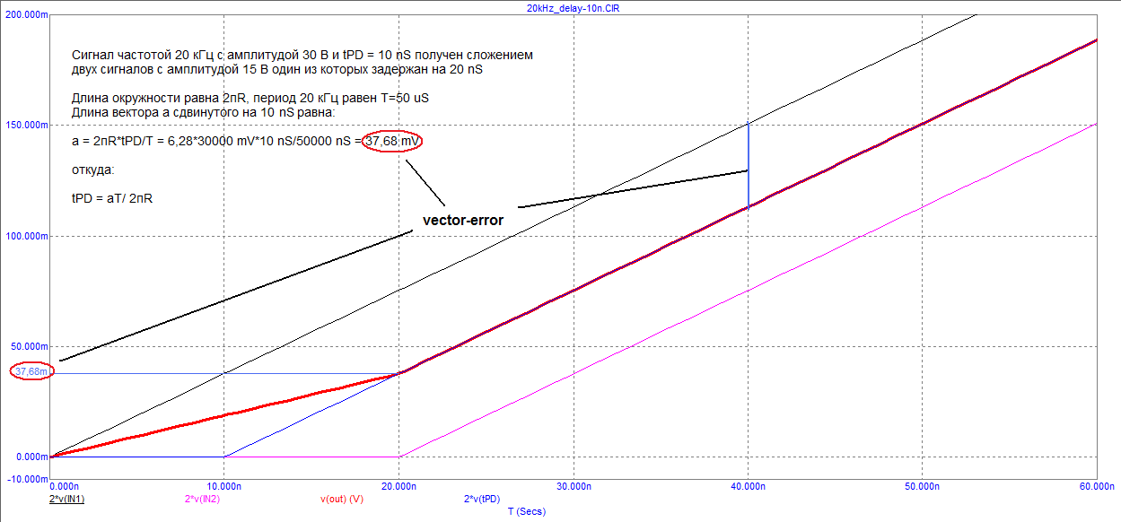

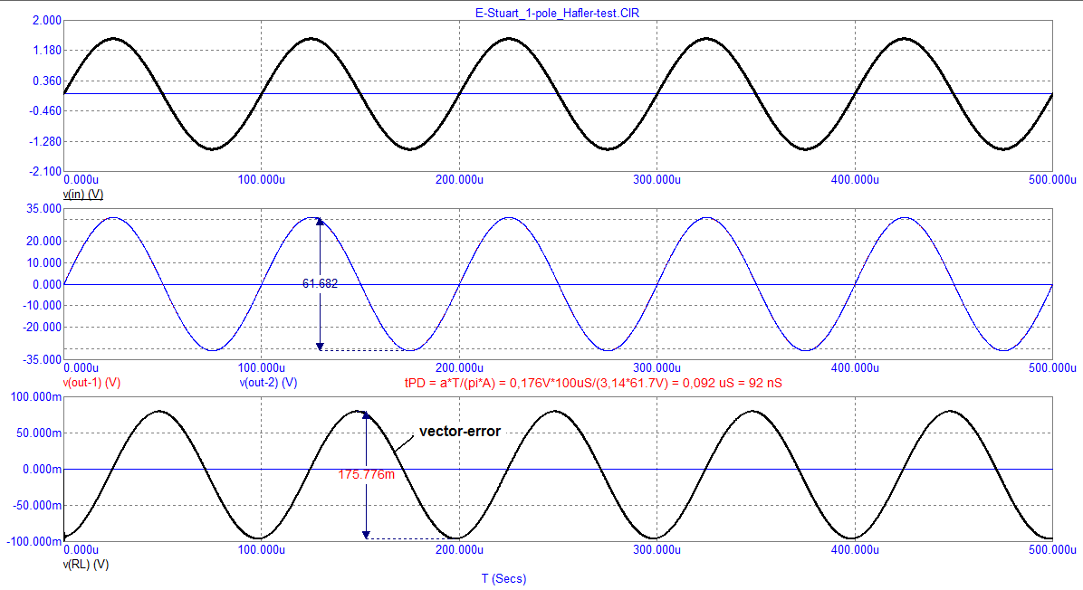

Hafler's test measures vector error.
According to the AKSA message, the vector error in the Hafler test should be in the range from minus 50 dB to minus 70 dB (or from 1/3000 ... 1/300 of the output voltages).
With 60 V output signals, the vector error in the worst case should not exceed 200 mV.
And what do we have in the examples discussed above?

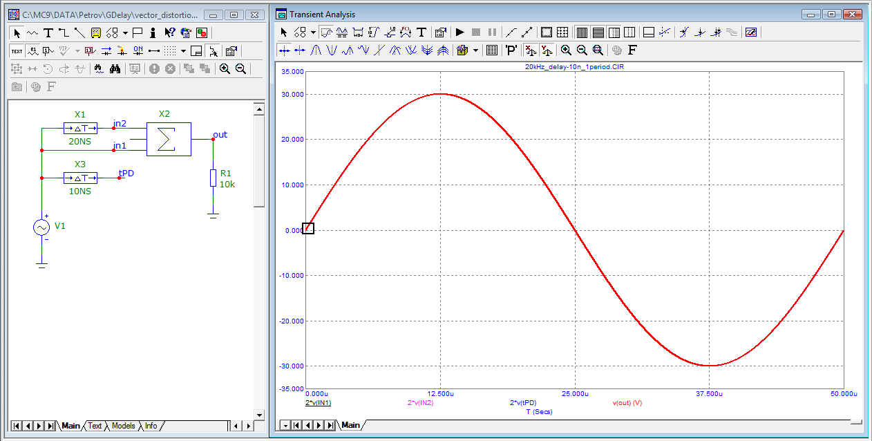

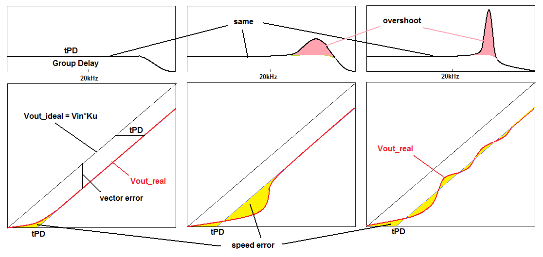

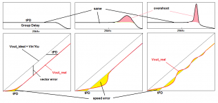

the sound quality is strongly influenced not only by the signal propagation delay (tPD), but also by its behavior both in the passband and beyond the bandwidth. Here are some possible examples ...

And now please add what the square wave looks like, corresponding to these three variants of the behavior of the delay time and the signal shape. I think it will be very informative.the sound quality is strongly influenced not only by the signal propagation delay (tPD), but also by its behavior both in the passband and beyond the bandwidth. Here are some possible examples ...

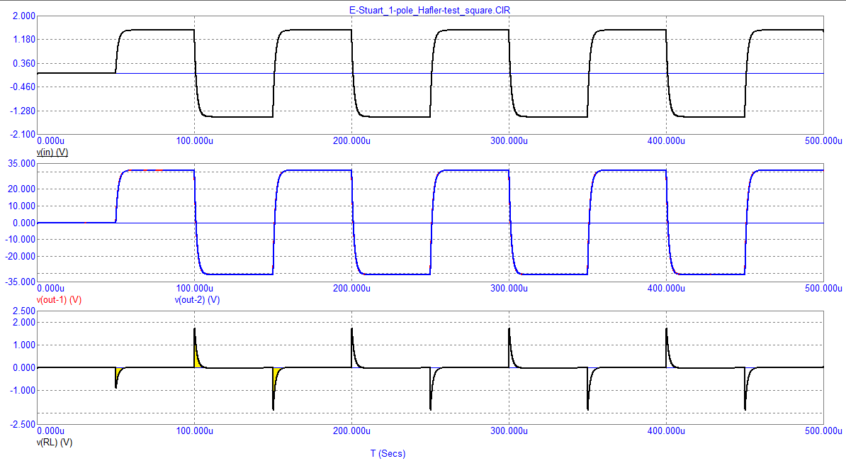

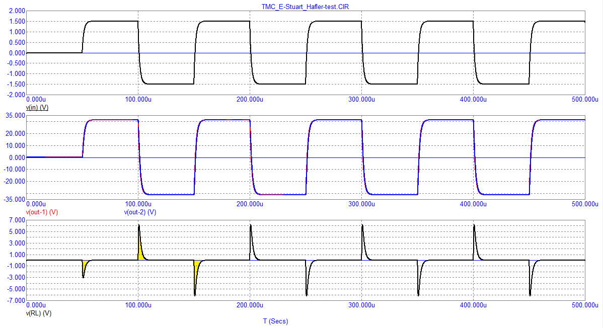

Hafler test using a rectangular signal and a 100 kHz low-pass filter (as in DIM-100). No comments
Which amplifier do you think will more accurately convey the smallest nuances of sound material?
No difference, because those differences in 100kHz low passed reproduction have nothing to do with 'accurately convey the smallest nuances of sound material'.
The 100kHz low pass is a way to characterize the amp transfer function. And you showed that a 'slower' amp has a larger error with this signal than a 'faster' amp.
But it is not the same as a normal audio signal. Audio has much less bandwidth and not a linear distribution. Therefor, you cannot extrapolate the results of this test to your question.
If you would want to know the audio differences, use a signal that looks more like audio.

Now we are getting somewhere.

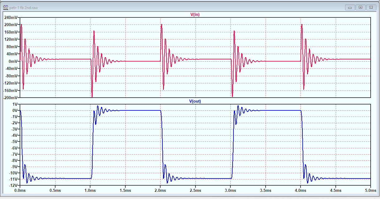

Lock at the error spikes, on each time we have a fast rise time/high frequency content. Not only in the first cycle!
/örjan

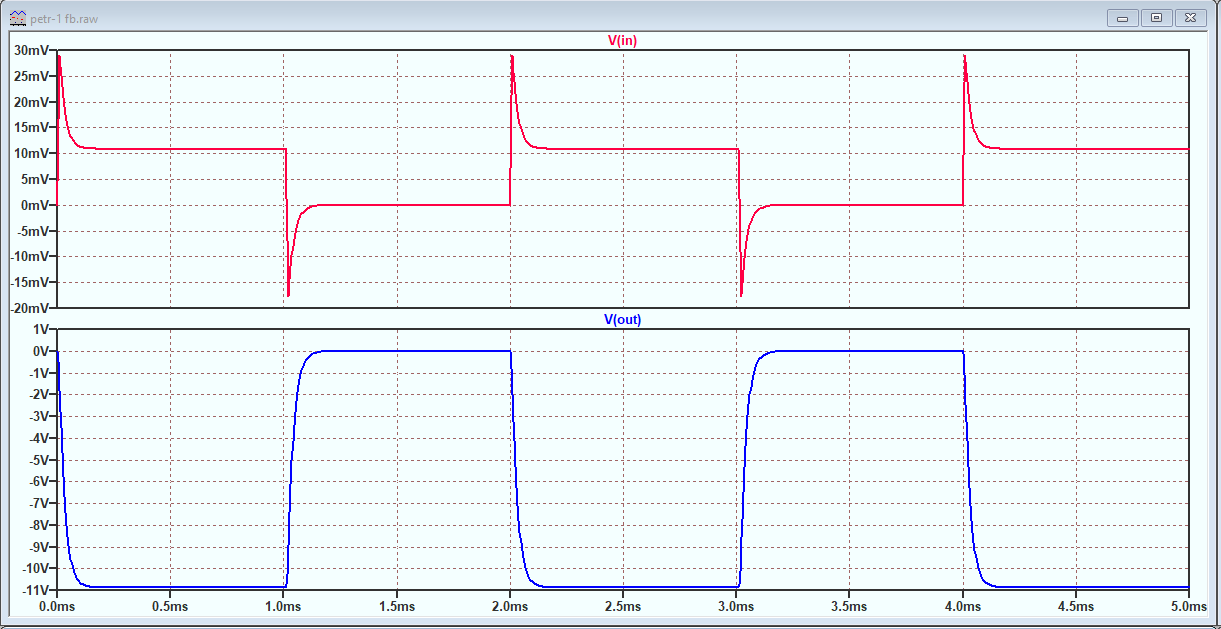

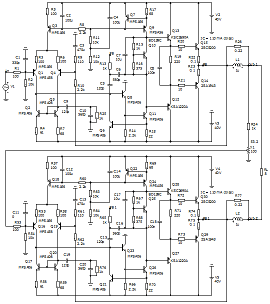

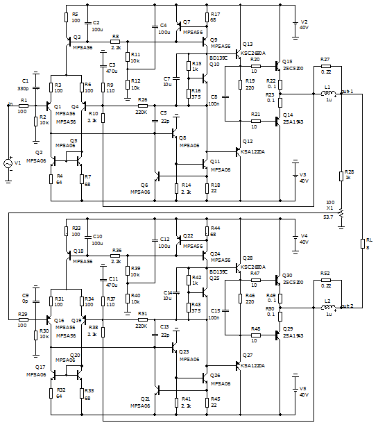

The simulations above give a good impression on the response and stability of the amplifiers. Both are well behaved as shown by the absence of any ringing.
The conceptual form is shown as petr_1 fb below. It is a amp with a 2nd order roll-off, where the 2nd break frequency is 100 times the first. Many audio power amps show a similar transfer characteristic. Both have an ol gain of 60dB, with a cl gain of 11.
The second example, petr_1 fb 2nd, has the two poles at the same frequency. That means that stability is marginal because the roll off leads to high phase shift while the gain is still not zero.
Jan
Jan

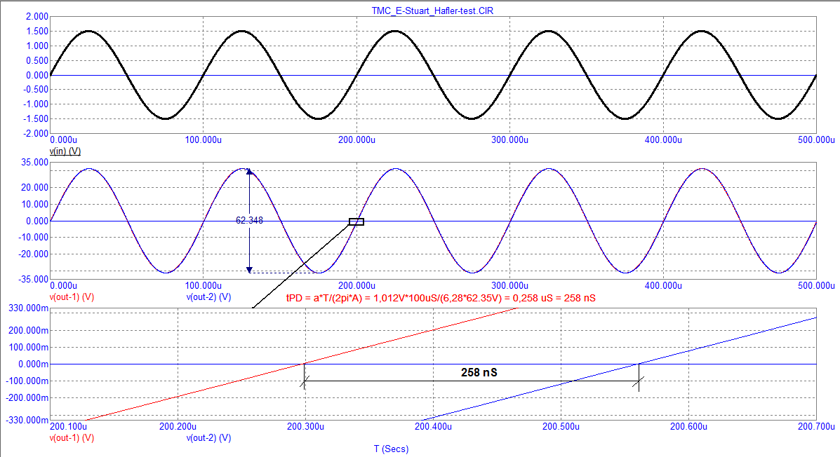

In my opinion, it is necessary to legitimize the Hafler test in the form of a standard along with the DIM-30 and DIM-100 tests.
As you can see, the test is extremely simple, does not require special measuring instruments, you can test on any signals, including real sound ones.

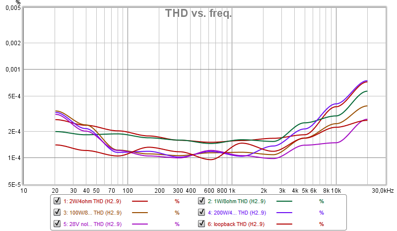

I can show you whole set of real standart audio measurements, as THD vs. freq, THD vs. pwr, spectra for various signal and power for DIM, TIM, CCIF, IMD, multitone and many more , which I make very often,one sample is attached. But you prefer "virtual reality" and believe only in simulations and very unprecise indicative Hafler test...So it has in this case no sens to argument with facts..
