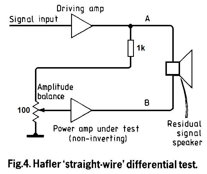

petr_2009, If Hafler should tell us something about audible artefacts ( about changes in sound), so output (pin "out" in your picture) have to be bandlimited to e.g 80kHz, as standard distortion tests, or to 20Hz-22kHz. Because no one can hear and no speaker can reproduce 100-500ns peaks...And Hafler slowly changed to Baxandall test..
Influence on sound have only products on amplifier otput, which are in audioband . Any potentially audible sound change must lie in audioband. And must carry "audible" energy. So simple is it...

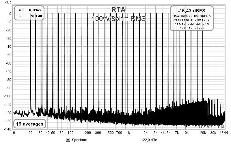

The Hafler and Baxandall tests are too primitive to give any consistent and worthwhile results with modern very low distortion audio equipment.
The best methods like multitone testing gives all kinds of distortion and noise in the presence of signal, coming very close to actual music conditions.
If you read for instance Belcher from 1978 (!) you already see the contours of such test methodologies, but the lack of high performance low cost digital number crunching at the time led it slide into forgetfulness. But they very well knew the issues and the conceptual solutions, and I am sure people at AP like Rich Cabot knew these papers by heart!

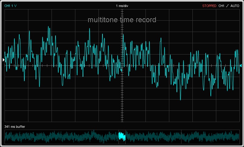

I often use multitone test, attached is the measurement of the same amp as THD/ freq from yesterday . Also time record of the same signal, looks like a random noise.

BV, with your experience to assemble a Hafler circuit in 3 minutes, test on the same multi-tone signal and on a 10 kHz sine wave and show the oscillograms. As you can see, the signals are in the audio range, and not what Jan Didden writes about. Vector distortions are perfectly described in the book by Jiri Dostala, calculations and graphic illustrations are provided.
Vector distortion is directly related to signal propagation delay and is proportional to GDelay. It is known from psychoacoustics that the human ear reacts most of all to GDelay.

Why should I do it?? I tried it about 25 years ago..It will be lost time and no new information gained, this test is very inacurate.
Read again
Musings on amp design... a thread split.
you will find answers why it s so..
And try think about facts, that time delay alone and band limiting are not nonlinear distortions, they create no new artefacts. And that real music signals are always bandlimited to audioband , maybee harmonics of instruments sound are slightly higher. But 100kHz bandlimit is more than enough.
But no in 100-500ns range :)

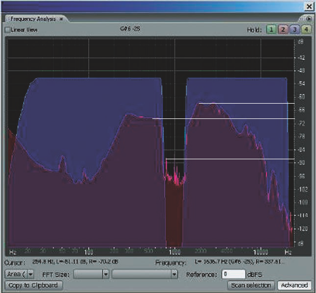

as practice shows, even a multi-tone test does not give a true picture of the quality of the amplifier.
At the 126th AES Congress, Professor Farina presented tests on noise signals in which the spectrum changes chaotically, like in audio signals. In the example shown, an octave of noise in the 1 kHz region has been clipped. The test shows that the dynamic range of the amplifier was only 18 to 26 dB. The distortion level reaches 10% or more.
At the 131st AES Congress, J. Atkinson noted that up to this day in sound engineering there are problems to which modern specialists have no answers.
Judging by the reasoning of some gurus, amplifiers with THD = 0.3% on acoustics with THD = 3% should sound the same. But even amplifiers with THD = 0.03% or less sound differently for some reason.

Facts about this Farina AES session
The method is based on the analysis of the distortion products, such as harmonic distortion products or intermodulation effects, occurring when the system is fed with a wide-band (noise..)signal. Removing from the test signal a small portion of the whole spectrum, it becomes possible to collect and analyze the not-linear response and the noise of the system in that “suppressed” band. Changing continuously the suppressed band over time, we get the Silence Sweep test signal, which allows for quick measurement of noise and distortion over the whole spectrum.
Not about chaotically changes in spectrum, but "Changing continuously the suppressed band over time"..Another way to measure nonlinear distortions, way to see distortion artefacts falling in this free band. Nothing about "unexpected" clipping and so. Another sidestep by peter_2009..

Yes. It is of technical interest, a typical University paper. But for practical measurements, the multitone in REW (or in an AP for the privileged ;-) is much easier to use.
As I said before, a $ 100 soundcard and the free REW runs rings around any of these old, complex, insensitive and inaccurate tests like the Hafler or Baxandall. Technology has moved on, and I have stuff on my hobby test bench that was unheard of 50 years ago even for professionals.
