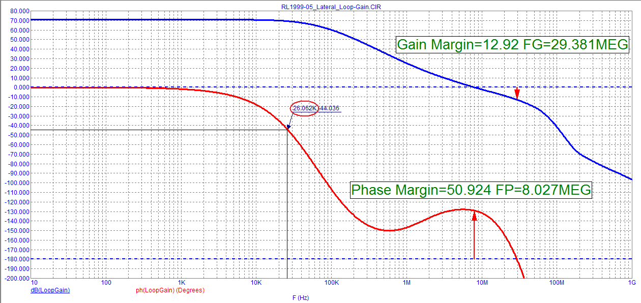

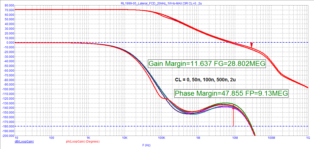

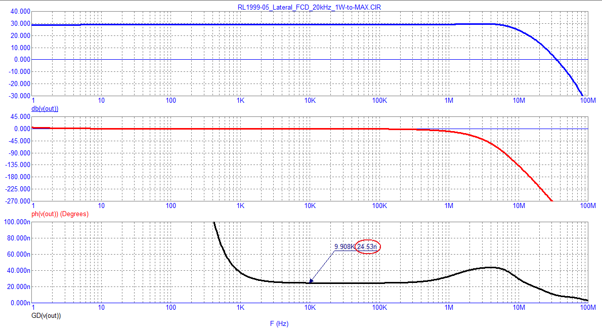

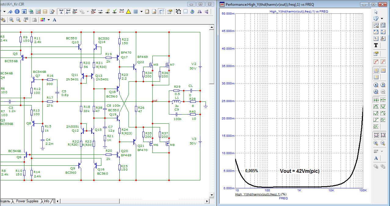

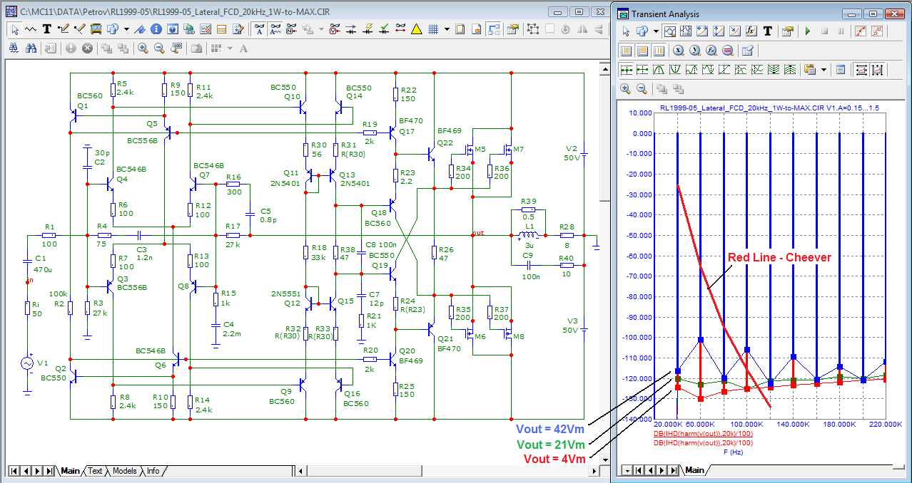

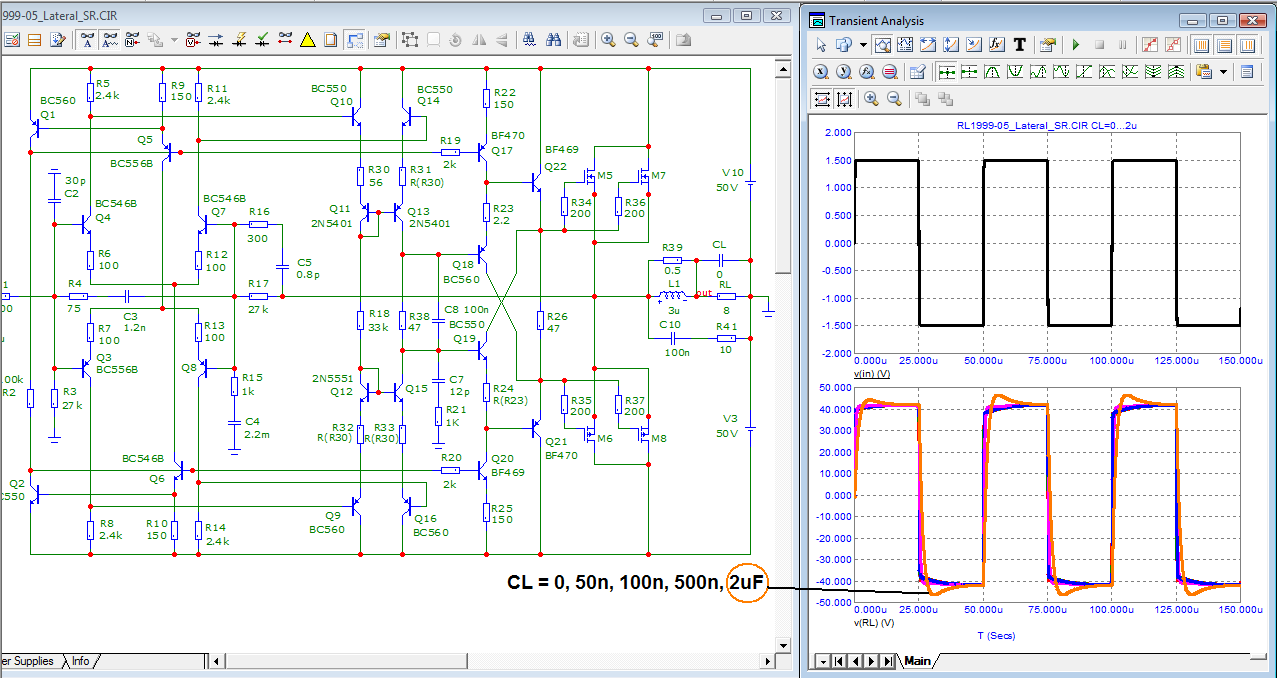

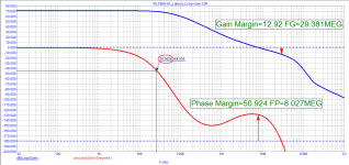

I decided to check what the 1999 design amplifier would be like if the output stage were made on laterals. That's what came out of it

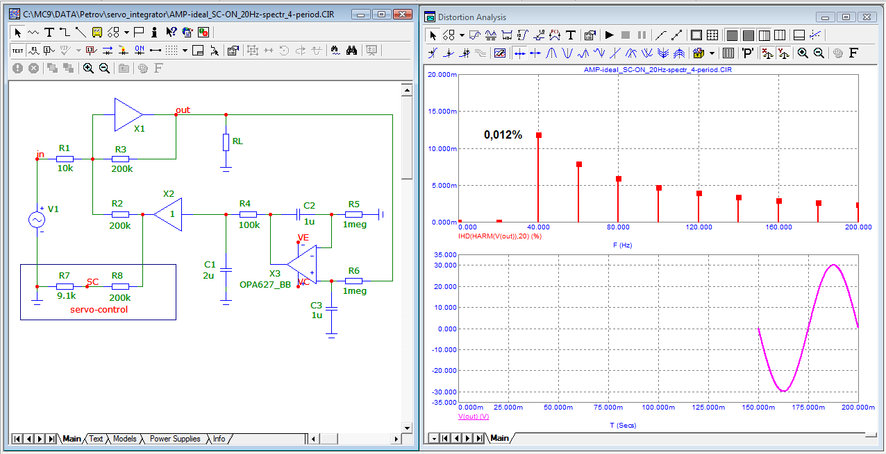

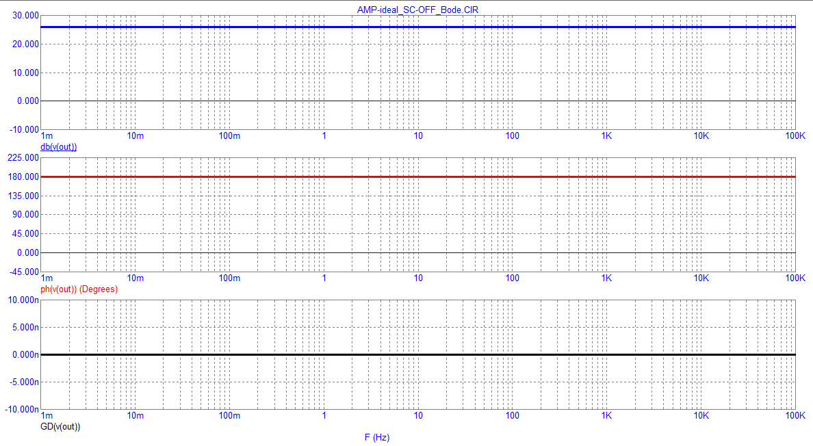

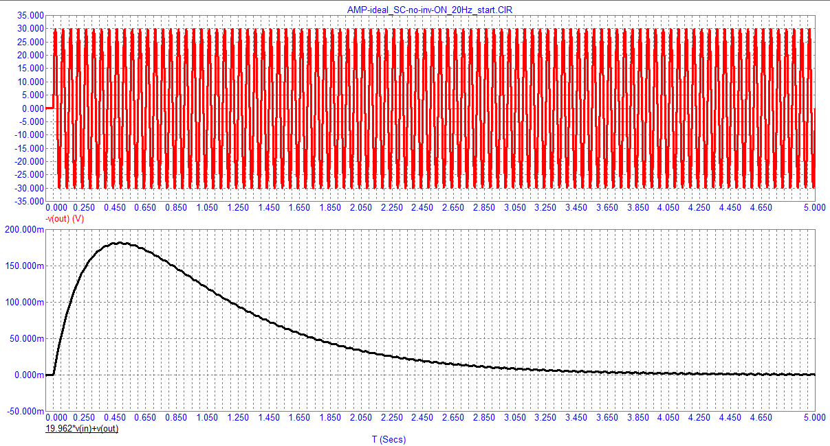

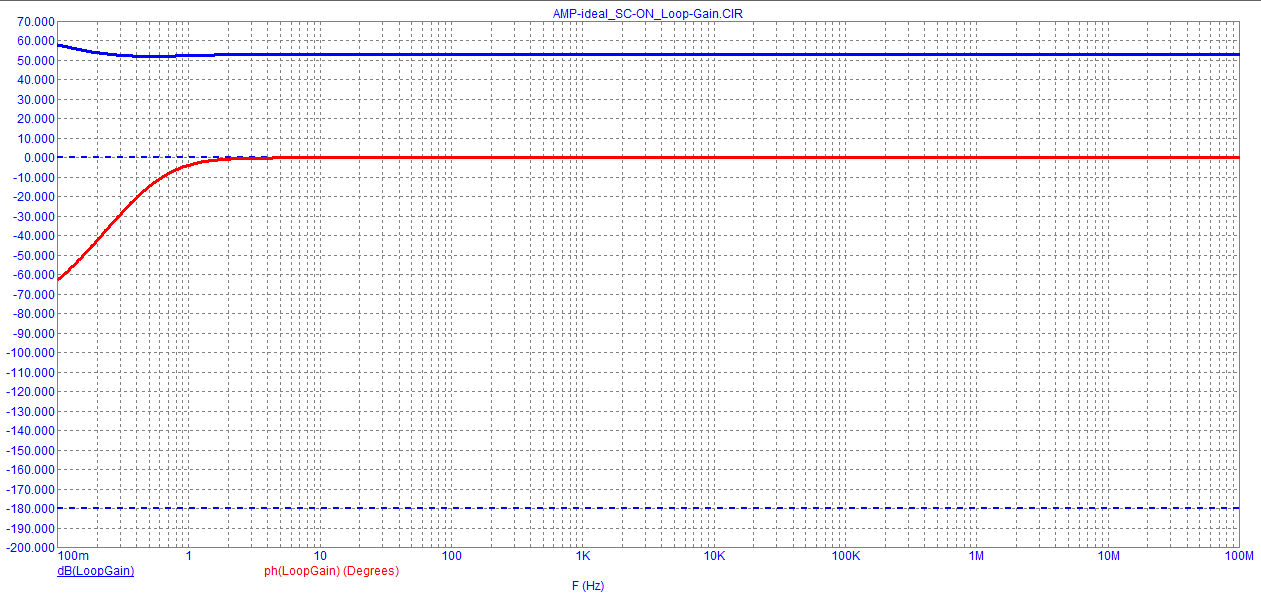

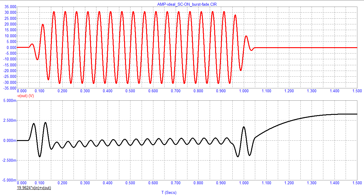

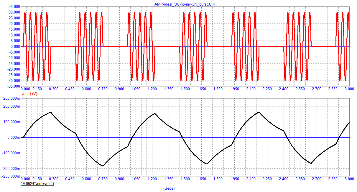

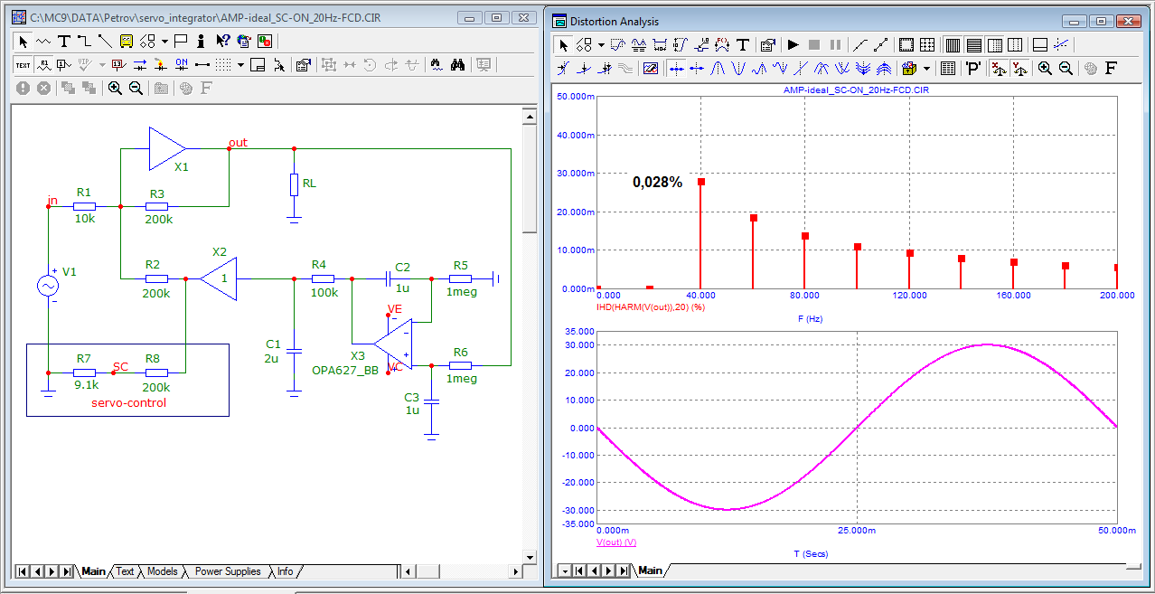

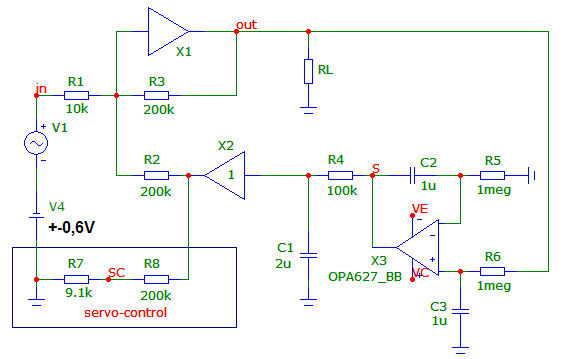

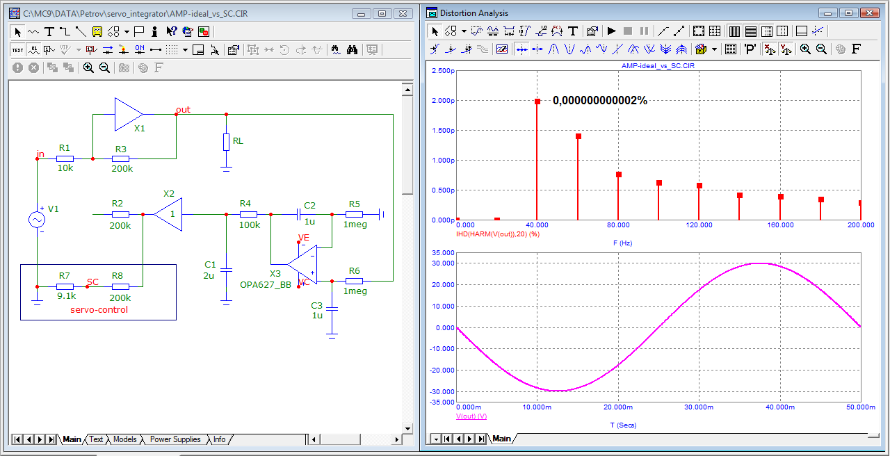

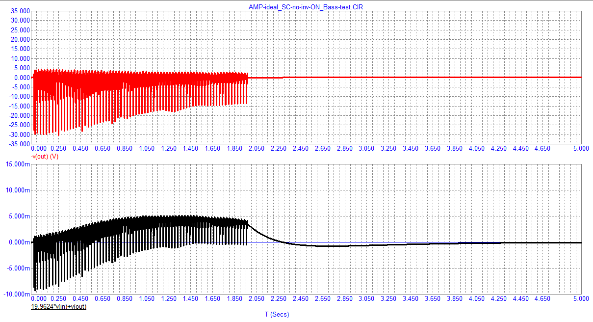

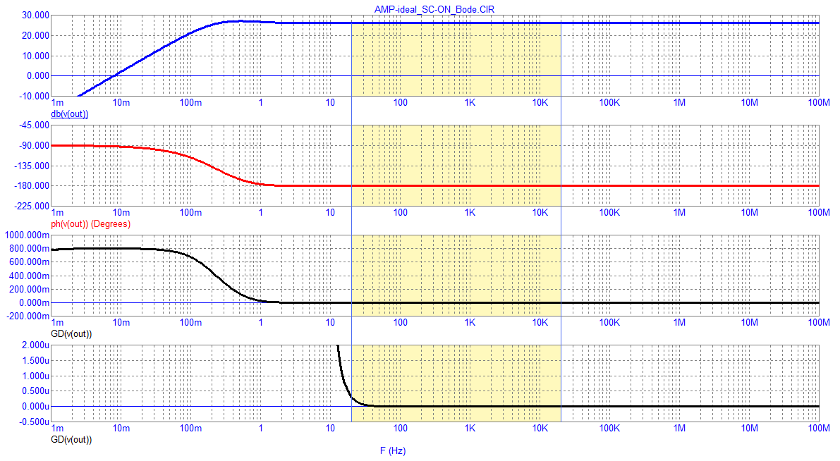

servo control operation

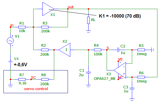

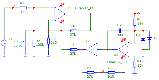

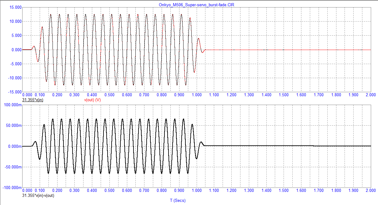

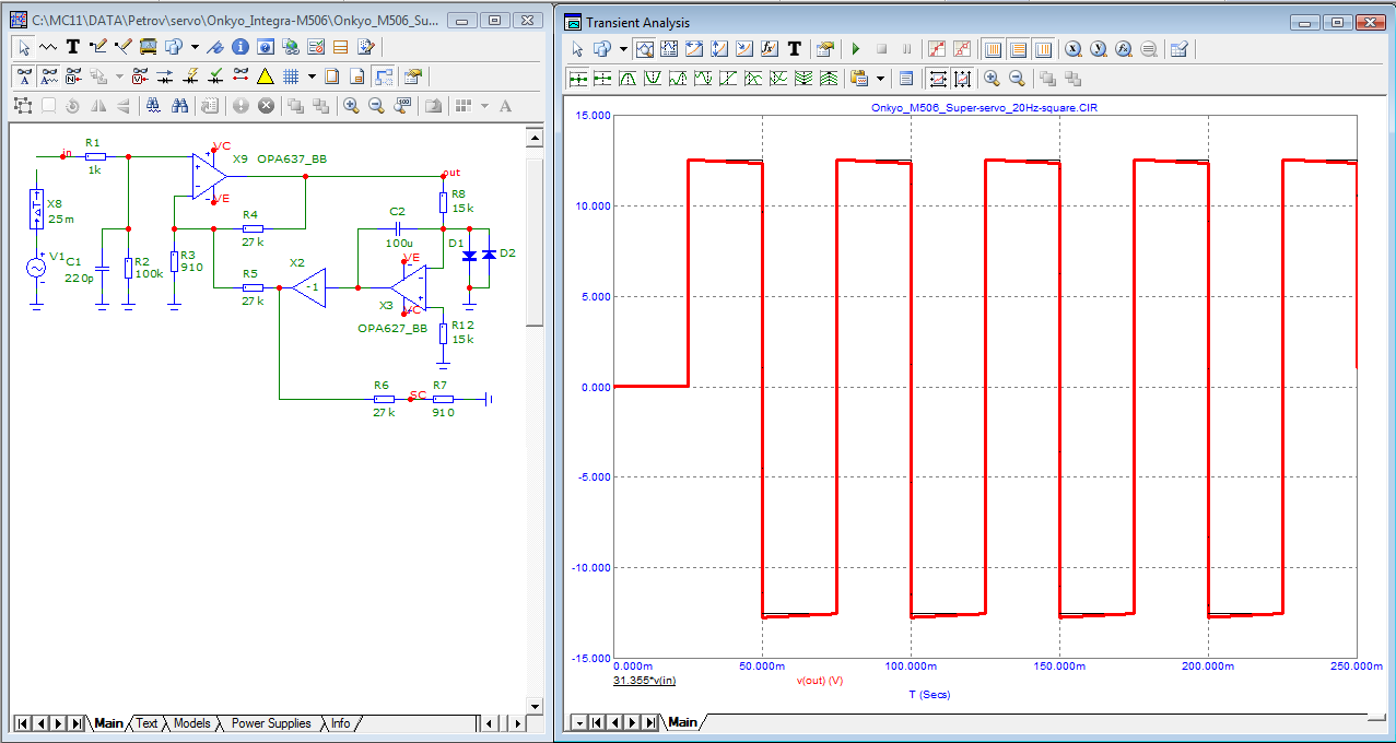

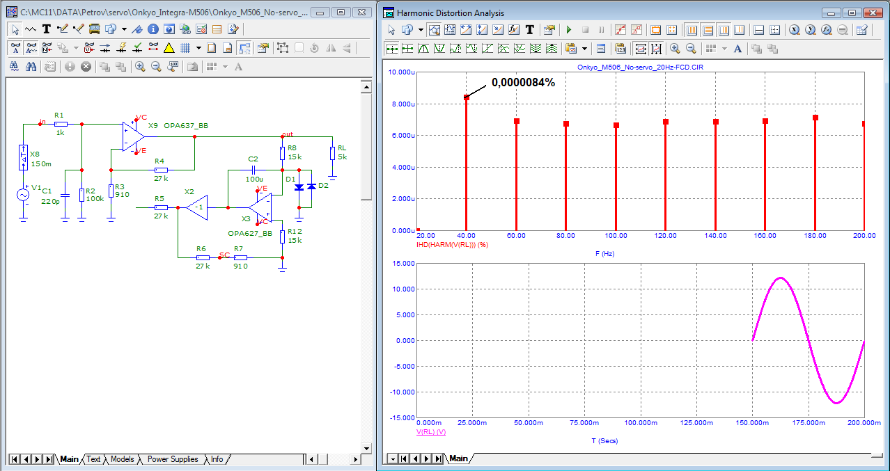

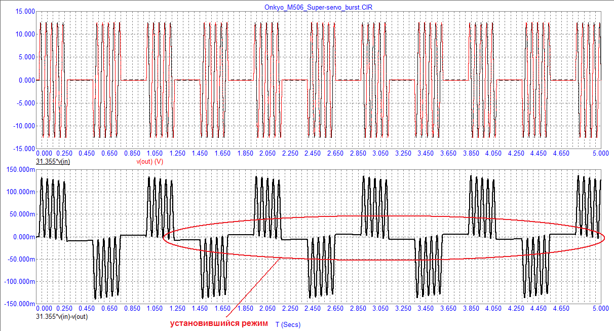

When the developers still understood how the servo control system should work, they did it like this. An op amp of the OPA637 type was used as an "ideal" amplifier. I do not give a description, as I see that the overwhelming majority of visitors are only interested in drawings.

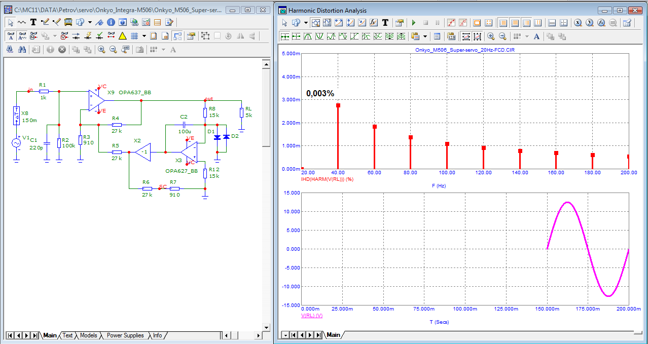

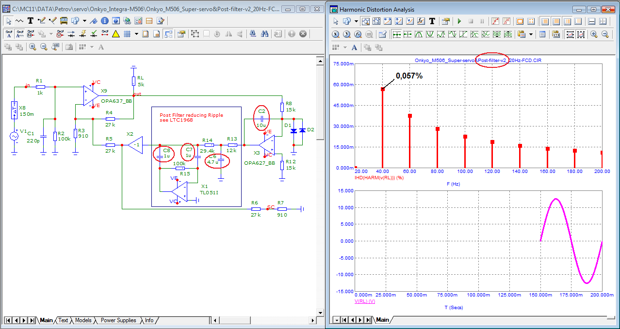

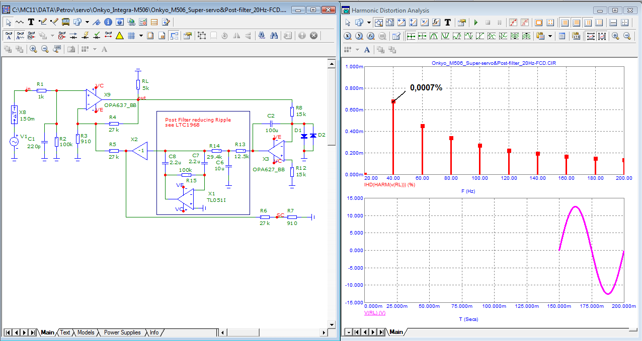

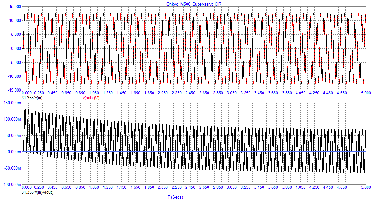

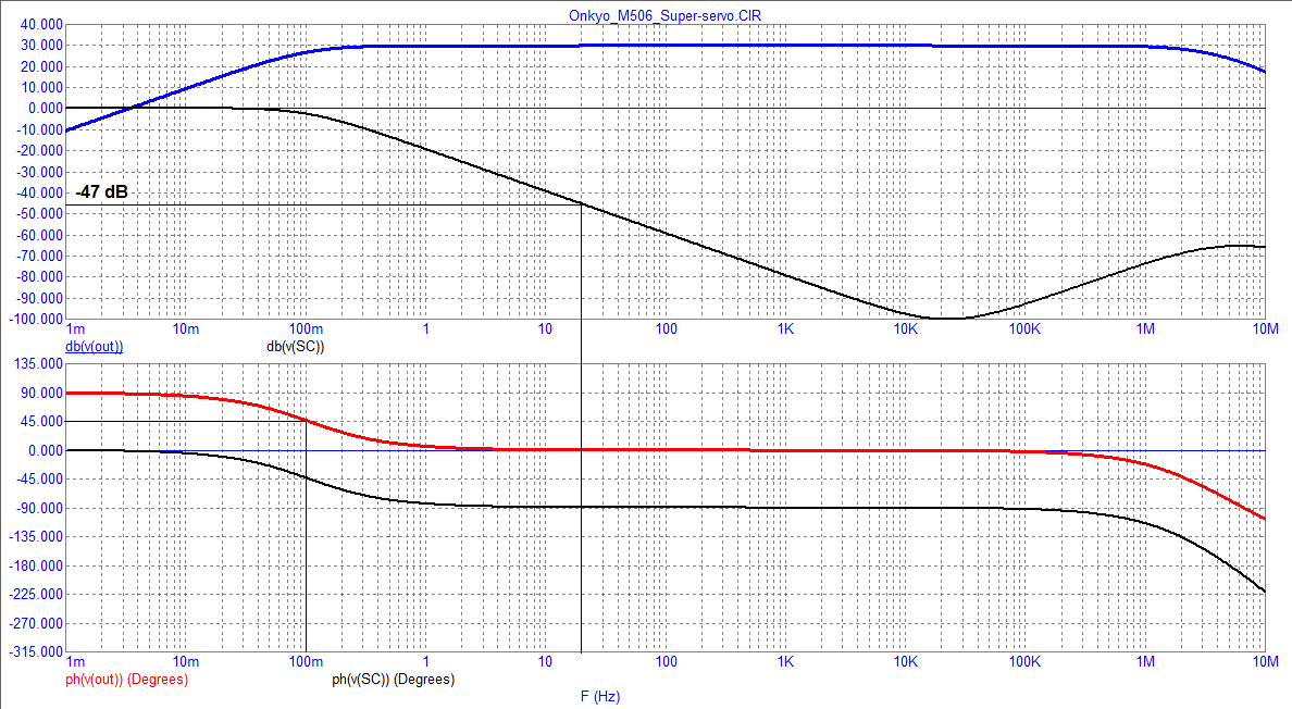

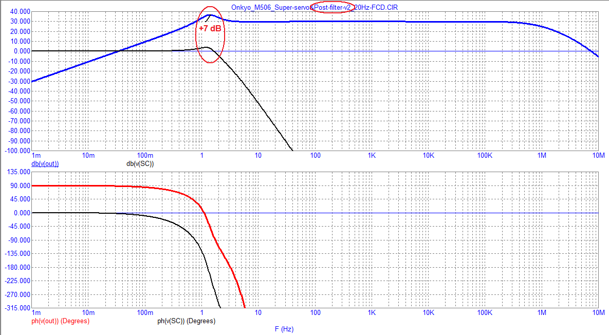

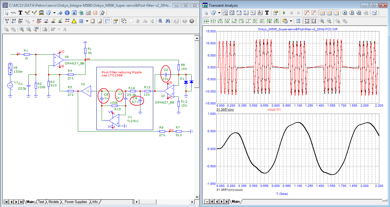

Increasing the speed of the servo control system with a post filter increases the distortion

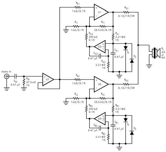

Amplifier options 100 W on the popular LM3886 IC based on circuits from AN-1192 TI
I would like to draw your attention to the following facts:
1. the presence of a buffer at the input provides a low and stable signal source resistance for the LM3886, which guarantees the minimum possible delay for these microcircuits;
2. the absence of a radio-frequency filter at the input, which also increases the delay time for the amplifier as a whole
3. Using servo control to reduce parasitic currents between the outputs of paired microcircuits
4. the integrator signal is attenuated by more than 200 times (about 50 dB) and has little effect on the signal in the audio band

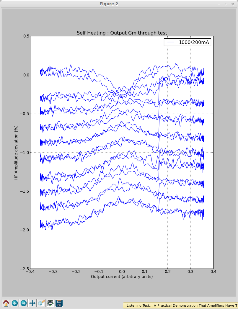

A method I have used is this:
The amplifier under test (DUT) has it input shorted.
I use a stereo amp. One channel outputs +/-24V 20Hz sinus, it is coupled into the output of the DUT with a 24R resistor, so it gets +/- 1A.
The second channel outputs +/-1V 48kHz sinus, it is also coupled into the DUT output via a resistor of higher value, for example 1k, so it produces an AC current of 1mA. This current should be pretty low.
The output of the DUT is acquired through a highpass filter that gets rid of the 20Hz tone, and the amplitude and phase of the 48kHz tone is detected with a soundcard.
This gives the output impedance of the amp at 48kHz versus the low frequency current in the output stage.
Here is an example, each curve is one period of the low frequency signal, they are vertically offset for readability. At the start of the test, the DUT output is cold, so it is a bit underbiased, then it heats up and shows gm-doubling.
I got a lower noise soundcard and I'm doing a board with support hardware to do more of this kind of tests.

No-one cares about the damping factor as long as output impedance is lower than that of the speaker wires, which is easy. What matters is that output impedance is constant with varying output current.
I don't remember the numbers from this particular measurement, but that's a convenient way to measure crossover/switching distortion.
Crossover/switching distortion depends only on output current because it is a large signal phenomenon in output stage. It does not depend much on output voltage, unless close to clipping.
So, if an amplifier outputs 8 Vpp into 8R resistive load, so 1App current, the crossover distortion will be about the same as if you inject a 1App current in the output while the input is shorted. But in the latter case the output signal is much smaller, there is no need for notch filter to get rid of fundamental, instead the distortion appears at the output directly.
So, for example, the plot I posted shows 0.25% change in amplitude of 10kHz HF signal during a LF current period. I did not write down the value of the resistor I used to inject the HF signal, but I think it was around 100R. If the 10kHz signal was injected through a 100R resistor and its amplitude varies 0.25%, it means the output impedance of the amp at 10kHz varies by 0.25 ohms over the range of output current. Since the output impedance of the amp forms a voltage divider with the load, over a 8R load this translates to about 3% distortion. This is a pretty bad sounding amp.

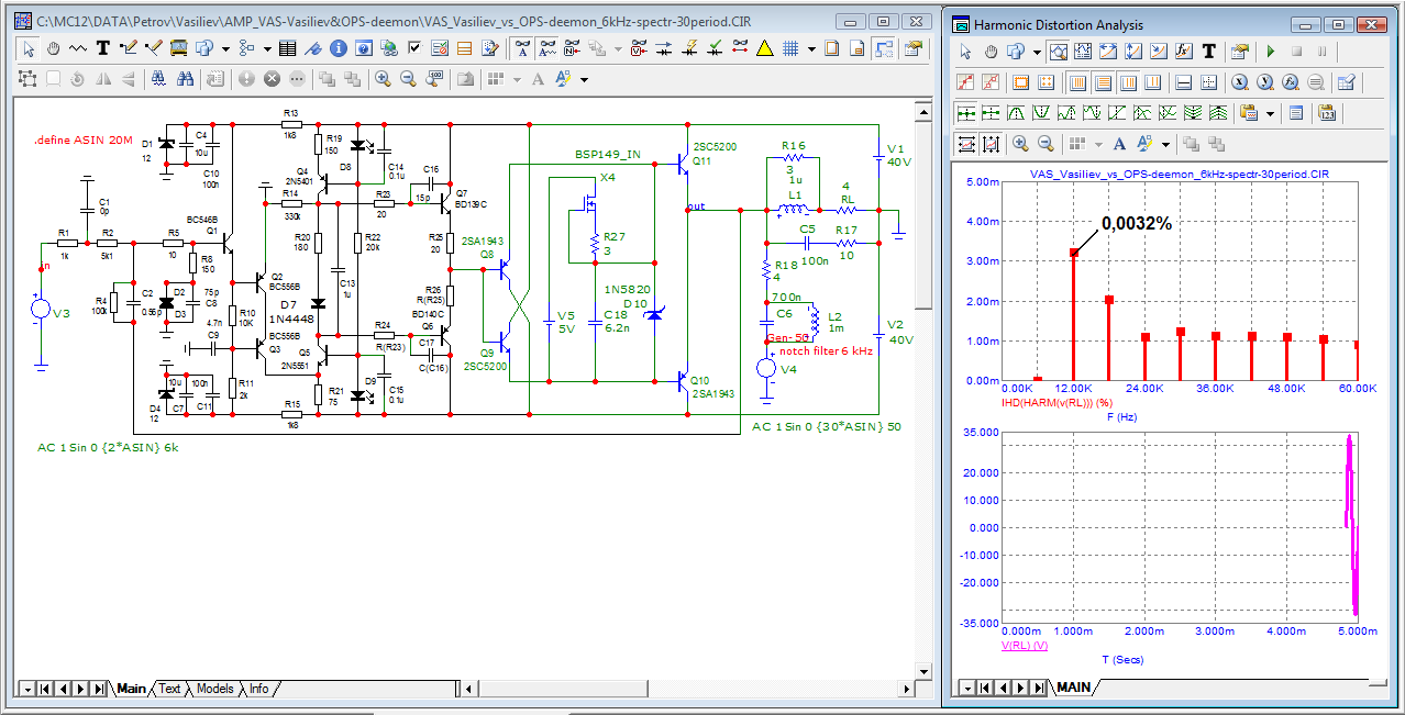

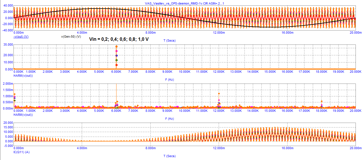

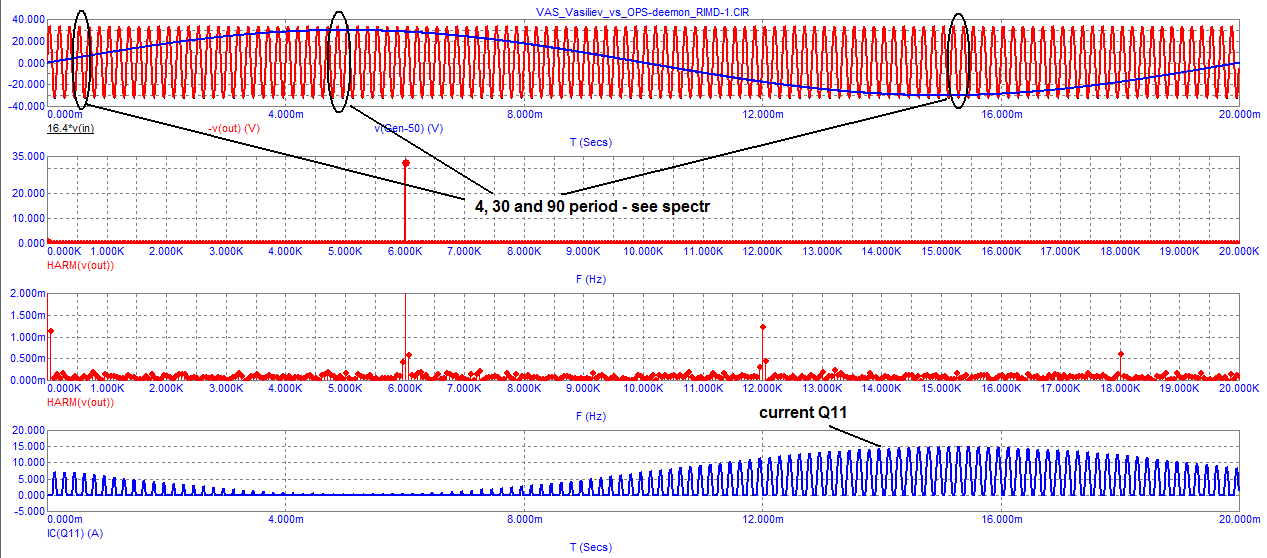

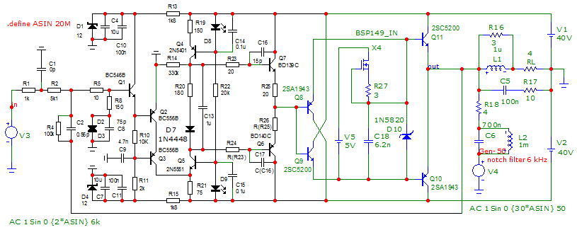

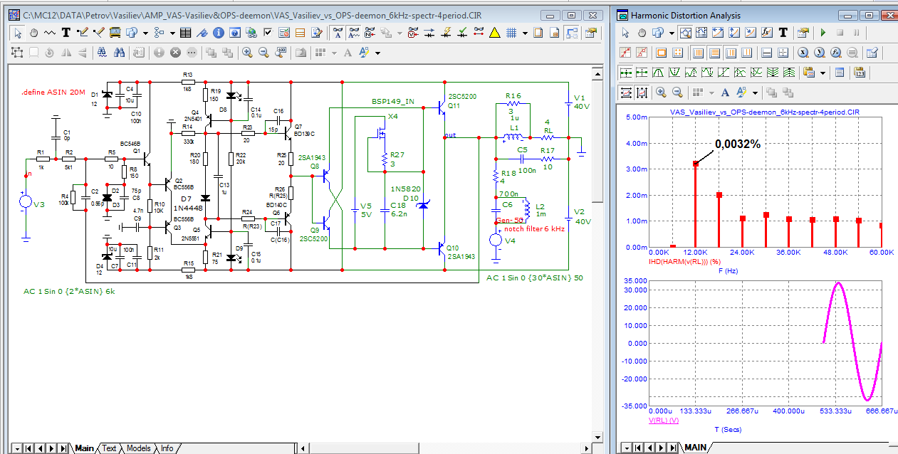

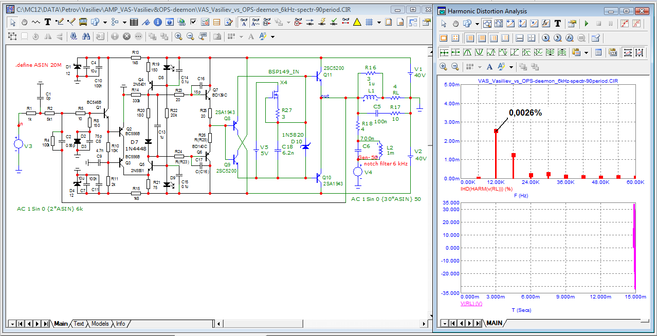

there is a method for measuring reversible intermodulation distortion proposed by Hiraga
That would give much less information because the amplitude of the HF signal is very high, so it does not reveal the small signal variations of output stage impedance versus current...

Is there a link available to the original (or new) Vasiliev amp - like article in Radio magazine, or something like this?
nothing prevents you from setting a step-by-step change in the signal level
Much lower distortion at lower RF levels
I'm not measuring distortion, I'm measuring the amplitude of the HF signal only.
Measuring its distortion would not give any useful information, and it would also be difficult, since other elements in the chain could add to the distortion, whereas it is pretty unlikely that a component in the measurement chain would introduce a time-varying change in amplitude of a steady state signal.
minek123, Vasiliev posted the VAS version in the “Alternative driver for Zarasustra” Vladimir sim on vegalab. See also:
