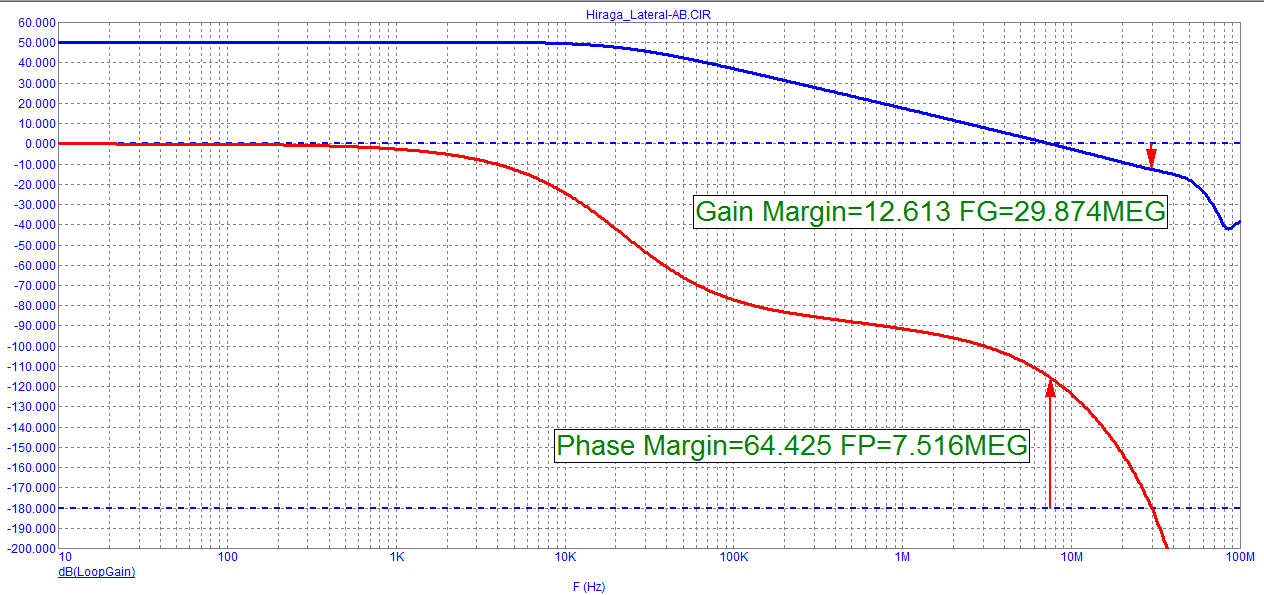

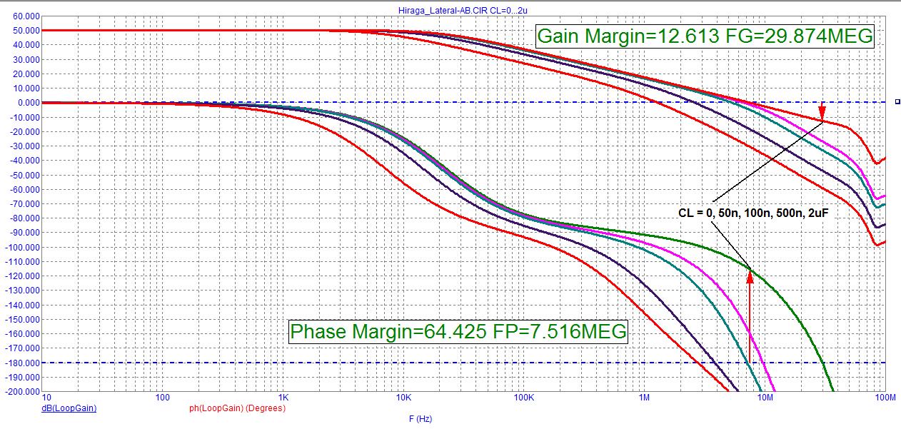

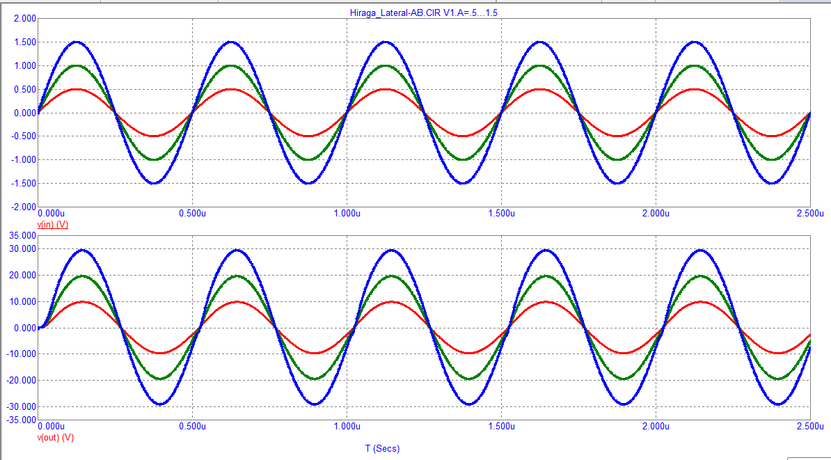

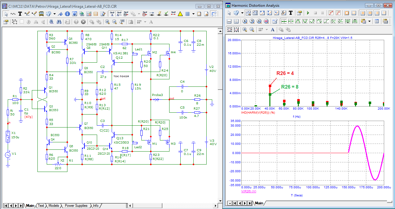

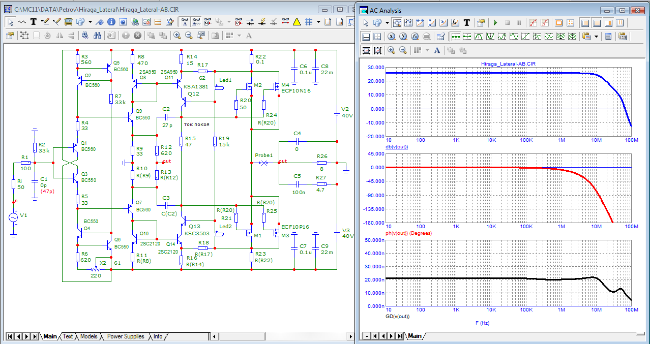

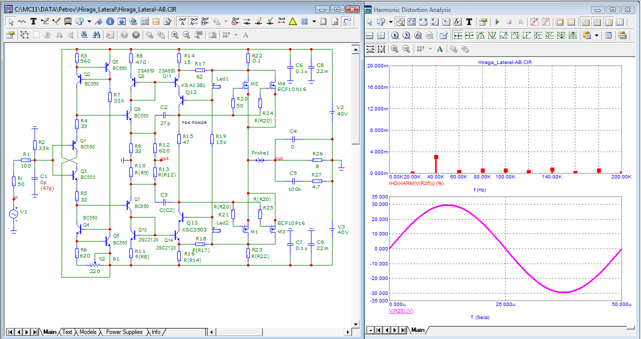

how do you like this version of the amplifier based on the amplifier by Hiraga

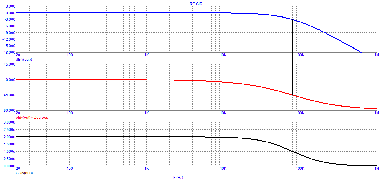

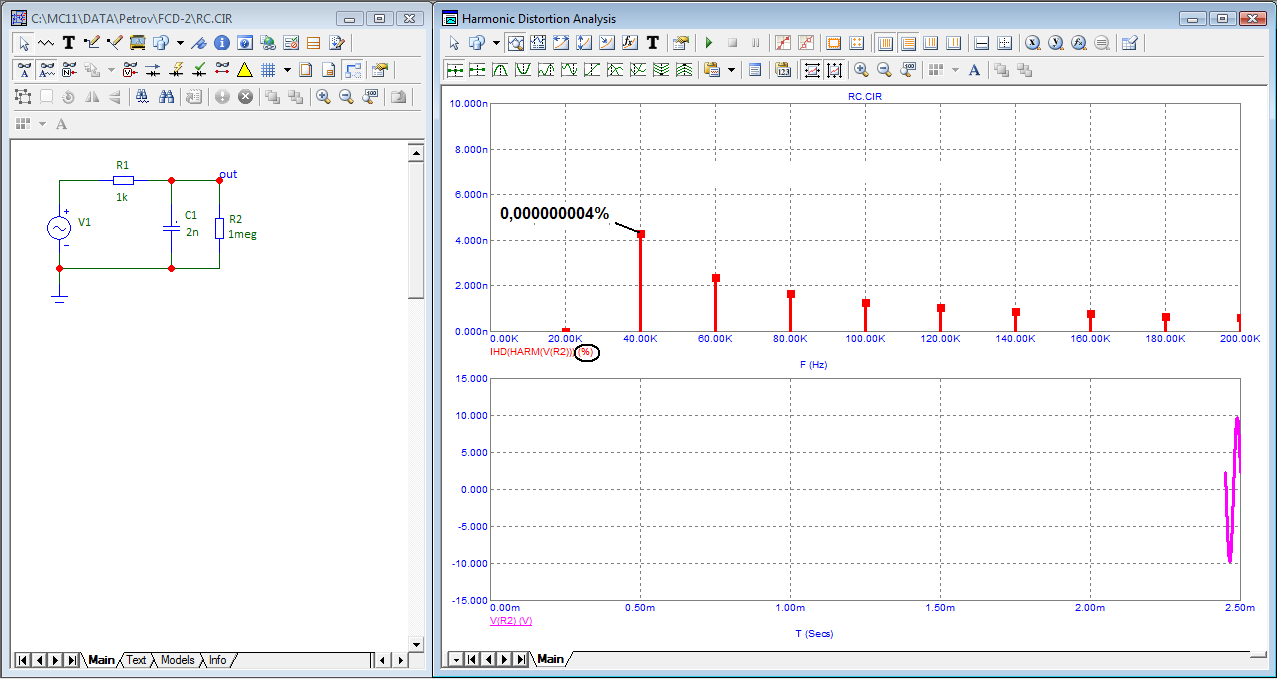

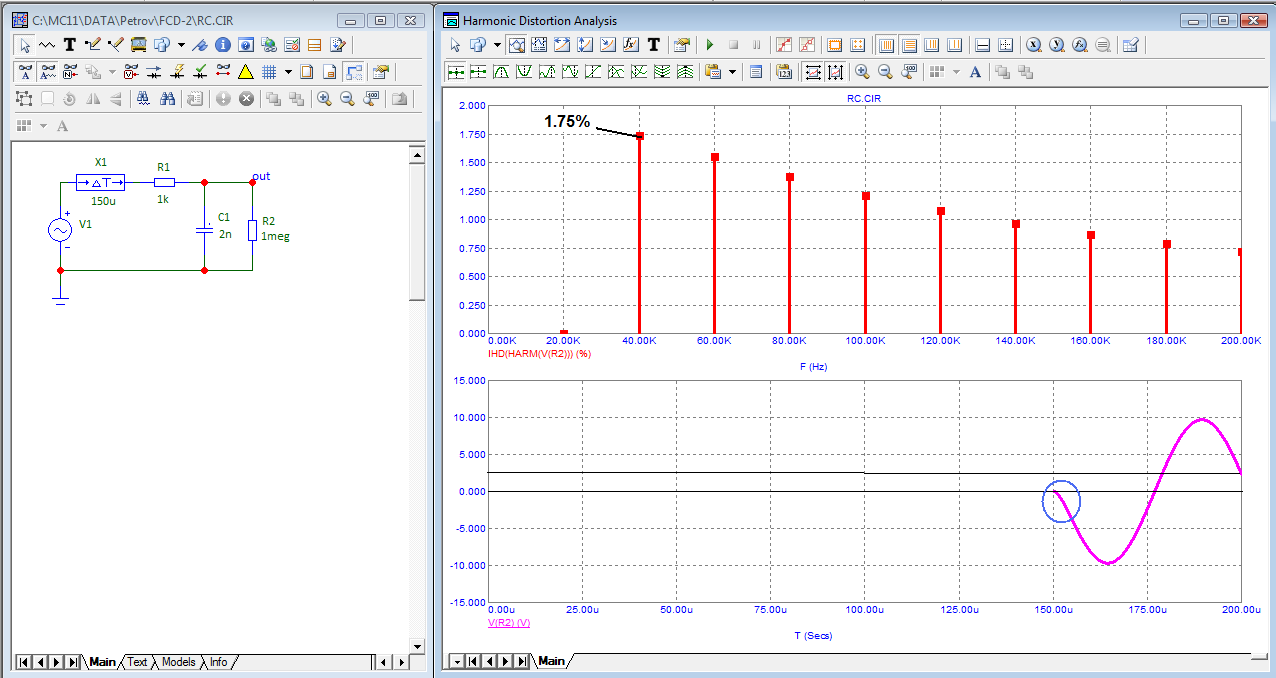

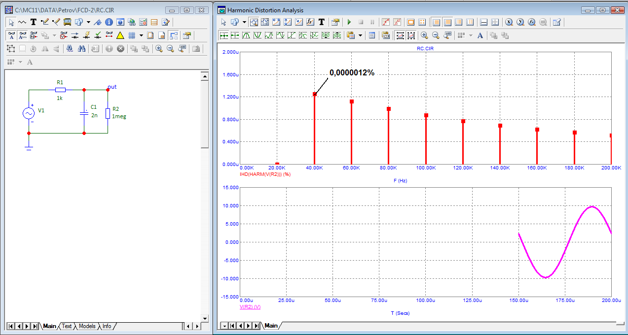

Consider the distortion of the first period on the simplest RC circuit with a cutoff frequency of 80 kHz, made on ideal passive components. By definition, such a circuit cannot introduce harmonic distortion. Amplifiers with this bandwidth are not uncommon. First, let's try to measure the distortion at a frequency of 20 kHz in the 50th period (this is the maximum value that the program allows). It can be seen from the test that even at the 50th period, the transient processes have not yet completely ended, and in addition to the phase shift and a decrease in the signal amplitude, we see a small level of distortion products.
The minimum number of periods for testing is four. Let's check the spectrum for the 4th period. As can be seen from the test for the 4th period, the level of additional components became higher.
In order to deceive the program, we use a small trick and delay the signal by 3 periods so that the 4th period is the first. The program will use it to measure the spectrum of distortions.
It turns out that a simple RC-circuit in the first period, in addition to a phase shift and a decrease in the signal amplitude, introduces additional distortion products of 1.7%.
I am sure that at the 1000th period, or even later, only a phase shift and a decrease in amplitude will remain in the signal, and no additional distortion products. This is what is meant by the term "linearity" which Graham was trying to explain.
I hope it is clear that the less the signal propagation delay and the larger the frequency band it will have a constant value, the less distortion will be in the first period. Only on pure sinusoidal signals, distortions are significantly reduced after several periods (see the test on the 4th period compared to the first). But the musical signal has a complex impulse character, so for it every moment is equivalent to the first period.

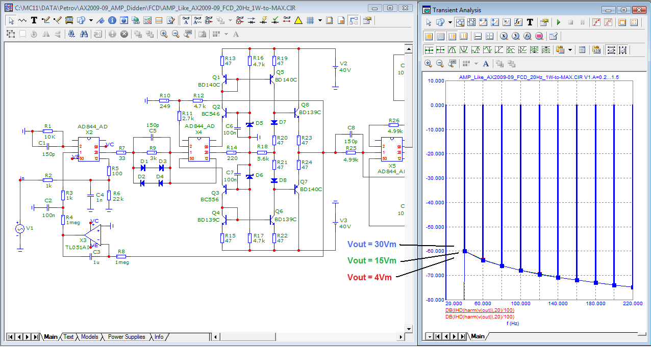

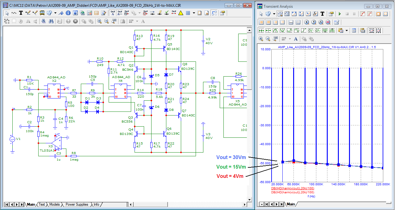

Many people will object to me, they say, what does RC-chain distortion have to do with amplifier distortion?
The most direct. The shorter the signal transmission delay time (for example, Cyrill Hammer believes that the delay time should be only a few ns), the less distortion is noticeable by ear.
In the LF region, distortion reduction is facilitated by the implementation of the amplifier in the form of a DC amplifier.
But DC amplifiers often use a servo control system that can have a negative effect on the signal.

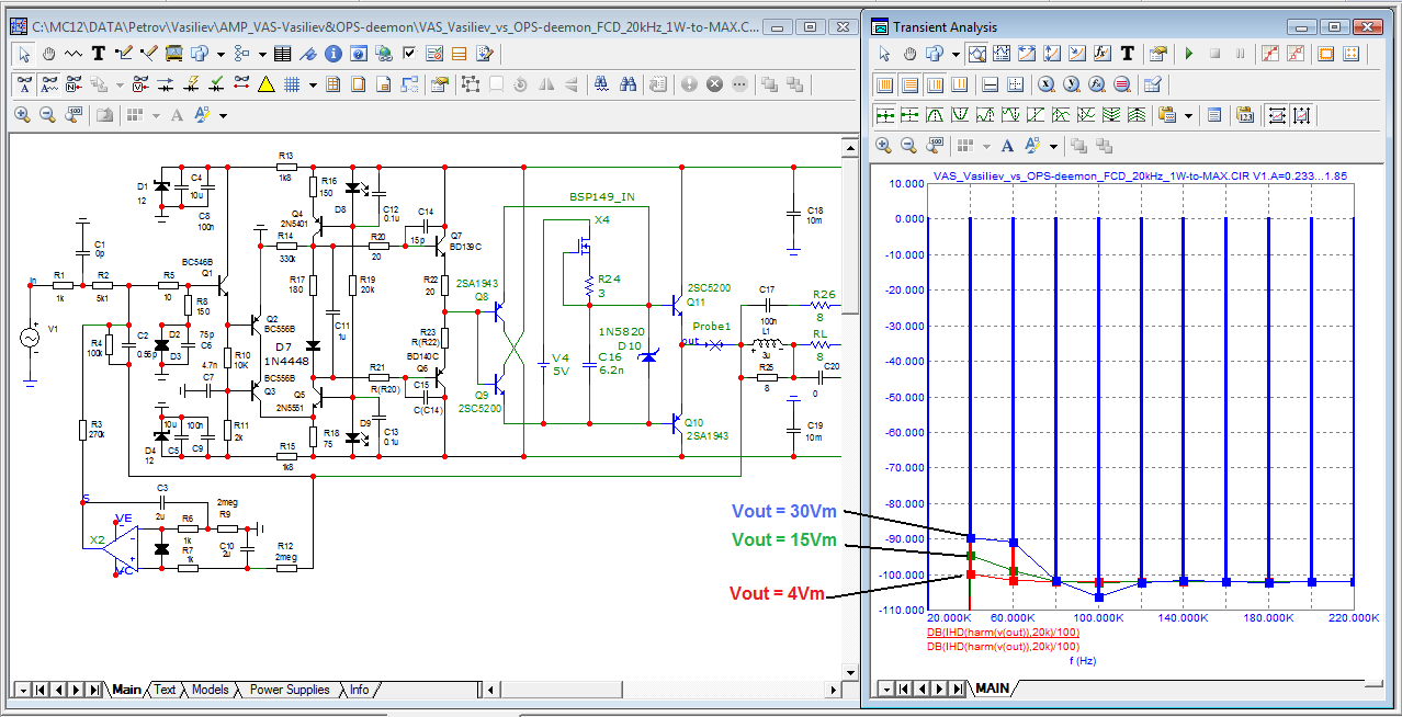

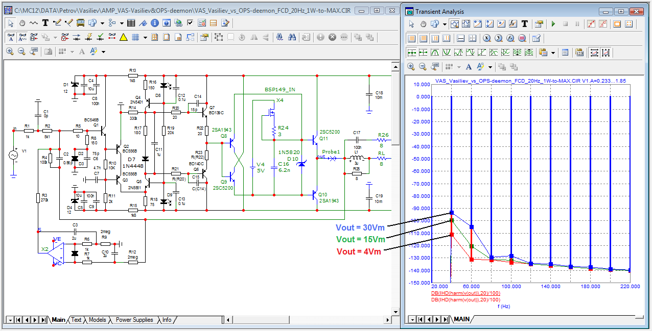

Well, now let's compare two DC amplifiers with servo control systems (they are already familiar to you from the settings above).
Laughing lovers can stock up on popcorn.

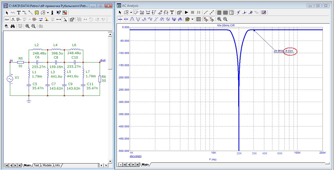

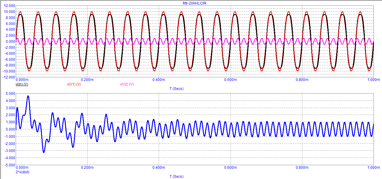

To understand what happens during transient processes, let's look at the example of a notch filter at a frequency of 20 kHz.
More than 500 dB rejection of 20 kHz signal - essentially a near-perfect distortion meter
Signal with a frequency of 30 kHz and above is suppressed by only 6 dB (2 times)
Take a 20 kHz signal at 10 V peak and add the 3rd harmonic at 1 V peak to it and see how long it takes to get distortion products at the filter output.
It turns out that a time of at least 1 ms is required with a period of the main signal of only 50 μs.
Not surprisingly, no distortion meter can measure signal distortion in its first periods.
Roughly speaking, approximately the same processes occur with the signal and in amplifiers during transient processes, but they are not seen by any distortion meter, not a single spectrum analyzer.
