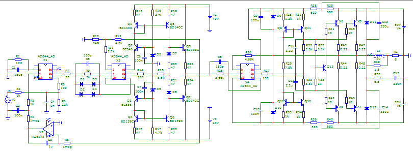

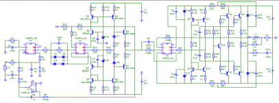

Jan, I showed the scheme in which the operation of the servo control system and its parameters in various modes of operation was checked repeatedly. Therefore, you have no reason to say that I am testing like Hans a piece of the circuit.
if you find an error, tell me where it is

Yes, there is a very good reason because your Servo is the worst design ever, even wasting an expensive AD844.
Look ate the circuit diagram below, a first order servo using the same components but without AD844, a circuit that is absolutely stable without any of your circuits anomalies.
The people who used your servo for decades where ignorant of it's extremely bad behaviour and so are you.
Hans
I am not saying that! I am trying to suggest to you a possible cause to your LF oscillation so you can fix it. If you are not interested in fixing your circuit, that's your choice. But don't put words in my mouth I didn't say. Let's try to stay honest.
And, while we are speaking about honesty, you should not publish copyrighted material on this public forum. It is clearly spelled out in the rules.
Jan
Jan, if you do not understand how your servo control system works, these are your problems. I'm just trying to open your eyes. I do not appropriate other people's schemes and do not give them out as my own, I always give a link to the source.
Hans, I repeat. This is not my servo!

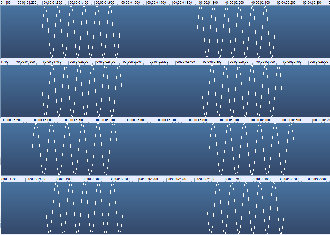

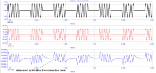

here are the wav tracks for testing servo control systems.
Jan, check your system at the control points that I indicated and show the oscillograms, let's laugh together

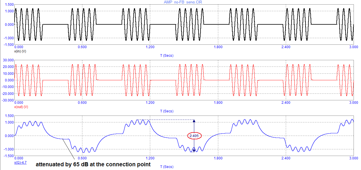

To avoid any wrong impressions, I think it is useful to recap what's going on lately.
Some days ago Petr_2009 once again changed the subject and claimed that a servo in his amp increased noise at the LF end. It was pointed out that his FFT was badly specified so he was looking at a high LF FFT floor. He did not fix the FFT, what would be the logical thing to do, to be sure that it was servo noise, but started showing graphs in the time domain.
It was apparent from those that his sim amp was unstable and showed LF oscillations, and this was pointed out to him.
He then claimed it was the fault of the servo designer, a circuit he copied from the internet, and which was part of a totally different design that was specifically designed to illustrate error correction concepts, and therefor had an unusual servo arrangement, a fact Petr did not realize.
Again, as would be logical, he did not fix the LF oscillation but posted .wav files and asked that we listen to them. I don't know what the goal was, what we were supposed to hear, what kind of amp we are listening to compared to the simulated one, and what the input signal was.
At that point I decided I am not going to invest more time in this. I believe that in the course of this thread, enough advice has been given to Petr_2009 on how to make meaningful and understandable posts that could make for useful discussions and knowledge transfer. I have no idea what his goal is with all these posts.

Here is another version of the audio track for testing the servo control system.
The signal is applied to the input of the amplifier and, using an oscilloscope, they look at the signal at the output of the integrator and other control points (depending on the specific circuit) four tracks are different combinations of 20 Hz burst
For each of the tracks, the system will react (or, as Yang says - "excited") in different ways.
Well, then, since Jan took the position of an ostrich, I appeal to all forum visitors: if anyone has such an amplifier or an amplifier with a similar servo control system, please conduct tests and post oscillogram photos so that one channel has an output signal, and the second channel of the oscilloscope has a signal at the output of the interactor, etc.
Jan, files need to be viewed with an oscilloscope and eyes, not ears

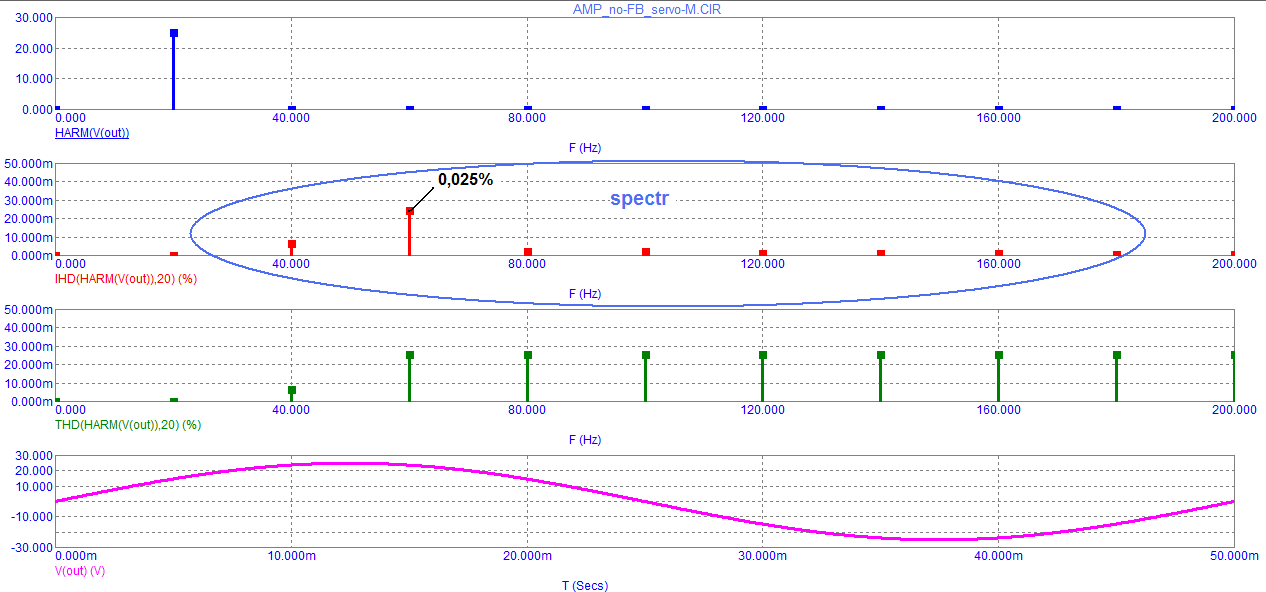

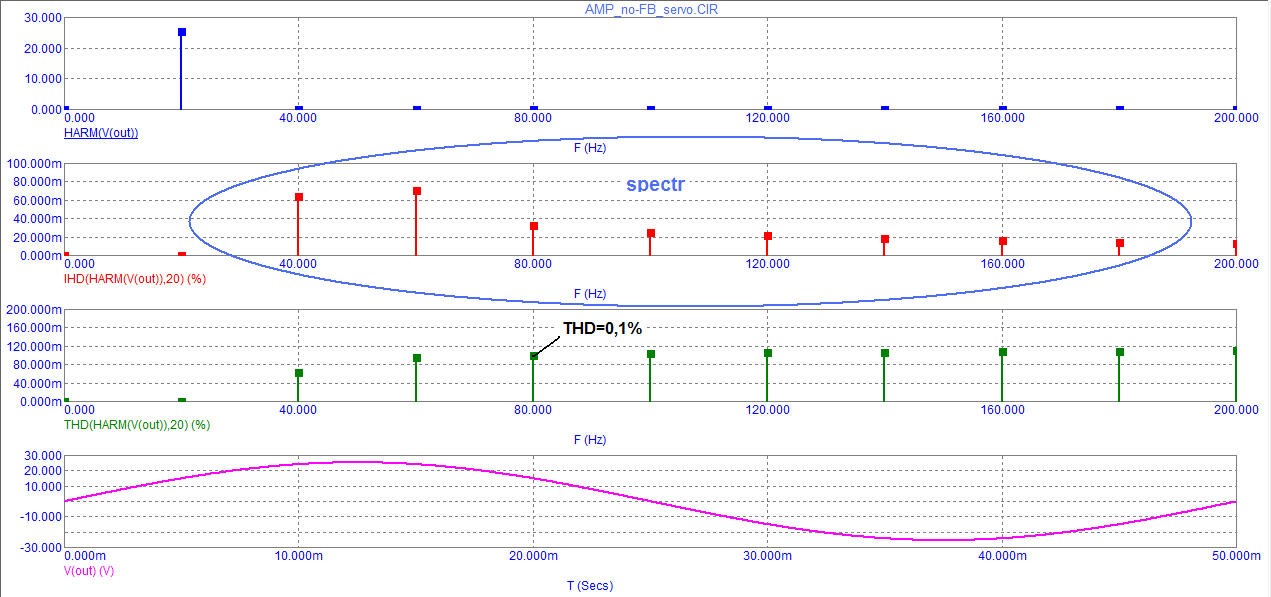

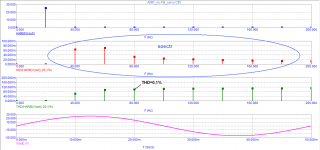

Here are some more arguments about servo control tests.
I tested the original circuit and this same circuit after modifying the servo control system. The rest of the scheme remained unchanged.
Conclusions, I hope you will do it yourself
after revision, the distortions decreased by 4 times, especially the spectrum of higher harmonics decreased
