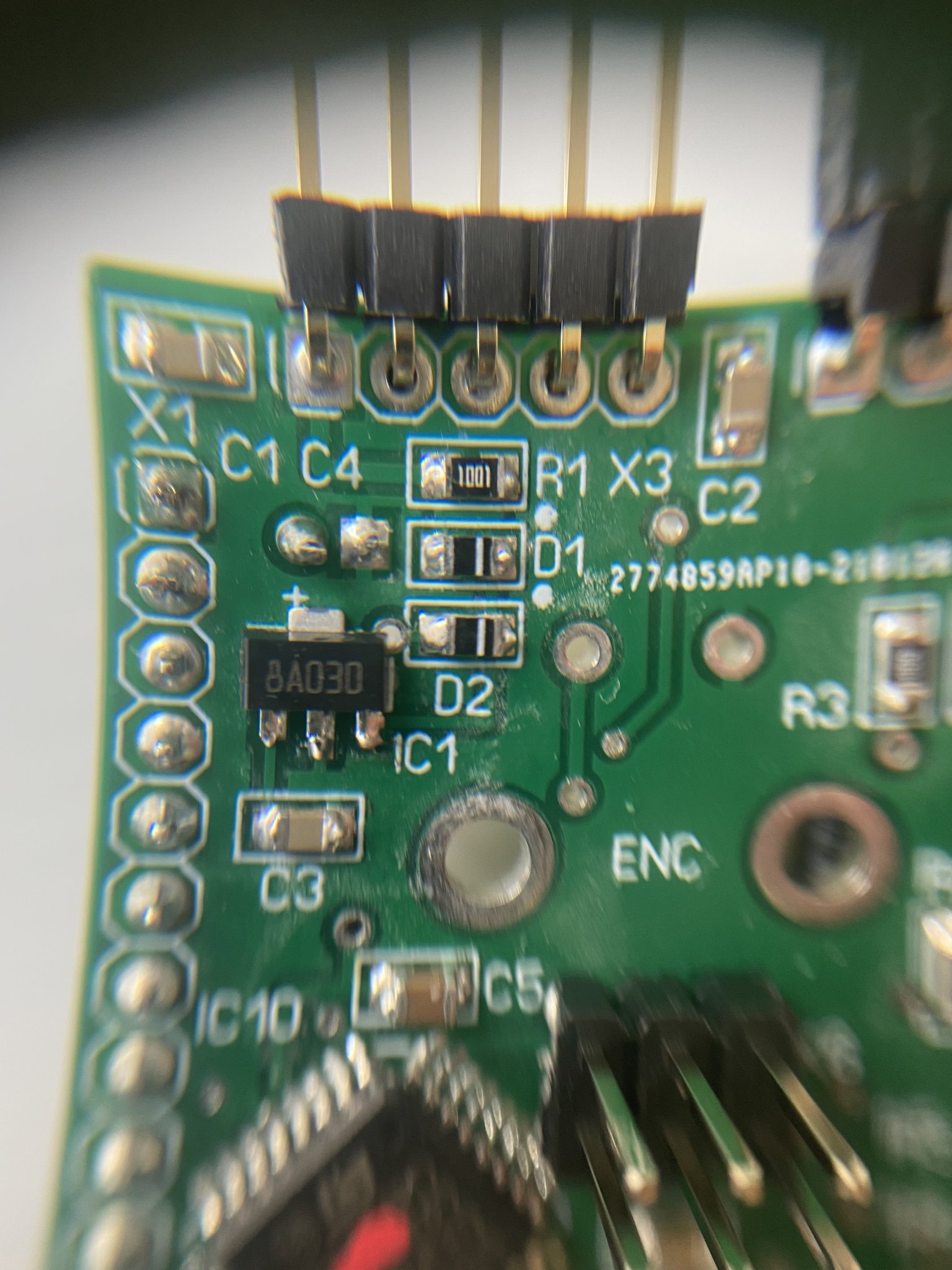

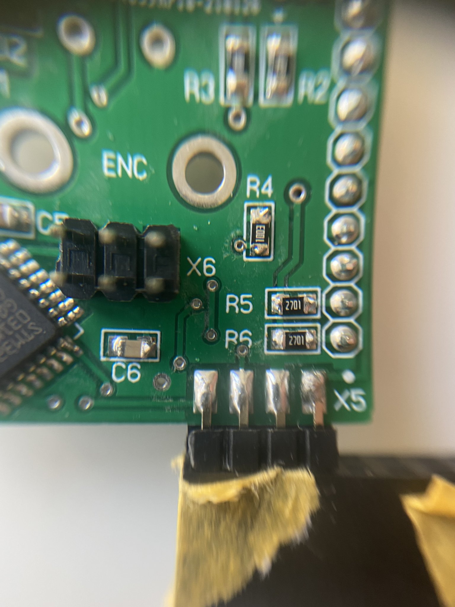

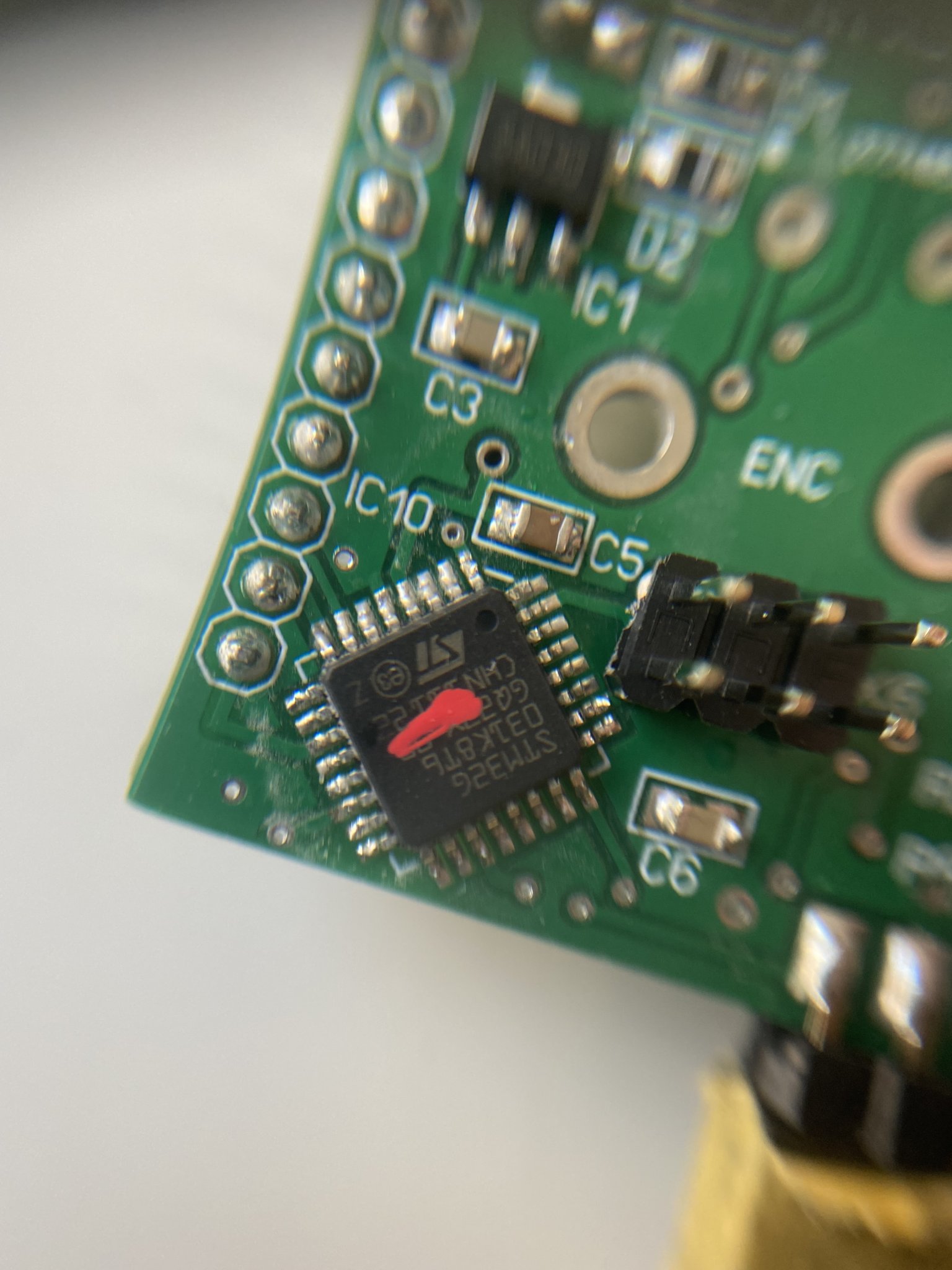

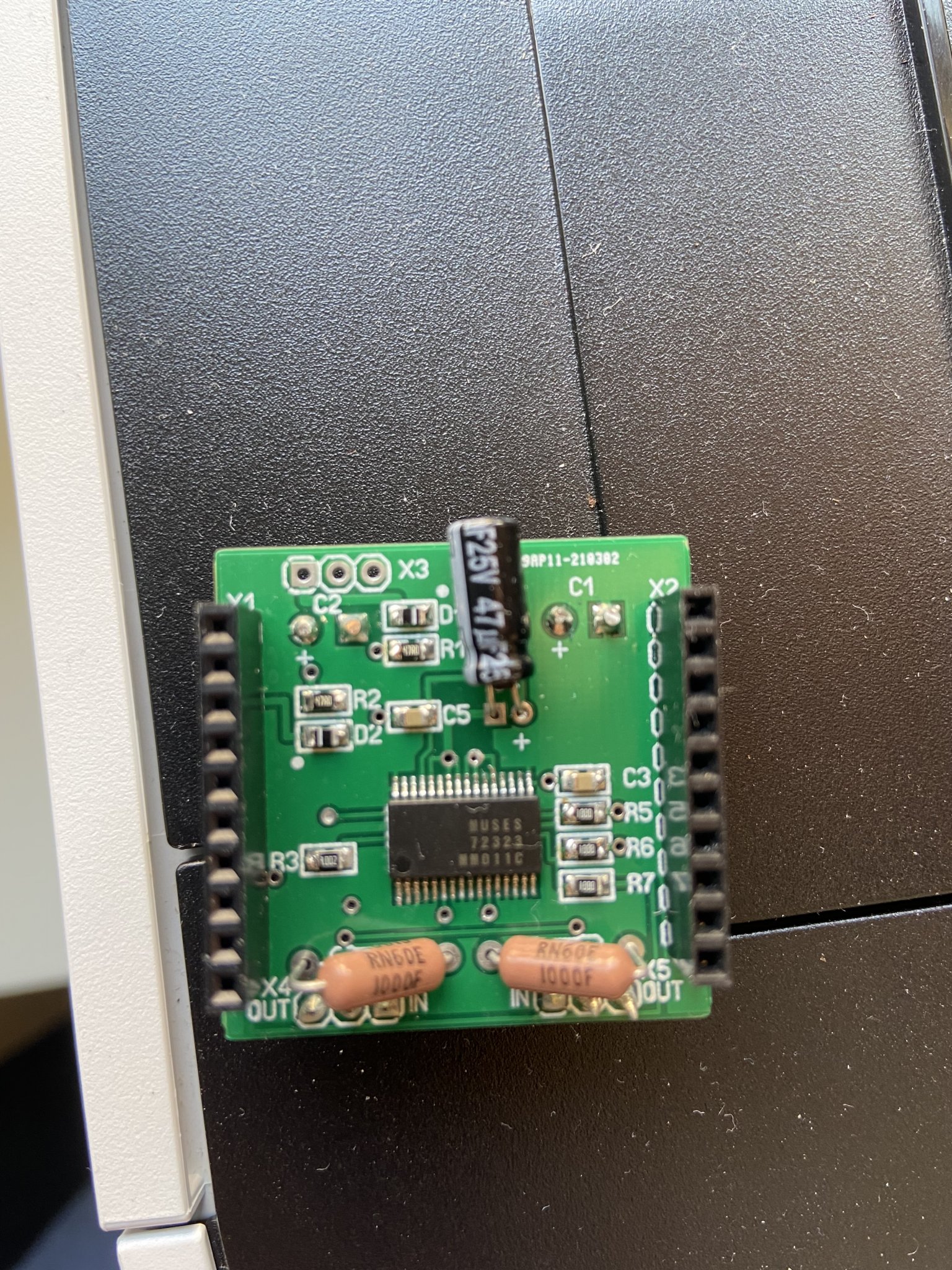

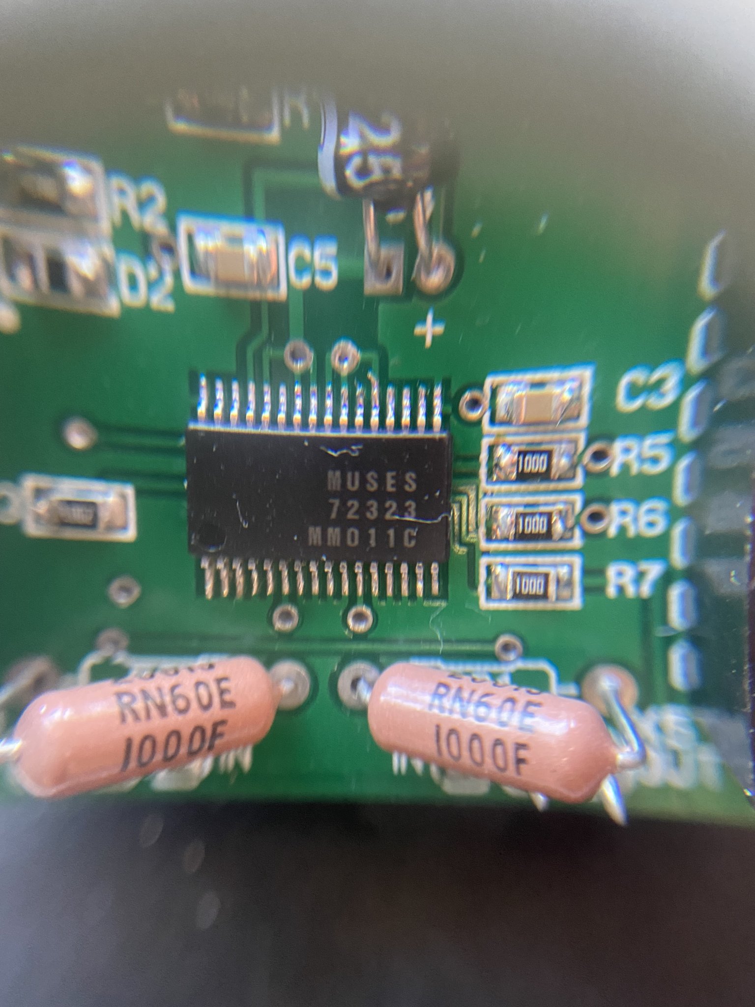

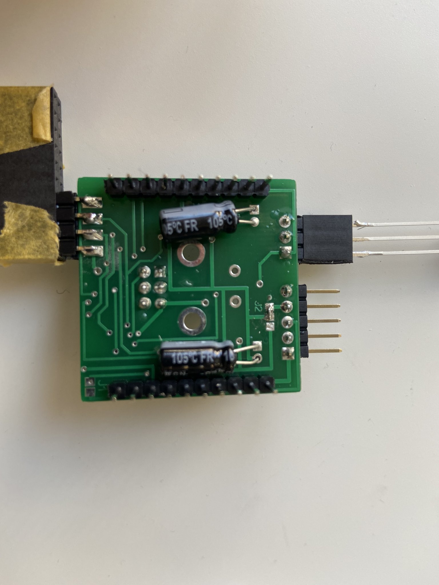

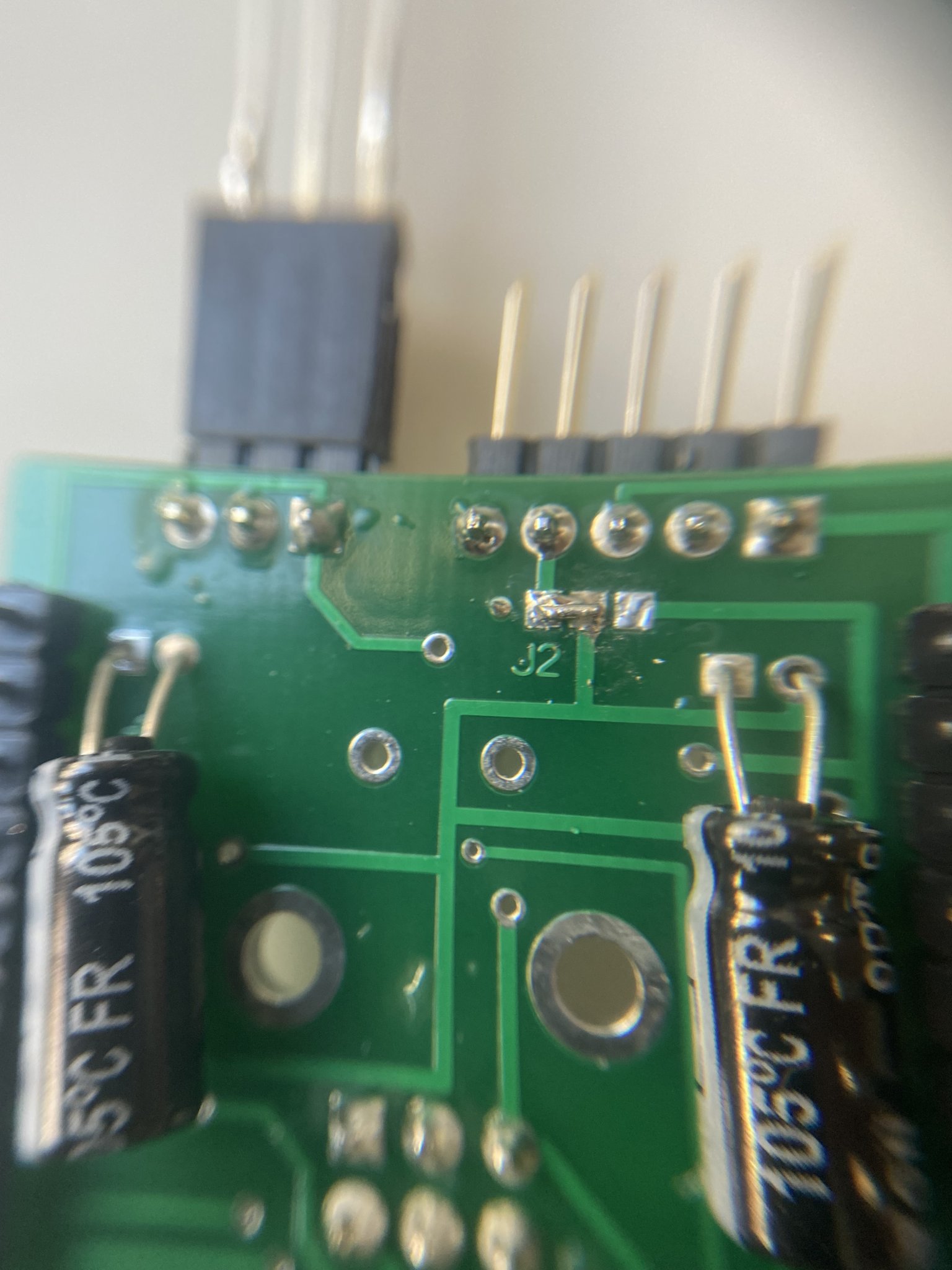

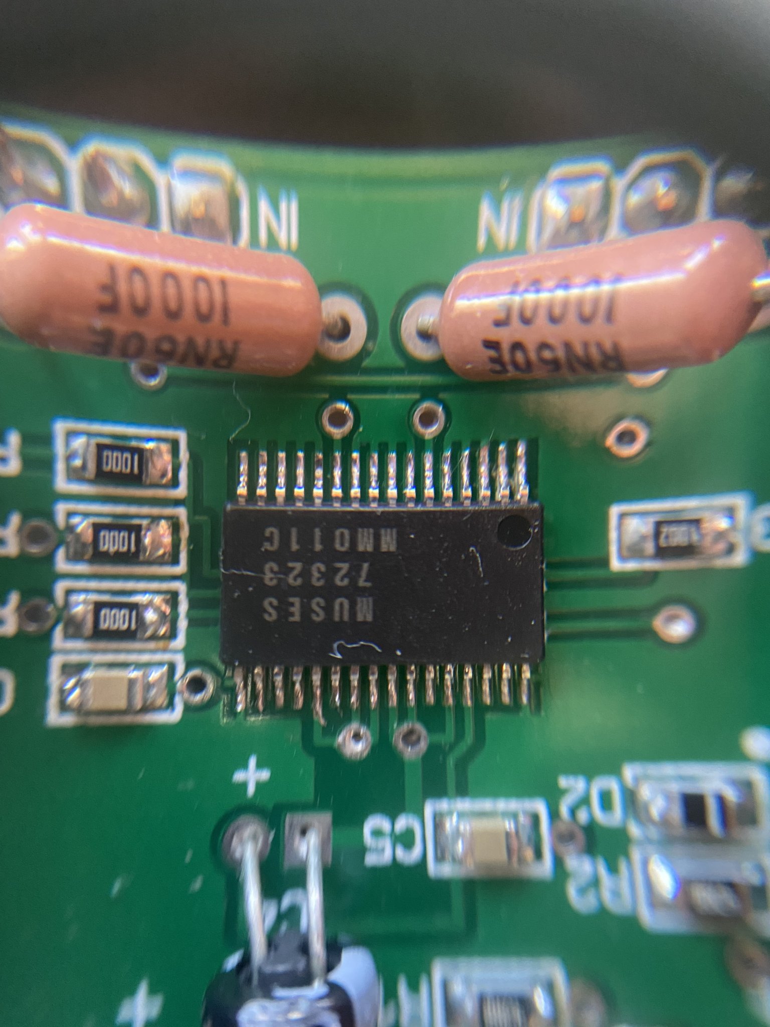

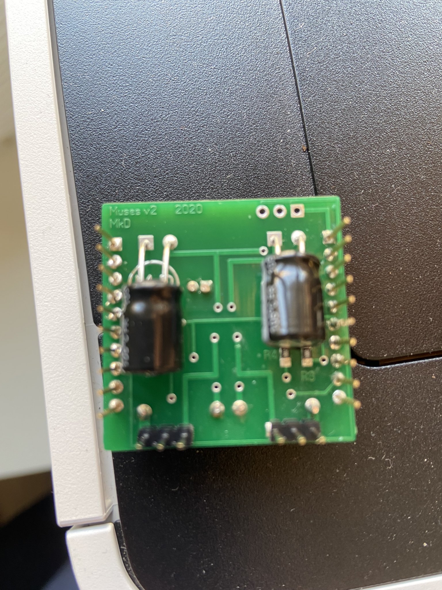

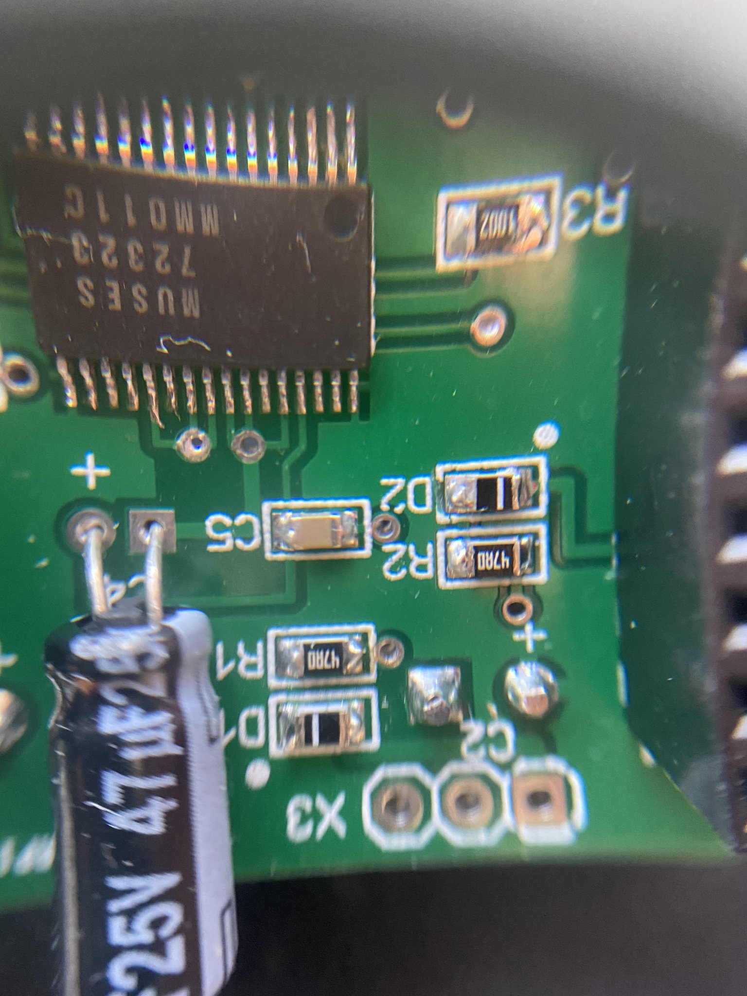

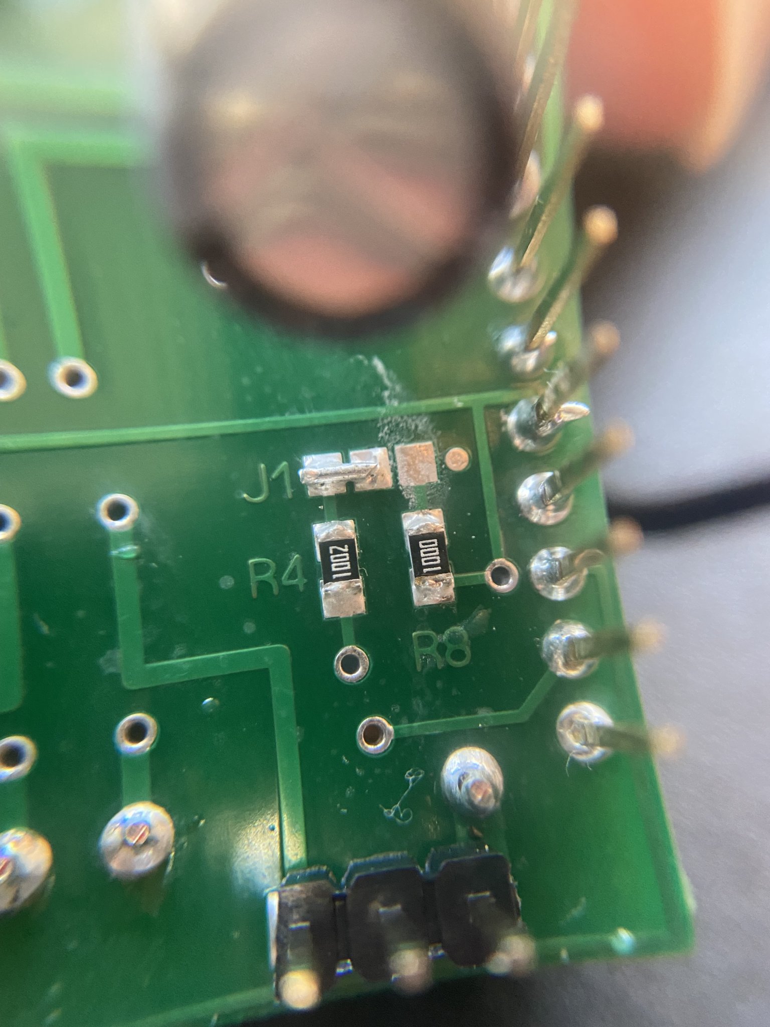

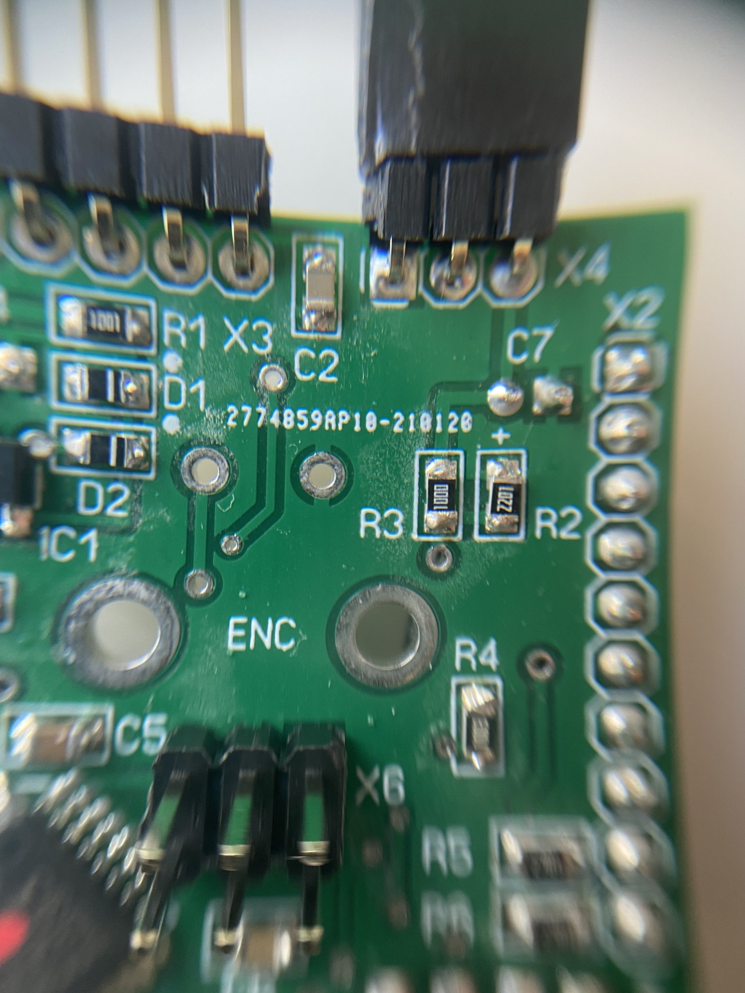

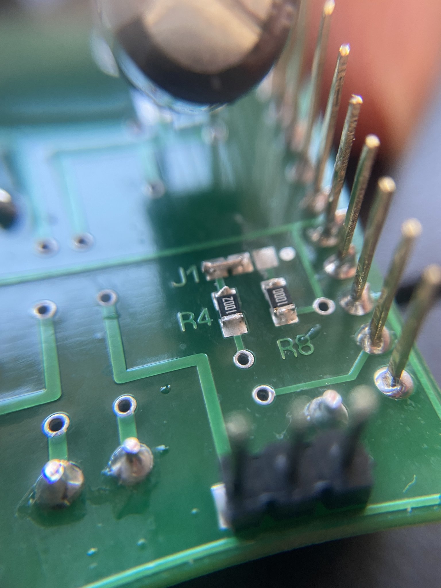

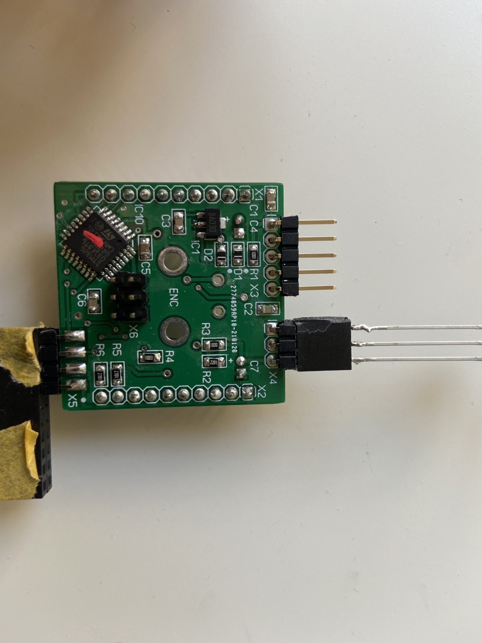

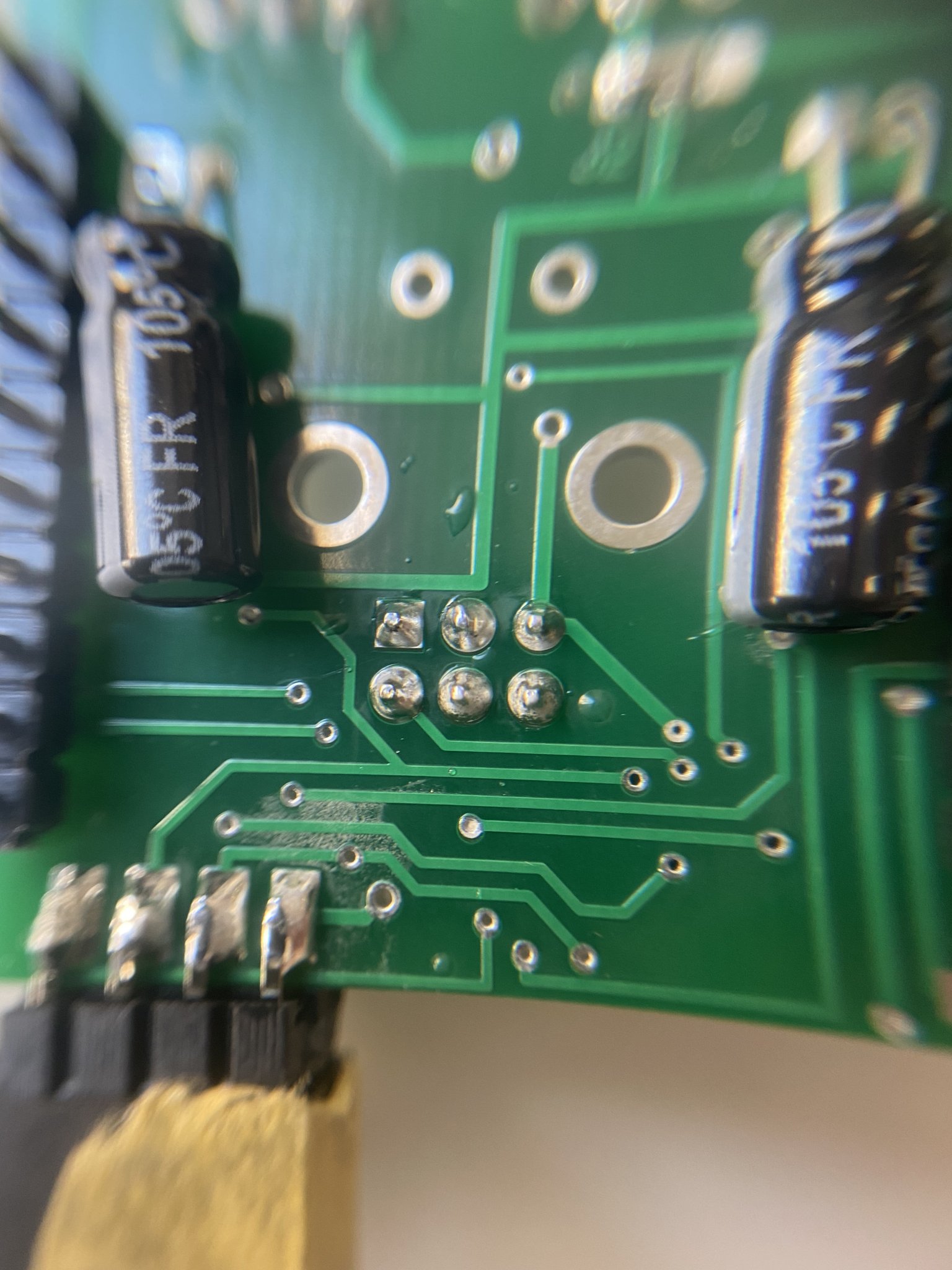

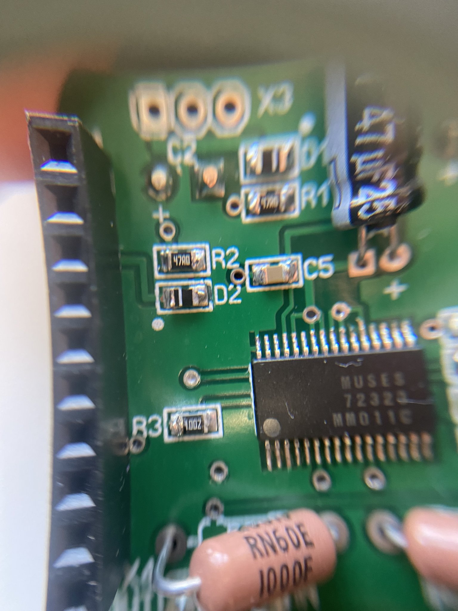

Hey guys,
I am having trouble getting the volume control to work and could use your help. I have an unbalanced setup consisting of a mainboard and one controller and volume board.
In the end I want to integrate the Muses into my BA2018 preamp.
So far I have completed all of the boards and did several test runs. Because I am lacking a variac I had to put the finished baords into my preamp case and hook it up to the VRDN power supply. No smoke and nothing otherwise bad happened - so far so good. I furthermore was able to verify that the controller led is working for example when muting via pressing the encorder. The process of teaching a remote control and using it to also works. When switching channels I can hear the relais click and the respective channel led lights up afterwards.
Now to the problem at hand: I am getting absolutely no ouptut from the volume control. It is dead silent.
Is there any way I can verify, that the muses ic is working? Unfortunately my toolset is kind of limited to a dmm. Where would I start measuring and how? I have attached several photos of the controller and the volume boards.

I verified that I got a signal not with a sine wave but via playing music and testing for AC voltages at X4 / X5 "in". Is that correct? Sorry, kind of a noob here... Due to the stacked layout I could not follow the signal path any further to the muses.
I did not test the boards without the mainboard yet. In order to do so I would have to set J2 on the controller board between 2 and 3, right?
SelektaM
2019-08-26 8:42 pm
Thanks for the suggestion! I tried that today (soldered J1 between positions 1 and 2 and set the controller balanced mode to balanced via 0-0-0-8-0-0-1). Unfortunately I still cannot measure any signal at X4 it X5 out. Is it possible that the muses chip could be defective? I took extra care not to overheat it while soldering.
