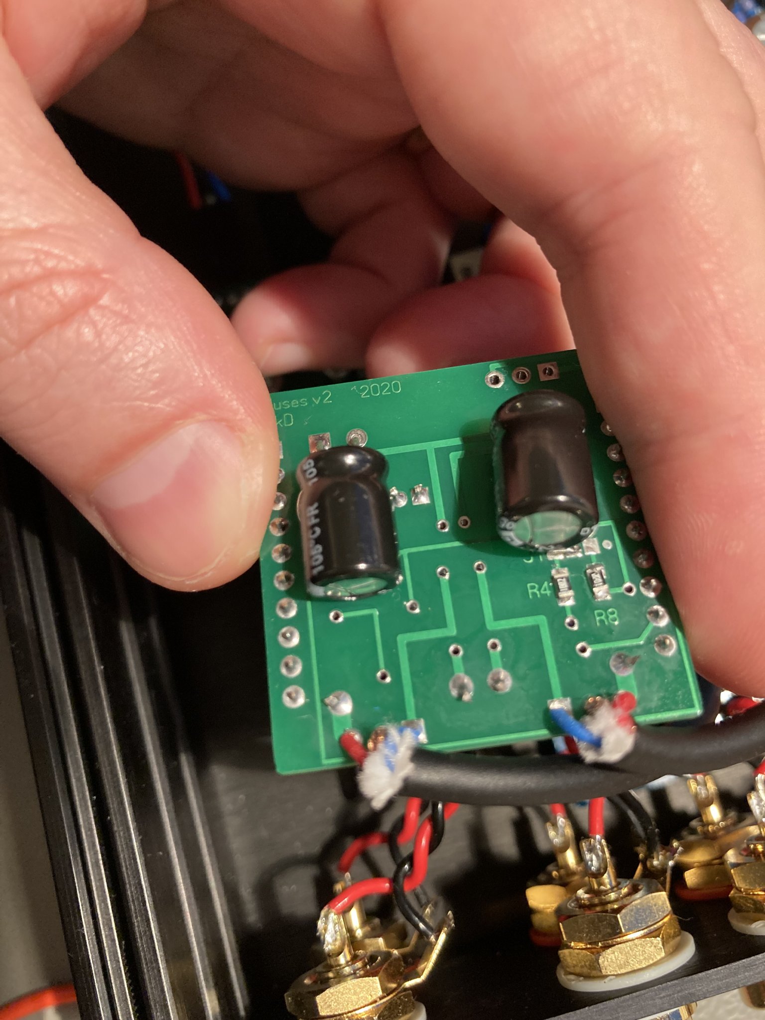

I have some odd behaviour with the v2 in SE use. There is only sound on the right channel, and the volume doesn't change when turning the encoder, nor does it go mute when pressing it. I installed the LED and it does light up when pressing the encoder. Going through the remote control programming seemed to work as well. So I think the controller must be ok. I did the "beep" test on all legs of the MUSES chip and it seemed to check-out correctly.
Did you check pins PA1,4,7 from the controller to the muses?
Is the value from R5,6,7 (volume board) correct?
R5, 6 and 7 are all 100. PA1, 4 and 7 seem to be connected correctly as well. Might be worth reflowing?
Please check your grounding. The Muses controller sometimes reacts sensitively to parasitic potential influences.
Then the uC does not react correctly to the signals from the encoder.
It's the MUSES72323V-TE1 and the v2 boards / controller etc.
@paxm3 Interesting. Which ground should I pay special attention to? Power or audio? It's installed next to two Edcor PC600/600. Could that have an influence?
@meldano Well I hope not, given how hard it was to get one of these... How would I go about measuring the signal flow of the data lines? Not sure I have the right tools.
