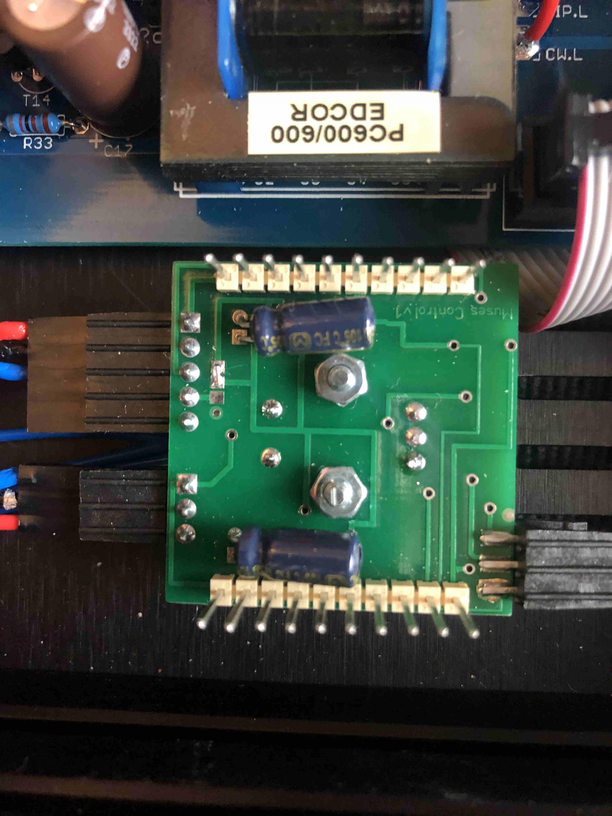

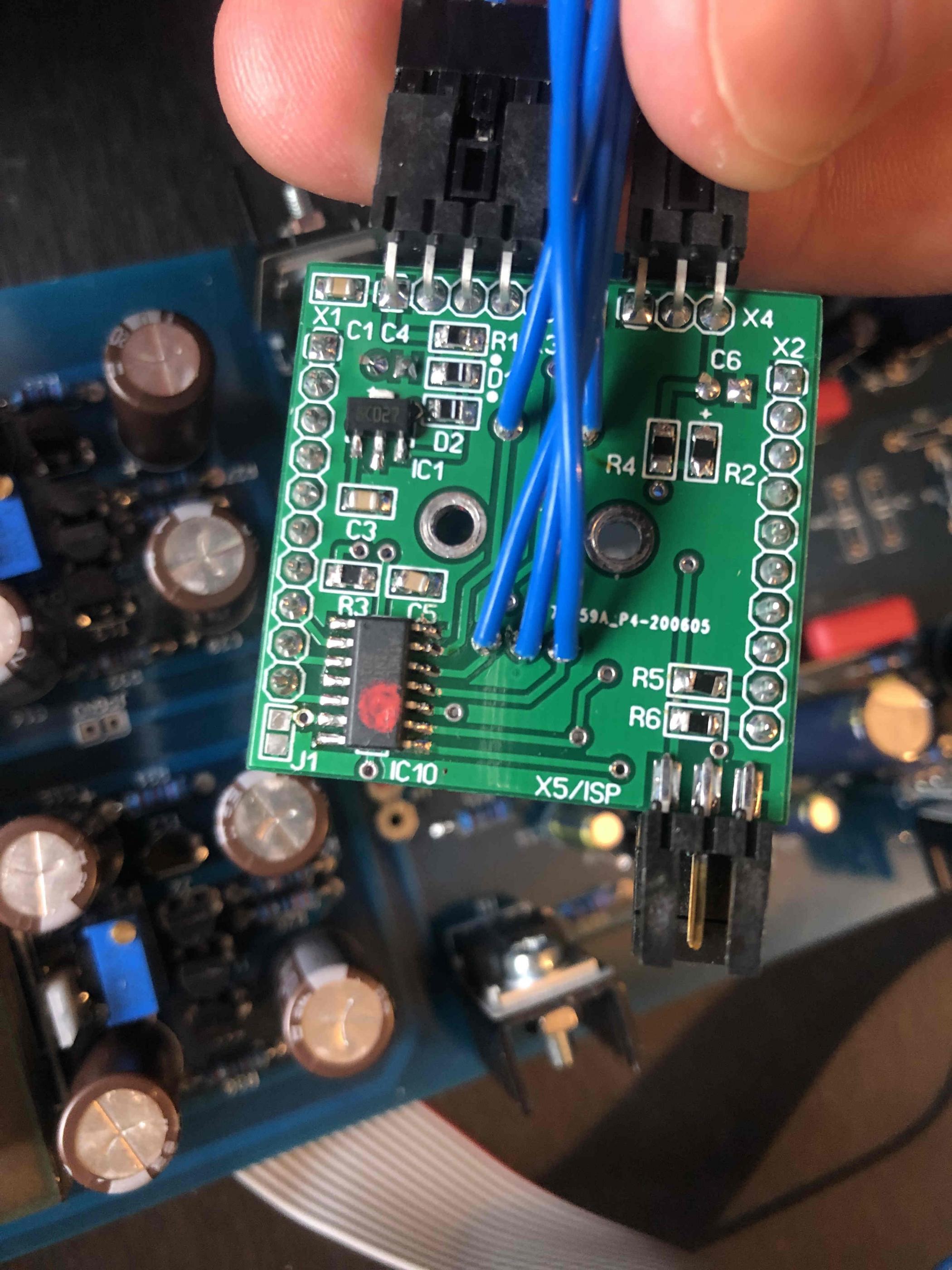

Finally had time to come back to this. I'm still struggling to get my v1 working. meldano kindly sent me a new controller, which I installed following all precautions.
The muses chip seems to start-up at power-up (resistance between input and output drops from 200k to ca. 20k), but turning the encoder doesn't do anything nor can I program the infrared remote control. So, at this point I'm wondering if my encoder is broken?? (https://www.mouser.co.uk/ProductDet...vUC/3abYfYw==&countrycode=GB¤cycode=GBP)
Any ideas?

In some cases the controller don’t wake up from sleep mode by rotate the encoder.
I updated the documentation (have a look the the first post in the thread).
It is possible to solve the problem:
a) with two pull up resistors (500k-1M)
b) update the firmware
ba) buy a st-link v2 clone and contact me. I will flash the new firmware with TeamViewer. You’ll need a windows 7/10 PC with USB
ST-Link V2 Programming Unit mini STM8 STM32 Emulator Downloader M89 New Hot | eBay
bb) contact me and send the controller back. I will flash the new firmware

I only have a multimeter, but measuring the rotary encoder each step (or pressing it) swaps the 4.8v between the pins. Not sure if that means that it is working correctly...
Just checked again and both the IR Receiver and the encoder seem connected correctly. I've also tried it without the IR Receiver connected and it's the same...
Please connect only the rotary encoder switch and the ir reciever.
