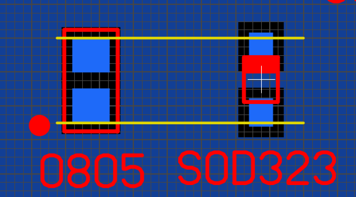

SOD323 is an option but not perfect

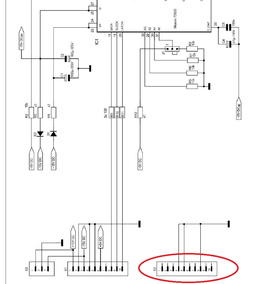

I plan to implement my modules with the control PCB on the front panel and two stacked volume PCBs at the rear of the chassis with ribbon cable connections.
Referencing the documentation, see screengrab below, it would appear that I onlt need to use a ribbon cable between the X1 headers. The X2 header on the schematic appears to only have ground conenctions, which are also made via X1.
Am I reading this correctly?

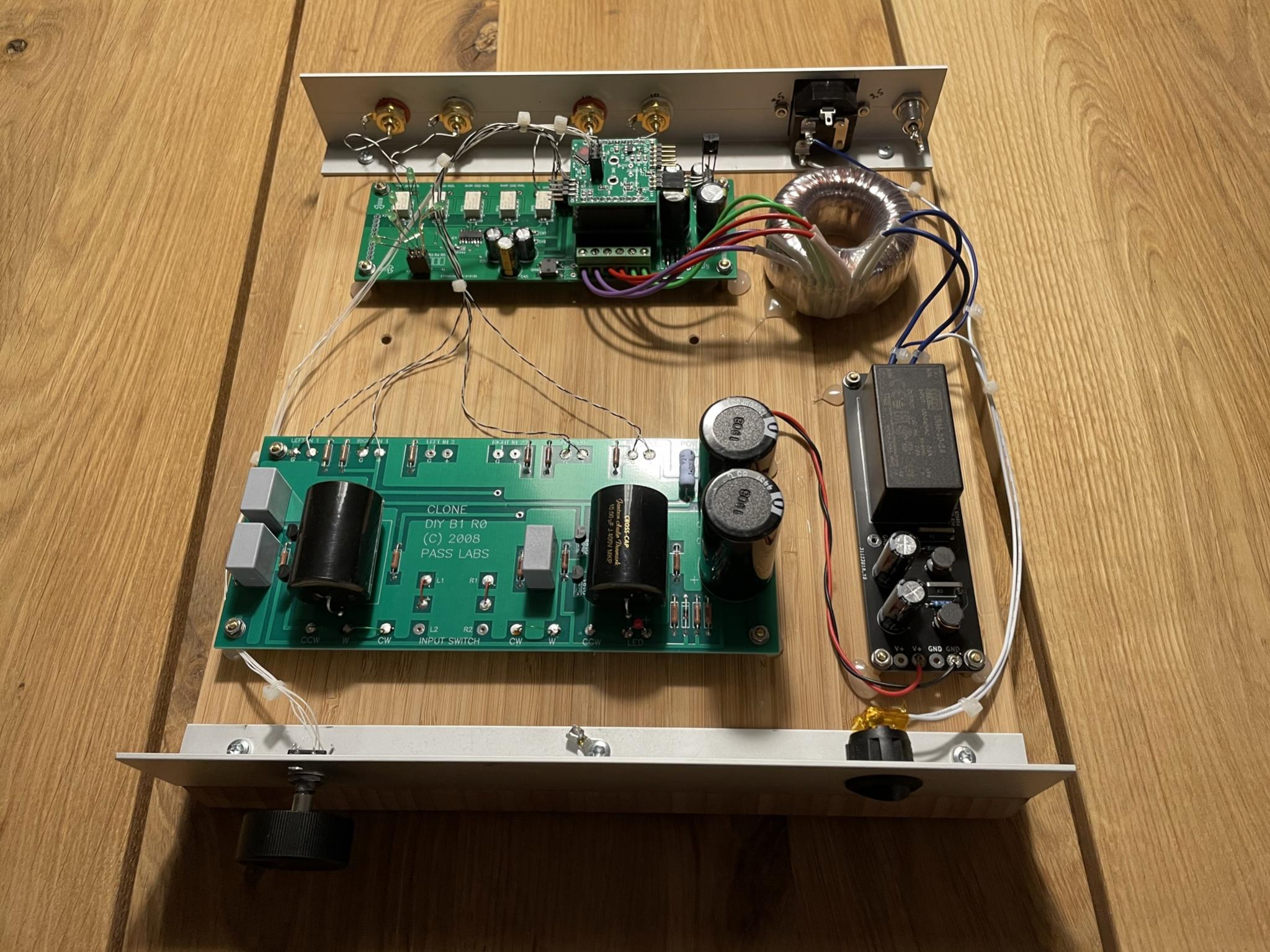

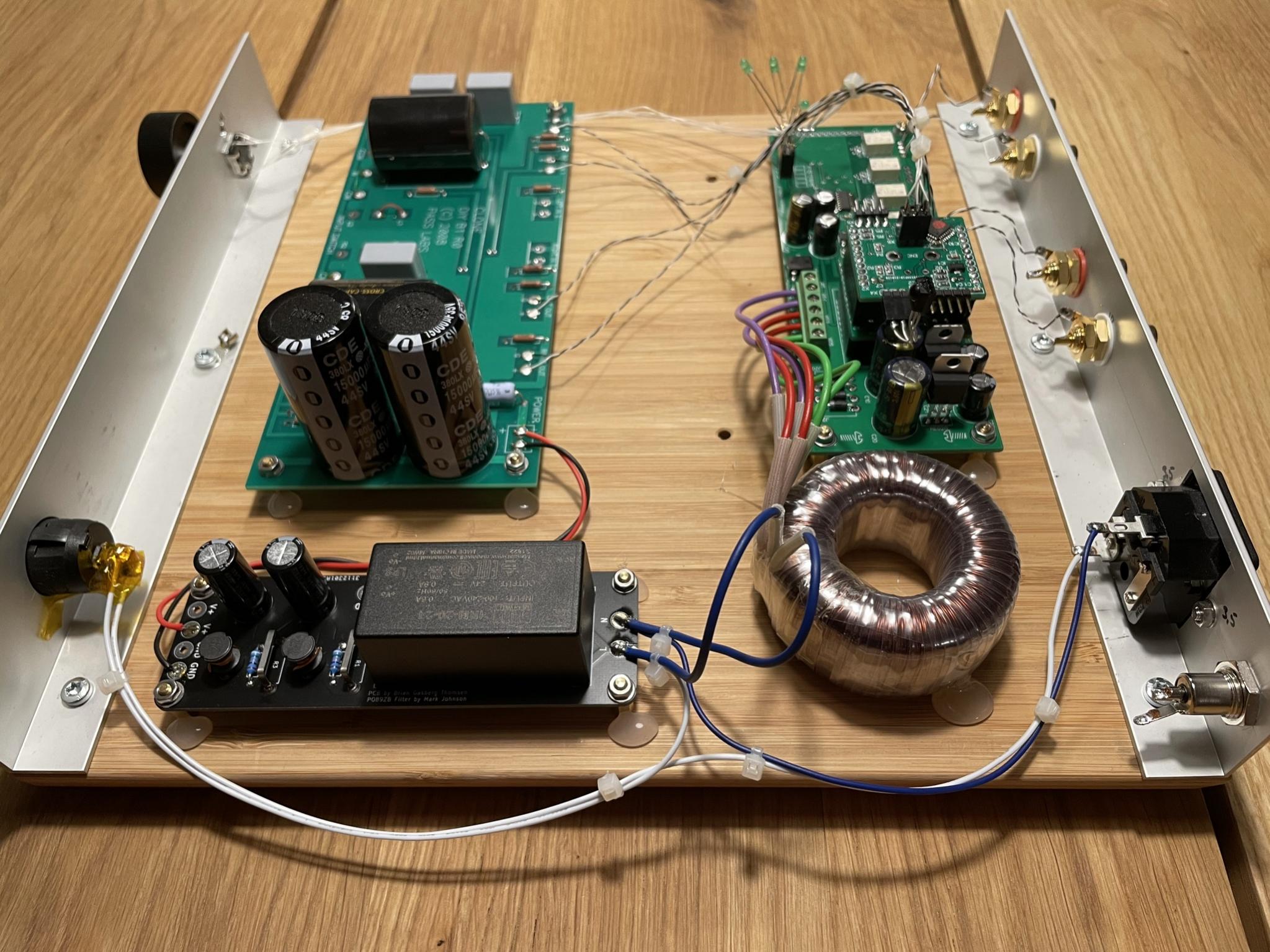

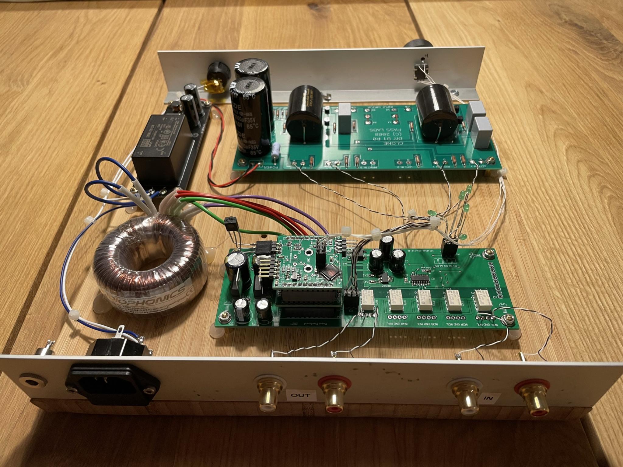

At the moment it is very much a prototype build - i am using the Muses volume and input select in front of a B1 Buffer.
The B1 power supply is a 24 V MeanWell IRM on a PCB with Mark Johnsons line filter. The "LED spider" 😉 on the main board is there because i wanted the LEDs in the prototype but with long leads so i can cut them, and use them, when i am ready with a chassis for it.
I am currently designing a linear PSU (TPS7A47) for the B1, when that is ready, all of it will be put in a box 🙂

It works🙂
Just need to implement that IR-receiver so I can change the steps to 0,5dB.
I saw a suggestion for Apple TV remote but it doesn't have numbers. Do you use another remote for configuring 0-9?
Thanks for excellent boards and documentation Meldano!
