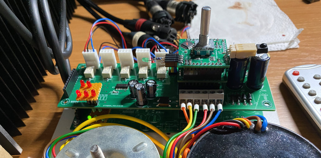

@meldano,
works great ... I think a little more clearness and a little bit more punch at bottom as the "old" MUSES.

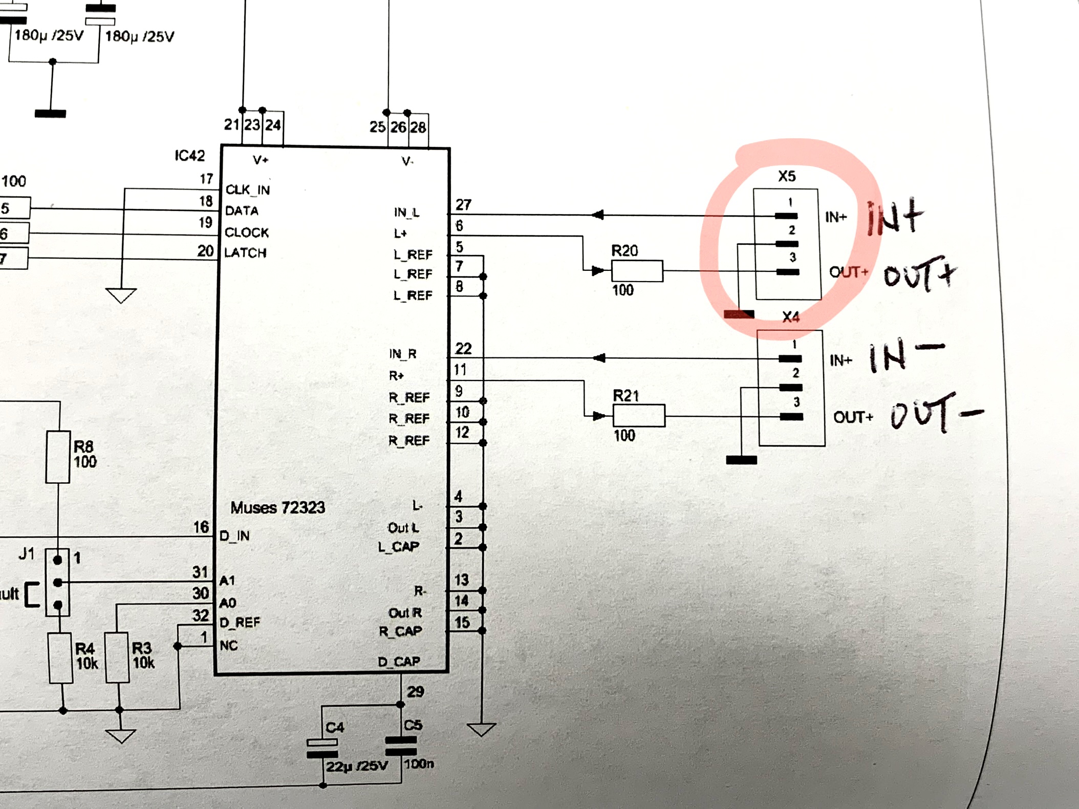

Hi @meldano,

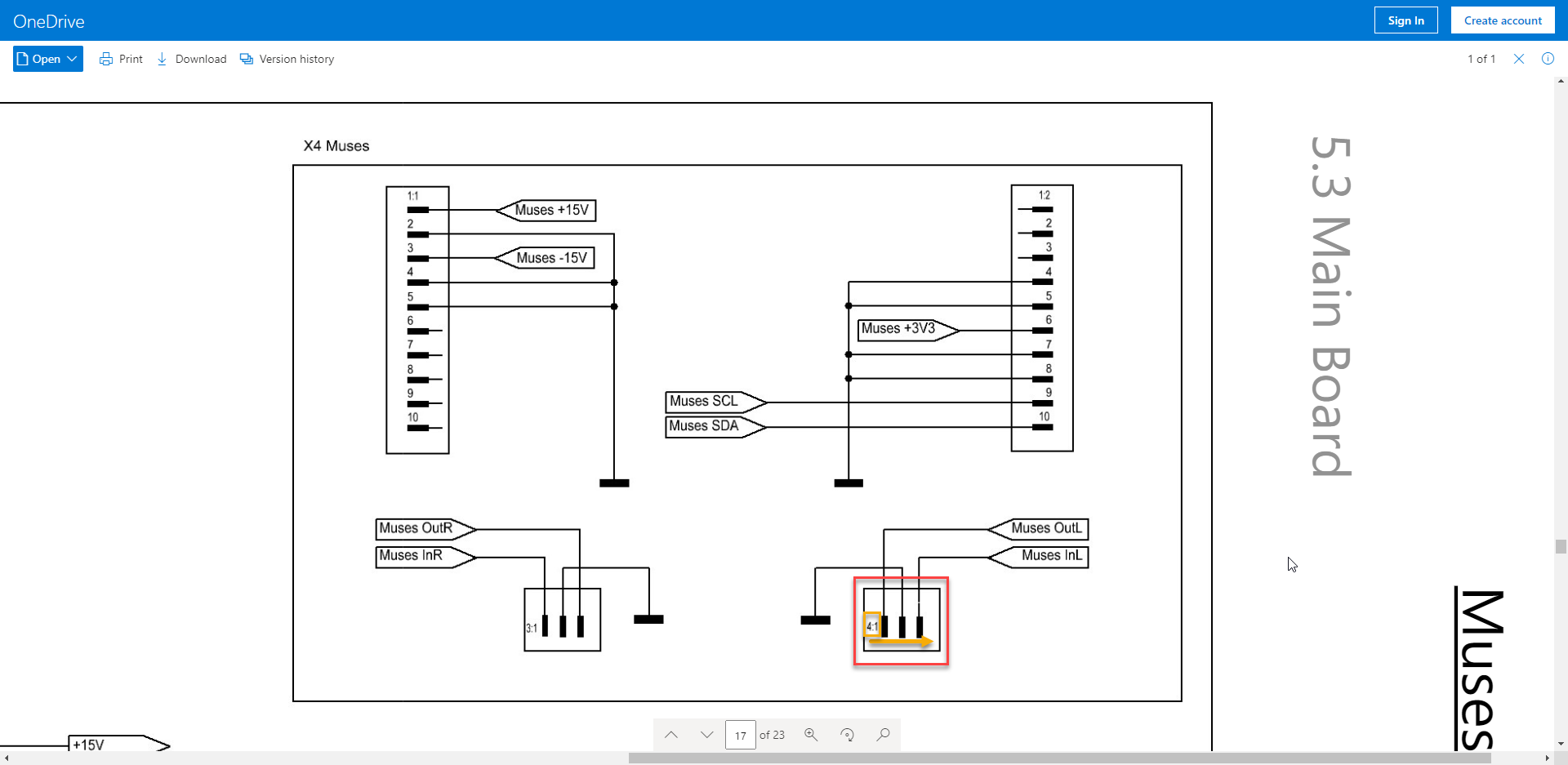

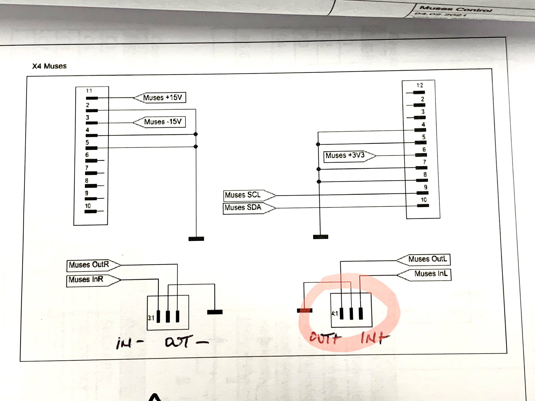

While reviewing the schematics, I may have run into a pin labeling error on the Main Board. Presuming I read this correctly, the input and output signals for connection point X4-4 on the Muses interface area are reversed. Presuming the leftmost connection in the schematic is X4-4:1 and X4-4:3 is the rightmost, it is opposite of pin 1 on Volume Board.
If you’re stacking boards, you’ll probably never even notice it. My configuration will likely have them separated, and it might get wired out of phase if I’m reading the schematics as I believe them to be.
Board artwork is fine, though, so no worries. Likely not an issue for most. 🙂
Thoughts?

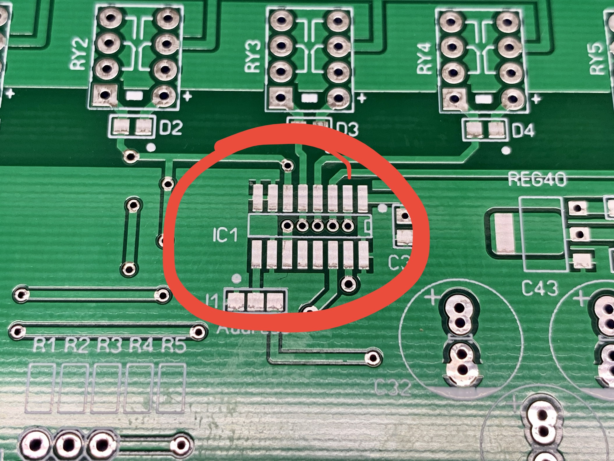

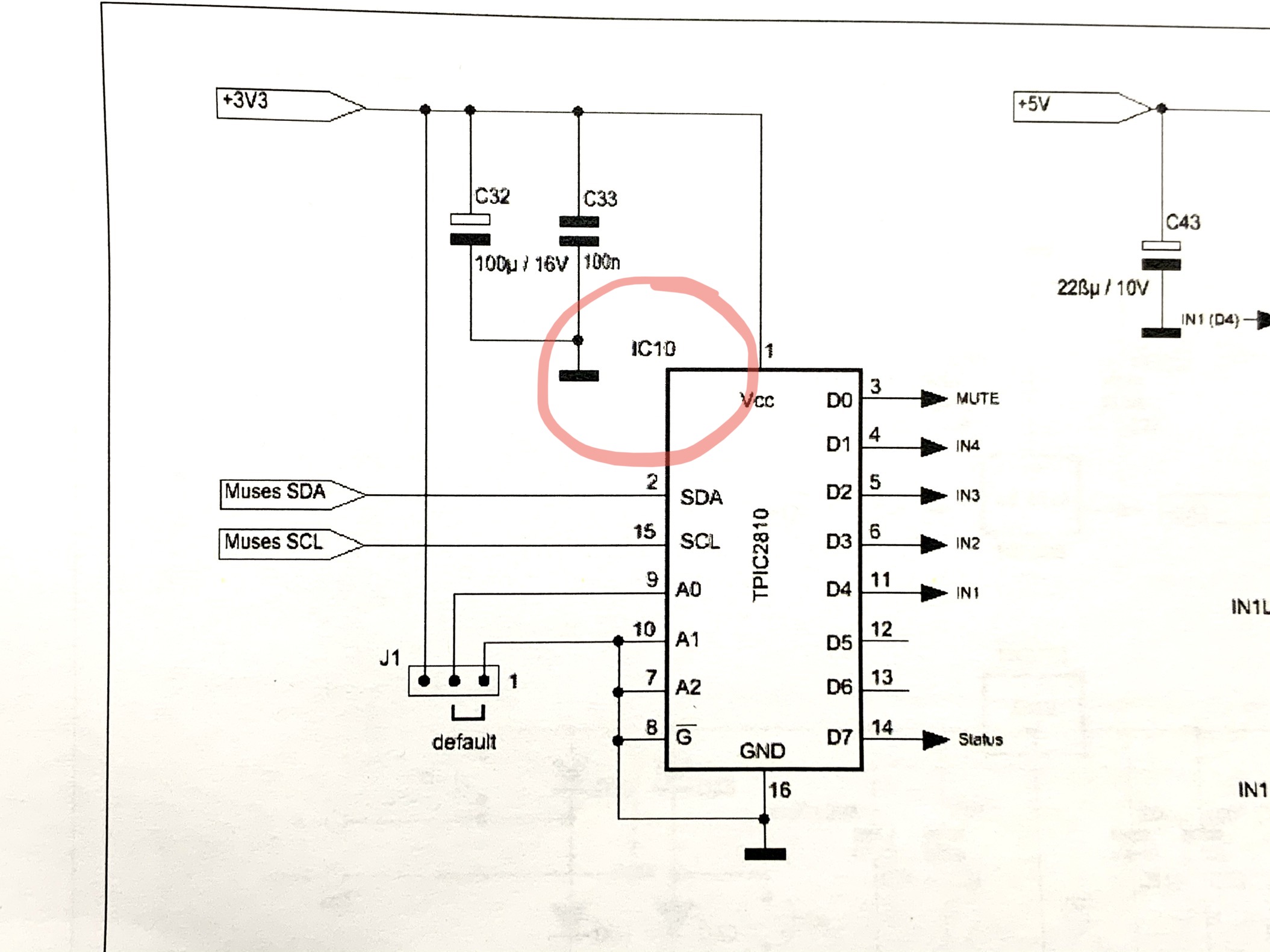

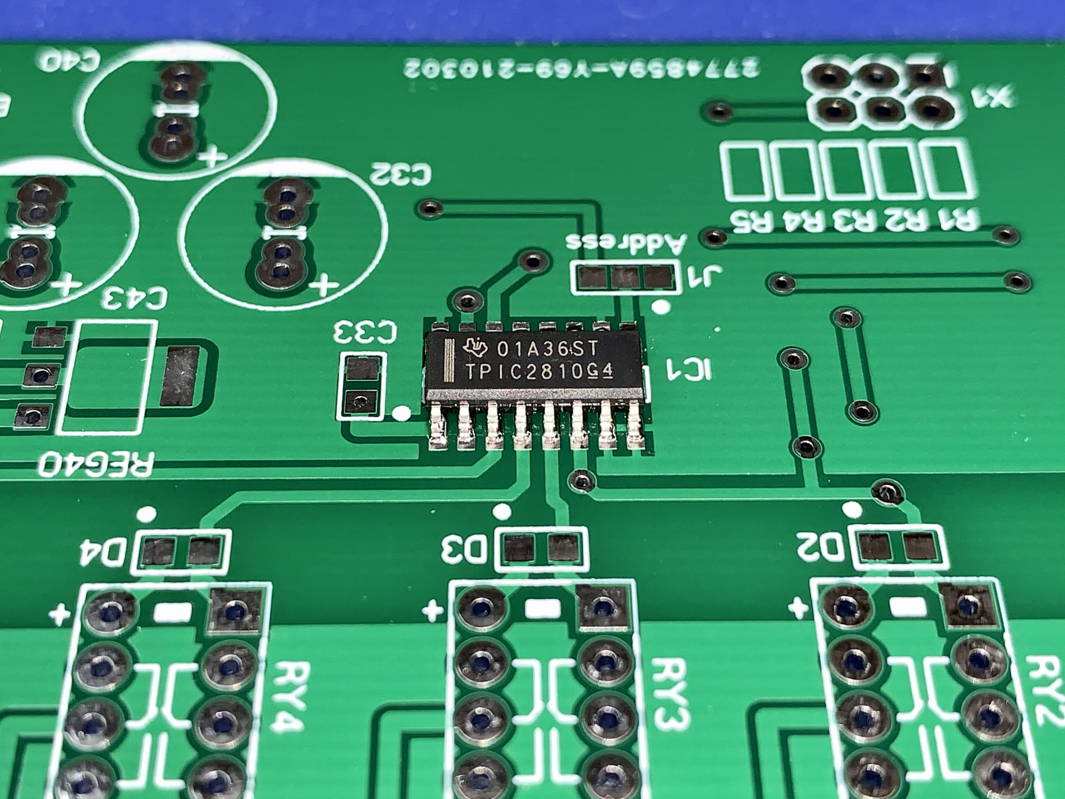

EDIT: IC10 on the schematics are labeled IC1 on the Main Board. 🙂
