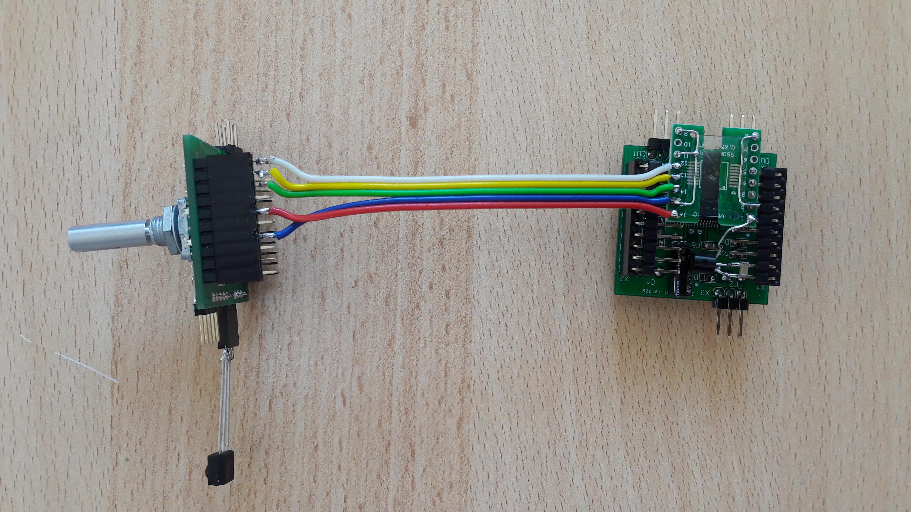

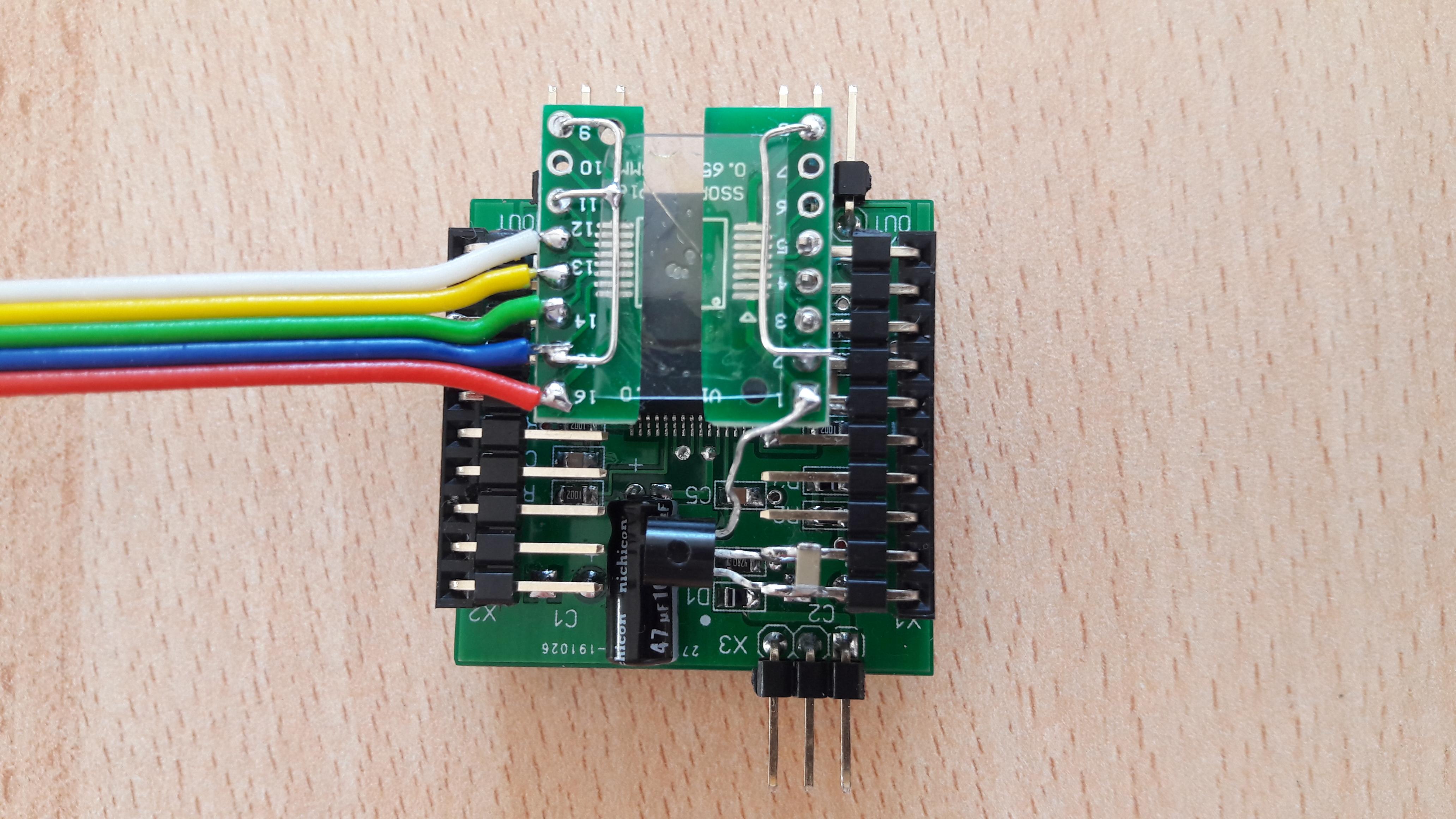

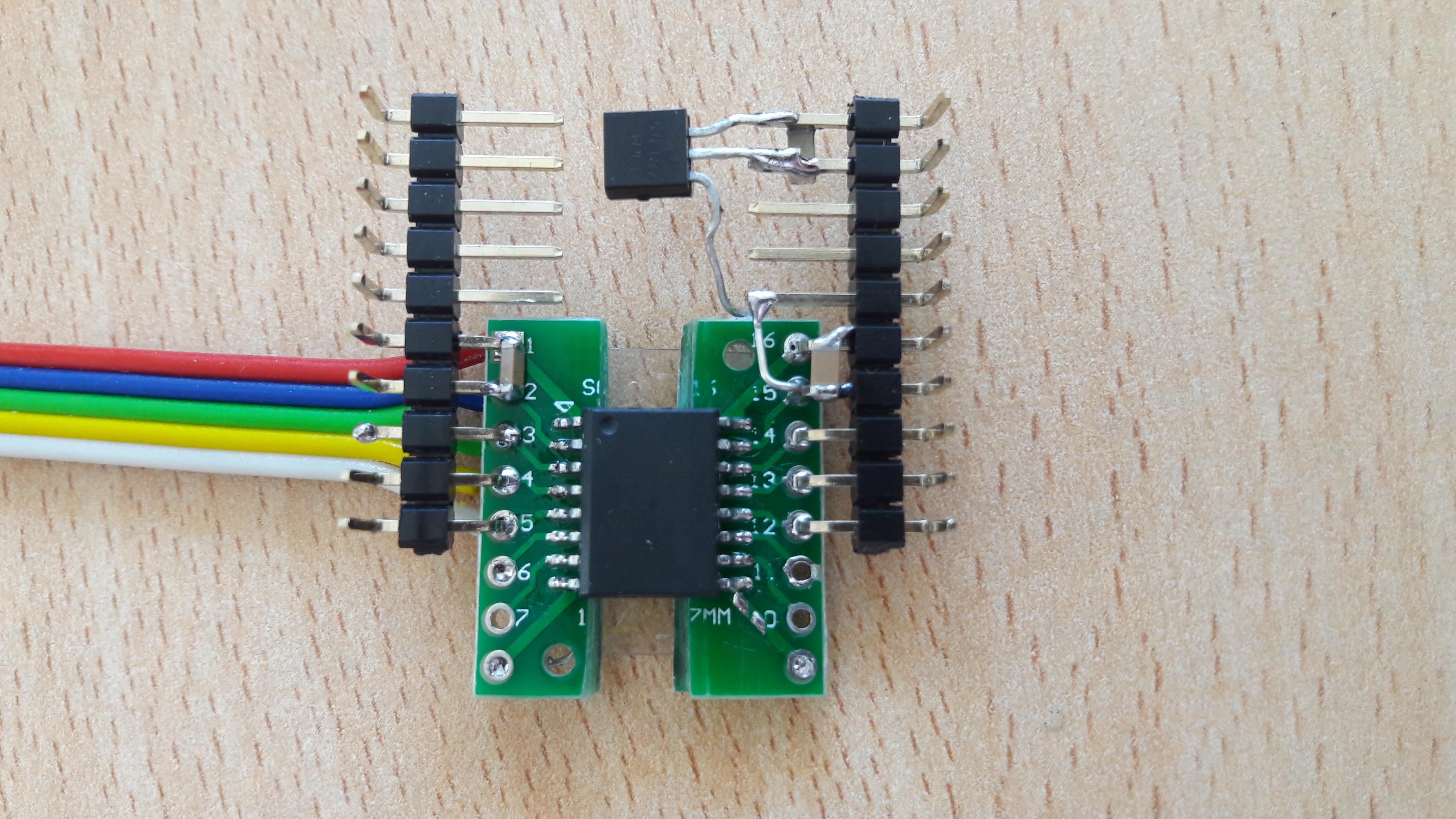

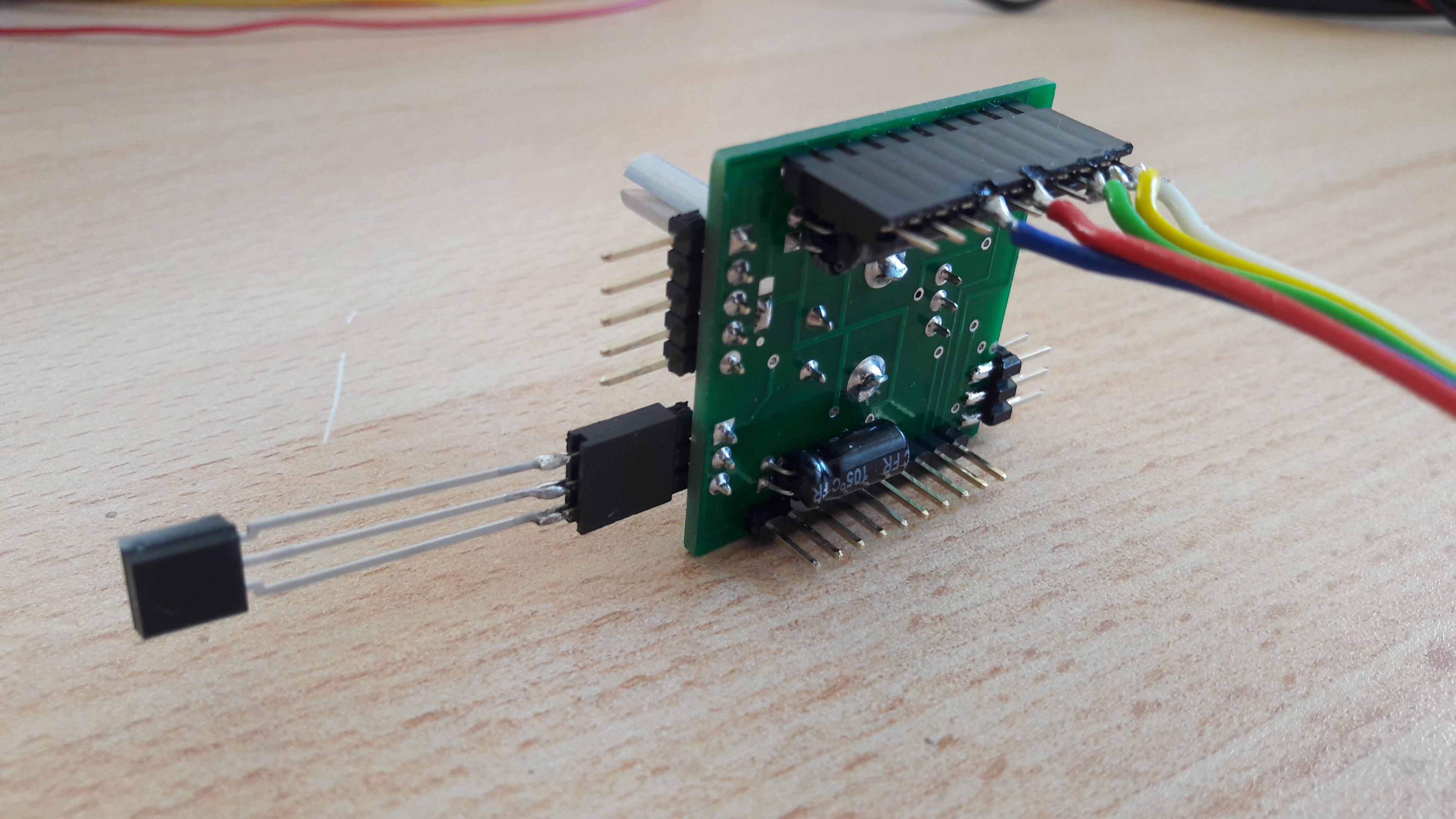

I solved the galvanic isolation of the controller and MUSES with an ADUM1400 (thanks Daniel for the suggestion!) 4-channel digital isolator.
Working perfectly!

From bottom to top:
- Main board with assembled Relais and X1,X2 connector
- Volume board
- Full assembled main board
- Volume board
- Controller board
Please note: bottom main board is connected with X2 to the other main board and with X1 to all other boards.
