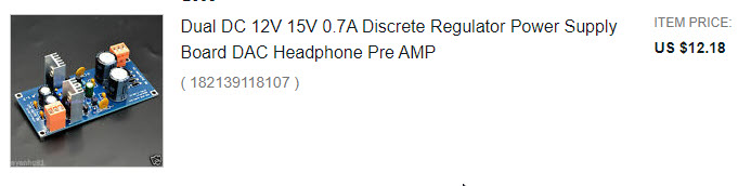

Thank you Rick! I used separate 5V and +-15V tapped from my preamp psu and I know it is quiet but still have the buzz.

Hi everyone!
I am out of ideas. I am waiting for the ADUM1250 socket but I do not think it will solve my problem. The buzz is loud, not faint.
There's a buzz every time I connect the 5V Vcc from pin 2 of X5 (Gnd is pin 6). I tried a different 5V supply (move jumper from 2-3 to 1-2 on the controller board), and a different 15 (+-)V supply to no avail.
