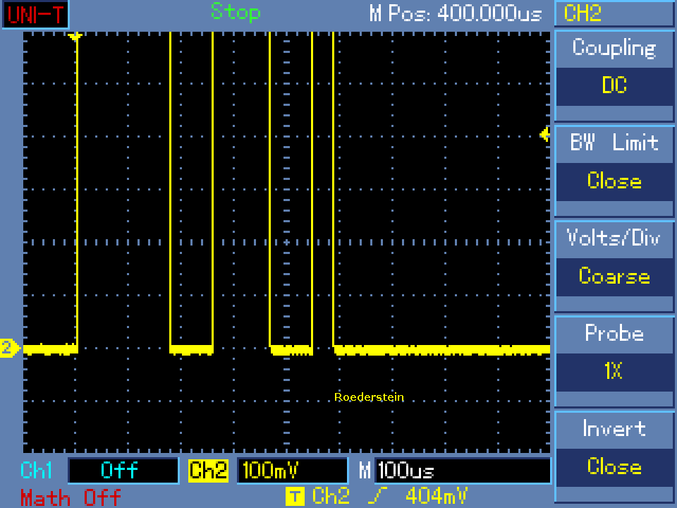

There is just one notable difference between these two capacitors, and this is DA (dielectric absorption). This is seen with a DC-like measurement. You will discharge both to zero, then open the leads, and wait some time (like 1 second, 10 seconds, 1 minute etc.). The capacitors will charge to some voltage (very low) due to electric charge absorbed in the capacitor dielectric foil. In this respect, Mundorf is better, it will keep less residual charge than Roederstein. This is due to dielectric used, polypropylene is better here than polyester. SY can tell us more, he is an expert in this field. These are low frequency phenomena, they could occur only with asymmetric waveform of several hundred ms duration. I have no valid data here. I have some basic DC measurements.
Looks like a possible cause of my perception of the sound. How do you relate that (DA) to e.g. PHASE behaviour (or other simple variable)?

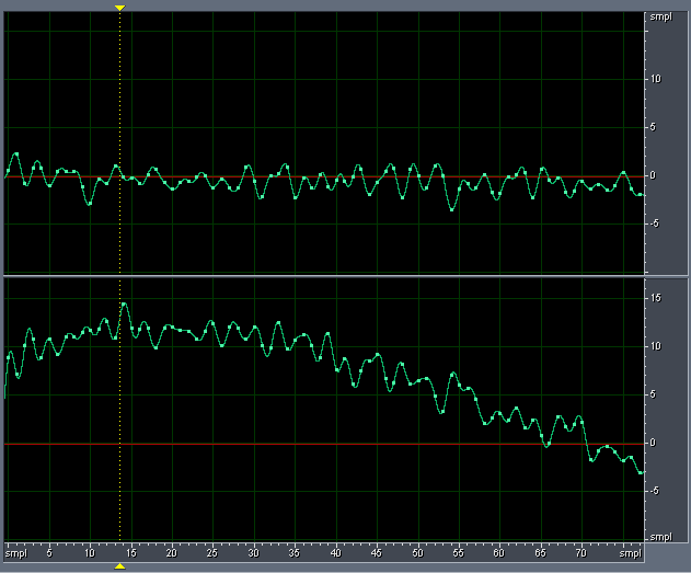

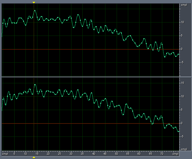

Lets look at first 78 samples for left channels of Cap1, Cap2, and Cap3. First Cap2 left channel in top track with Cap1's left channel in bottom track. Here I found best alignment required single sample offset:
Extensive identity exists between the two, seen by subtracting the Cap1 samples in bottom track from Cap2 samples in top track:
Result effectively returns dither/noise of total system.

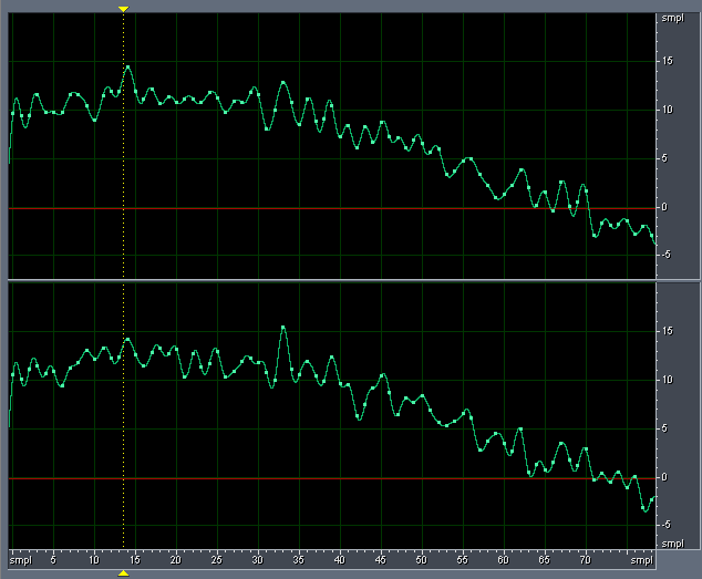

Next Cap3 is aligned below Cap2:
Sample 33 for Cap3 in above pic stick out with short rise time.

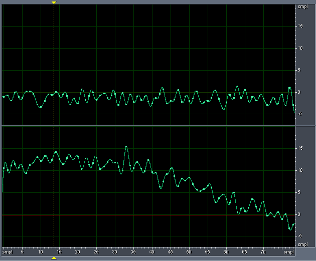

Cap3 samples are subtracted from Cap2 samples:
Again, basically dither/noise, but with slight negative bias, suggesting Cap3 had slightly higher overall voltage.
May Cap3 be thought of as faster than Cap2?
The above may be used to differentiate the capacitors, but similar analysis elsewhere in waveforms with higher signal levels do not produce same results, and this was not used for in my differentiation of the caps.
