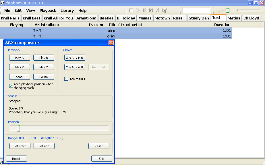

I get 7/7 ABX result when I compare the original sound file with D/A - wire- A/D sound file. Matched and aligned, of course. Listening in a second room through open door, sitting at my PC, the biggest difference is in the sound impact.
When doing cap1 x cap3 (Mundorf x Roederstein), I get 2/7 result, or something similarly random when repeated.
The conclusion, to me, is like this: there is a big difference after applying a commercial D/A - A/D chain to the original data. I would need something like Meitner system. Thus, even if there was a subtle audible sound difference between the caps, it would be very difficult to catch it, without having the best SOTA D/A A/D hardware available.

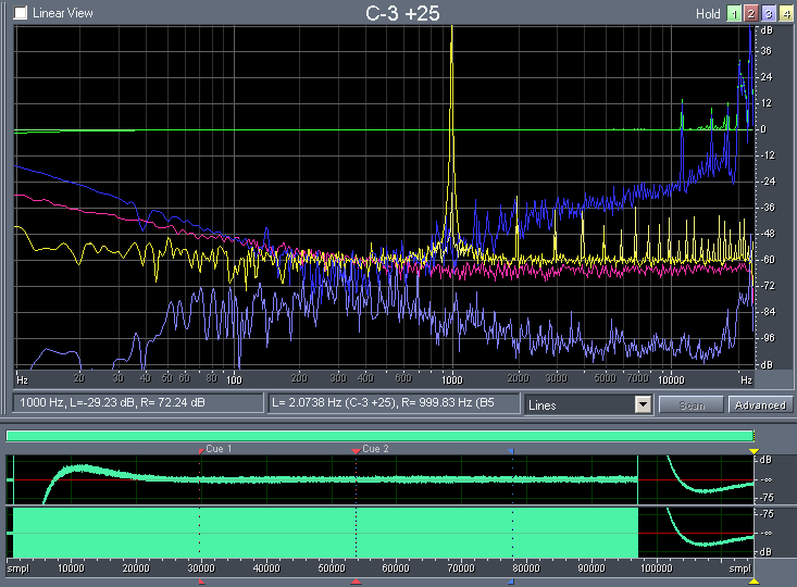

I must take a break now, but leave off with a picture worth a thousand words. It contains information about original.wav, wire.wav, and superposition of a 1kHz.wav from a similar D/A A/D system. Later I will provide details of wire.wav and original.wav run on this similar D/A A/D system with fresh and proper referenced 1kHz.wav:
The above does involve other time transformations, and perspectives.

Temporal and frequency are the same thing (or freely interconvertible). Ditto amplitude, which can be expressed in either the time or frequency domain interchangeably. Fourier Denial seems to be a strange mental pathology harbored by some.
The "simultaneous" requirement is odd- I can measure my car's speed, its length, and its weight. Why would I expect or even want to use a simultaneous single measurement to characterize all of them?
Time may be viewed as stationary with energy constant and moving across time.
If what you mean to say is that energy and time are conjugate variables, then fine. But as soon as you say "moving," then time isn't "stationary."

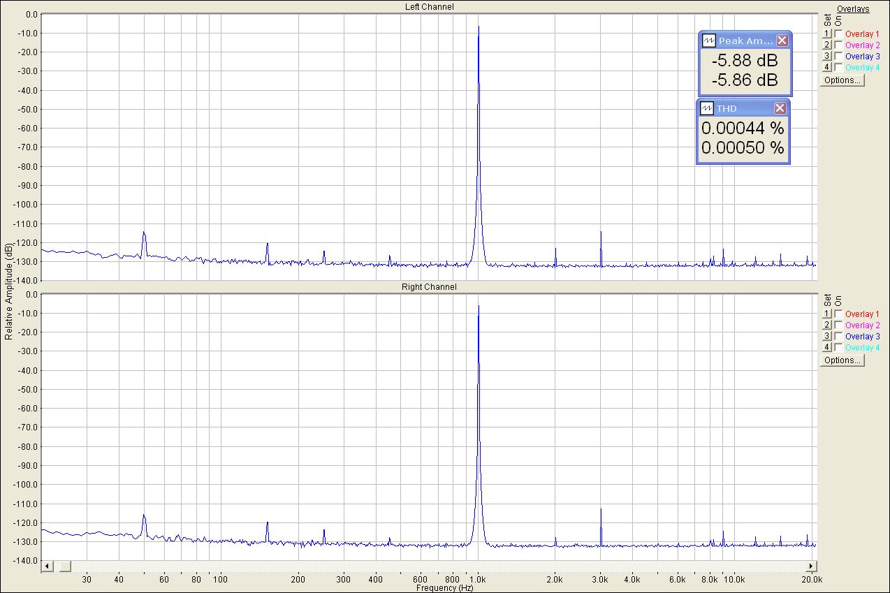

This was recorded with the D/A A/D system under test, all settings same, 0dBFS D/A file, replayed through foobar and recorded by A/D 48/24, exactly same conditions that I used to record the wire.wav, all foobar settings for 1kHz same as for sound files.
