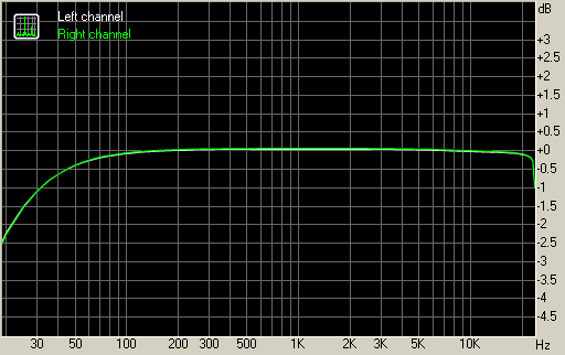

However, there is a chance that the difference in LF content being fed through the analogue circuitry, at some point before the speakers is having an effect - I'll try a copy and paste of that content, to see if it makes a difference ...
Frank it is quite possible that whilst your small speakers have no "audible" output below 100Hz that when they try to reproduce it, you ARE getting inter-modulations in the upper ranges as a result.
The rolloff that Pavel just posted whilst only down 1db at a bit over 30Hz, *may* be enough to make a perceptible difference.

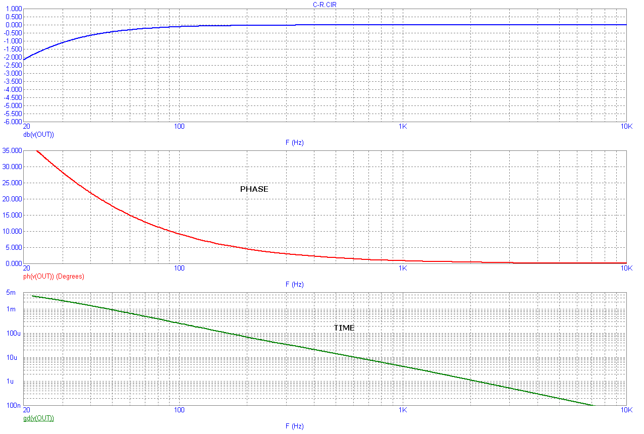

I hope that the attached plot helps. The bottom, green plot shows time difference vs. frequency, with the capacitors under test used. Thus, it is almost impossible to make a difference file between wire and cap files.

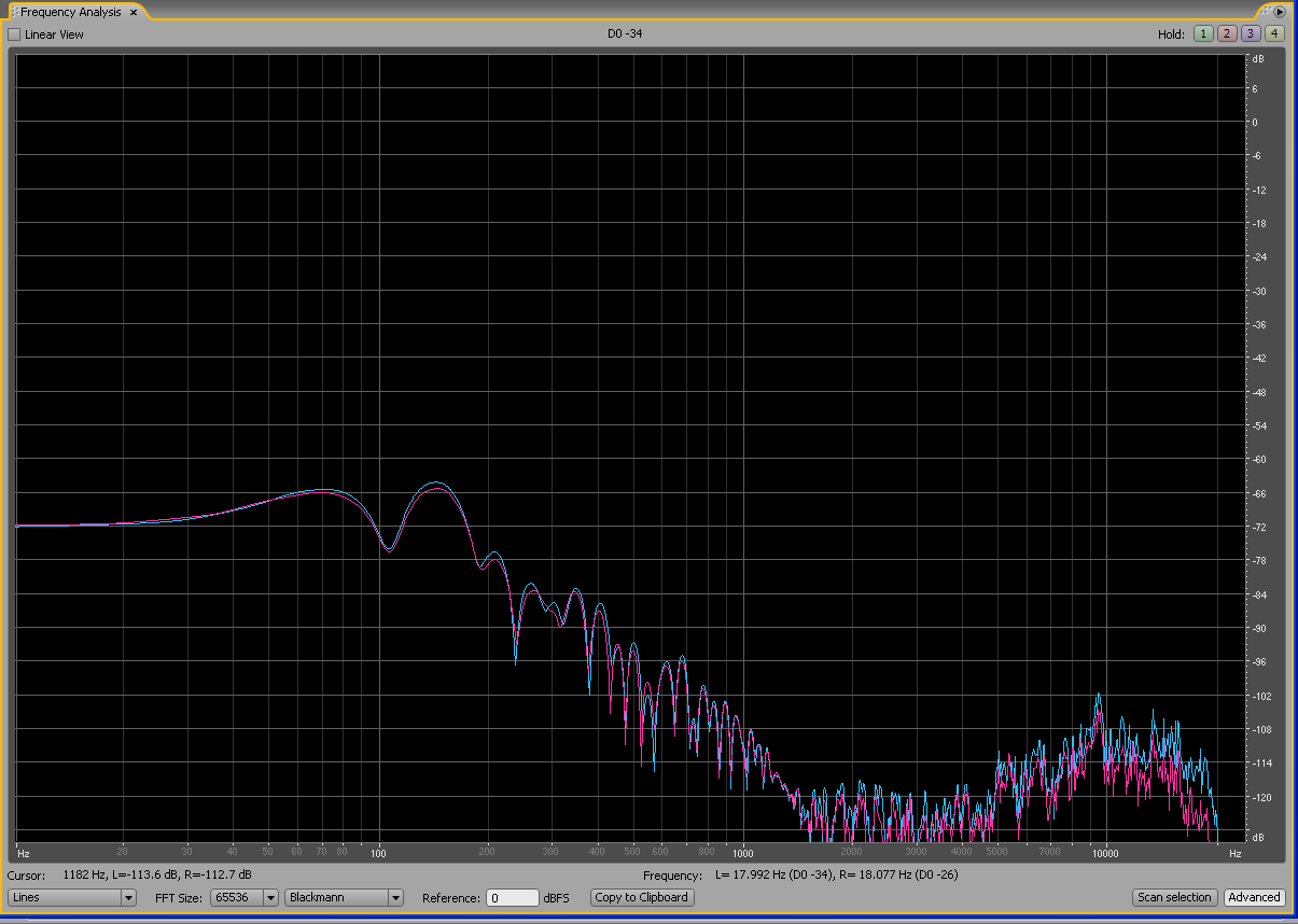

Frank, I have succeded to make a difference file, in case I use only first 3000 samples, before the time differences and phase shifts make the result unusable 🙂. We can see a clear difference below 1000Hz.
Below 100Hz, the 3000 samples window is too short.

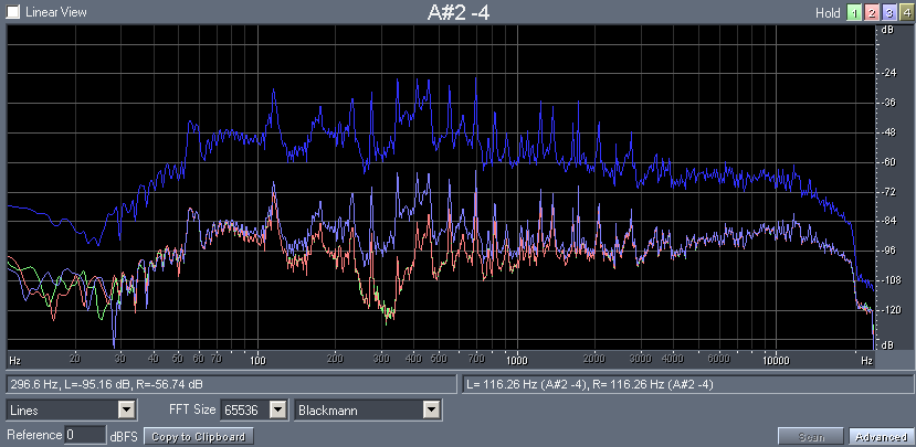

Thanks for posting wire.wav.
The capacitors are well modeled by 14.5Hz Butterworth high pass filter. When filter is applied to wire.wav, difference files become excellent:

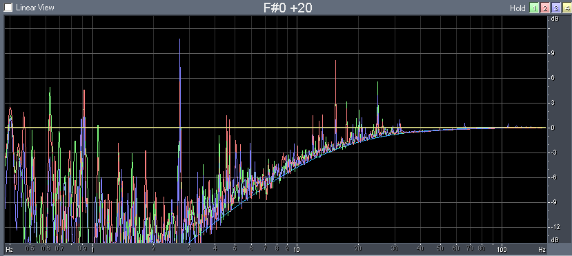

With wire.wav for reference the following analysis is possible:
Above was used in determining 14.5Hz filter, seen as clean white trace. Some strong signals are seen above 0dB reference. These could be in source signal, or produced by caps, D/A A/D, or most likely intermodulation of the various system components with each other.

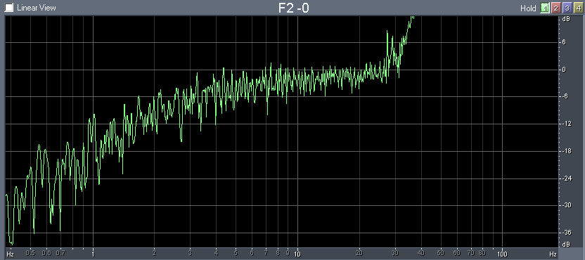

Low frequency view of wire.wav supports system intermodulation theory:
A corner frequency in above is estimated as -3dB referenced to about 30Hz. This could be signal, or high pass behavior of D/A A/D circuit. Obviously, appropriate test signals would resolve all this better than music file.
