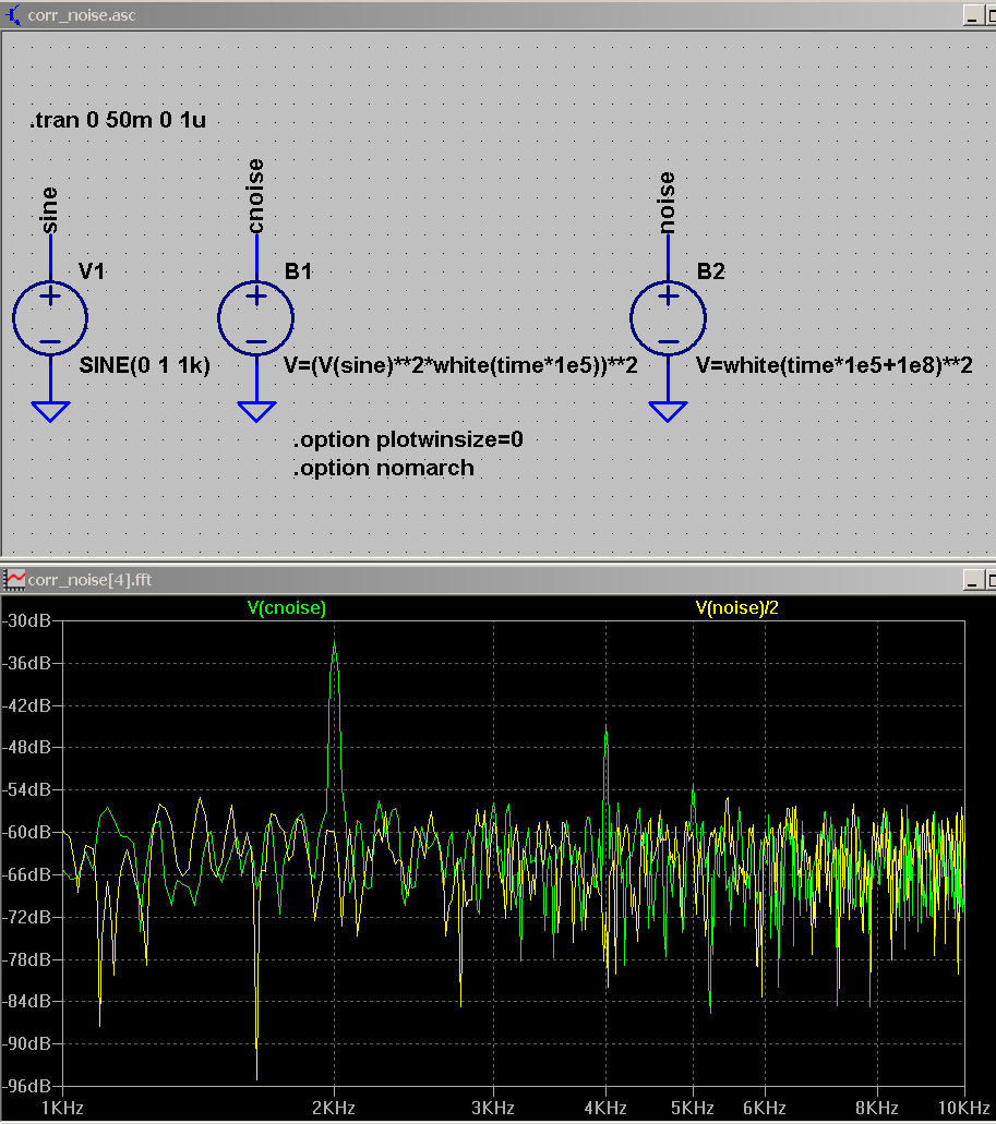

the vague "noise hidden by fft averaging" is lame - fft is in fact an excellent tool for picking out correlations - try the power spectrum
sim shows the clear peaks at 2x the modulation frequency - in the noise Power Spectrum fft (easieist to just square the BV equation)

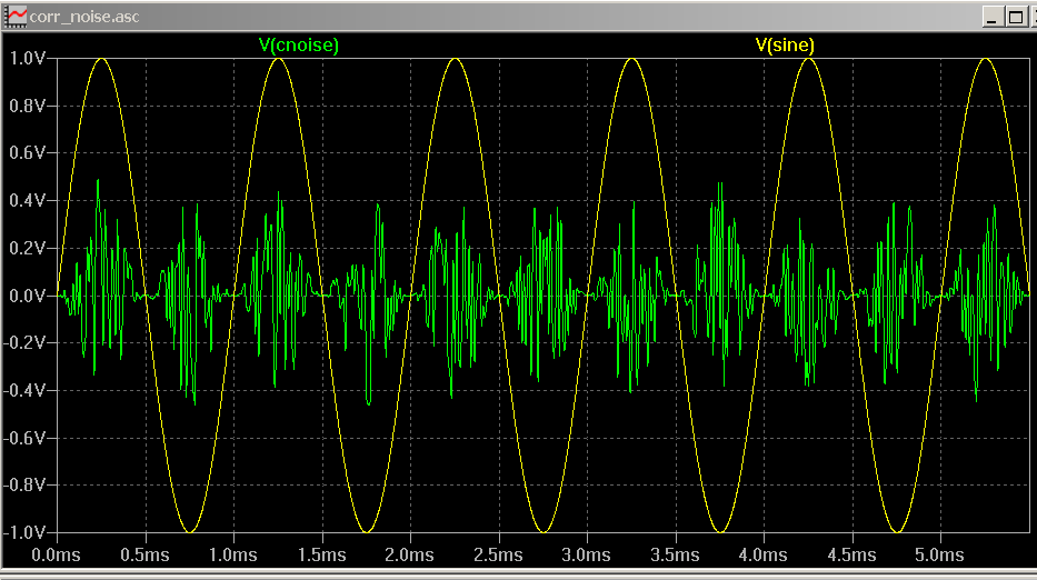

2nd pane just the modulation and modualted noise - not squared
Are you referring to any post here?
It is not a question of hobbyists only, I have never seen any professional method that would reliably and with high resolution measure something that we might call as transient spectrum of non-periodic, non-stationary signal. We all know FFT above single tone, two tones, multitone, noises, frequency/phase responses, impulse responses etc.
None of the measurement is able to provide us with a complex non-linear transfer function with respect to frequency, amplitude, load and input impedance. I would like to see it, once.
OK, but I see nothing about noise hidden by FFT averaging.

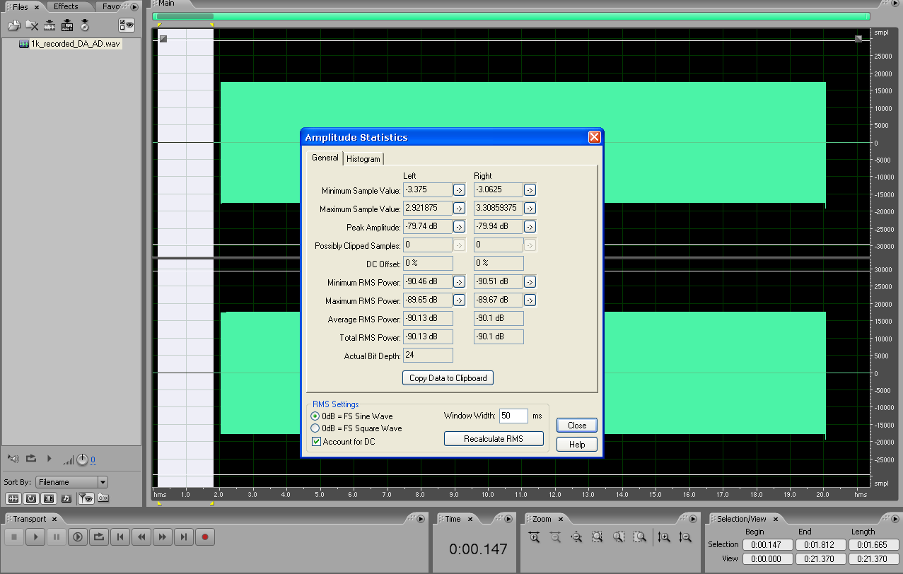

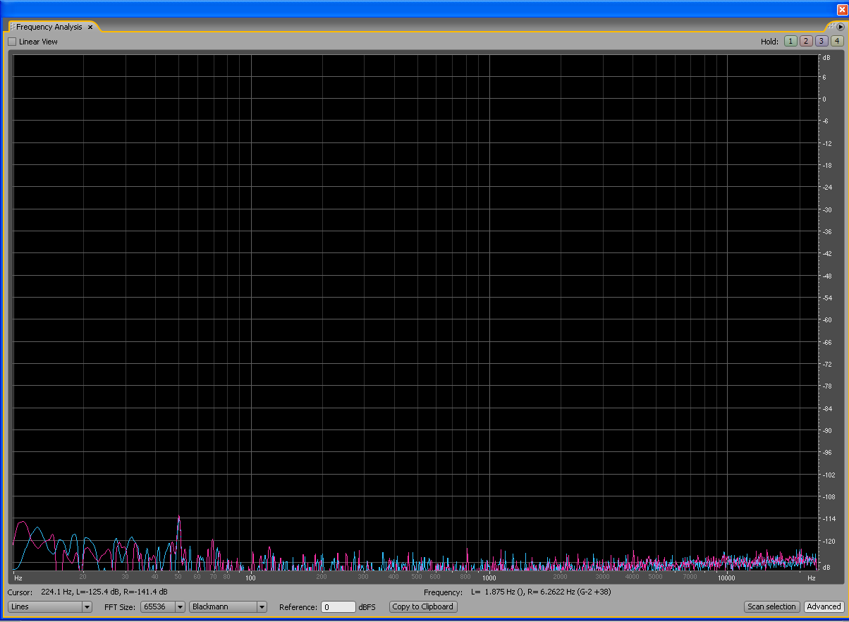

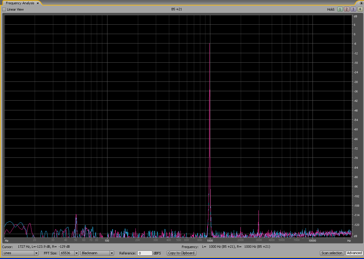

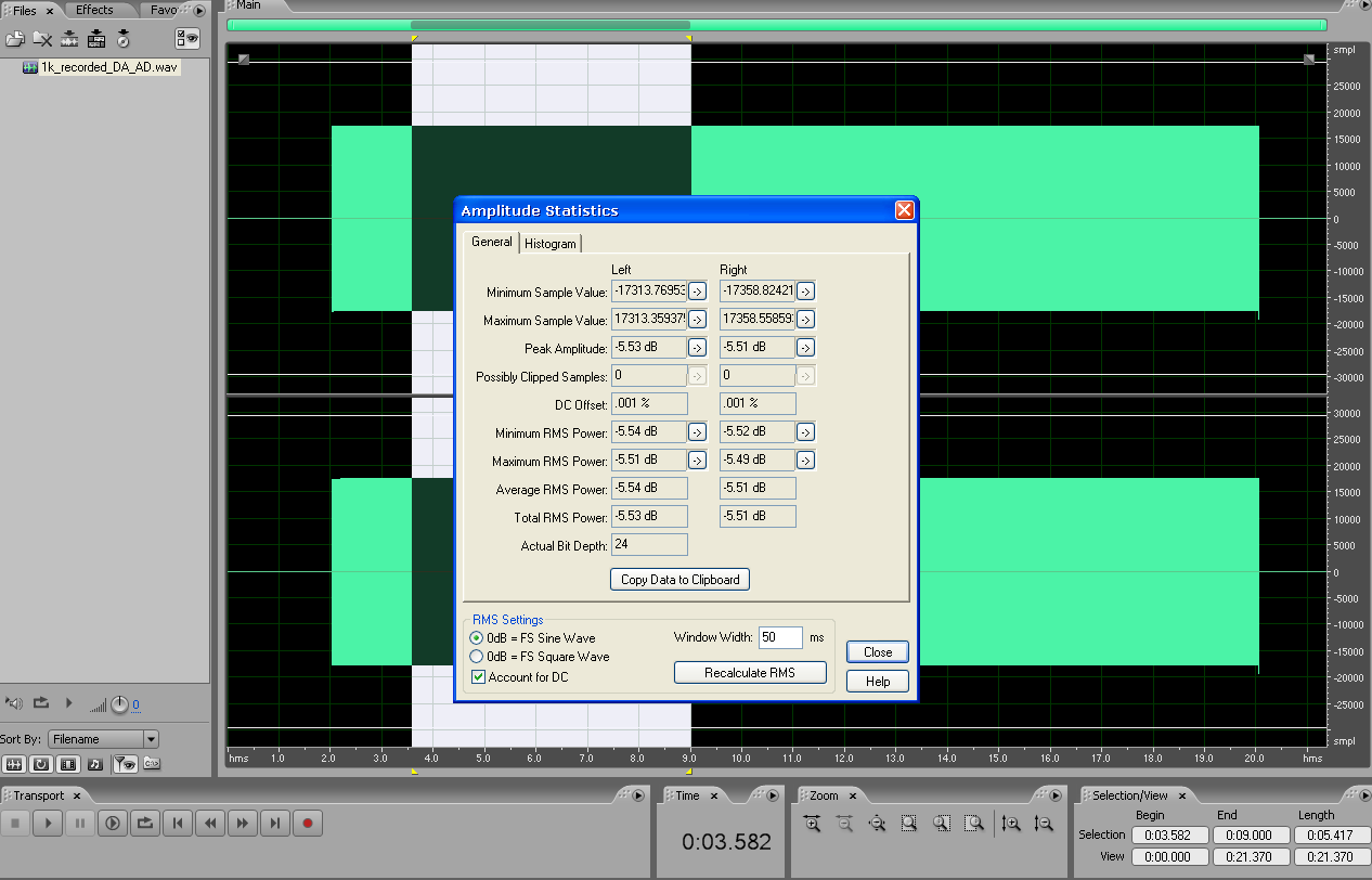

Barleywater, this is the 1kHz 0dBFs signal replayed through my D/A converter (via foobar) and recorded by my A/D converter. All conditions same as in the test files in this thread, replica of "wire.wav" conditions in fact.
https://www.dropbox.com/s/w9oqvi1w710lux7/1k_recorded_DA_AD.wav
Analysis of the initial part, before the 1kHz is turned on, shows overall system noise, both in spectrum and RMS values:

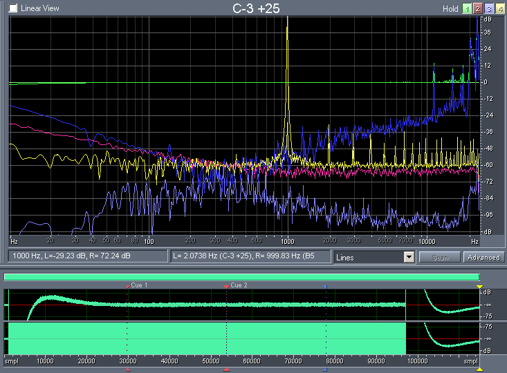

I must take a break now, but leave off with a picture worth a thousand words. It contains information about original.wav, wire.wav, and superposition of a 1kHz.wav from a similar D/A A/D system. Later I will provide details of wire.wav and original.wav run on this similar D/A A/D system with fresh and proper referenced 1kHz.wav:
The above does involve other time transformations, and perspectives.
