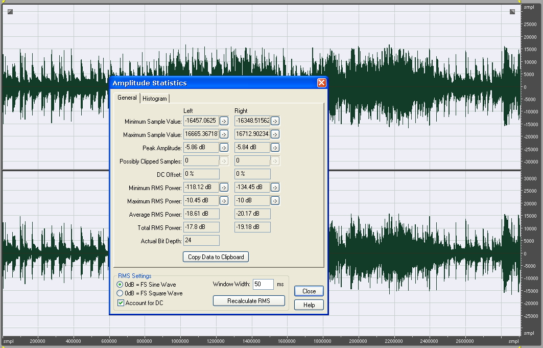

I have prepared 3 sound files for you, in 48kHz/24 bit. Two files are consequent take from the same capacitors, the third file is recorded through second type of capacitors. I will show you the file statistics now, for you to evaluate amplitude matching of files.

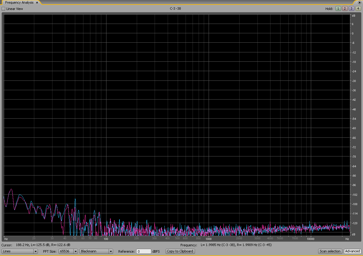

Now I will show you FFT analysis of the difference file between two recordings from the same capacitors. This will show consistency of the replay/recording process, resulting in noise bottom only. Such test is necessary for us to know that we do not evaluate only random errors of the D/A - A/D process used. Which may happen, anyway, but the difference must not create well audible artifacts.

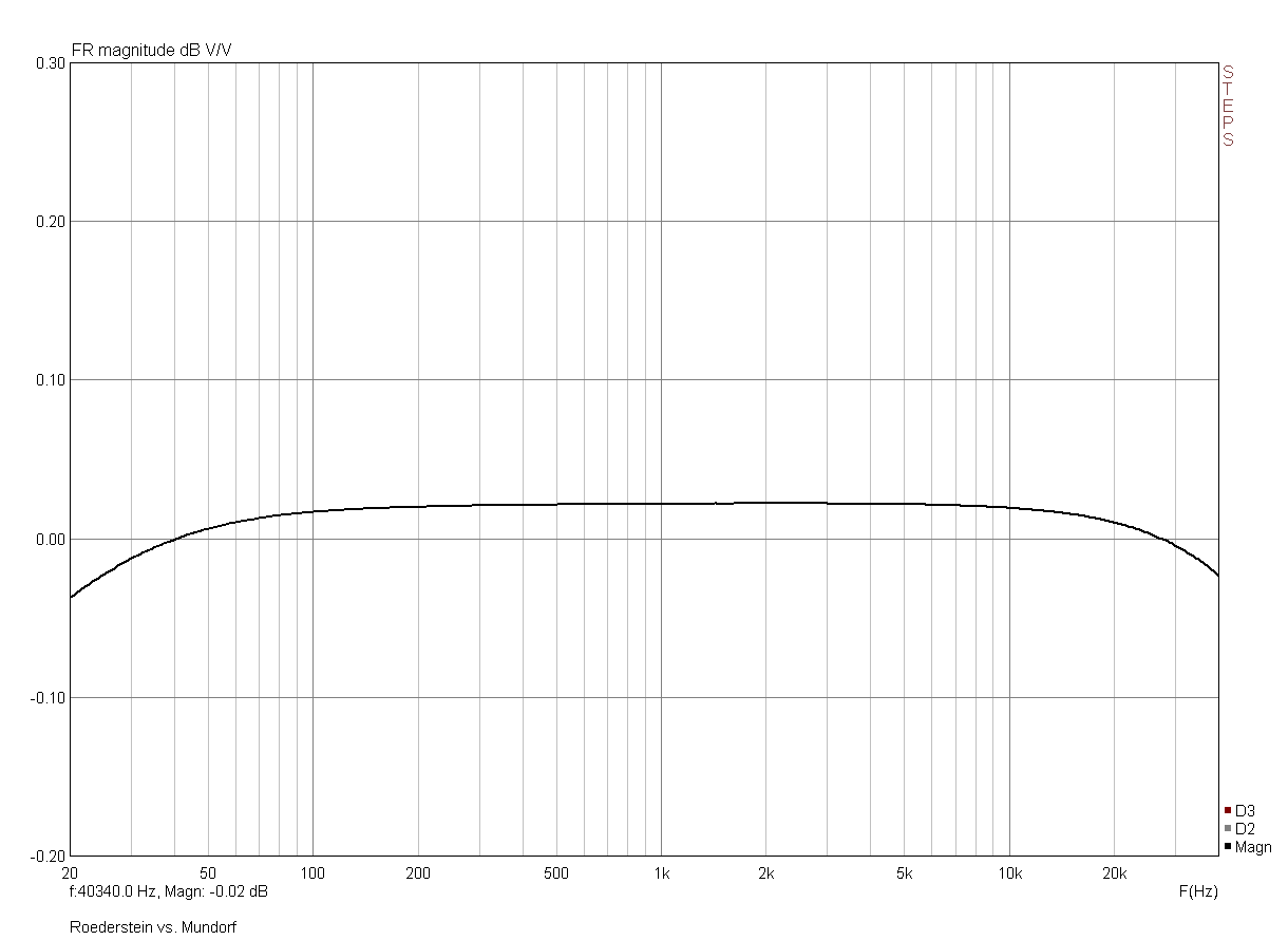

The difference in capacitances makes less amplitude response deviation than 0.1 dB over 20Hz - 48kHz band between the capacitor channels. Would it be OK?
It just almost passes your own requirement on level matching for ABX tests 😉
I think blind filenames, not due to be able to identify the actual make, but to take away chance of have being influenced ny marketing etc.
Seems quite high frequency for a coupling cap into a power amplifier.we shall have some low frequency roll off. Like -2.25dB/20Hz
What about F-3dB @ ~2Hz?
But it is matched between caps <0.1dB, and it may bring some stress to capacitors at least at very low frequencies.

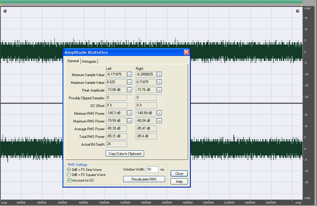

The difference between two files recorded with the same capacitor is like residual noise, you can see it in the attached FFT and in a grossly zoomed time record. On the other hand, difference file between two capacitors is quite clearly defined both in spectrum and time domain - but I do not show it yet.
