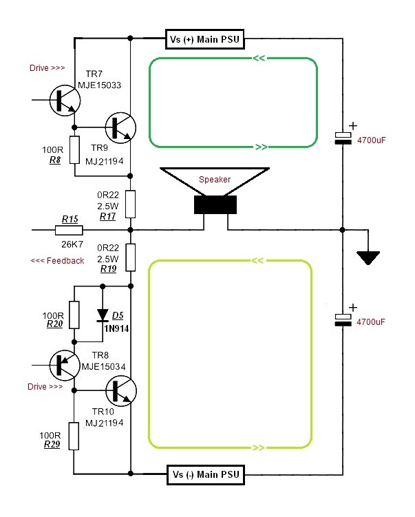

Here is a representation of how current flows through the entire circuit.
The current flow is always from higher potential to lower. But with respect to the speaker, you see it goes forwards and backwards which is what causes the speaker to vibrate, producing sound.
The speaker return IS the high current ground return that completes the amplifier circuit.
The ground return that comes from your amplifier module is important, but very little current flows through that compared to the speaker's return wire.
When connected as shown, the current is returned back to the power supply taking the path of least resistance. This keeps the current loop consistent.

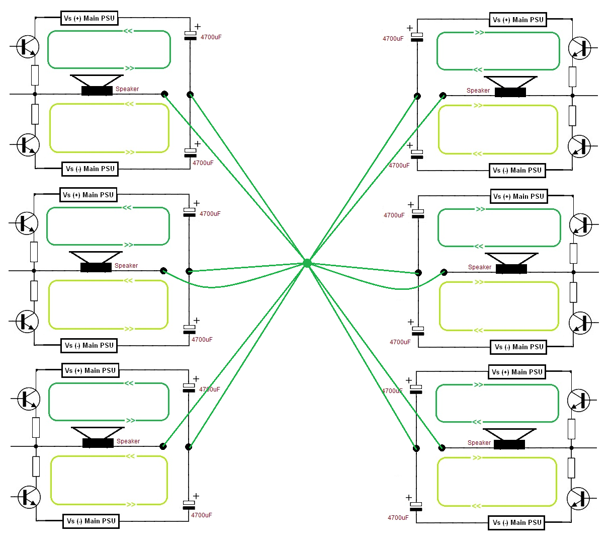

The picture here shows what you're trying to do.
Although the current loops have been shown circling within the circuits, it does not happen that way anymore.
The current through the speaker's return wire has to go to the central star point and then travel back to the zero-volt connection of the bulk capacitors.
Then there are six return flows that will have to be balanced out and since the flow is never constant within the circuit, it creates ripples.
You're listening to music after all, not trying to power a light bulb.
As the ground connections are now spanned out and connected to each other, this creates differences in potential within different points in the ground due to uneven current flow, giving rise to noise.

Soooooo...finally,
according to AndrewT & Bonsai...I was on the right track with the schematic on my post#103?
Right?
Or should I change something?
Bonsai...if you would have seen #103 you would have remarqued that the Star point is NOT on the caps's junction but connected from it like your DRW on 115.
Luke
Right?
Luke

I've explained the problem in few of the 100 or more threads before but I'm becoming an expert for explainings.
To make it short: every channel has great noise figure when tested individually.
But if you dare connect two or more channels to a preamp or just paralleled together then buzzes and hum occurs to a totally unacceptable point.
This happens to any 2 CH. unbalanced power amp but six is another story, I'm telling you.
Frankly...?...I really consider a set of Jensen or Cinemag 10k-10k line Xfo's.
Galvanic isolation is in my point the only solution.
Check in the past replies as I tried everything.
I've had a lot of great suggestions and I tried them all but none worked, even at the end converting my ground system did not bring the solution...not even a glimpse of solution or improvement!
