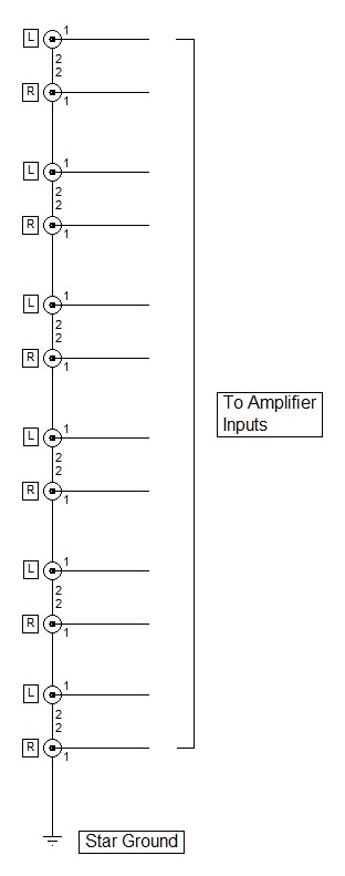

Consider a single channel amplifier connected to a Source.
The input cable is a two wire connection.
That input connection is referenced to Power Ground.
Now double that up to a two channel amplifier with two interconnects from Source to amplifier.
The two Signal Grounds are referenced to the single Power Ground.
At the Source the two Signal Grounds are almost certainly connected internally.
Now you have a LOOP.
any interference impinging on that loop creates a current around the loop.
The part of the loop from source to amplifier that carries the signal will now have an interference current on it and with the inherent resistance of the bit of the connection will have an interference voltage that is added to the signal.
Multiply that by 10 inputs and you have dozens of loops all collecting interference. Equals big hum !

So here is the Ground scheme of my amplifier.
Luke

Hi Luke123,
Have you tried tying all of the input grounds together, and then connecting them to the star with a single wire? Like this: View attachment 425435
Mike
Oh yes Michael, believe me!
The very first thing I did after realizing buzzes were still there.
Add to this inclusion of 100 ohms resistor(s) with the tests.
Tested in a lot of different ways...
Oh by the way, you show a 12 channels amp while I only have 6 ch.
Luc

By the way shields connect exactly at the Amp's Gnd point that links to the star-point.
jn
Hi JN
Wow...this picture is almost a month old and it's old story. Gone!
The new Gnd config is here at post#117 and it is a star ground with a ½"x½"x5" copper bar.
Luke
Hi JN
Luke
You still have to control the currents.
Think of this as a mind experiment. With all the inputs connected to sources, think of yourself as a current.. Travel along one of the input shields...where do you end up? Can you get back to the source equipment via another shield?
For any conductive loops, can a time varying magnetic field go through it? Are any of them signal grounds?
You show a massive star, did you twist the opposing current wires together?
How do you deal with the shield connections at the input jacks? Pins 1, 3 and 5 will be connected to an external common ground, where they form a big loop. If the other side input connector also connects to the source unit ground, you again form a big ground loop using your input shields, but it now climbs entirely through your main amp chassis.
Given the piecemeal schematics of the system I/O, it is rather difficult to follow what your amp is doing.

The picture here shows what you're trying to do.
Although the current loops have been shown circling within the circuits, it does not happen that way anymore.
The current through the speaker's return wire has to go to the central star point and then travel back to the zero-volt connection of the bulk capacitors.
Then there are six return flows that will have to be balanced out and since the flow is never constant within the circuit, it creates ripples.
You're listening to music after all, not trying to power a light bulb.
As the ground connections are now spanned out and connected to each other, this creates differences in potential within different points in the ground due to uneven current flow, giving rise to noise.
You still have loops here through the source components.
Hello
Bingo! The input transformers solved the problem!
So JNeutron was right to confirm my experience.
I just forgot I had a pair of Sowther 3197 600-600 ohms transformer so I tried them.
So I'll check for Jensen or Cinemag and I know I'll end out with much better noise specs as these have double-EShields and offer a better impedance match with my inputs.
