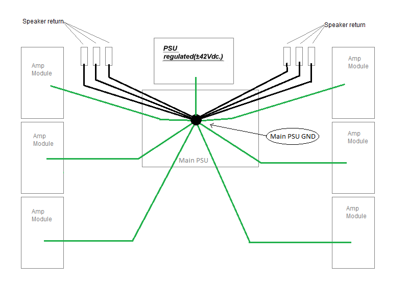

Luke, here is how you would route the ground connections of each module/unit/block in your amplifier to resemble a star ground.

1) If I compare your DRW to my revised Schematic of Post #45, page 5, you have common point with mine which is the Star to Amps path.
2) And now, for your speaker part in your drawing, I'm curious about something.
Does it matter by the fact that a speaker's terminal could be fed by a PSU shared copper track of 2.5 inches long on a PCBoard, if anyway...
• it is passive thus non active...
• it's balanced by nature...
• it deals with high-level signals...
• it is of low impedance ...
• it does not care at all to have a grounded or non-grounded fed signal...
• and this on any of its terminal...
• it does not need at all to be shielded...
3) Do I assume your inputs Gnd are connected at the inputs of amps and share the Amp track up to the Star point
4) Finally does your suggestion is based on my drawing post #45 which has a pair of Power PSU, a regulated PSU, both on a common star point?
Luke

Can you post some photos of your main power supply section? And i don't see the large supply smoothing capacitors after the transformers. Are they hidden?
In your case, what i'd do is have a single ground for signal return and connect it to the main PSU Gnd terminal, preferably through a 4.7 ohm resistor while the six signal lines will be connected to one amplifier each. It will work, because the amplifiers will be grounded to the main PSU.3) Do I assume your inputs Gnd are connected at the inputs of amps and share the Amp track up to the Star point
A pair of power PSUs is not the problem - how it's wired is the problem. And i see a lot of green wires exiting the regulated PSU board, while ideally i'd only have a single thick wire connecting the regulated PSU board ground to the main PSU ground.4) Finally does your suggestion is based on my drawing post #45 which has a pair of Power PSU, a regulated PSU, both on a common star point?
Don't worry about RF interference, mains interference, twisting, shielding, etc. Those are the least of your problems right now.

1) Well yes, mine looks more complicated but I don't have the choice...One extra MainPSU, RegPSU...that's life.
2) Some infos in pictures...mainPSU during assembly, MainPSUsch, RegPSUsch.
Note that starpoints on MainPSU are at C10-C11 and on RegPSU at C4-C8.
Here we go...
3) I've done this your way as stated in previous posts but not with coupling resistors.
4) Now for Gnd speaker lines I'm a bit skeptic in one sense but open for surprise in the other.
