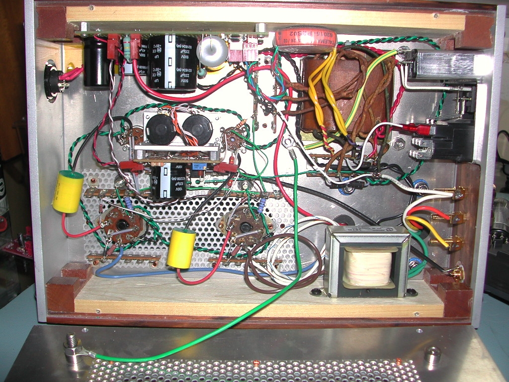

what I did on my summer vacation.......
I wonder if you might throw up some internal shots of your work as well?
Also, do you have a good source for the bias adjustment setup you used?
Here are a few shots of the underside.....Hopefully more fuel for chassis build ideas.....The B+ PS and (most of) the bias supply is on perfboard mounted to the side panel; the small toroid is the bias transformer.
In general, power stuff is on one side, and signal stuff is on the other.

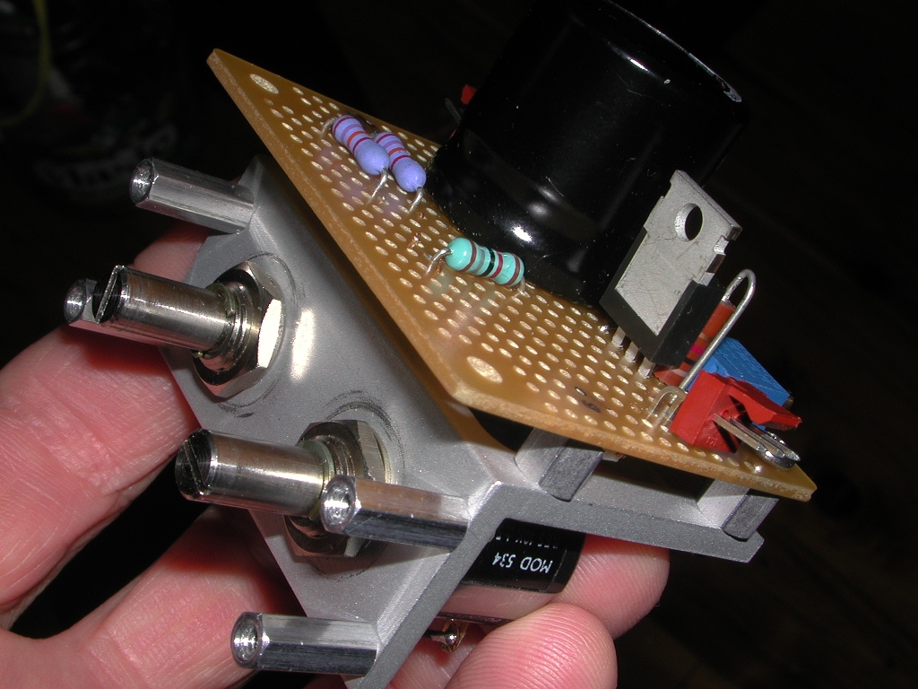

Bias bracket (my favorite part) is a piece of plain vanilla 1" x 1 1/2" x 1/8" thick aluminum angle with some small standoffs to get the end of the shafts flush with the top deck. The perfboard on the bracket holds the final filter cap and R's for the bias supply, as well as the 10M45S, adj pot etc. for the driver stage.
I ran out of room on the PS perf board so that's what drove the angle bracket for the bias pots. The angle bracket allows mounting another board vertically without any additional holes in the top deck. Two of the mounting holes for the bracket also hold one side of the 6GK5 sockets, further reducing fasteners.
I milled the AL angle for extra coolness, but it would work fine with just the holes for the pots and the standoffs.
I would have done an amperite based turn on delay but I don't have the room for a separate heater transformer, another socket and relay....
The amps are Poindexter's 6GK5/EL34 music machines.

That Bias pot mount is excellent as is all your chassis work! I'm taking some of these Ideas.
