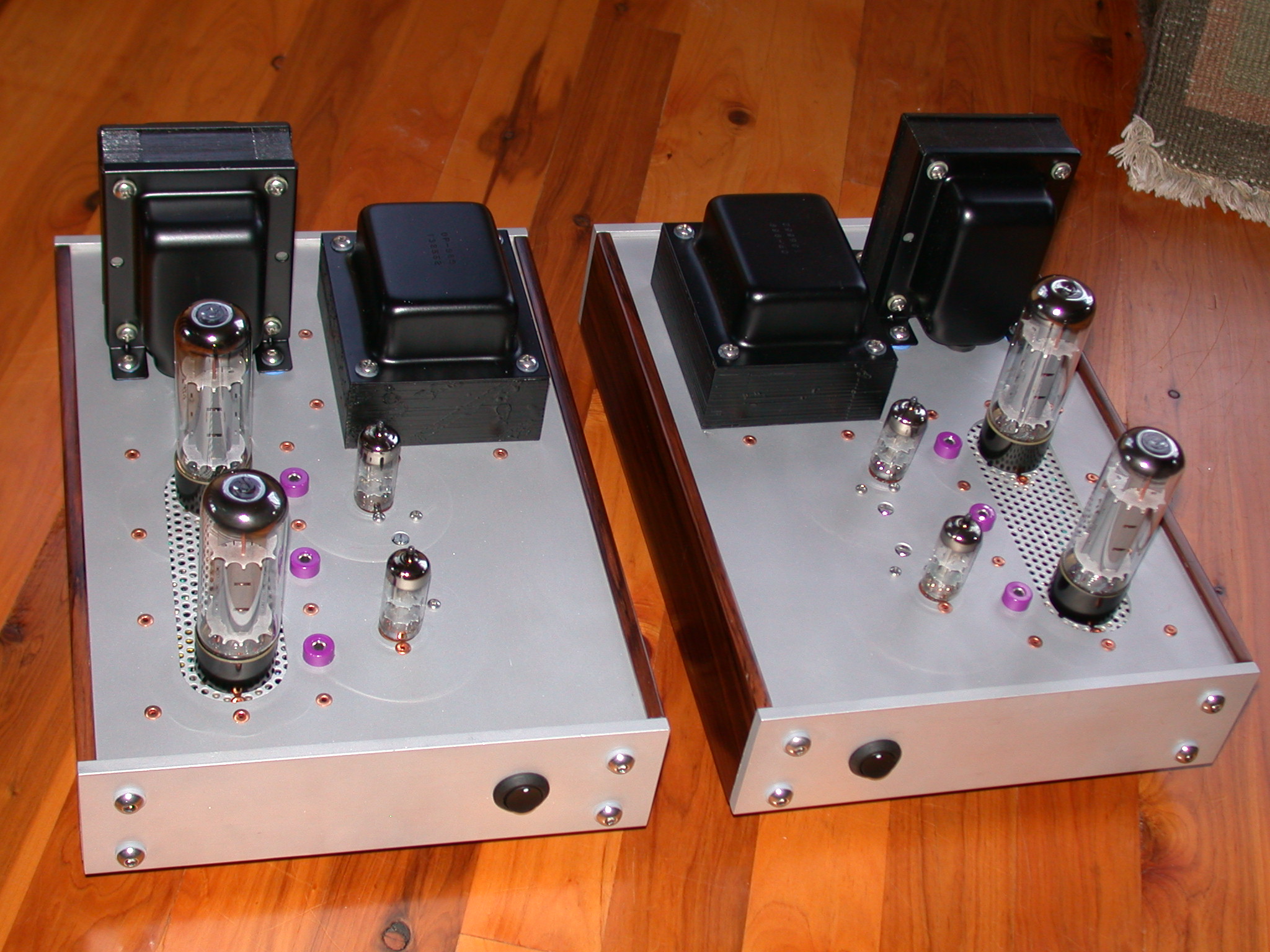

FWIW, here is my chassis construction method. Hopefully there are some ideas here that may be useful.
Bead blasted 1/4" AL font and back panels, 1/8" bead blasted top and bottom plates with perforated AL sheet riveted in. Round power switch since round holes are easier than sq/rectangular. I picked up a Freud non-ferrous table saw blade at Home depot that cuts the bar and sheet stock like butter.
I've also done "time-saver" grain pattern on AL with a 120 grit belt sander, although my preference lately is the bead-blast look. I made a bead blasting rig out of a rubbermaid storage container, and a cheap sandblast gun.
Perf hole pattern and rivet location also align with the solder tab strips to minimize fasteners on the top deck.
Top panel slides in groove in side panels, bottom panel is rabbeted in for ease of removal. Threaded brass inserts for F/R panel attachment. This way, if you screw up a top panel, or later decide those 7 pin sockets need to be 9 pin, you can fab a new panel and still re-use the rest of the chassis.
Bias pots are Bourns 10 turn WW and banana plug sockets on the top deck to connect voltmeter.
Rubber feet and copper rivets are from McMaster-Carr.
Those are my painted Edcors from my earlier post.

OK, we need to talk more about those. That it's exactly the look I wanted. 70's style, wood on the sides, and aluminum else where. I wanted some wood trim, but prefered it not be the main structure. My concern is the tooling required. I need details! I could use Front Panel Express for the tops, it it would cost too much for them to do it all. I must find a way to replicate that!
BTW, they look fabulous! A+++++
That does look nice doesn't it!.
I have and will use a router with templates for mine. Still leaves the issue of getting the surface finish as seen in boywonders. I have safely routed out 3/8 aluminum.
The plates could be taken to an anodizing shop if you have on locally.

The chassis above required a mill, planer and a table saw to complete. If you don't have access to mill, you can't do slots very easily, but you could still do large round holes with perforated AL underneath using holesaws. Also, the rear panel could get a lot simpler if your power entry can use a round hole, and the speaker binding posts are insulated from the chassis (more simple round holes).

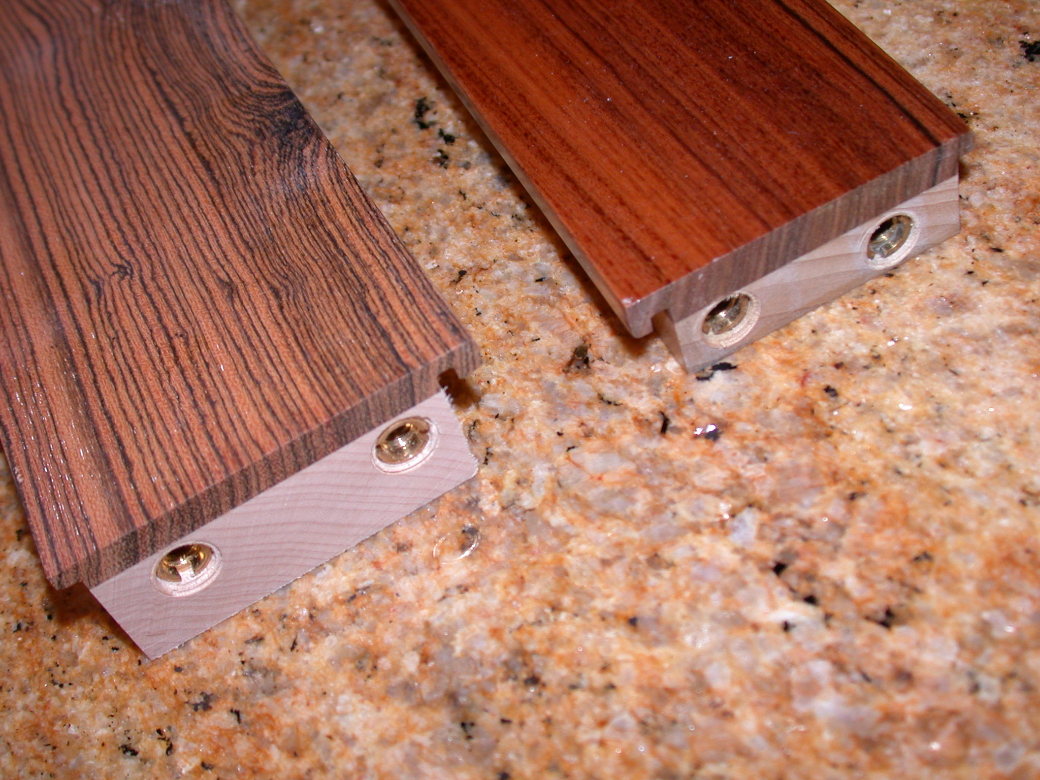

You could also use solid hardwood for the side panels, but if you get into exotics it makes sense to laminate to save the lumber, the trees, and $$. Making thin decorative wood pieces requires a planer, unless you don't mind sanding and you can keep things flat.
The slot and the rabbet on the side panels are simple rips on the tablesaw. A std table saw blade is 1/8" wide, so the 1/8" top panel slips right in. Most modern rip blades are .090" wide (thin kerf) so I use a 1/8" combo or a laminate blade to make the groove.
Screwing into end-grain is another issue; that's why I use the threaded inserts (also from McMaster-Carr). In the side panels shown above, the inserts are threaded into the end grain of the substrate (hard maple IIRC), still end grain.....I have since changed this a little by gluing small hardwood substrate blocks on the ends of the side panels to allow the inserts to thread into side grain, a huge improvement. I use the holes in the front and rear panels as the template to get the holes for the threaded inserts in the right place.

I see you used the Corcom power entry modules with the fuses, voltage selector, line filter and croissant warmer tray.
Seriously, very tasteful and well executed. I haven't yet got up the nerve to use wood as a structural enement in an amp chassis but those inserts look secure. I have a few sizes of them in my fastener box I'm sure... Zebrawood (or bocote?) over eastern maple?
