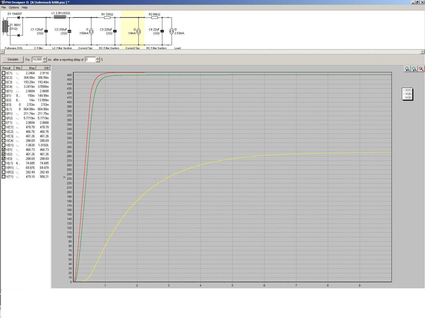

Here is the PSUDII model with the latest B+ voltages and currents:
I used 22u for the final cap, I'm not sure what a 32u was doing for us....

Sorry for my possibly mixing up more than one circuit diagram in referring to components. To set that straight, the diagram should be the one given in post #610 (and shortly afterwards post #612). The designations and electrode voltages there represent my suggestions. Only, recently, C6 was increased to 32µF, which was decreased in the immediately previous post to 22µF. If my subsequent posts differ, ignore and put it down to .... well whatever.
(No pressing reason for my 32µF; it is more of an available value here than 22µF. A higher value will guarantee a little more against l.f. instability and is physically quite small as said previously, but we do not know that l.f. instability will be a factor at all. Thus 22µF if that is more available over there.)

I have just noticed a further correction needed on the diagram. On the diagram above the EF86, it shows the correct B+ at 288V, but below on the power supply diagram it still shows the old value of 240V. Then perhaps also, the value of R10 = 200K, is a non-standard over here. I notice that a lot of 'strange' resistor values are available over your ways, but that value is uncritical and might well be 220K or 270K or some standard value, if it matters.
Yup, that was fixed in rev. 7c
200K is pretty common here (E24 I think), but if it's not elsewhere, then it's certainly easy and worthwhile to change, which I will do.
