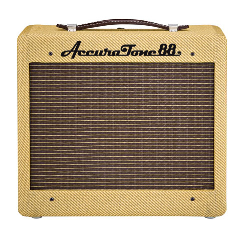

Mullard 5-20 KT88 PP blocks!
I'll play with it.
Meanwhile, I was starting to warm up to those retro ones 😉.
..Todd
