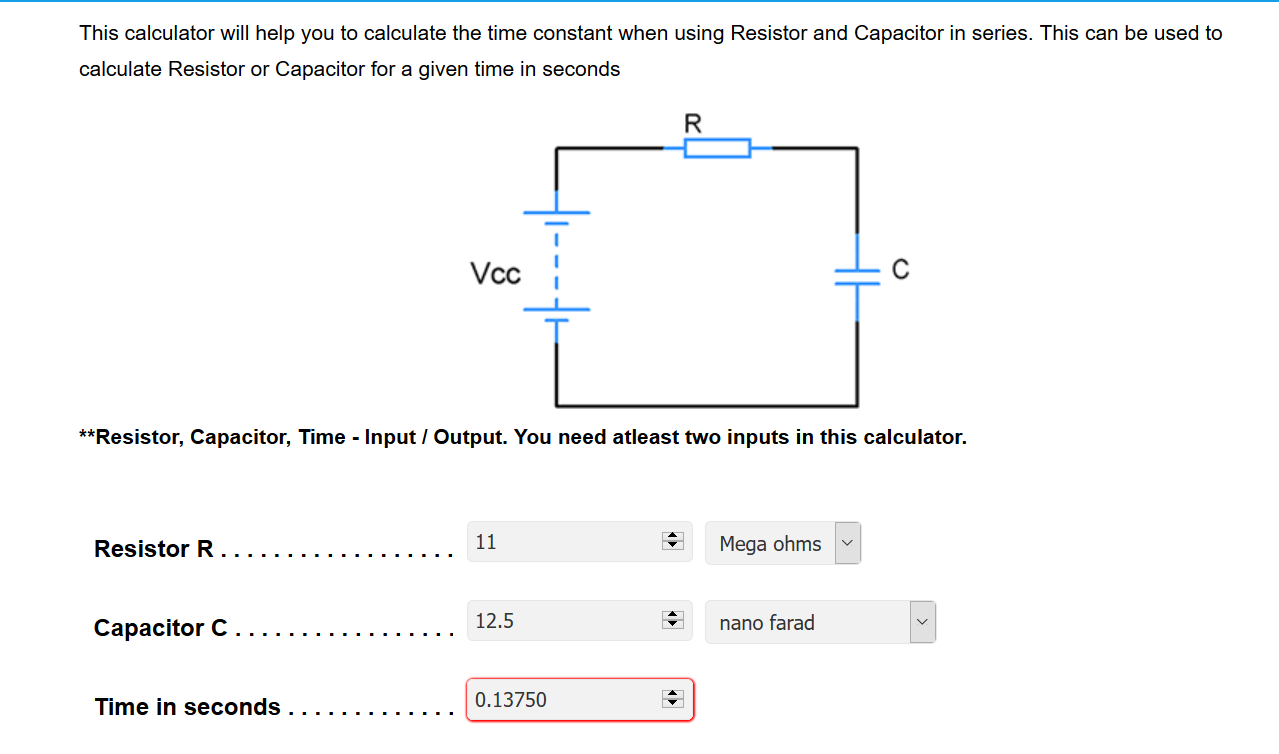

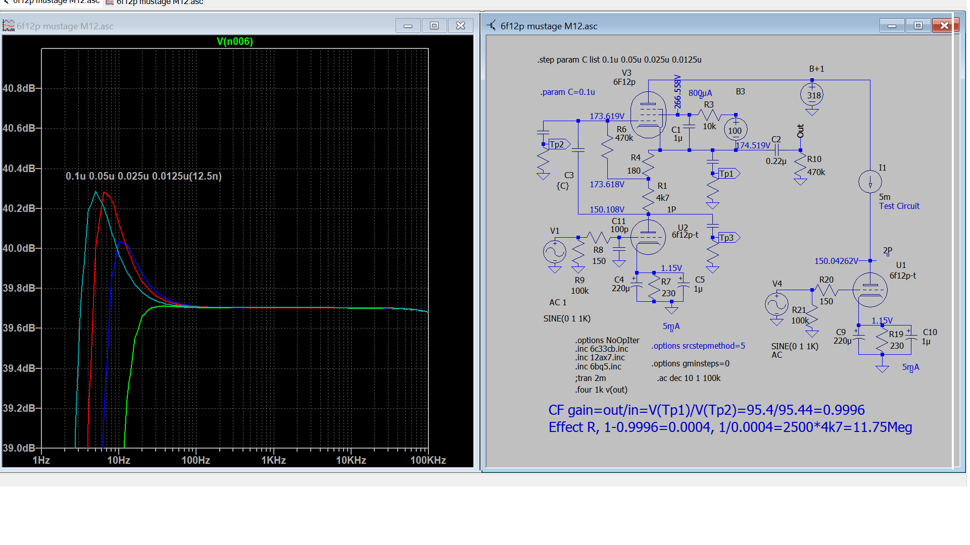

I think it's my ceramic capacitor 10nf
I calculated it with the effective Rcf(7,83 MΩ that i calculated and capacitor value should be 4,7nf for 4hz)
Is it wrong ?
Or should i calculate it with 470kΩ?
Both resistors are parallel...

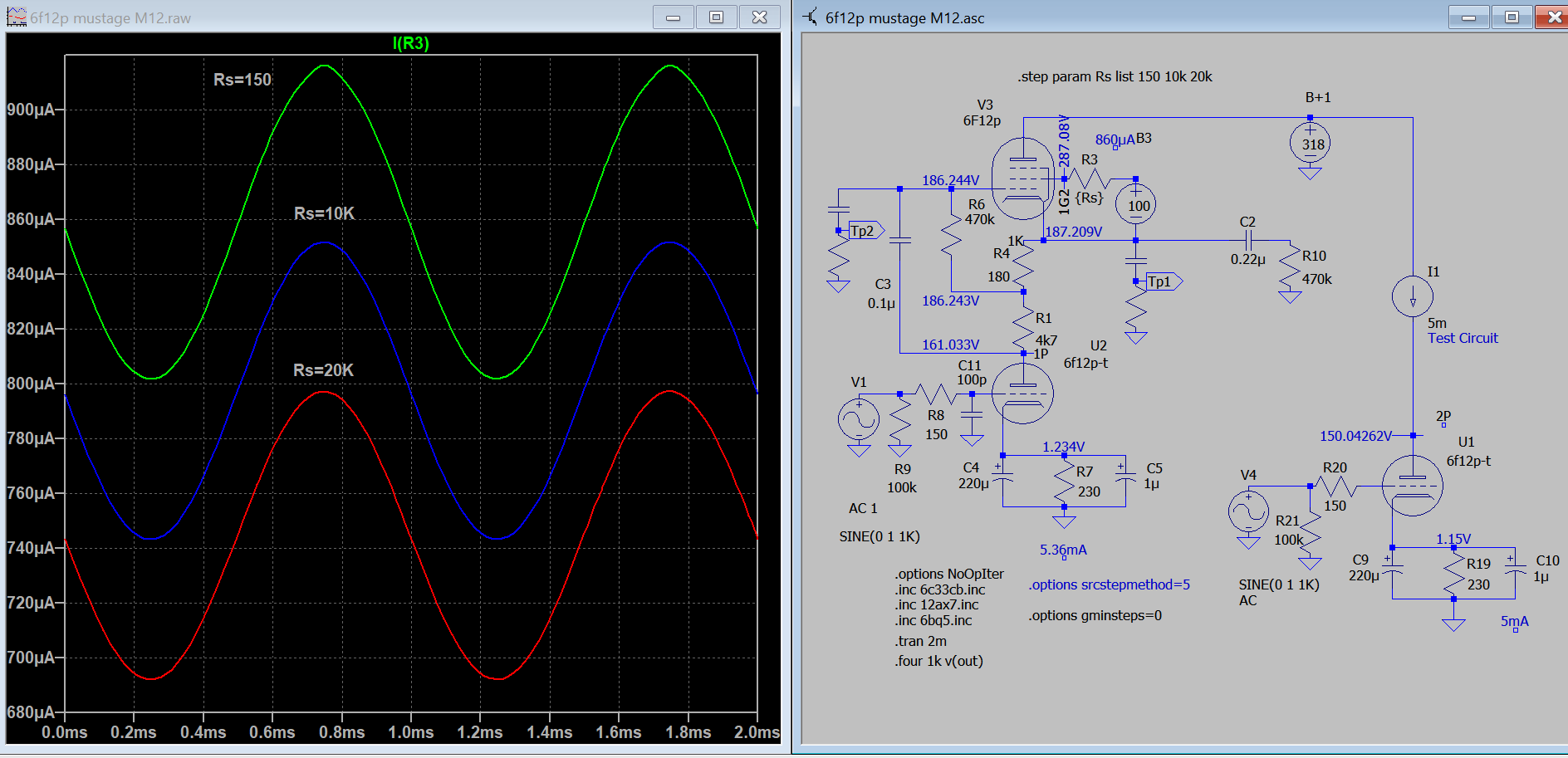

I think the screen resistor is too low as it draws too much current that causes the distortion, use Rs of 10K is better. Or increase the bias of top pentode should help.

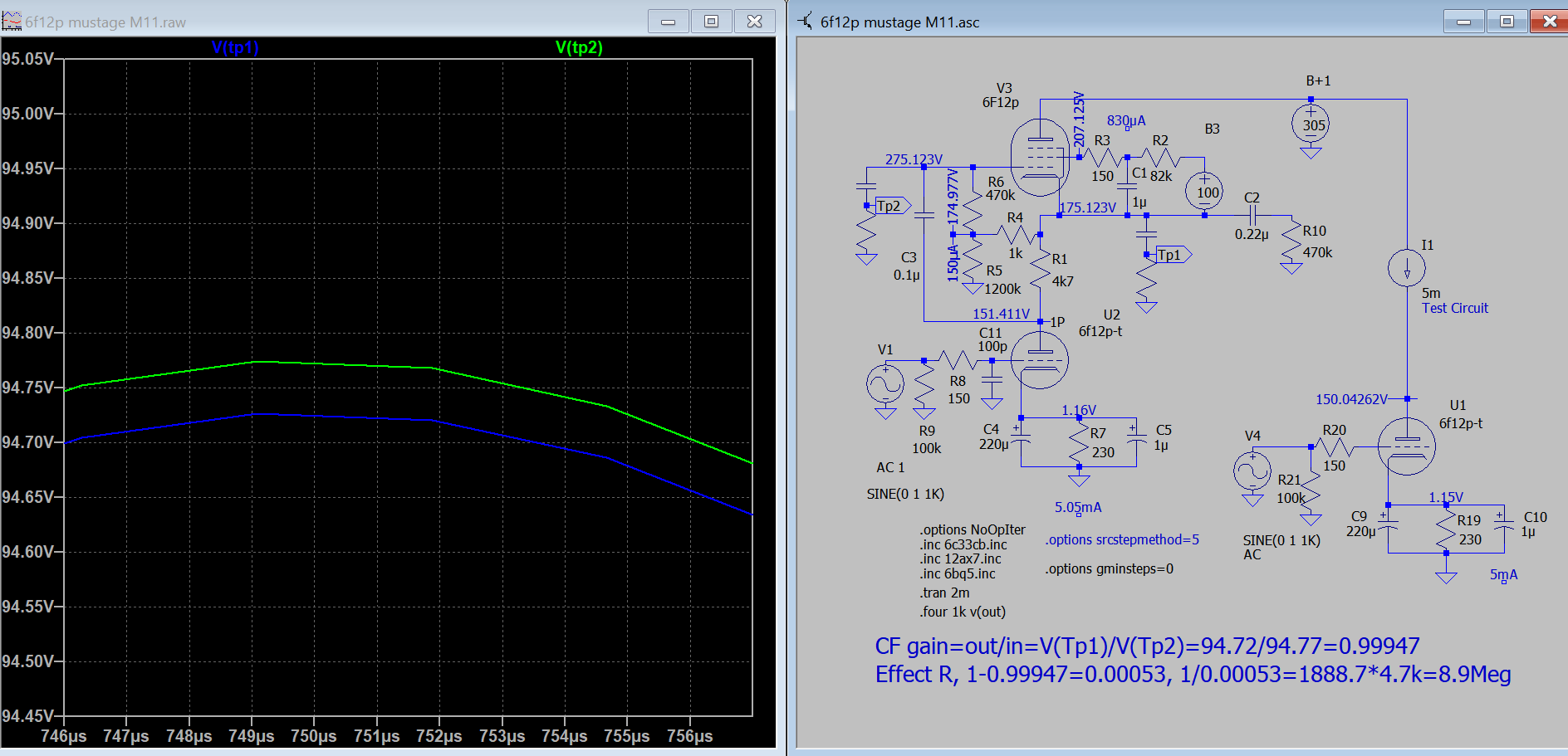

The coupling capacitor in upper tube should be reduced as you already pointed out as effective Rp is greater now. Still think you need to bypass the screen to cathode with a capacitor.

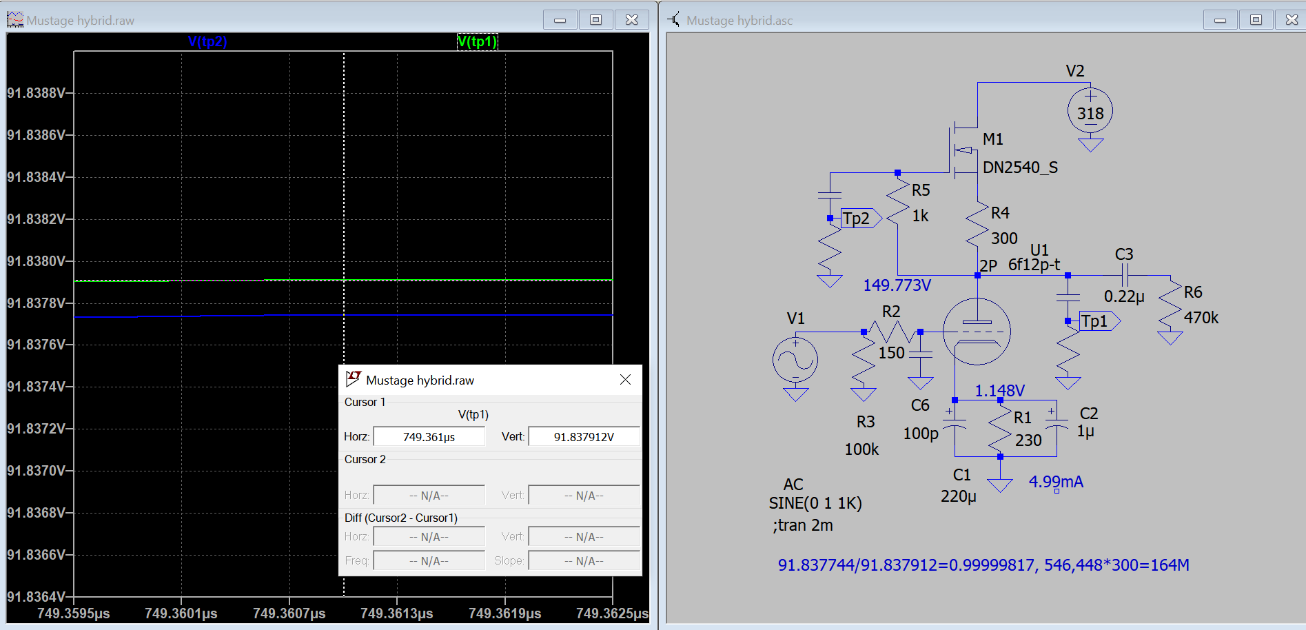

RC constant for Tp1/Tp2 (0.0001µ/1000Meg) has very little loading on signal and frequency response down to 10Hz, is ideal for measuring the tinny difference of gyrator. But there is no coupling capacitor here. The gyrator has 164M effective Rp, more than 10 times the pentode for bottom triode.
Correction: Load should taken out on source top of 300 Ohms. Effective remeasured Rp is (?), sorry about that.
