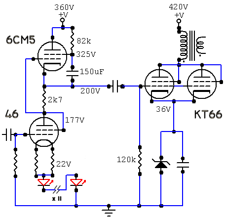

I would like to try something like this with my 801A as a driver for 300B...not sure how to do the maths so on these new variants...so, if anyone did already something in that direction, that would be helpful to understand.
Looking at the 6CM5 curves, it is a far from linear performer. So, how to arrive at a more or less steady current? The 150uF sets the G2 voltage, over the high value 82K resistor. At peaks G2 voltage drops, stabilizing the penthode current. One can always put a potentiometer in its place and follow the empirical route.

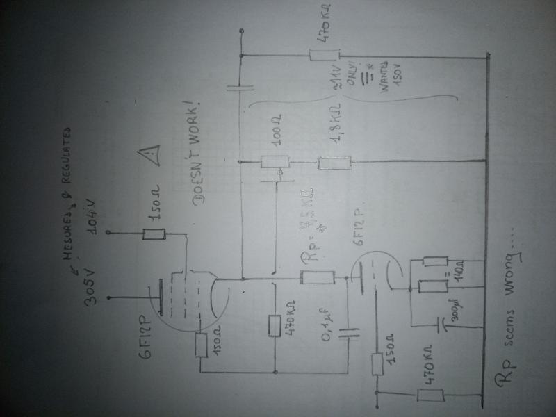

Hello, I'm trying to build a mu stage with the 6F12P tube. It's a triode + pentode with a big μ, it seems to me to be a good tube for that but I have all the difficulties in the world to make something that works.

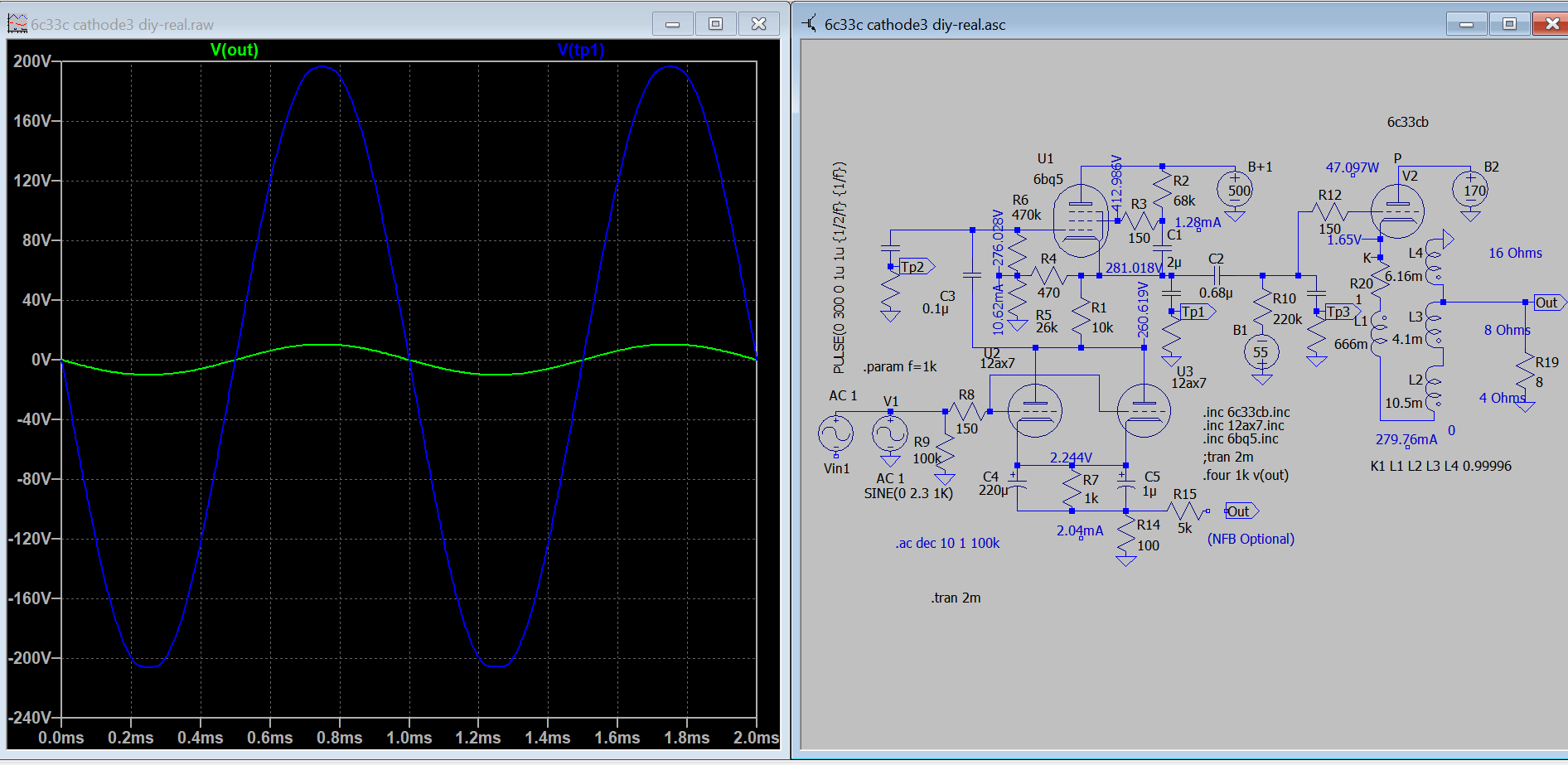

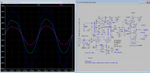

This is sch of my real amp, not different from Alan Kimmel's circuit. But If the upper tube is 6f12p Pentode you don't want to draw too much current and hence the difference is current division, the bottom tube can carry as much current as upper tube. Btw replacing 4x 6c19p with 1x 6c33cb sounds much better to me, Mu stage driver stage is good to go.
Very interesting, Koonw! Could you confirm that your output transformer primary and secondaries are actually in series? If OP allows could you please tell more about this transformer and did you use one or both triodes in the 6C33B?

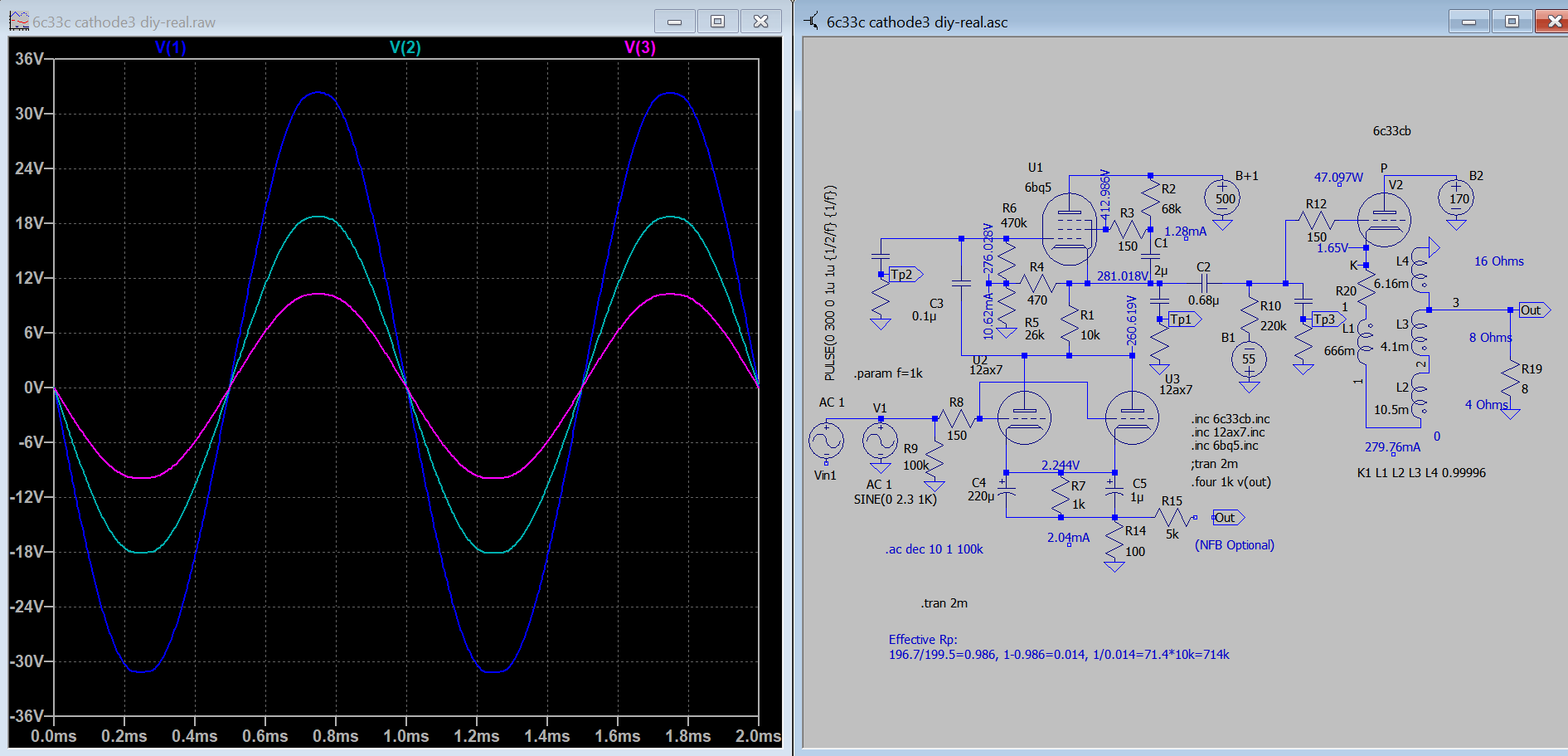

Yes I confirm the OT secondary is connected in series, in correct phase which will induce NFB as shown otherwise it's PFB which resulted in more distortion and I use both triodes of 6c33c. The bottom and top response is much extended in this arrangement than without, still good power output. OT is air-gap, rated 30W , the inductance is measured, and calculated about 200-300 ohms Pri DCR 65 ohms, but maybe due to quality of lamination used HF is rolled off but after NFB from output winding it's much improved.

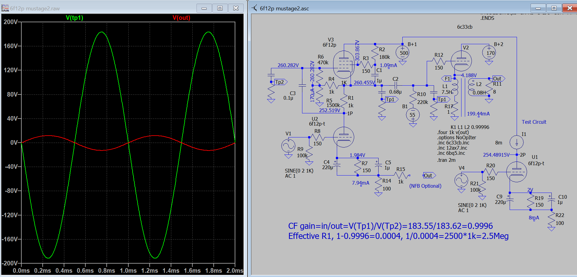

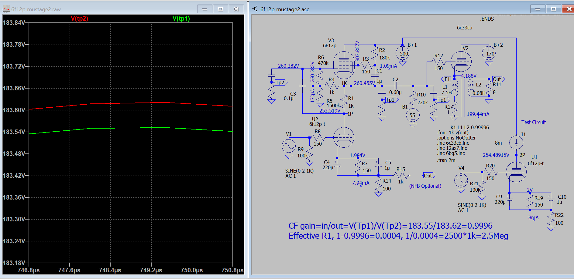

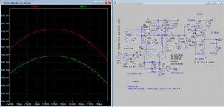

Btw I figure that Effective Rp is 714k<1Meg:
196.7/199.5=0.986, 1-0.986=0.014, 1/0.014=71.4*10k=714k

I spot one reason why it does not work. The screen supply is short circuit the signal of the upper tube. Insert a resistor of about 100k after 150 screen resistor to HT2 should fix it. Btw the total current is 9.8mA, if not you may have to adjust HT2 (screen supply) or the cathode resistors of bottom tube.
