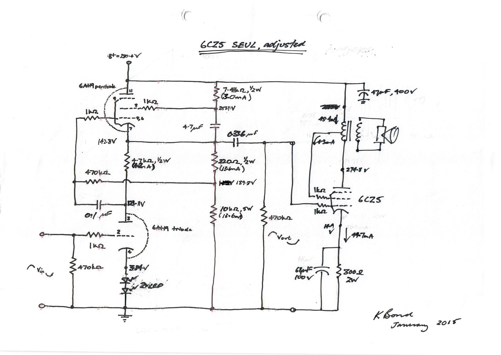

I tried directly the resistor without zener solution.It was easier for me.I will test the triode strapped solution later, but it seems the most interesting.

There is still a capacitor in the signal path shorting AC signals, this is normal for pentode operation but it is still no current source...but it should be closer now... the higher the resistor the closer you will het at the expense of the voltage drop. So using a current source instead of the resistor can solve this.

The subject is Mu stage or follower, the idea is understand first the prior art and built, then only you can compare. The schematics by OP will mostly work if you don't get into clipping. The gain is not equal to Mu as output Z will suffer esp. smaller tubes. I have EL84 screen wired the same way but I could try the floating screen PSU to compare one day.

A pentode will draw current on G2... this is normal, therefore you need a low impedance source to drive it (if you want to drive it).
Therefore you always measure the cathode current in a pentode and not the anode current as you need to add the G2 and A to get the exact results...

Thank you for the lesson.I was a hassle and it's not finish...
Now i would to understand why in whole case i saw in a mu follower a bypass capacitor between the screen and the cathode
There are 3 modes 1) Pentode, screen is made reference to cathode 2) Triode, screen is made reference to Plate 3) Ultra-Linear, screen is connected to tap of OT usually 60% from plate.
So a capacitor between screen and cathode makes it work in Pentode mode (max gain, as there is zero feedback from plate), else it's still in tridoe mode (depending on how the screen supply is wired). In floating screen PSU, the filtering cap is already connected between the 2 terminals, the capacitor can be omitted.

Is it possible to get schematic of your kimmel 6ah9 schematicYes that's what I used too. I had max B+=300V, so I put only 116V across the triode, about 155V across the pentode, so that the last 30V was across the anode resistor of the triode.
I biased both the pentode and the triode at -1V. That gave me 3mA through the triode and I guessed about 15mA through the pentode (the 6F12P dat sheets don't show screen current 😕)
30V and 3mA gives 10kOhm on the triode.
I have attached a cleaned up sketch of my test circuit (the original is very messy because I changed values a lot before I arrived at the final circuit). I was testing many pentode/triodes at the time. The 6F12P worked well, so did the 6KT8, and the 6KR8. My favourite was the 6AH9 compactron (mu=20).
I didn't use a second regulated supply for the screen of the 6F12P pentode (interesting idea) but just tapped it frpom the B+ as Alan suggested.
